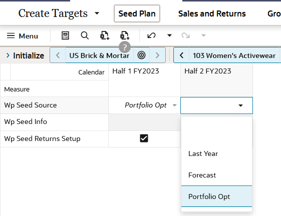

Seeding One Level at a Time
To seed one target at a time you will set the seed source information. Then, to seed the next department in the Product hierarchy within the Brick & Mortar channel, complete the following steps:
Click the dimension whose value (position) you want to change..
Click the Next or Previous arrow.
Figure 8-1 Changing a Dimension Level with Page Arrows
The page refreshes and the next position in the department dimension is displayed in the page edge. Notice that the Seed Source measure is not populated for this department.
Select the half that you want to seed with Last Year (LY), Forecast (Fcst), or Portfolio Optimization data.
Before seeding with Portfolio Optimization data, you need to retrieve results from Portfolio Optimization using the Review Portfolio Optimization view.
Figure 8-2 Seeding Options
Click the Next arrow to view and seed the next division.
When you have selected all the data you want to seed, click Seed in the bottom right corner.
A confirmation message is displayed, stating that the data has been successfully seeded. Click OK.
After you have seeded, the view refreshes and the Last Seed Source and Last Seed Date measures contain the source and date of the last seed.

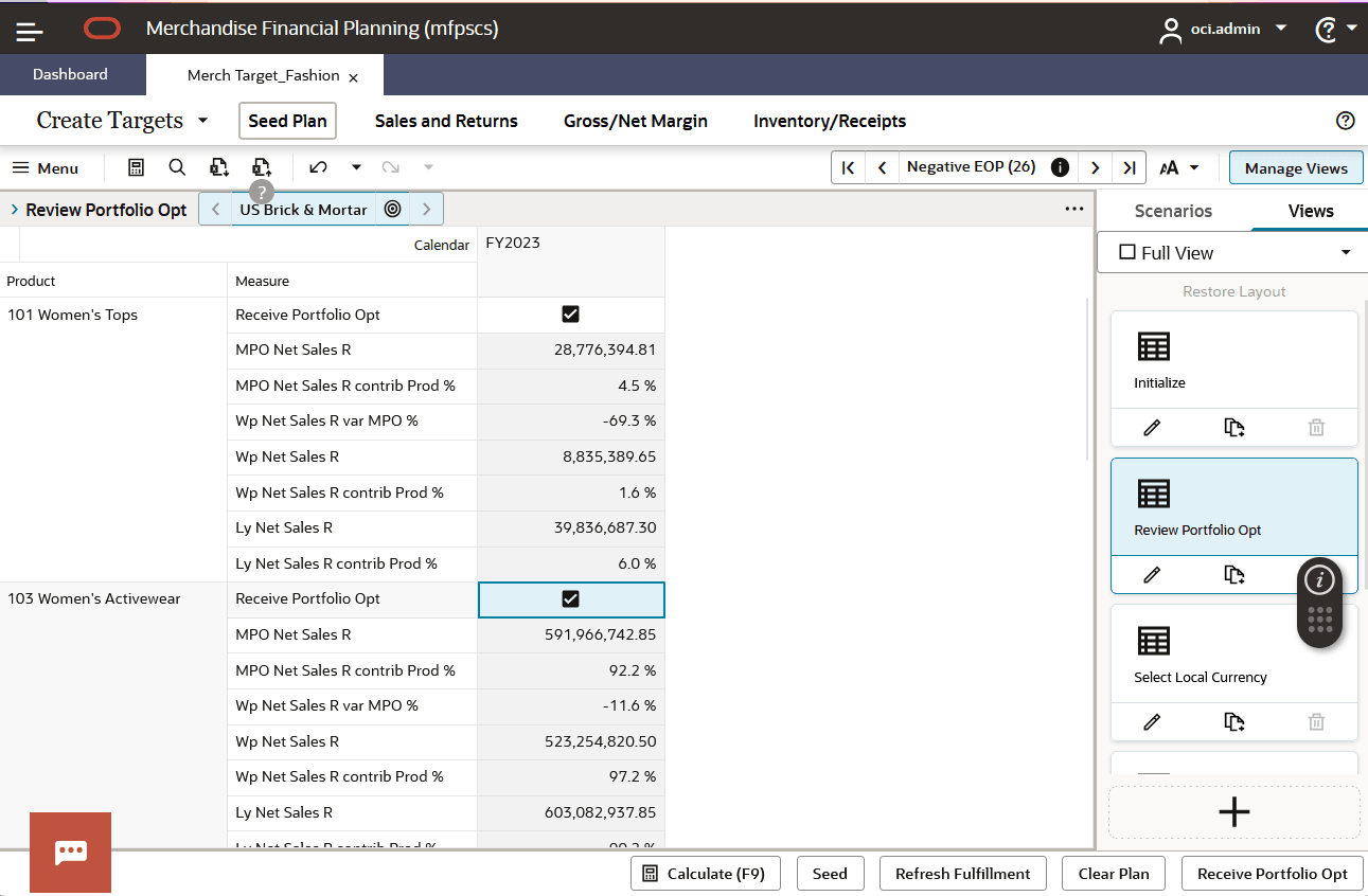

Review Portfolio Optimization View
The Portfolio Optimization output can be used for seeding the Merch Target Plan. Select the Boolean for dimension scope and click the custom menu action, Receive Portfolio Opt. After the results are populated against the MPO (Portfolio Optimization) measures, you can proceed with seeding the plan from the Initialize view. By default, MFP GA receives Net Sales R as output from Portfolio Optimization and it populates MPO Net Sales R in the view. The portfolio optimization results are retrieved at the year level which are then split into weeks using the LY data reference while seeding. You can choose to configure it for Gross Sales Portfolio Optimization output.
When creating the Merch Target workbook, the scope of the workbook should be at the same level of the scope of the Portfolio Optimization run.
Figure 8-6 Review Portfolio Optimization View

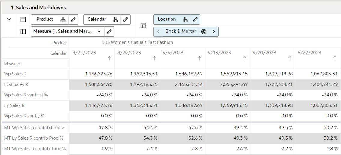

Sales and Markdowns View
In the Sales and Markdowns view, you plan net sales, promotions, and markdowns. Sales are the revenue generated by selling goods or services. Regular priced sales yield the greatest margin, however successful promotions drive more traffic and completion of sales. Though the promotional sale likely includes markdown, the overall increase in sales should outweigh the markdown and drive at good margins.

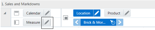

There are several measure profiles available to logically guide you through the plan variables.
A measure profile is selected by clicking on the Edit View button next to the Measure tile.
Figure 8-7 Edit View Button
The following measure profiles are available:
Sales and Markdowns
The measures in this profile represent totals which are not broken down by type of sale such as Promo, clearance, and so on. This view also incorporates the forecast for viewing on top of all Ly actuals.
Sales by Type
The measures in this profile display and capture sales and returns figures by type of sale: Regular + Promotional, and Clearance. Regular + Promo, and Clearance added together equate to the total sale or total return.
Start by planning the regular sales. Then, using your marketing calendar as a guide, align the promotional sales to the calendar. Refer to the calendar again for the exit weeks for the products, and plan the clearance sales for those weeks.
The planned figures for these sales types populates the Wp Sales R measure.
Markdowns by Type
Markdown is the difference between the original retail price and the actual selling price. The measures in this profile display and capture markdown figures as a total as well as by sales type: Regular + Promotional, and Clearance. The markdown types added together equate to the markdown (Wp Markdown POS R).
In the cost method of planning, many companies do not plan markdowns, but planning both promotional and markdowns offers a guide to make decisions and keep aging inventory from becoming an issue.
Units
Some lines of businesses may prefer to build the plan, or at least closely couple the financial plan, by sales in terms of units. You use this view to review sales units, Average Unit Retail (AUR), and Average Unit Cost (AUC).
Direct
This measure profile contains the KPIs for direct-to-consumer channels.
Fulfillment Planning
This measure profile is focused on planning returns which result from Online purchases which are returned to the store. Often a significant portion of those returns are then sent back to the Online Fulfillment warehouses. These returns are rightfully attributed to the Direct channel and impact the net sales.
The restocking costs associated with such returns are reflected in the net gross margin of the Direct channel.
Fulfillment Ly
This measure profile is used to review last year's financials for sales returns and returns back to online.
Figure 8-8 Sales and Markdowns View
Follow these steps to basic sales and markdown generation.
To create the Merch Targets, one approach is to complete the following steps within the views described above:
Using the default measure profile, which is Sales and Markdowns, review and compare the total sales to the forecast and last year.
When building the targets for Wholesale/Franchise channels, plan Net Sales and then go directly to the W/F - Sales and Markdowns view.
Enter the Wp Sales R that you are projecting. Use Fcst Sales R as a guide.
Enter the projected Wp Gross Margin% at month level and click Calculate in order to calculate the Wp Gross Margin R and Wp Net Sales C.
Continue to the next sub-step to plan the required inventory. Review Wp Stock to Sales Ratio. Adjust other seeded inventory measures, such as Wp Shrink C and Wp MOS C, and plan the Wp Receipts C to achieve the desired stock to sales ratio.

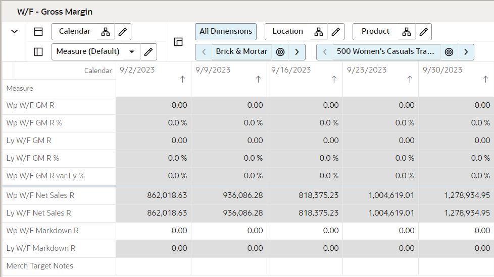

W/F - Gross Margin View
If the Wholesale Franchise option is provisioned, you plan W/F channels in this view.
Wholesale/Franchise sales are typically tracked and managed as a separate channel of a retail business. In the Wholesale/Franchise Gross Margin, you review the planned gross margin on your wholesale/franchise sales.
Figure 8-15 W/F - Gross Margin

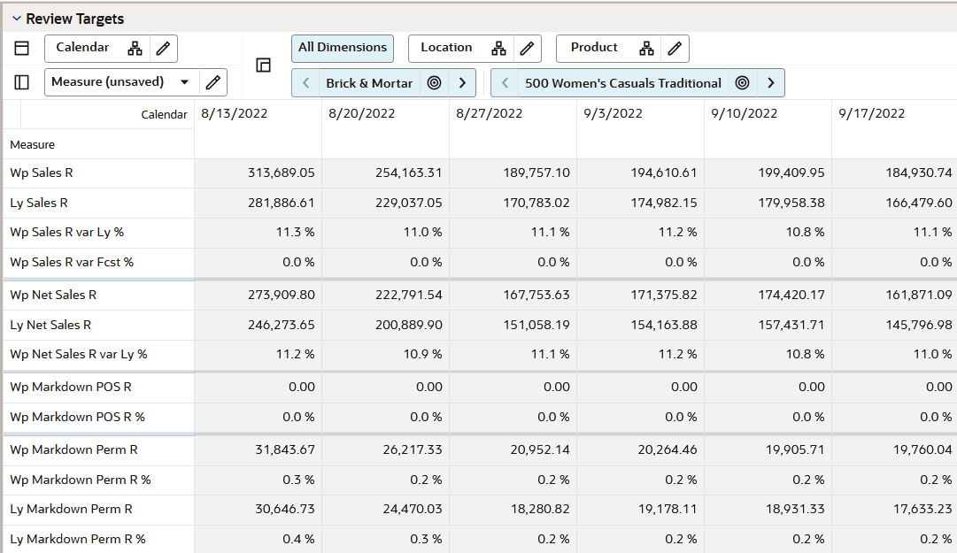

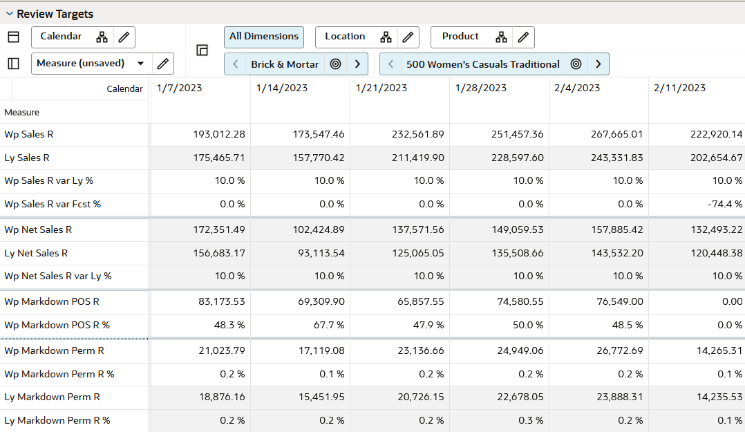

Review Targets Sub-Step
In this sub-step, review the targets you created in the previous step. If you need to alter the targets, return to the Create Targets step to make edits.
Review Targets View
There are several measure profiles in this view to quickly guide you to the plans you wish to review:
Default
This measure profile shows the main Working Plan metrics for comparison with last year metrics. This is the profile you will use after initially performing the Create Targets step.
Tgt with Cp
This measure profile shows the main Working Plan metrics for comparison with Current Plan metrics. Current Plan is a version of the plan that is approved in-season (and is actualized for elapsed/historical periods).
Tgt with Op
This measure profile shows the main Working Plan metrics for comparison with Original Plan metrics. Original Plan is the plan as it was initially approved-typically it got approved pre-season and stays fixed when the period becomes in-season.
Figure 8-16 Review Targets View

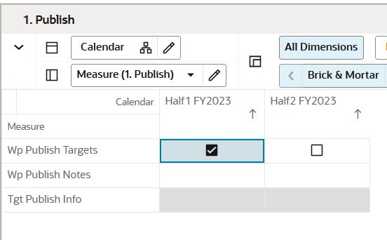

Publish Targets Sub-Step
Publishing a target copies the targets you built in the Wp measures to the target (Tgt) measures, and then commits them to the database. Once committed, Planners can retrieve those targets and take action planning to them.
The Tgt measures are shown in the Publish Targets view found in the Review and Publish Targets step. These measures initially have zero values. After the targets are published in this step, those measures are populated with the target information. There are two views within the Publish Targets Sub-step.
Publish Targets View
To publish the targets, complete the following steps.
Select the halves in the Wp Publish Targets measure that you want to publish.
If needed, enter relevant information in the Wp Publish Notes measure. This is optional.
Repeat Steps 1 and 2 for other channels and departments as desired.
Click Publish Targets. This button is located in the bottom right corner.
A success message is displayed. Click Dismiss to close it.
The view refreshes and clears the data in Wp Publish Targets and Wp Publish Notes measures. It populates the data for Tgt Publish Info measure as name:date:notes.

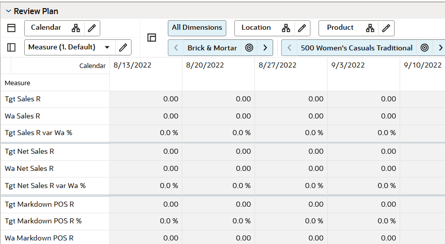

Review Plan Sub-Step
In the Review Plan sub-step, you directly compare the Planners Wa plan to the targets. There are several Tgt-to-Wa variance measures that quickly guide you to areas of difference.
Tip:
Use exception formatting on the variance measures to highlight variances. To reach the formatting dialog, right click the measure label and choose Format from the popup menu.
Figure 8-17 Format Dialog

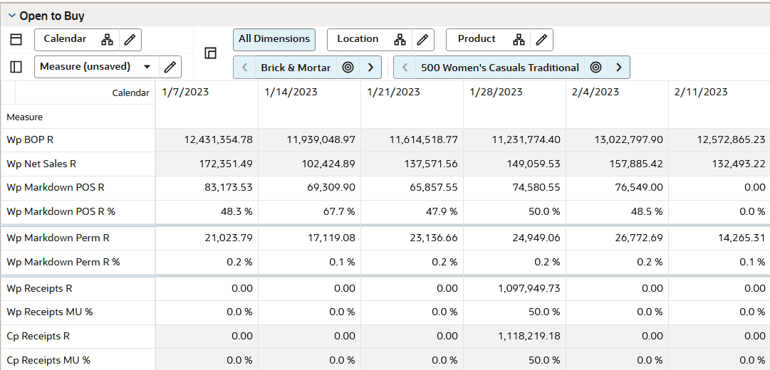

Open to Buy Sub-Step
This sub-step has one view.
Open to Buy View
Use Open to Buy (OTB) to understand the variance between the current planned receipts and the on order plus any on order adjustments. This variance is shown in the Wp OTB C measure. OTB indicate how many additional receipts can be purchased. Users should understand if their planned receipts keep them on the overall Cp EOP inventory plan. To understand the variance between the Cp EOP inventory plan and the Wp EOP inventory plan, reference the measure Wp EOP C var Cp%. Use this view to validate what OTB you have available and then start adjusting your plan. Then, confirm that your updates can be obtained given the OTB constraints you may have.
The following profiles are available:
Cost
This measure profile focuses on key metrics of total sales, markdowns, receipts, and on order to summarize open to buy.
Units
This measure profile focus on unit and average unit cost key metrics for sales, receipt, and on order.
Use the following best practices to adjust OTB:
To understand the difference between the current approved receipts and the net on order, compare Cp Receipts C to Wp Net On Order C.
If receipts are booked for upcoming (non-elapsed) periods, you can enter the Wp Receipt C data into the Wp On Order Adj C to capture the Wp OTB C measure. For example, this may occur if receipts book daily for the retailer, and OTB is completed on a Tuesday. By using the Wp On Order Adj measures, you can capture all receipts for comparing the Net On Order to the Cp receipt plan.
Figure 8-21 Open to Buy View
