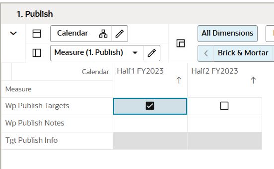

The first two steps are related to pre-season creation and publication of targets to the Merch Planner. The third step involves reviewing and approving or rejecting plans submitted by the Merch Plan role. The fourth step is used for in-season adjustments to targets.
The Planning Manager must complete the first two steps to publish the strategic targets to the Planner.

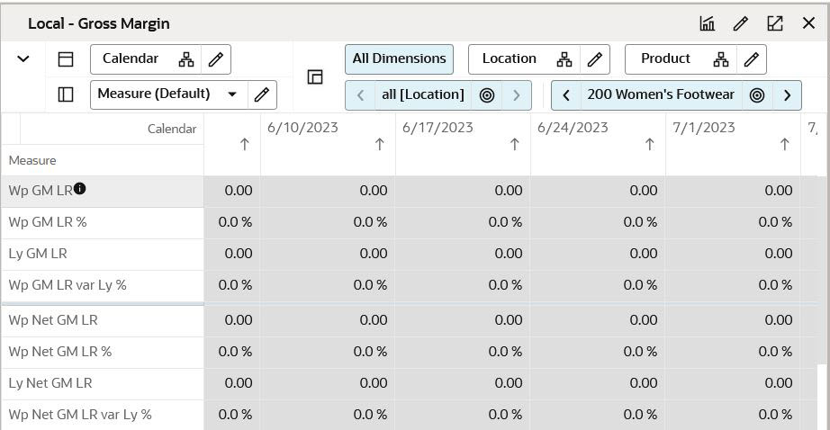

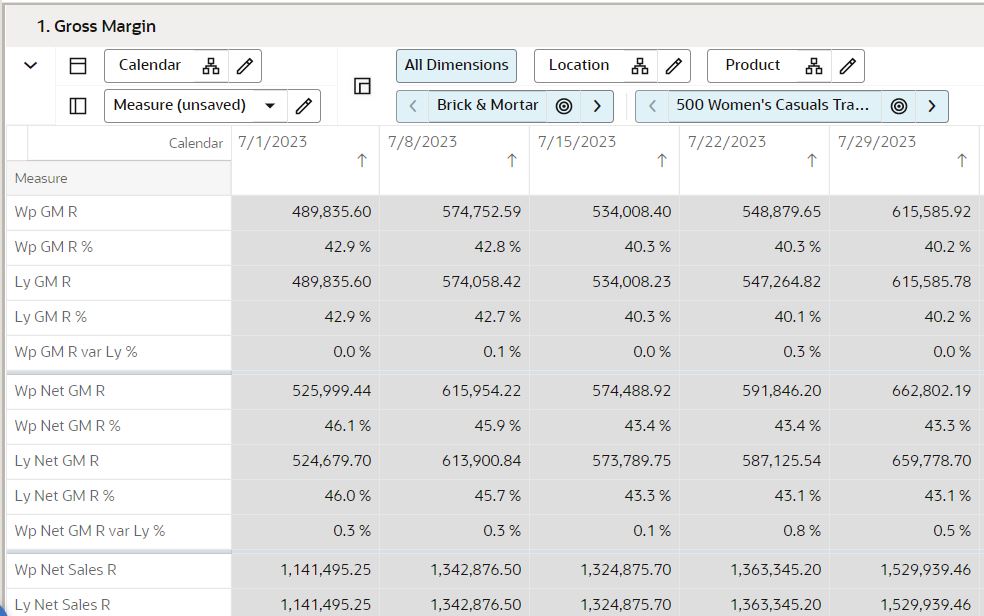

Review Gross Margin results.

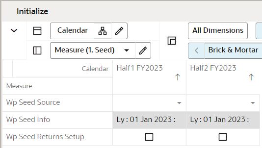

Seed Plan Sub-Step

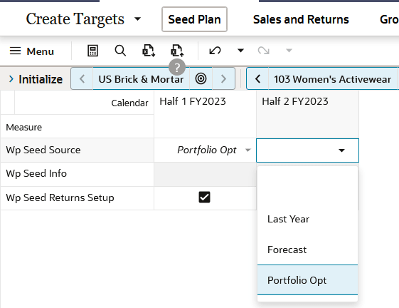

The first action that the Planning Manager completes when creating new targets is to seed the plan within the Initialize view. In order to seed the plan, you can first review the LY plan and forecast in the Sales/Markdowns tab. When you have portfolio optimization data, you can review it in Review Portfolio Optimization view. This will help you determine which plan you will use for seeding.

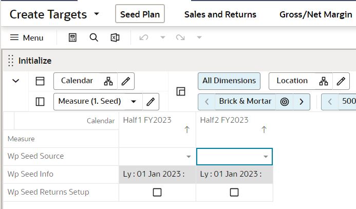

Initialize View
With this view, you can choose to seed your plan with Last Year (LY), Forecast (Fcst), or Portfolio Optimization data to create a demand curve on which to spread the new plans initial targets. Or you can instead choose to not seed the plan, which allows you to create a plan that is not influenced by Last Year (LY) performance, the forecast (plus last years performance) result, or Portfolio Optimization results. When seeding the plan, you can choose which information is seeded. For instance, you can seed just one half or all halves in the workspace. You can also choose what locations and products to seed.
Figure 8-1 Create Targets - Seed Plan: Initialize View
Table 8-1 Initialize View Measures
| Measure | Description |
Seed Source |
The seed source used to seed the working plan. Use this option to seed or not seed the working plan. You can seed with Last Year (LY), Forecast (Fcst), or Portfolio Optimization data output. Or, you can choose the blank option if you do not want to seed the working plan. |
Seed Info |
Includes a few pertinent facts about the last time that the Seed custom menu was executed: last seed source concatenated with last seeded date and the last user to seed. If blank, then the given intersection has never been seeded. |
Seed Returns Setup |
Use this option to seed the working plan returns. You can seed the returns values with Last Year (LY) or Forecast (Fcst) data. You can also choose the blank option if you do not want to seed the working plan returns. |
There are two ways you can seed. You can seed each level individually, or you can seed several levels at once by changing the dimension level shown in the view.
Seeding One Level at a Time
To seed one target at a time you will set the seed source information. Then, to seed the next department in the Product hierarchy within the Brick & Mortar channel, complete the following steps:

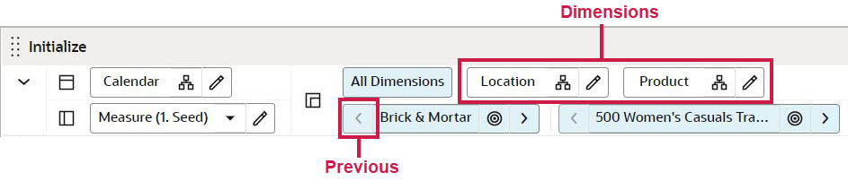

Click on the Dimension whose value (position) you want to change, as shown in Figure 8-2.
Click the Next or Previous arrow, as shown in Figure 8-2.
Figure 8-2 Changing a Dimension Level with Page Arrows

Select the half that you want to seed with Last Year (LY), Forecast (Fcst), or Portfolio Optimization data.
Before seeding with Portfolio Optimization data, you need to retrieve results from Portfolio Optimization using the Review Portfolio Optimization view.
Figure 8-3 Seeding Options
Click the Next arrow to view and seed the next department.
When you have selected all the data you want to seed, click Seed in the bottom right corner.
A confirmation message is displayed, stating that the data has been successfully seeded. Click OK.
After you have seeded, the view refreshes and the Last Seed Source and Last Seed Date measures contain the source and date of the last seed.

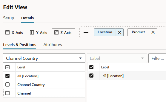

To change the level shown in the page edge or grid, complete the following steps:
Click the Edit View button of the dimension level you want to change.
Figure 8-4 Location Dimension Tile
The dimension window is displayed. Select the level of the dimension that you want to appear in the page edge. If you want to view more than one level at a time in the page edge or grid, select multiple levels. In Figure 8-5, Channel was deselected and all [Location] was selected instead.
Figure 8-5 Location Dimension Window
Click OK when finished.
Repeat Steps 1 through 3 for other dimensions if necessary.

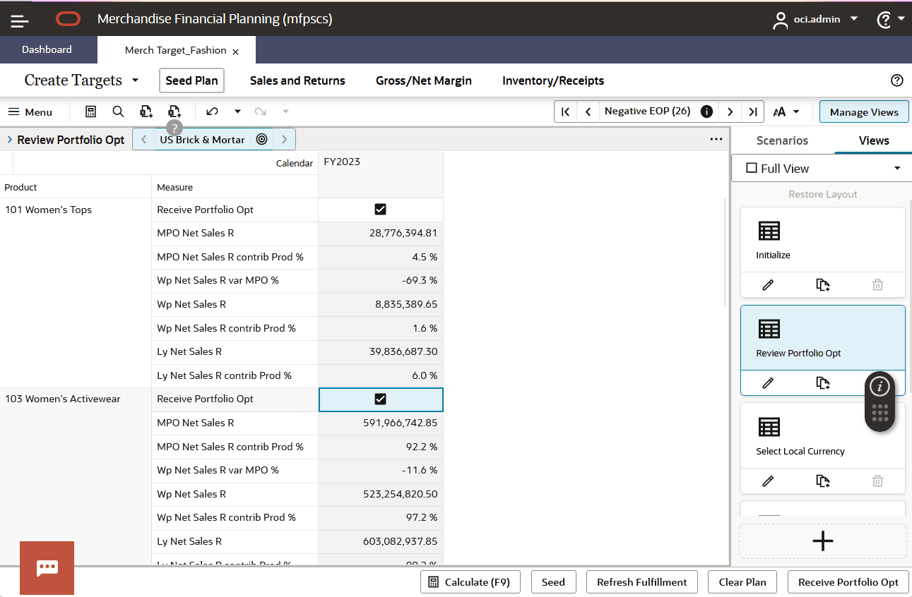

Review Portfolio Optimization View
The Portfolio Optimization output can be used for seeding the Merch Target Plan. Select the Boolean for dimension scope and click the custom menu action, Receive Portfolio Opt. After the results are populated against the MPO (Portfolio Optimization) measures, you can proceed with seeding the plan from the Initialize view. By default, MFP GA receives Net Sales R as output from Portfolio Optimization and it populates MPO Net Sales R in the view. The portfolio optimization results are retrieved at the year level which are then split into weeks using the LY data reference while seeding. You can choose to configure it for Gross Sales Portfolio Optimization output.
When creating the Merch Target workbook, the scope of the workbook should be at the same level of the scope of the Portfolio Optimization run.
Figure 8-7 Review Portfolio Optimization View

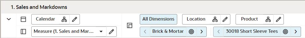

The second action within the Create Targets step is Sales/Markdowns. The number of views in the Sales and Markdowns action depends on your system settings. Typically, there is one view. However, if Wholesale/Franchise and/or the Local Currency options are enabled, then there are additional views.

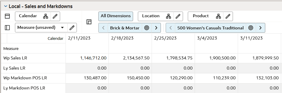

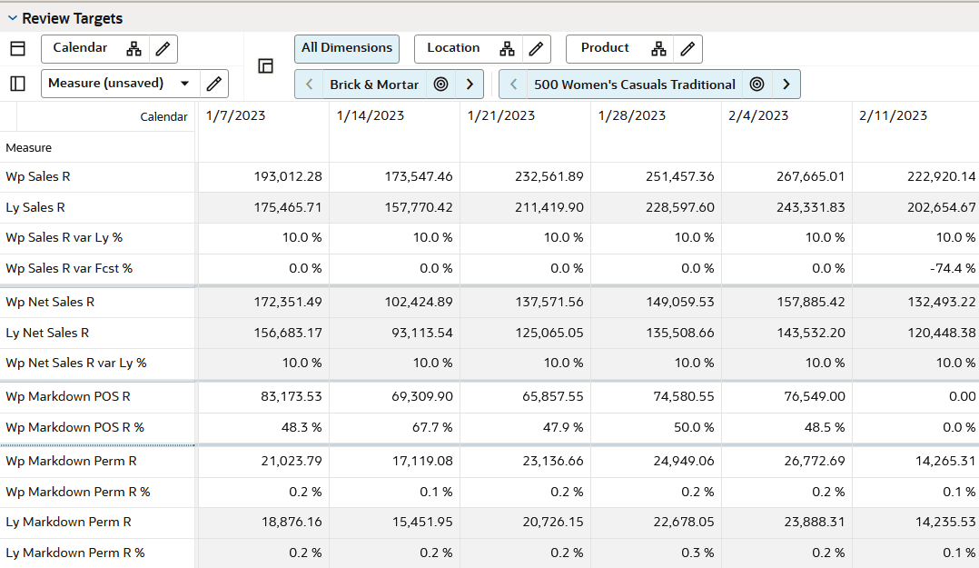

Sales and Markdowns View
In the Sales and Markdowns view, you plan net sales, promotions, and markdowns. Sales are the revenue generated by selling goods or services. Regular priced sales yield the greatest margin, however successful promotions drive more traffic and completion of sales. Though the promotional sale likely includes markdown, the overall increase in sales should outweigh the markdown and drive at good margins.
There are several measure profiles available to logically guide you through the plan variables.
A measure profile is selected by clicking on the Edit View button next to the Measure tile.
Figure 8-8 Edit View Button
The following measure profiles are available:
Sales and Markdowns (Default)
The measures in this profile represent totals which are not broken down by type of sale such as Promo, clearance, and so on. This view also incorporates the forecast for viewing on top of all Ly actuals.
Sales by Type
The measures in this profile display and capture sales and returns figures by type of sale: Regular + Promotional, and Clearance. Regular + Promo, and Clearance added together equate to the total sale or total return.
Start by planning the regular sales. Then, using your marketing calendar as a guide, align the promotional sales to the calendar. Refer to the calendar again for the exit weeks for the products, and plan the clearance sales for those weeks.
The planned figures for these sales types populates the Wp Sales R measure.

Follow these steps to basic sales and markdown generation:
Using the default measure profile, which is Sales and Markdowns, review and compare the total sales to the forecast and last year.
When building the targets for Wholesale/Franchise channels, plan Net Sales and then go directly to the W/F - Sales and Markdowns view.
Change the measure profile to Sales by Type.
In the Sales by Type measure profile, plan your sales by type. The sales types are Total Sales, Regular + Promo Sales, and Clearance Sales.
Return to the Sales and Markdowns measure profile.
With the total Wp Sales R populated, you can adjust the total to your target while still maintaining the relationships between the different sales types.
Change the measure profile to Markdown by Type. In the Markdown by Type profile, edit the Wp Markdown POS Reg+Promo R% to adjust the Wp Markdown POS Reg+Promo Rate.
Since sales and markdowns are both planned at the type level, you must first complete the sales by type planning before you can plan the markdowns by type.

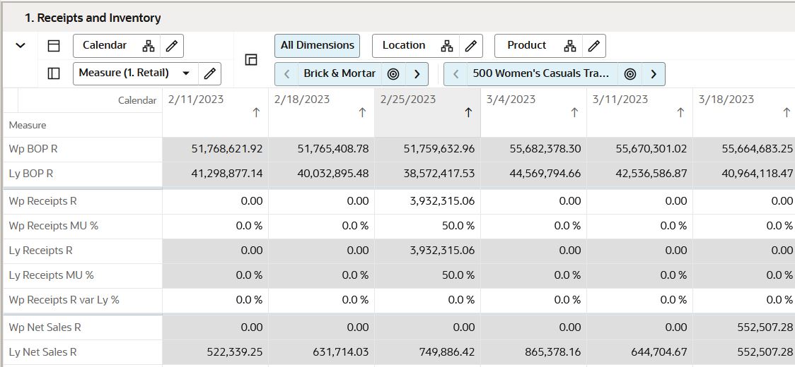

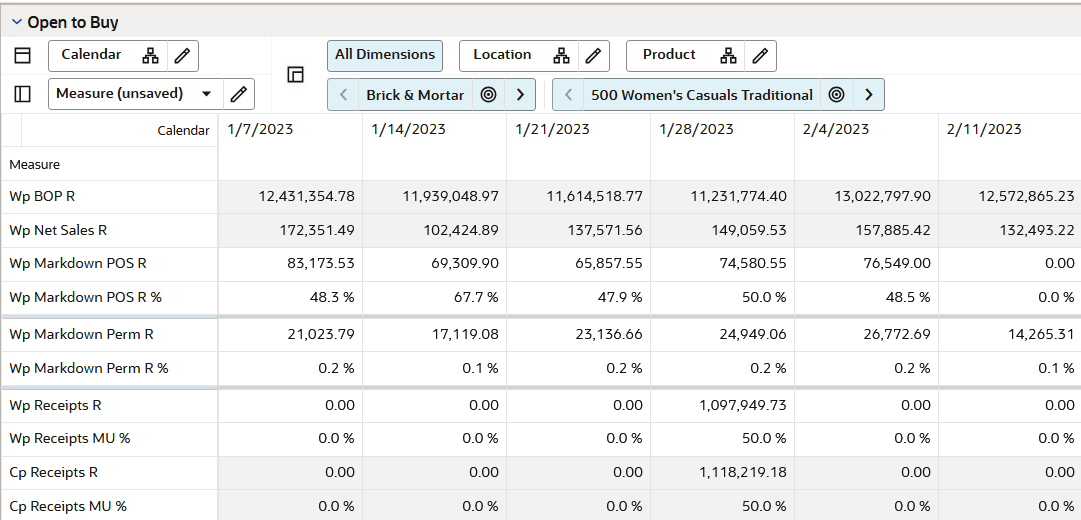

Receipts and Inventory View
Receipts and Inventory is where you will plan Beginning-of-period (BOP)/End-of-period (EOP) inventory, receipts, turn, and so on. This view is frequently planned at a month level. At a month level, EOP is usually targeted to be about the same as BOP and then ramp up for holiday gift giving is factored in. After planning the month, it is wise to review the results at a week level to ensure there are no undesirable anomalies.
Inventory turn is an important indicator of the effectiveness of the planned inventory. It tells you how many times stock is being sold and repurchased over a given period of time. The goal is to increase your turn as much as possible, without having to take markdowns. Turn (Wp CUM Turn R) is reviewed in this workspace view.
Another important indicator is Stock to Sales Ratio. The stock to sales ratio is the proportion of inventory on hand at the beginning of a period (such as a week or month) that will support the planned sales in that period.
If the Stock to Sales Ratio rises, (due to an increase in inventory without an accompanying rise in sales), then you are adding more stock without increasing sales. Unless you are intentionally ramping up stock for holiday, promo, and so on, then it is time to hold off on receipts and work on selling down the quantity on that item. The ultimate goal is to reduce your Stock to Sales Ratio as low as possible, without losing sales.

Use the following best practices to plan the receipts and inventory:
Plan the receipt flow and then evaluate the average inventory and turn.
Review the Receipts Markup (MU) for accuracy. Often this will follow the keystone 50%, but many variables can impact the decision on markup-from competitor pricing to freight costs, and overhead operating expense.
Review the Wp CMU % measure. Cumulative markup rate (CMU %) is a blend of the beginning of period (BOP) inventory retail and cost with the future receipt retail and receipt cost. The Wp CMU % directly affects the cost of goods sold (COGS), which then affects the gross margin.
Review the Wp Stock to Sales R ratio. Make adjustments to Sales and other inventory measures (Receipts, Move out of Stock, Move to Clr, and so on) to achieve the desired stock to sales ratio.
Figure 8-13 Receipts and Inventory View
Gross Margin Sub-Step
You build your plan with a close eye on gross margins and net gross margin. Gross Margin is a percentage (or ratio) of gross profit to net sales. Gross profit (expressed as Wp GM R) is the difference between net sales retail and Cost of Goods Sold (COGS). Gross margin and gross profit are very important measures of the profitability and financial performance of a company.
Gross Margin View
Use the Gross Margin view to evaluate the gross margin created from your sales and markdown plan and receipts and inventory plan. Determine whether the planned gross margin meets your gross margin goal. If it does not, return to the Develop Sales and Markdown Plan and Develop Inventory and Receipt Plan steps to adjust your receipt markups and receipt flow. Finally, return to the Gross Margin view to adjust additional contributors to net gross margin such as vendor funds and royalties.
Figure 8-15 Gross Margin View

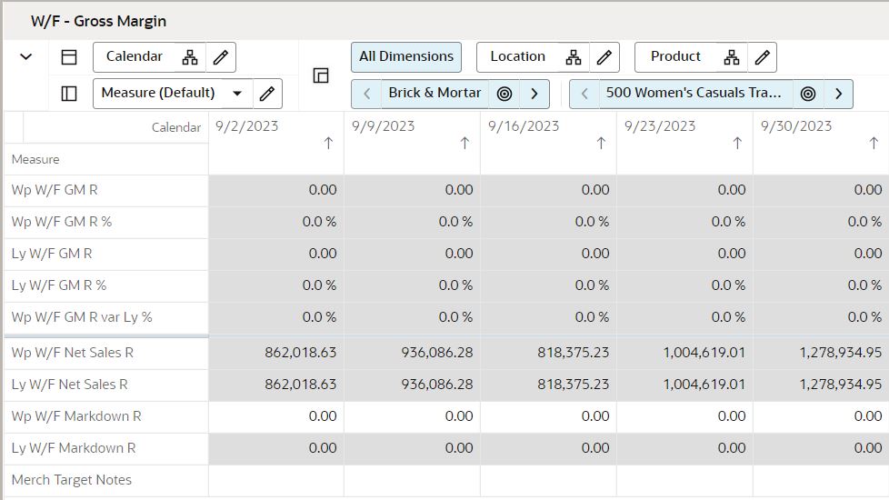

W/F - Gross Margin View
If the Wholesale Franchise option is provisioned, you plan W/F channels in this view.
Wholesale/Franchise sales are typically tracked and managed as a separate channel of a retail business. In the Wholesale/Franchise Gross Margin, you review the planned gross margin on your wholesale/franchise sales.
Figure 8-16 W/F - Gross Margin
Local - Gross Margin View
If the Local Currency option is provisioned, then there is an additional view to support planning Gross Margin.
The key planning KPIs contributing to gross margin are available in local currency for cross-referencing and high-level planning.
Figure 8-17 Local - Gross Margin

Review Targets Sub-Step
In this sub-step, review the targets you created in the previous step. If you need to alter the targets, return to the Create Targets step to make edits.
Review Targets View
There are several measure profiles in this view to quickly guide you to the plans you wish to review:
Default
This measure profile shows the main Working Plan metrics for comparison with last year metrics. This is the profile you will use after initially performing the Create Targets step.
Tgt with Cp
This measure profile shows the main Working Plan metrics for comparison with Current Plan metrics. Current Plan is a version of the plan that is approved in-season (and is actualized for elapsed/historical periods).
Tgt with Op
This measure profile shows the main Working Plan metrics for comparison with Original Plan metrics. Original Plan is the plan as it was initially approved-typically it got approved pre-season and stays fixed when the period becomes in-season.
Figure 8-18 Review Targets View
Publish Targets Sub-Step
Publishing a target copies the targets you built in the Wp measures to the target (Tgt) measures, and then commits them to the database. Once committed, Planners can retrieve those targets and take action planning to them.
The Tgt measures are shown in the Publish Targets view found in the Review and Publish Targets step. These measures initially have zero values. After the targets are published in this step, those measures are populated with the target information.
Publish Targets View
To publish the targets, complete the following steps.
Select the halves in the Wp Publish Targets measure that you want to publish.
If needed, enter relevant information in the Wp Publish Notes measure. This is optional.
Repeat Steps 1 and 2 for other channels and departments as desired.
Click Publish Targets. This button is located in the bottom right corner.
A success message is displayed. Click Dismiss to close it.
The view refreshes and clears the data in Wp Publish Targets and Wp Publish Notes measures. It populates the data for Tgt Publish Info measure as name:date:notes.
Figure 8-19 Publish Targets

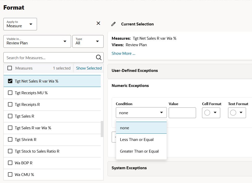

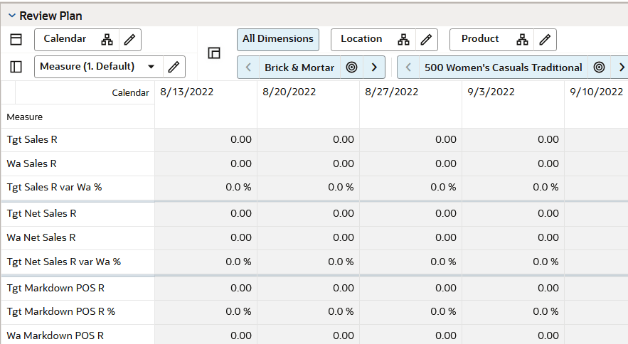

In the Review Plan sub-step, you directly compare the Planners Wa plan to the targets. There are several Tgt-to-Wa variance measures that quickly guide you to areas of difference.
Tip:
Use exception formatting on the variance measures to highlight variances. To reach the formatting dialog, right click the measure label and choose Format from the popup menu.
Figure 8-20 Format Dialog

Open to Buy Sub-Step
This sub-step has one view.
Open to Buy View
Use Open to Buy (OTB) to understand the variance between the planned and projected inventory levels. This variance is shown in the Wp OTB R measure. OTB indicate how many additional receipts can be purchased (or canceled) after projected sales and markdowns. Users should understand if their planned receipts keep them on the overall Cp EOP inventory plan. To understand the variance between the Cp EOP inventory plan and the Wp EOP inventory plan, reference the measure Wp EOP R var Cp%. Use this view to validate what OTB you have available and then start adjusting your plan. Then, confirm that your updates can be obtained given the OTB constraints you may have. Use the following best practices to adjust OTB:
To understand the difference between the current approved receipts and the net on order, compare Cp Receipts R to Wp Net On Order R.
If receipts are booked for upcoming (non-elapsed) periods, you can enter the Wp Receipt R data into the Wp On Order Adj R to capture the Wp OTB R measure. For example, this may occur if receipts book daily for the retailer, and OTB is completed on a Tuesday. By using the Wp On Order Adj measures, you can capture all receipts for comparing the Net On Order to the Cp receipt plan.
This view has two measure profiles:
Default
This measure profile focuses on key metrics of total sales, markdowns, receipts, and on order to summarize open to buy.
Units
This measure profile focuses on unit and average unit cost key metrics for sales, receipt, and on order.
Figure 8-23 Open to Buy View
