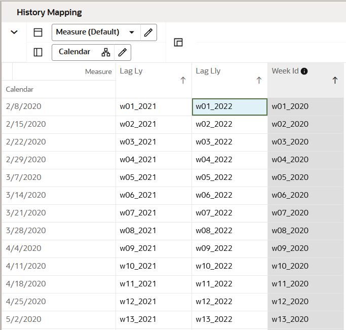

History Mapping View
When a new calendar year is loaded, these values are automatically populated for the new year by the weekly batch. Use this view to make any updates needed in week mapping to most accurately account for moving holidays, promotions, and also to set up 52 to 53 week mappings.
The last year's (Ly) mapping is used to identify which week to map to in order to Seed from Ly, and review Ly values in a workspace.
The last last year (Lly) is used to identify which week to map to for reviewing history from two years prior in a workspace.
A week can be mapped to more than one Ly or Lly week to account for 53 week years. Separate weeks with a comma. If more than one week needs to be assigned, then those week positions should be separated with a space. Those week positions data will then be aggregated.
Figure 4-1 History Mapping View
Table 4-1 History Mapping View Measures
Measure Description
Lag Ly
Identifies the week used for mapping as adjusted last year.
Lag Lly
Identifies the week that is being used for mapping as last last year (two years ago).
Week ID
Identifies the internal week position for the current week for reference. This is useful for copying week positions when manually setting Lag Ly and Lag Lly.

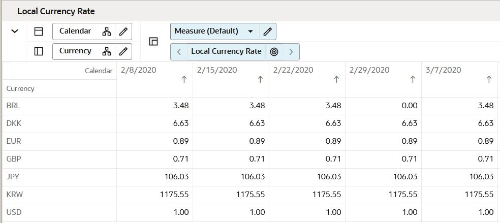

Local Currency Rate View
Within this view, you set the local currency conversion rate for each Channel by Week. The conversion rate is set in relation to the sales currency, often the corporate currency.
Figure 4-2 Local Currency Rate View
Table 4-2 Local Currency Rate View Measure
Measure Description
Local Currency Rate
The rate used to convert values from the primary currency to the local currency for a given Channel/Week.

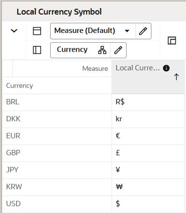

Local Currency Symbol View
Within this view, the planning administrator sets the local currency symbol for each channel. This currency symbol can be included as the Location attribute in all Local Currency views.
For example, in Figure 4-3 the BRA Brick & Mortar channel has R$ as its local currency symbol, which indicates that local currency values for this channel are in Brazilian Real. All local currency BRA Brick & Mortar monetary values are displayed with R$.
Figure 4-3 Local Currency Symbol View
Table 4-3 Local Currency Symbol View Measure
Measure Description
The graphic symbol associated with the channel's local currency.

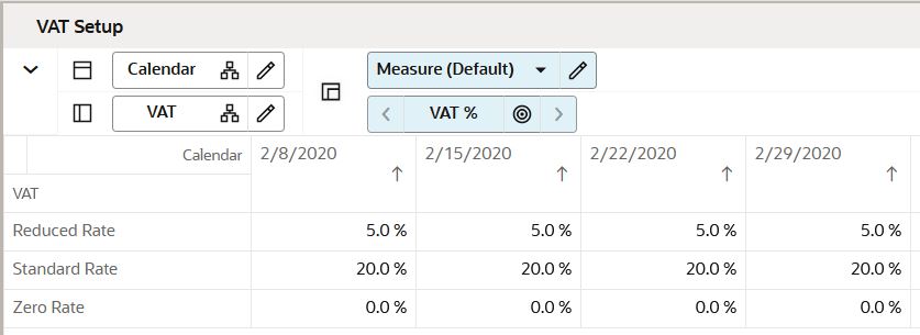

VAT Setup View
In this view, the planning administrator inputs the VAT% (sales) and VAT C % (cost rate).
When planning sales retail, the VAT% rate is applied to gross sales and then returns are subtracted to calculate net sales. If no VAT% rate is planned, then net sales are simply determined as gross sales less returns.
VAT Rate% is stored at Week/Subclass/Channel.
Figure 4-4 VAT Setup View
VAT Setup View
Table 4-4 VAT Setup View Measures
Measure Description
VAT%
The default Value Added Tax (VAT) rate percentage applied to sales. This value should be set if there are taxes that are applied to the sale of goods.
VAT C %
The Value Added Tax rate percentage for the cost of goods. This value should be set if there are taxes that are applied on the purchase of goods.

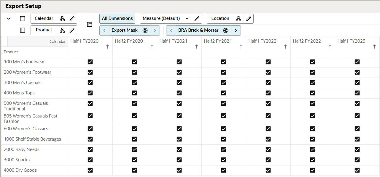

Export Setup View
Within this view, the planning administrator selects the positions that will be included when exporting plan data for all versions.
Figure 4-5 Export Setup View
Export Setup View
Table 4-6 Export Setup View Measure
Measure Description
Export Mask
Allows the user to control which positions are exported for all plan versions. When selected, the Department/Channel/Half is included when exporting plan data. By default, this Boolean is checked for all positions. If the user wants to exclude any Department/Channel/Half from exporting, you must clear this Boolean.
The export flags are set based on Export Mask and Approved or Submitted Info for Approved or Submitted Plans and Seeded Info for Working Plans.

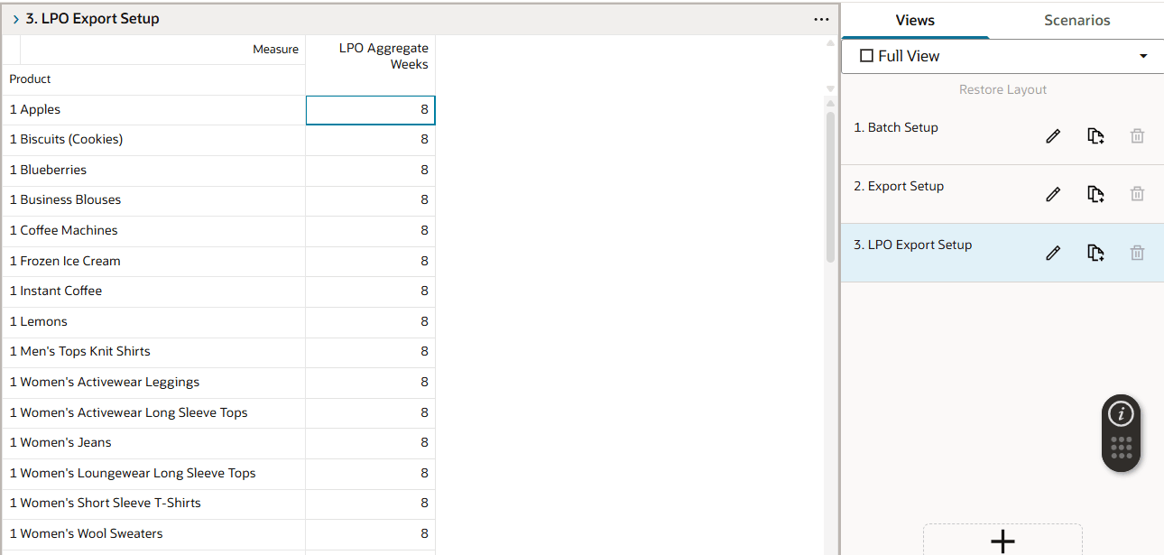

LPO Export Setup View
The LPO Export Setup view allows admin users to define the number of weeks used to aggregate permanent markdown values for each subclass. By default, the value is set to 8 weeks, but users can update it as needed. The configured value determines the rolling week range over which permanent markdown is aggregated for export to LPO.
Figure 4-6 LPO Export Setup View
