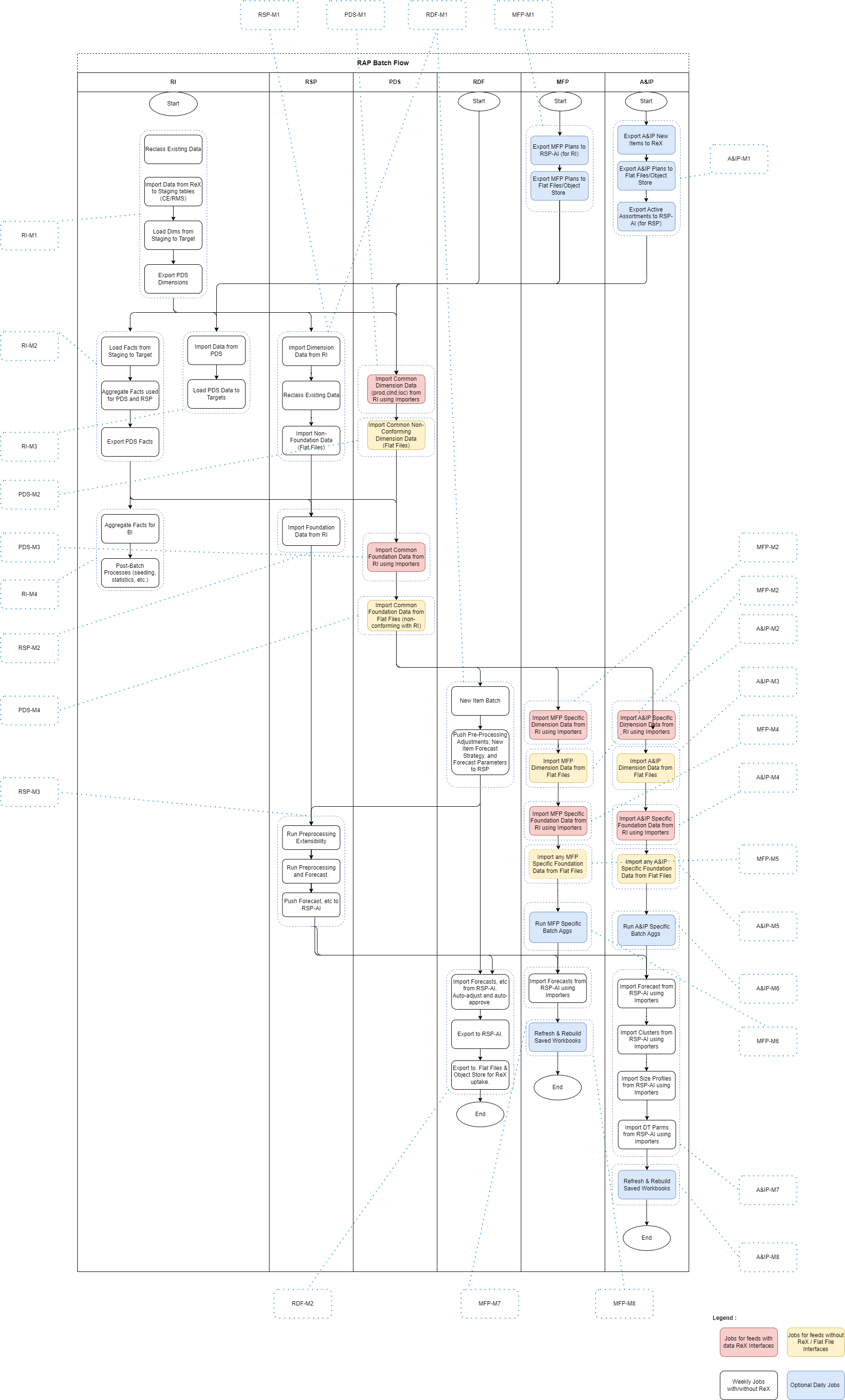

All applications on the Retail Analytics and Planning have either a nightly or weekly batch schedule. Periodic batches allow the applications to move large amounts of data during off-peak hours. They can perform long-running calculations and analytical processes that cannot be completed while users are in the system, and close out the prior business day in preparation for the next one.
To ensure consistency across the platform, all batch schedules have some level of interdependencies established, where jobs of one application require processes from another schedule to complete successfully before they can begin. The flow diagram below provides a high-level view of schedule dependencies and process flows across RAP modules.
Figure 5-1 Batch Process High-Level Flow
The frequency of batches will vary by application. However, the core data flow through the platform must execute nightly. This includes data extraction from RMS by way of RDE (if used) and data loads into Retail Insights and AI Foundation.
Downstream applications from Retail Insights, such as Merchandise Financial Planning, may only execute the bulk of their jobs on a weekly basis. This does not mean the schedule itself can run weekly (as MFP batch has been run in previous versions); those end-of-week processes now rely on consumption and transformations of data happening in nightly batches. For example, Retail Insights consumes sales and inventory data on a daily basis. However, the exports to Planning (and subsequent imports in those applications) are only run at the end of the week, and are cumulative for all the days of data up to that point in the week.
For this reason, assume that most of the data flow and processing that is happening within the platform will happen every day and plan your file uploads and integrations with non-Oracle systems accordingly.

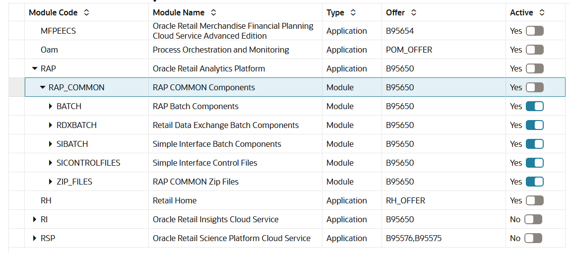

These files will be bundled into a single ZIP file named RAP_DATA.zip. To configure the Customer Modules
for this batch implementation, perform the following steps:
At the top level, you may disable the RI module entirely (if it’s visible), because you are not implementing that solution
Enable and expand the RAP module. Within the
RAP_COMMONsub-module, enable only the following components and disable the rest:-
RAP>RAP_COMMON>ZIP_FILES: RAP_DATA_ZIP
RAP>RAP_COMMON>SICONTROLFILES: RAP_SI_DIM_CALENDAR, RAP_SI_DIM_EXCHANGE_RATES, RAP_SI_DIM_ONORDER, RAP_SI_DIM_ORGANIZATION, RAP_SI_DIM_PRODUCT, RAP_SI_FACT_ADJUSTMENT, RAP_SI_FACT_INVENTORY, RAP_SI_FACT_MARKDOWN, RAP_SI_FACT_ORDER_DETAIL, RAP_SI_FACT_RECEIPT, RAP_SI_FACT_RTV, RAP_SI_FACT_SALES, RAP_SI_FACT_TRANSFER
RAP>RAP_COMMON>SIBATCH: RAP_SI_INVADJ, RAP_SI_INVPOS, RAP_SI_INVRECEIPT, RAP_SI_INVRTV, RAP_SI_INVTRANSFER, RAP_SI_MARKDOWN, RAP_SI_ONORDER, RAP_SI_PO, RAP_SI_REQUIRED, RAP_SI_SALES
RAP>RAP_COMMON>RDXBATCH: RAP_RDX_INVADJ, RAP_RDX_INVPOS, RAP_RDX_INVECEIPT, RAP_RDX_INVRTV, RAP_RDX_INVTRANSFER, RAP_RDX_MARKDOWN, RAP_RDX_PO, RAP_RDX_REQUIRED, RAP_RDX_SALES
RAP>RAP_COMMON>BATCH: RAP_INVADJ, RAP_INVPOS, RAP_INVRECEIPT, RAP_INVRTV, RAP_INVTRANSFER, RAP_MARKDOWN, RAP_PO, RAP_REQUIRED, RAP_SALES
To use AIF for forecasting, you will also need certain parts of the AI Foundation modules (named RSP in Retail Home). Enable the RSP root module, expand it, and enable the FCST module. All options under FCST should also be enabled. Disable all other RSP modules here.
If you are integrating with Merchandising using the RDE batch jobs, then you are likely not providing flat files for most things, and the setup process will be different. Refer to Integration with Merchandising to understand the batch setup process in more detail.
Once all changes are made, make sure to Save the updates using the button below the table. Only after saving the changes will they be available to sync with POM.

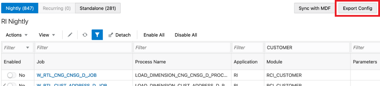

POM allows you to export the full batch schedule configuration to a spreadsheet for review. This is an easier way to see all of the jobs, processes, and dependencies that exist across all batch schedules that you are working with on the platform. Perform the following steps to access batch configuration details:
From Retail Home, click the link to navigate to POM, or go to the POM URL directly if known. Log in as a batch administrator user.
Navigate to the Batch Administration screen.
Select the desired application tile, and then select the schedule type from the nightly, recurring, or standalone options.

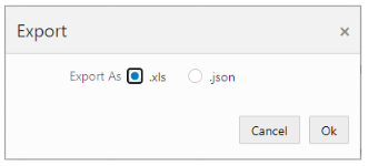

Click the Export Config button to download the schedule data.
Choose your preferred format (XLS or JSON).
XLS is meant for reviewing it visually.
JSON is used for importing the schedule to another environment.
Save the file to disk and open it to review the contents.
For more details about the tabs in the resulting XLS file, refer to the POM User Guide, “Export/Import Schedule Configuration”.
