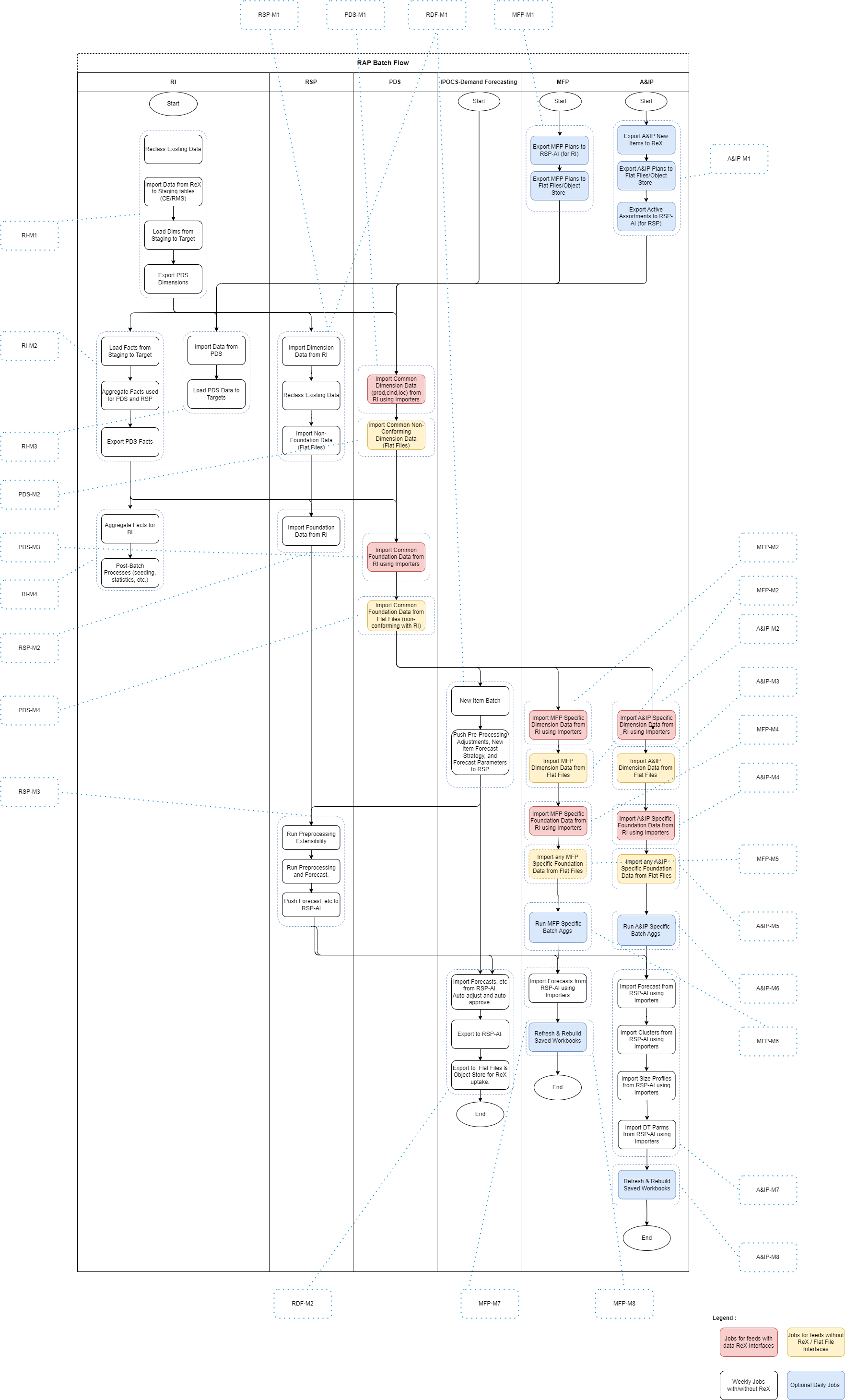

Overview
All applications on the Retail Analytics and Planning have either a nightly or weekly batch schedule. Periodic batches allow the applications to move large amounts of data during off-peak hours. They can perform long-running calculations and analytical processes that cannot be completed while users are in the system, and close out the prior business day in preparation for the next one.
To ensure consistency across the platform, all batch schedules have some level of interdependencies established, where jobs of one application require processes from another schedule to complete successfully before they can begin. The flow diagram below provides a high-level view of schedule dependencies and process flows across RAP modules.
Figure 5-1 Batch Process High-Level Flow
The frequency of batches will vary by application. However, the core data flow through the platform must execute nightly. This includes data extraction from RMS by way of RDE (if used) and data loads into Retail Insights and AI Foundation.
Downstream applications from Retail Insights, such as Merchandise Financial Planning, may only execute the bulk of their jobs on a weekly basis. This does not mean the schedule itself can run weekly (as MFP batch has been run in previous versions); those end-of-week processes now rely on consumption and transformations of data happening in nightly batches. For example, Retail Insights consumes sales and inventory data on a daily basis. However, the exports to Planning (and subsequent imports in those applications) are only run at the end of the week, and are cumulative for all the days of data up to that point in the week.
For this reason, assume that most of the data flow and processing that is happening within the platform will happen every day and plan your file uploads and integrations with non-Oracle systems accordingly.
While much of the batch process has been automated and pre-configured in POM, there are still several activities that need to be performed which are specific to each implementation. TheTable 5-1 table summarizes these activities and the reasons for doing them. Additional details will be provided in subsequent sections of this document

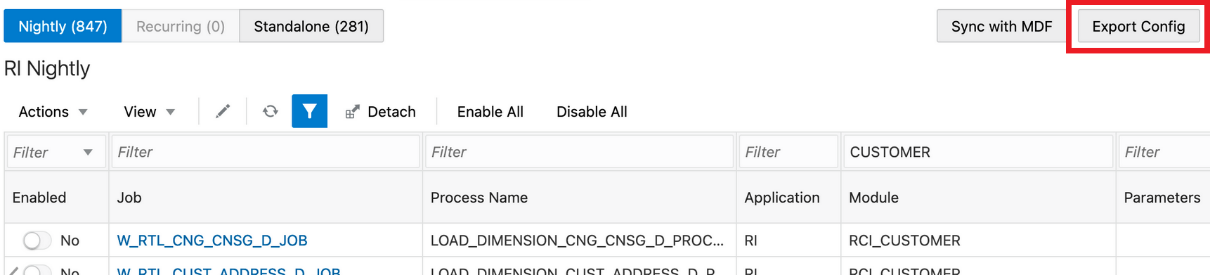

It is possible to export the batch schedules from POM to review process/job mappings, job dependencies, inter-schedule dependencies, and other details. This can be very useful when deciding which processes to enable in a flow or when debugging fails at specific steps in the process, and how that impacts downstream processing.

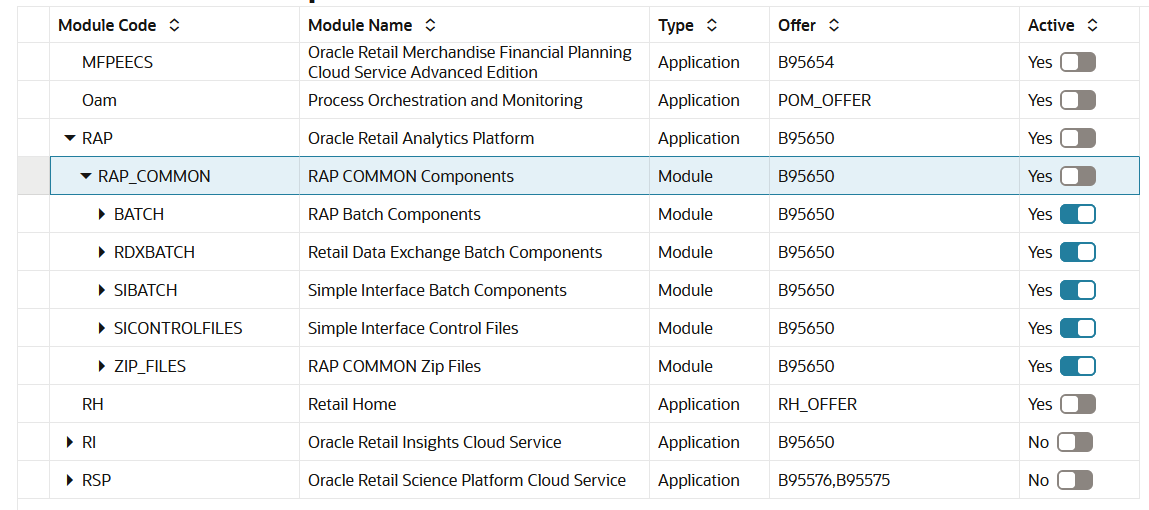

These files will be bundled into a single ZIP file named RAP_DATA.zip. To configure the Customer Modules for this batch implementation, perform the following steps:
  1. At the top level, you may disable the RI module entirely (if it’s visible), because you are not implementing that solution
  2. Enable and expand the RAP module. Within the RAP_COMMON sub-module, enable only the following components and disable the rest:
    • RAP>RAP_COMMON>ZIP_FILES: RAP_DATA_ZIP
    • RAP>RAP_COMMON>SICONTROLFILES: RAP_SI_DIM_CALENDAR, RAP_SI_DIM_EXCHANGE_RATES, RAP_SI_DIM_ONORDER, RAP_SI_DIM_ORGANIZATION, RAP_SI_DIM_PRODUCT, RAP_SI_FACT_ADJUSTMENT, RAP_SI_FACT_INVENTORY, RAP_SI_FACT_MARKDOWN, RAP_SI_FACT_ORDER_DETAIL, RAP_SI_FACT_RECEIPT, RAP_SI_FACT_RTV, RAP_SI_FACT_SALES, RAP_SI_FACT_TRANSFER
    • RAP>RAP_COMMON>SIBATCH: RAP_SI_INVADJ, RAP_SI_INVPOS, RAP_SI_INVRECEIPT, RAP_SI_INVRTV, RAP_SI_INVTRANSFER, RAP_SI_MARKDOWN, RAP_SI_ONORDER, RAP_SI_PO, RAP_SI_REQUIRED, RAP_SI_SALES
    • RAP>RAP_COMMON>RDXBATCH: RAP_RDX_INVADJ, RAP_RDX_INVPOS, RAP_RDX_INVECEIPT, RAP_RDX_INVRTV, RAP_RDX_INVTRANSFER, RAP_RDX_MARKDOWN, RAP_RDX_PO, RAP_RDX_REQUIRED, RAP_RDX_SALES
    • RAP>RAP_COMMON>BATCH: RAP_INVADJ, RAP_INVPOS, RAP_INVRECEIPT, RAP_INVRTV, RAP_INVTRANSFER, RAP_MARKDOWN, RAP_PO, RAP_REQUIRED, RAP_SALES
  3. To use AIF for forecasting, you will also need certain parts of the AI Foundation modules (named RSP in Retail Home). Enable the RSP root module, expand it, and enable the FCST module. All options under FCST should also be enabled. Disable all other RSP modules here.
  4. If you are integrating with Merchandising using the RDE batch jobs, then you are likely not providing flat files for most things, and the setup process will be different. Refer to Integration with Merchandising to understand the batch setup process in more detail.
Once all changes are made, make sure to Save the updates using the button below the table. Only after saving the changes will they be available to sync with POM.

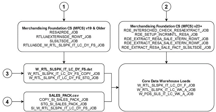

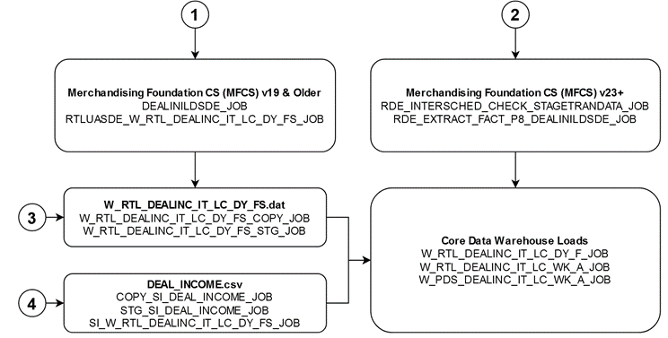

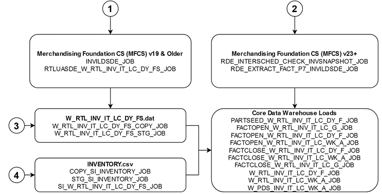

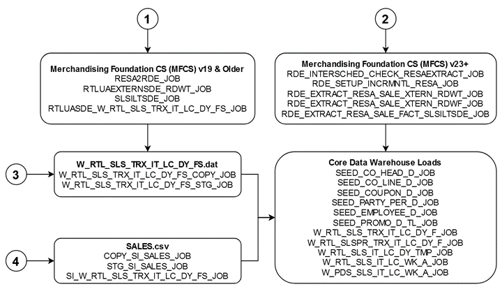

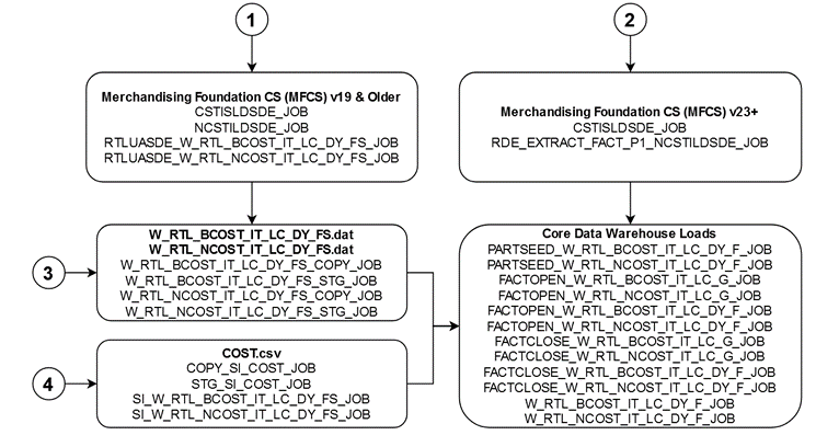

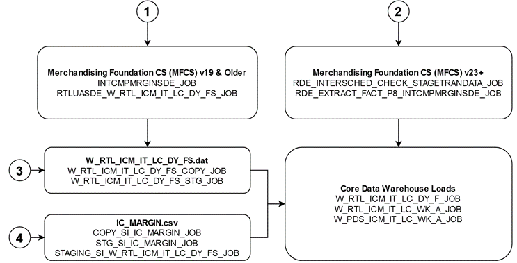

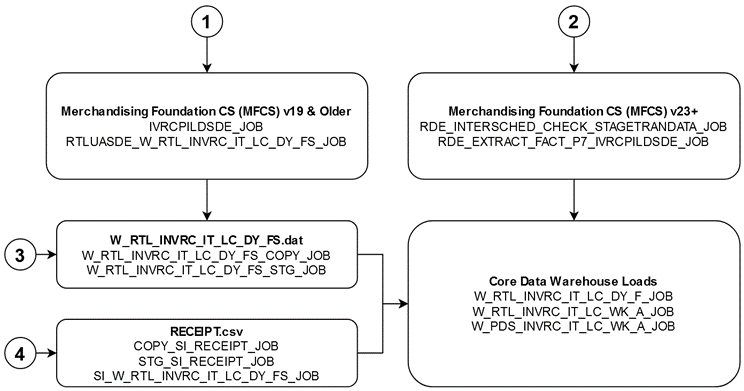

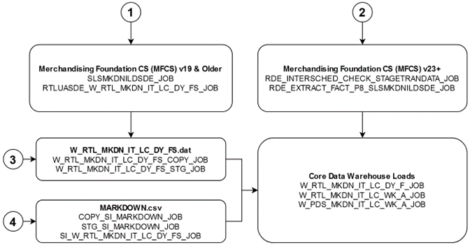

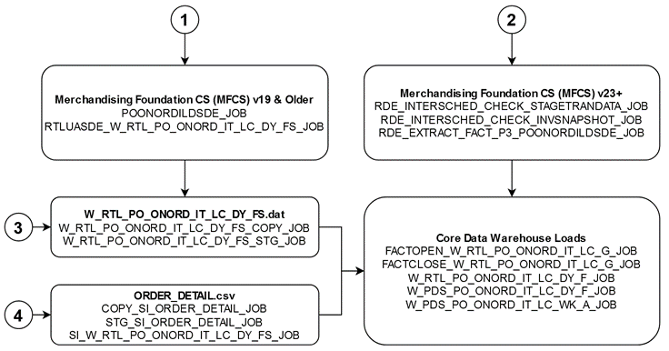

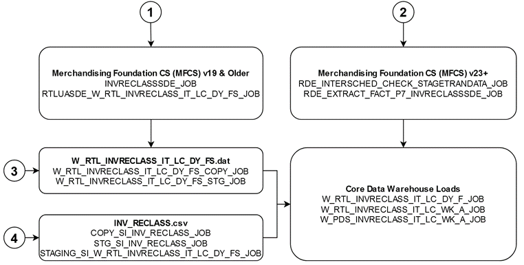

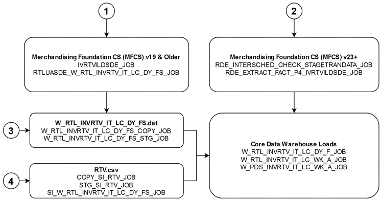

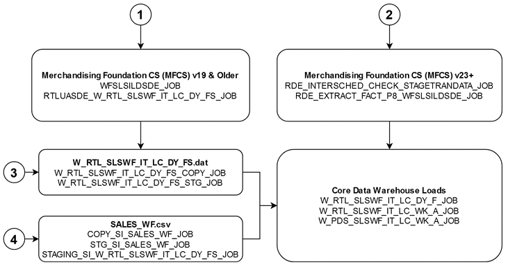

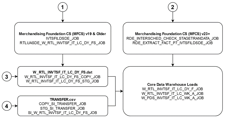

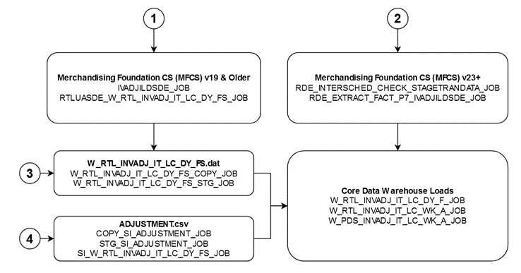

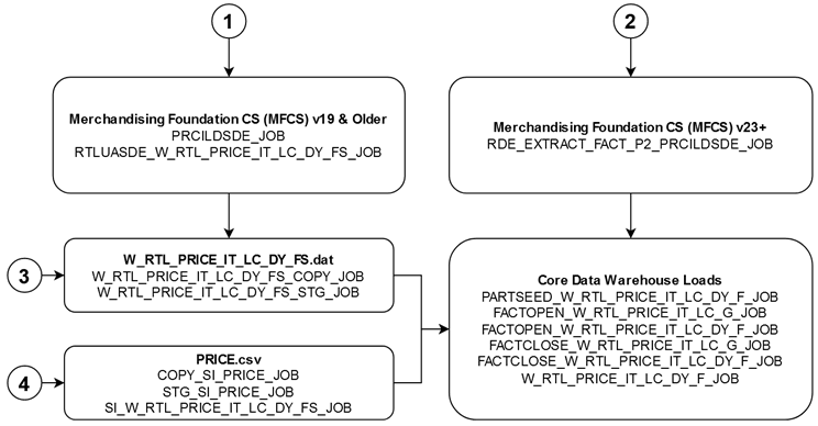

Some implementations require sourcing fact data from more than one source. For example, your inventory data may be coming from Merchandising Foundation CS (MFCS) but your sales data will come from an external 3rd-party application. In such cases, it will be necessary to manually configure your batch schedule for AIF DATA to selectively enable the jobs for your chosen data flow and disable all other paths for that data. The diagrams in this section highlight each possible data flow from an outside source into the AIF DATA data warehouse.
Each numbered entry point into the data flow is mutually exclusive, you cannot run multiple data flows at the same time or it can result in duplicated or invalid data being loaded. For example, if you are entering the diagram from point 1, you would want to ensure all AIF DATA jobs along that path are enabled, and also disable the jobs for unused entry points (2 and 4). The entry points in every diagram are explained in more detail below.
Entry Point Explanation
1
This is the data flow for Retail Data Extractor for MFCS v19 or earlier. In this flow, RDE is a separate module that runs on the MFCS server and POM instance and creates flat files to export to AIF DATA. This data flow includes on-premise instances of MFCS/RDE.
2
This is the data flow for Retail Data Extractor for MFCS v23 or later. In this flow, RDE jobs are a part of the AIF DATA batch schedule and will directly read from MFCS and insert to AIF DATA staging tables without using any files.
3
This is the data flow for legacy AIF DATA flat file formats, which use the same file structures as RDE v19 or earlier. New implementations will generally not use this entry point for foundation fact data.
4
This is the data flow for simplified foundation interfaces in RAP v23 or later that use CSV file formats. When data is not coming from MFCS, it should usually enter here.
Adjustments
This is the data flow diagram for inventory adjustment transactions. Enable only the jobs for your chosen load method and disable the jobs for all other entry points.
Adjustments Diagram
Costs
This is the data flow diagram for base cost and net costs. Enable only the jobs for your chosen load method and disable the jobs for all other entry points.
Costs Diagram
Deal Income
This is the data flow diagram for deal income transactions. Enable only the jobs for your chosen load method and disable the jobs for all other entry points.
Deal Income Diagram
Intercompany Margin
This is the data flow diagram for intercompany margin transactions. Enable only the jobs for your chosen load method and disable the jobs for all other entry points.
Intercompany Margin Diagram
Inventory Position
This is the data flow diagram for inventory positions. Enable only the jobs for your chosen load method and disable the jobs for all other entry points.
Inventory Position Diagram
Inventory Reclass
This is the data flow diagram for inventory reclass transactions. Enable only the jobs for your chosen load method and disable the jobs for all other entry points.
Inventory Reclass Diagram
Markdowns
This is the data flow diagram for markdown transactions. Enable only the jobs for your chosen load method and disable the jobs for all other entry points.
Markdowns Diagram
Prices
This is the data flow diagram for daily price updates. Enable only the jobs for your chosen load method and disable the jobs for all other entry points.
Prices Diagram
Purchase Orders
This is the data flow diagram for purchase order updates. Enable only the jobs for your chosen load method and disable the jobs for all other entry points.
Purchase Orders Diagram
Receipts
This is the data flow diagram for inventory receipt transactions. Enable only the jobs for your chosen load method and disable the jobs for all other entry points.
Receipts Diagram
Returns to Vendor
This is the data flow diagram for inventory returns to vendor. Enable only the jobs for your chosen load method and disable the jobs for all other entry points.
Returns to Vendor Diagram
Sales
This is the data flow diagram for sales transactions. Enable only the jobs for your chosen load method and disable the jobs for all other entry points.
Sales Diagram

Sales Wholesale
This is the data flow diagram for wholesale and franchise sales transactions. Enable only the jobs for your chosen load method and disable the jobs for all other entry points.
Sales Wholesale Diagram
Transfers
This is the data flow diagram for inventory transfer transactions. Enable only the jobs for your chosen load method and disable the jobs for all other entry points.
Transfers Diagram

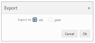

POM allows you to export the full batch schedule configuration to a spreadsheet for review. This is an easier way to see all of the jobs, processes, and dependencies that exist across all batch schedules that you are working with on the platform. Perform the following steps to access batch configuration details:
  1. From Retail Home, click the link to navigate to POM, or go to the POM URL directly if known. Log in as a batch administrator user.
  2. Navigate to the Batch Administration screen.
  3. Select the desired application tile, and then select the schedule type from the nightly, recurring, or standalone options.
  4. Click the Export Config button to download the schedule data.
    Export Config Button
  5. Choose your preferred format (XLS or JSON).
    • XLS is meant for reviewing it visually.
    • JSON is used for importing the schedule to another environment.
  6. Save the file to disk and open it to review the contents.
    Export Config Window
For more details about the tabs in the resulting XLS file, refer to the POM User Guide, “Export/Import Schedule Configuration”.
