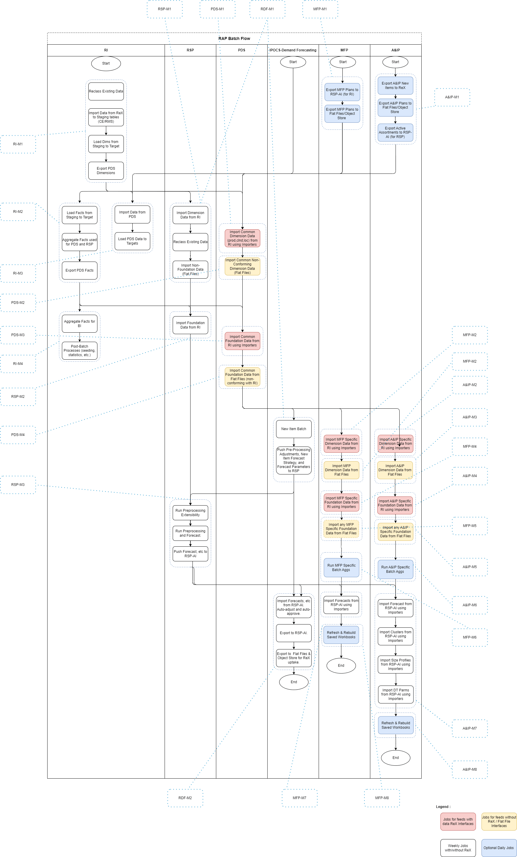

To ensure consistency across the platform, all batch schedules have some level of interdependencies established, where jobs of one application require processes from another schedule to complete successfully before they can begin. The flow diagram below provides a high-level view of schedule dependencies and process flows across RAP modules.
Figure 5-1 Batch Process High-Level Flow
The frequency of batches will vary by application. However, the core data flow through the platform must execute nightly. This includes data extraction from RMS by way of RDE (if used) and data loads into Retail Insights and AI Foundation.

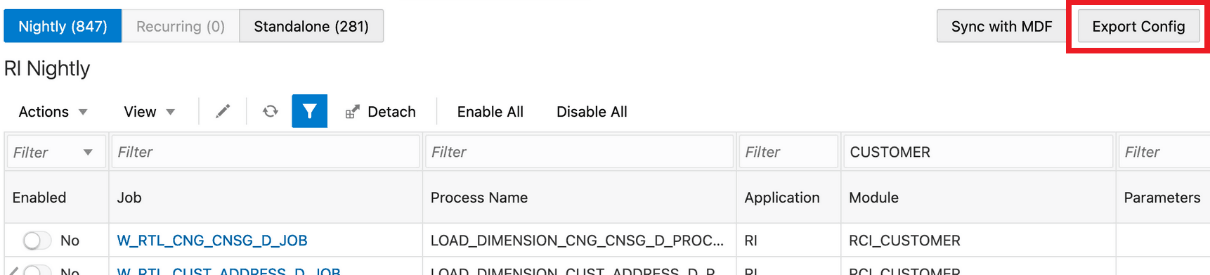

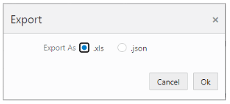

It is possible to export the batch schedules from POM to review process/job mappings, job dependencies, inter-schedule dependencies, and other details. This can be very useful when deciding which processes to enable in a flow or when debugging fails at specific steps in the process, and how that impacts downstream processing. |

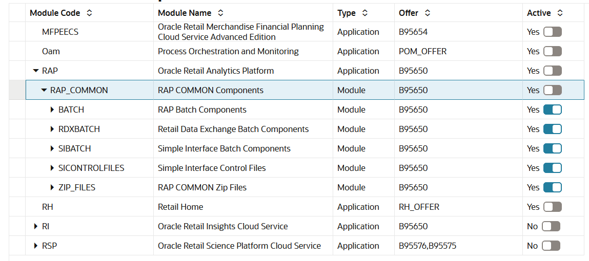

When using POM and Customer Modules Management, it is required to enable or disable the application components based on implementation needs. The sections below describe which modules are needed to leverage the core integrations between applications on the platform. If a module is not present in the below lists, then it is only useful if you are implementing that specific application and require that specific functionality. For example, most modules within Retail Insights are not required for the platform as a whole and can be disabled if you do not plan to implement RI.
After you make changes to the modules, make sure to synchronize your batch schedule in POM following the steps in Implementation Tools. If you are unsure whether a module should be enabled or not, you can initially leave it enabled and then disable jobs individually from POM as needed.

At the top level, you may disable the RI module entirely (if it’s visible), because you are not implementing that solution
Enable and expand the RAP module. Within the
RAP_COMMONsub-module, enable only the following components and disable the rest:-
RAP>RAP_COMMON>ZIP_FILES: RAP_DATA_ZIP
RAP>RAP_COMMON>SICONTROLFILES: RAP_SI_DIM_CALENDAR, RAP_SI_DIM_EXCHANGE_RATES, RAP_SI_DIM_ONORDER, RAP_SI_DIM_ORGANIZATION, RAP_SI_DIM_PRODUCT, RAP_SI_FACT_ADJUSTMENT, RAP_SI_FACT_INVENTORY, RAP_SI_FACT_MARKDOWN, RAP_SI_FACT_ORDER_DETAIL, RAP_SI_FACT_RECEIPT, RAP_SI_FACT_RTV, RAP_SI_FACT_SALES, RAP_SI_FACT_TRANSFER
RAP>RAP_COMMON>SIBATCH: RAP_SI_INVADJ, RAP_SI_INVPOS, RAP_SI_INVRECEIPT, RAP_SI_INVRTV, RAP_SI_INVTRANSFER, RAP_SI_MARKDOWN, RAP_SI_ONORDER, RAP_SI_PO, RAP_SI_REQUIRED, RAP_SI_SALES
RAP>RAP_COMMON>RDXBATCH: RAP_RDX_INVADJ, RAP_RDX_INVPOS, RAP_RDX_INVECEIPT, RAP_RDX_INVRTV, RAP_RDX_INVTRANSFER, RAP_RDX_MARKDOWN, RAP_RDX_PO, RAP_RDX_REQUIRED, RAP_RDX_SALES
RAP>RAP_COMMON>BATCH: RAP_INVADJ, RAP_INVPOS, RAP_INVRECEIPT, RAP_INVRTV, RAP_INVTRANSFER, RAP_MARKDOWN, RAP_PO, RAP_REQUIRED, RAP_SALES
To use AIF for forecasting, you will also need certain parts of the AI Foundation modules (named RSP in Retail Home). Enable the RSP root module, expand it, and enable the FCST module. All options under FCST should also be enabled. Disable all other RSP modules here.
If you are integrating with Merchandising using the RDE batch jobs, then you are likely not providing flat files for most things, and the setup process will be different. Refer to Integration with Merchandising to understand the batch setup process in more detail.
Once all changes are made, make sure to Save the updates using the button below the table. Only after saving the changes will they be available to sync with POM.

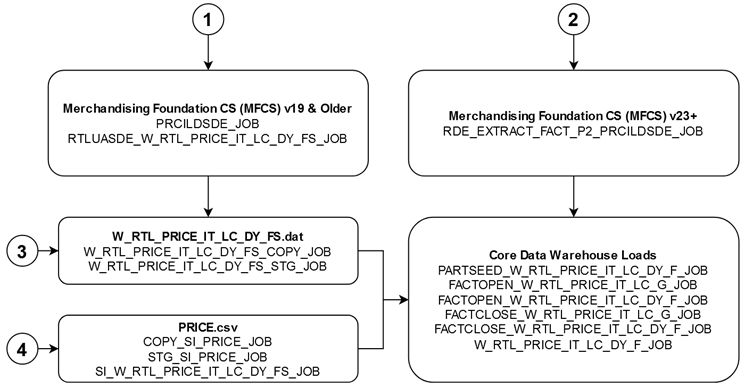

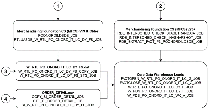

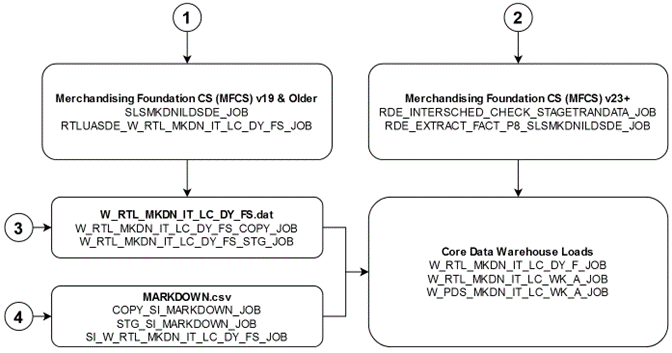

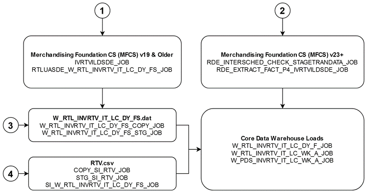

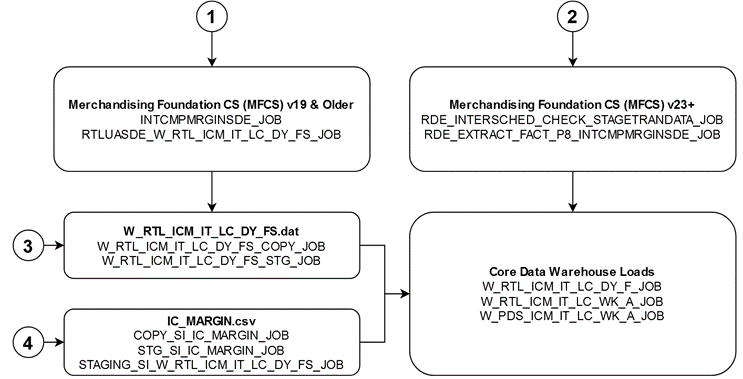

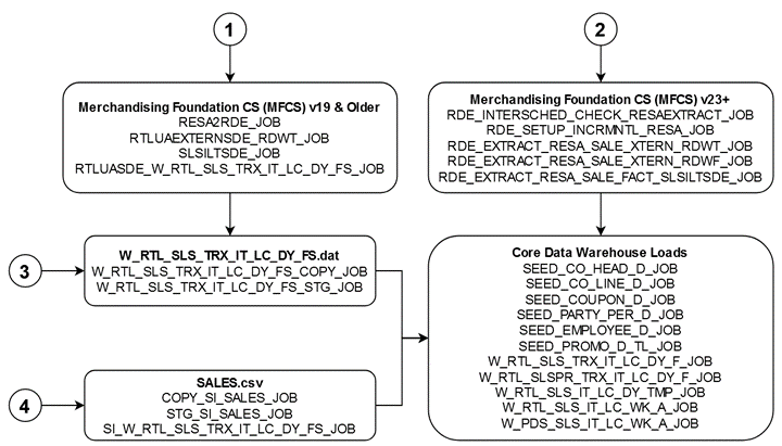

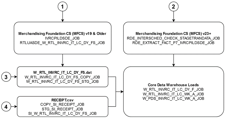

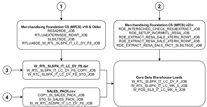

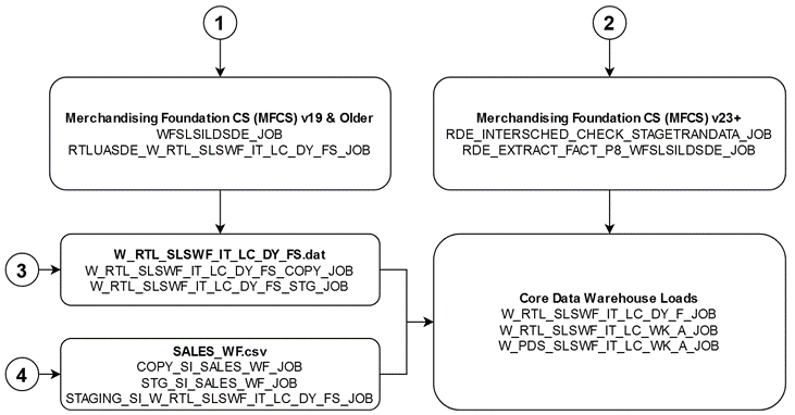

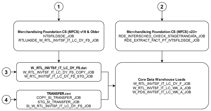

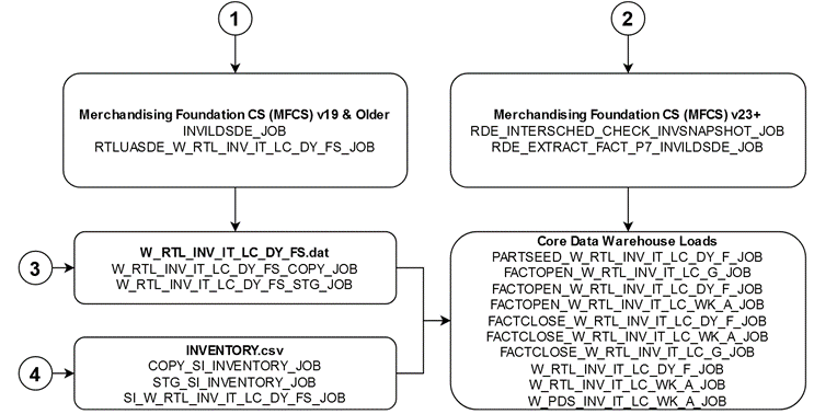

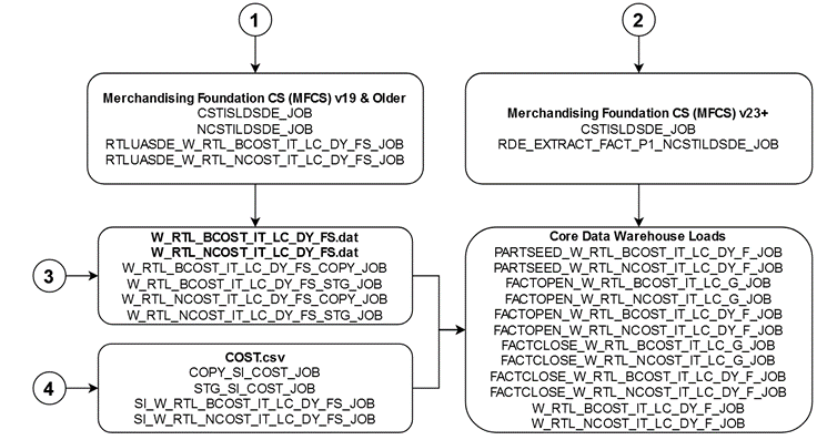

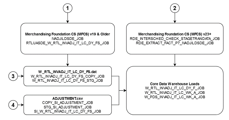

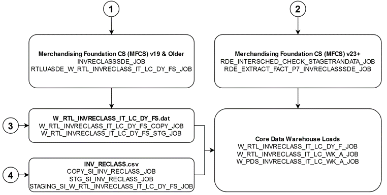

Some implementations require sourcing fact data from more than one source. For example, your inventory data may be coming from Merchandising Foundation CS (MFCS) but your sales data will come from an external 3rd-party application. In such cases, it will be necessary to manually configure your batch schedule for AIF DATA to selectively enable the jobs for your chosen data flow and disable all other paths for that data. The diagrams in this section highlight each possible data flow from an outside source into the AIF DATA data warehouse.
Each numbered entry point into the data flow is mutually exclusive, you cannot run multiple data flows at the same time or it can result in duplicated or invalid data being loaded. For example, if you are entering the diagram from point 1, you would want to ensure all AIF DATA jobs along that path are enabled, and also disable the jobs for unused entry points (2 and 4). The entry points in every diagram are explained in more detail below.
| Entry Point | Explanation |
1 |
This is the data flow for Retail Data Extractor for MFCS v19 or earlier. In this flow, RDE is a separate module that runs on the MFCS server and POM instance and creates flat files to export to AIF DATA. This data flow includes on-premise instances of MFCS/RDE. |
2 |
This is the data flow for Retail Data Extractor for MFCS v23 or later. In this flow, RDE jobs are a part of the AIF DATA batch schedule and will directly read from MFCS and insert to AIF DATA staging tables without using any files. |
3 |
This is the data flow for legacy AIF DATA flat file formats, which use the same file structures as RDE v19 or earlier. New implementations will generally not use this entry point for foundation fact data. |
4 |
This is the data flow for simplified foundation interfaces in RAP v23 or later that use CSV file formats. When data is not coming from MFCS, it should usually enter here. |
Adjustments
This is the data flow diagram for inventory adjustment transactions. Enable only the jobs for your chosen load method and disable the jobs for all other entry points.
Costs
This is the data flow diagram for base cost and net costs. Enable only the jobs for your chosen load method and disable the jobs for all other entry points.

Intercompany Margin
This is the data flow diagram for intercompany margin transactions. Enable only the jobs for your chosen load method and disable the jobs for all other entry points.
Inventory Position
This is the data flow diagram for inventory positions. Enable only the jobs for your chosen load method and disable the jobs for all other entry points.
Inventory Reclass
This is the data flow diagram for inventory reclass transactions. Enable only the jobs for your chosen load method and disable the jobs for all other entry points.
Markdowns
This is the data flow diagram for markdown transactions. Enable only the jobs for your chosen load method and disable the jobs for all other entry points.
Prices
This is the data flow diagram for daily price updates. Enable only the jobs for your chosen load method and disable the jobs for all other entry points.
Purchase Orders
This is the data flow diagram for purchase order updates. Enable only the jobs for your chosen load method and disable the jobs for all other entry points.
Receipts
This is the data flow diagram for inventory receipt transactions. Enable only the jobs for your chosen load method and disable the jobs for all other entry points.
Returns to Vendor
This is the data flow diagram for inventory returns to vendor. Enable only the jobs for your chosen load method and disable the jobs for all other entry points.
Sales
This is the data flow diagram for sales transactions. Enable only the jobs for your chosen load method and disable the jobs for all other entry points.
Sales Pack
This is the data flow diagram for sales transactions at component level that are spread down from pack item sales. Enable only the jobs for your chosen load method and disable the jobs for all other entry points.

POM allows you to export the full batch schedule configuration to a spreadsheet for review. This is an easier way to see all of the jobs, processes, and dependencies that exist across all batch schedules that you are working with on the platform. Perform the following steps to access batch configuration details:
From Retail Home, click the link to navigate to POM, or go to the POM URL directly if known. Log in as a batch administrator user.
Navigate to the Batch Administration screen.
Select the desired application tile, and then select the schedule type from the nightly, recurring, or standalone options.
Click the Export Config button to download the schedule data.
Choose your preferred format (XLS or JSON).
XLS is meant for reviewing it visually.
JSON is used for importing the schedule to another environment.
Save the file to disk and open it to review the contents.
