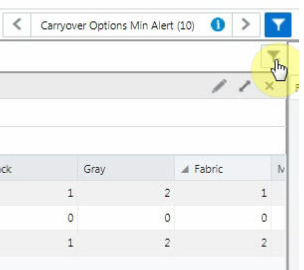

Carryover Options Minimum
The alert will activate when the Carryover Options Shopped is less than the Target options (Carryover status) defined in the determine # of options in the shopping list. This alert is used in the Create Assortment segment under the Planning Services activity.

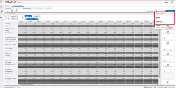

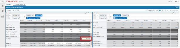

Alert Navigation

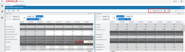

Clicking on the right arrow launches the alert navigation mode. Use this to navigate quickly and easily between the various alerted intersections present in the specified view.
Figure A-1 Alert Navigation
Alert Navigation
You can see that you are in alert navigation mode, as highlighted in the following figure.
Figure A-2 Alert Navigation Mode
Sometimes, a warning message indicates that the alert hits are invisible. You can check the alert summary to view the alert intersection and make sure that your view reflects the same intersection so that the alerted positions can be highlighted.
Figure A-3 Alert Intersections
Alert Intersections
Once the alerted intersections are highlighted at the required intersections as specified in the alert summary, you can resolve them one by one.

Click Next to move to the next selected alert until you resolve all the alerted positions. You can also exit from the alert navigation mode. Click the left or right arrows to move to the next or previous real time alert relative to the currently selected cell in the pivot table.
Figure A-5 Moving Between Alerts

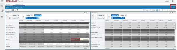

In alert navigation mode, the rows, columns, and pages in the workspace view are restricted to those with the currently selected real time alert. These rows are not dynamically updated. The same rows, columns, and pages remain visible after a calculation changes the data.
You cannot change the view layout or navigate to different view in the alert navigation mode.
Figure A-6 View Layout
View Layout
You can exit the alert navigation mode by clicking Done. To hide the alerts, deselect the Alert in the Exception list.
Figure A-7 Exit Alert Navigation Mode

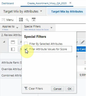

Special Filters
Special Filters are used to affect the visible positions in the workspace view. These filters contain special rules, so planners can focus dynamically on the information that is important to them. Hovering over a Special Filter displays information about the filter criteria.
Once the Special Filter is applied, the positions that do not match the criteria are hidden. You can verify positions using EVO to view the positions in the hidden area. Any positions that were manually hidden previously will be un-hidden if they match the Special Filter criteria.
Following are the special filters defined in the application through configuration.

Filter by Selected Attributes
The Special Filter can be activated to show only the data associated with the Selected Attributes in the view. This is used in the Target Mix by Attributes view in the Create Assortment and Build Wedge segments under the Planning Services activity.
Filter Attribute Values for Score
The Special Filter can be activated to show only the data associated with the Selected Attributes for Scoring in the view. This is used in the Review Attribute Score View in the Create Assortment and Build Wedge Segments under the Planning Services activity.
The Special Filter can be activated to show only the data associated with the Selected Attributes for Scoring in the view in order to view any deviations from the target to the assigned. This is used in the Compare Assortment to Target view in the Create Assortment and Build Wedge segments under the Planning Services activity.

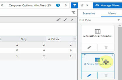

Special Filters Navigation
When the Special Filter exists, the Special Filter icon on the Quick Access Tool bar appears highlighted and is applied to the view in the view management drawer.
Figure A-8 Special Filter Navigation Icon

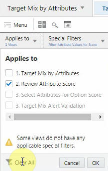

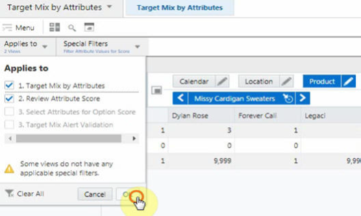

You can select the views that the selected Special Filter must apply to, either one view, multiple views, or all views under the step. Special Filters that have the same measure and query level combination are represented as one option and are applied to multiple views in a step.
Figure A-9 Special Filter Navigation: Select Views
Figure A-10 Select to Apply Special Filter
Figure A-11 Apply Special Filter
You can clear all the Special filters applied by clicking the special filters LOV, clicking Clear Filters, and clicking OK.
Figure A-12 Clear Special Filters
You can clear all the Special filters applied by clicking the special filters LOV, clicking Clear All, and clicking OK.
Figure A-13 Special Filter: Clear All Filters
