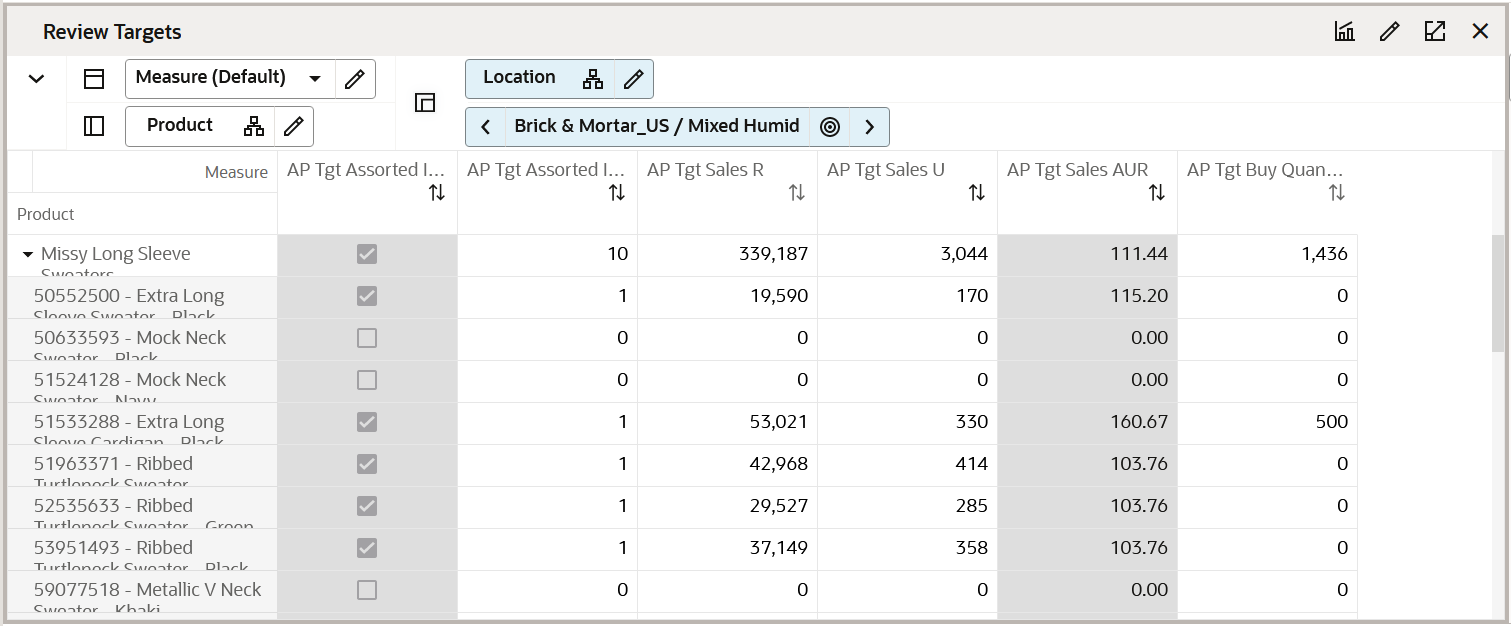

  • To start with Pre-season planning process, review targets from Assortment Strategy, forecast and MFP.

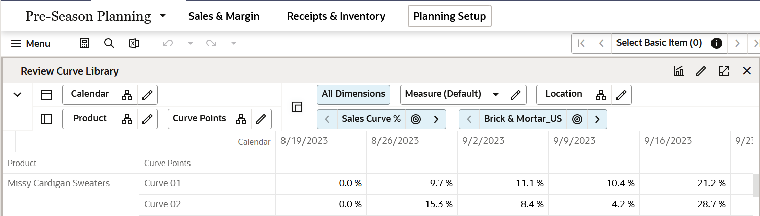

Review Curve Library View
The Review Curve Library view is a reference-only view used to review curves that were set up in Curve Maintenance. The curves can be applied to the sales, to intelligently spread sales over time, which is later used for planning receipt flows. For more information about the different types of curves and their functionality, see the Curve Maintenance task.
The step to complete this process:
  • Review the sales percent to totals for each curve, as necessary.
Figure 12-3 Review Curve Library View
Measure Table
Table 12-3 Review Curve Library View Measures
Label Definition
Sales Curve %
Used to
Measure Profiles
Default Profile
The Default profile is used to view each curve.

AP Tgt Assorted Item
A Boolean flag measure used to indicate that an item is carried in the approved Assortment Plan.

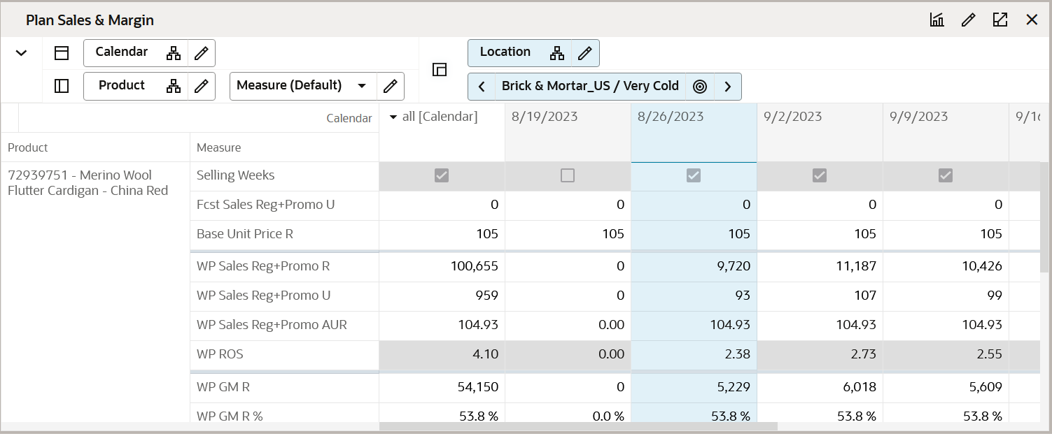

Plan Sales and Margin View
The second sub-step in the Pre-season Item Planning process is Sales & Margin. The Plan Sales and Margin view is used by the planner to plan regular and promotional sales by item, week, and location cluster.
Running the Create_weekly_Sales Application Action creates the following logic for each Assorted Item denoted by the WP Assorted Item Boolean flag being checked:
Source Sales Units are spread to week based on the source selected.
Units are multiplied by the Base Unit Price and Base Unit Cost to get Retail and Cost.
Base Unit Price and Cost are interfaced from a source system for existing items and entered by the planner for placeholder items in the Item Administration segment.
The steps to complete this process:
  • Review and adjust each item/week/cluster Regular and Promotional Sales:
    • It is a best practice to seed sales before planning the sales buckets so that there is a demand curve in Reg and Promo Sales from which to begin your plan.
    • If there is no seeding and no prior data entered, then planning WP Sales will spread proportionally (since there is no demand curve the data will spread evenly) to Reg and Promo Sales.
      If that is not the desired behavior, plan Reg Sales and Promo Sales before planning Sales, so that a demand curve is in place before planning WP Sales.
  • Review and adjust Sales after having planned Regular and Promotional Sales, if necessary.
    User-Defined Exceptions are a helpful way to identify exceptions which would need to be manually adjusted. For detailed information on these capabilities, see the Oracle Retail Predictive Application Server Cloud Edition User Guide.
  • Review AUC and GM measures to ensure financial viability of the plan.

Selling Weeks
A Boolean flag measure used to indicate the week the item begins selling in the assortment.
WP Sales Reg R, U, AUR
Regular Sales Retail, Units, and Average Unit Retail.
Wp ROS
Working Plan Rate of Sales.
WP Sales Promo R, U, AUR
Promotional Sales Retail, Units, and Average Unit Retail.
WP Sales Promo Disc %
The Promotional discount percent applied to the promotional week.
WP Markdown %
The Markdown discount percent applied to the markdown week.
WP Sales GM R, GM R %
Sales Gross Margin value and Gross Margin percent for an item.
Fcst Sales U
Forecasted Sales Units from RDF or RDF Lite.
Base Unit Price R
An item's retail value, which can be different by location.
WP Sales R, U, C, AUR, AUC
Working Plan Sales Retail, Units, Cost, Average Unit Retail, and Average Unit Cost.
Measure Profile
Default Profile
The Default profile is used to plan regular and promotional sales by item and cluster.

WP Sales R, U, AUR, C,AUC, GM R, GM R%
IP Working Plan Retail, Units, Average Unit Retail, Cost, Average Unit Cost, Gross Margin value, Gross Margin percent.
WP Sales Reg+Promo R, U, AUR
IP Working Plan Full Price Retail, Units, Average Unit Retail.
WP Sales Clr R, U, AUR
IP Working Plan clearance Retail, Units, Average Unit Retail.

Review Targets View
In Review Targets view, the Planner can review the targets from the assortment planning and also roll up to the needed attributes that are important to review or analyze.
Figure 12-7 Review Targets View
Review Targets View
Measure Table
Table 12-8 Review Targets View Measures
Label Definition
A Boolean flag measure used to indicate that an item is carried in the approved Assortment Plan, best viewed at the Sub-class and/or category level by cluster or All Location.
AP Tgt Assorted Item Count
The number of items carried in the approved Assortment Plan.
AP Tgt Buy Quantity
The Assortment Plan Current Plan Buy Quantity Units.
AP Tgt Sales R, U, AUR
The Assortment Plan Current Plan Sales Retail, Units, and Average Unit Retail values.
