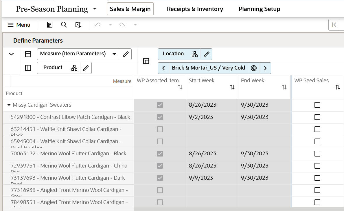

Define Parameters View
The Define Parameters view is used to select a curve source year, a seed source, and the curve type.
The steps to complete this process:
The Curve Description measure allows you to provide a detailed curve label for the curves defined so that you can easily identify the specific curves defined for different use cases.
In the Curve Source (Year) measure, select the year from which to pull the Seed Source data.
In the Seed Source measure, select MFP, Forecast or Actuals as the seed source.
The Seed Source measure selected should align with the Curve Source (Year) selected. For example, if you select Forecast, the Curve Source (Year) should be a future period. If you select Actuals, the Curve Source (Year) should be an elapsed period.
You may also directly enter a curve, without using one of the available seed sources (see "Define Curves View"):
For example, you can manually enter an 8–week curve, starting with W01 and going through W08.
The system will normalize these values to 100%.
If you manually enter a curve, select the Relative Curve type so that the curve will resize according to the assortment duration.
In the Curve Type measure, select Absolute or Relative:
Absolute will take the corresponding week's curve percent to total and normalize the curve to equal 100% based on the assortment period duration.
Absolute curves are not stretched or shortened to fit the assortment period and can be useful when items tend to display seasonal behavior based on the time of year.
An absolute curve will only normalize the data to make it 100%. It just changes the scale, retaining the shape of the curve.
Relative will take the first through the last populated week curve percent and resize, then normalize the curve to equal 100% to fit the assortment period duration. For example, if the assortment period is longer than the defined curve, the effective curve is stretched to match the assortment period.
Relative curves are useful if the items tend to display the same pattern of selling over their lifecycle, regardless of the time period.
A relative curve is useful when you do not want to enter data for all the weeks in the Define Curves view. As an example, if you have an assortment period of 12 weeks, you can just set data for week1 to week4 and the system will resize it to fit into the assortment period.
You can also set data for more than 12 weeks for this scenario; the relative setup will take the curve and fit it for 12 weeks.
You need to remember that the relative curve resizes for forward weeks only. Ideally, you should set data from week1 up to any week you decide to. If you do not set data for week1 but set data only from week2, the relative curve will only be set from week2, so effectively week1 will not have any sales. The curve will not adjust for any past week.
Run the Seed Source Application Action.
Seed Source will populate the Sales Curve % based on the seed source independent of the Curve Type defined. If the seeded curve % has curve data from week01 to week52 and type is set to Relative, it will resize and normalize it to the length of the Assortment Period. The resize and normalization of the curve occurs in the normal calc process and not through the Seed Curve custom menu. The decision to use which Curve Type, Absolute versus Relative, can happen after the Seed Curve process. Relative is best used for the manual setting of Sales Curve % from week01 onwards.

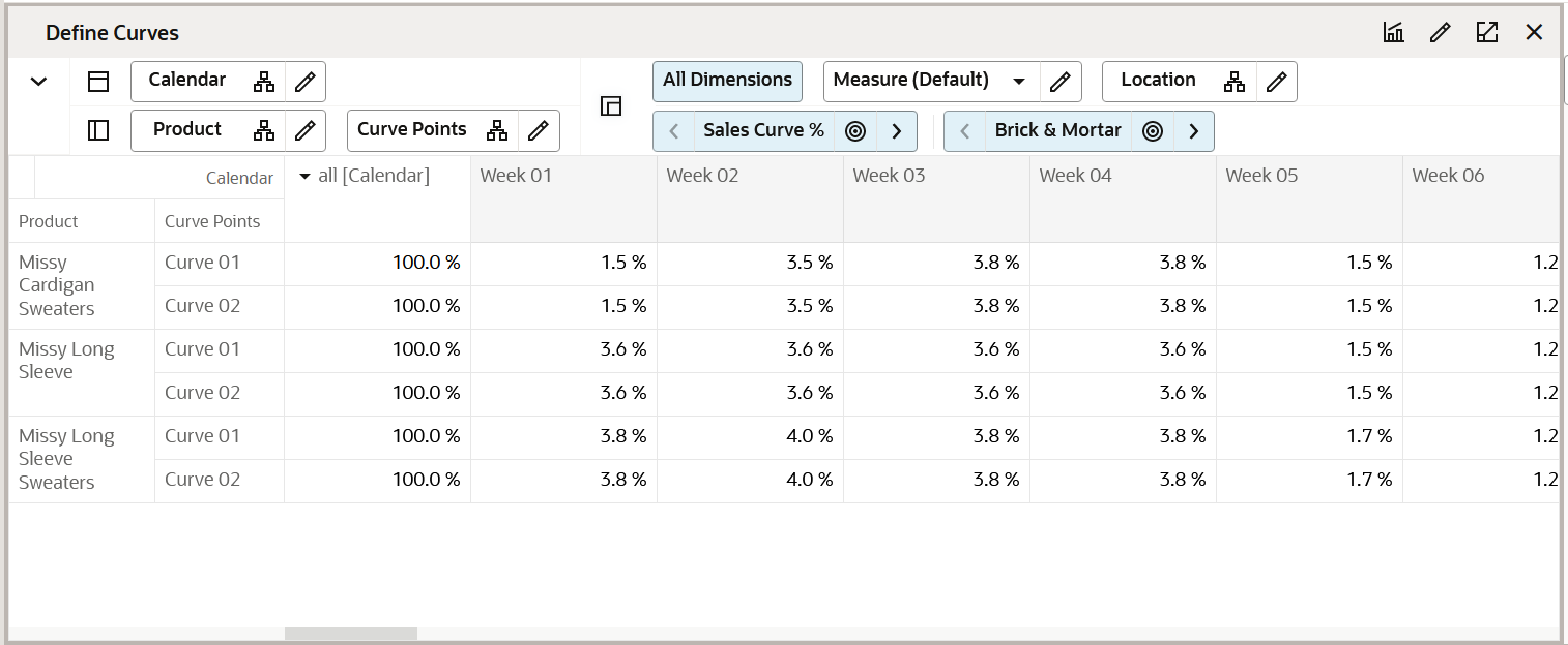

Define Curves View
The Define Curves view is used to view and modify the seeded curve data. Note that all curves will systematically normalize to equal 100%. You have the option of directly entering curves as well. When entering directly, the recommended curve type is Relative.
Review each of the defined curves and determine if adjustments should be made.
It can be helpful to view the curves in graph form to see the shape of the curve in a visual format.
In the Define Curves view, you are presented with week01 to week53. These are all generic weeks. Do not mistake it for FY weeks. These are relative weeks to the assortment period selected by you. For example, you can have an assortment period from week13 to week24. In Define Curves, it will map week01 to week13 of the assortment period (and onwards).

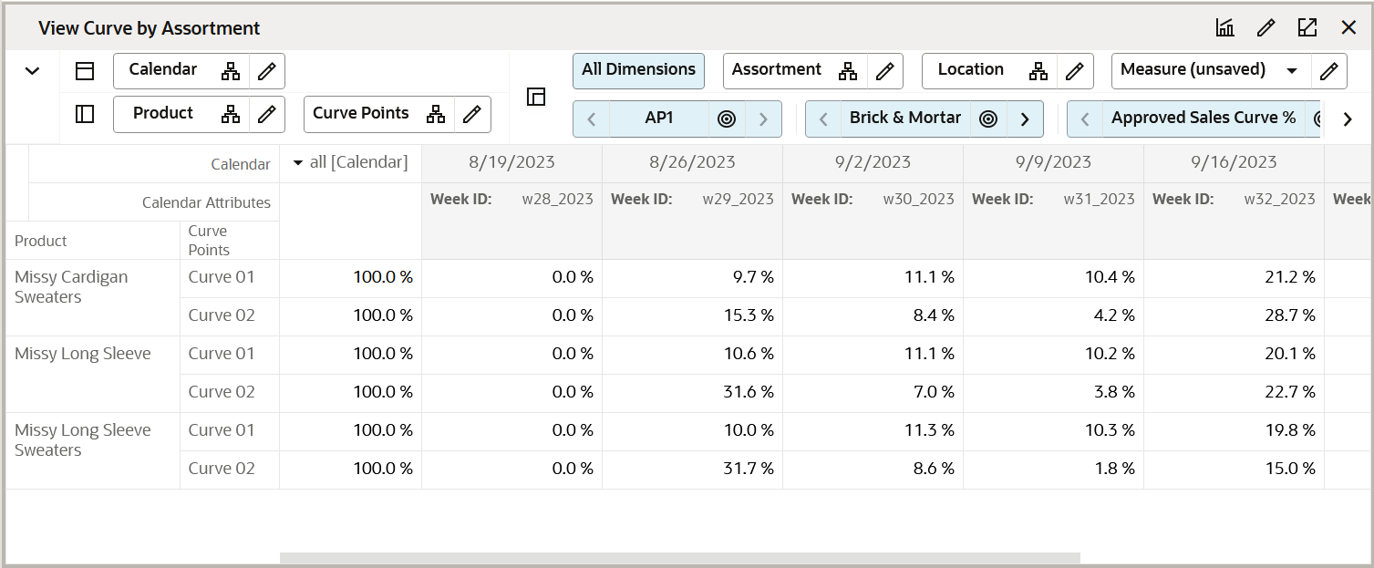

View Curve by Assortment View
The View Curve by Assortment view is used to view the curve library by Assortment Period and Subclass. This is a reference-only view.
The step to complete this process:
Review the curve library by each Assortment Period.
Use the radio button to scroll through Assortment Period and Subclass, as necessary.
Note that you may use the filter button to filter by Assortment Periods that have been assigned a curve.
