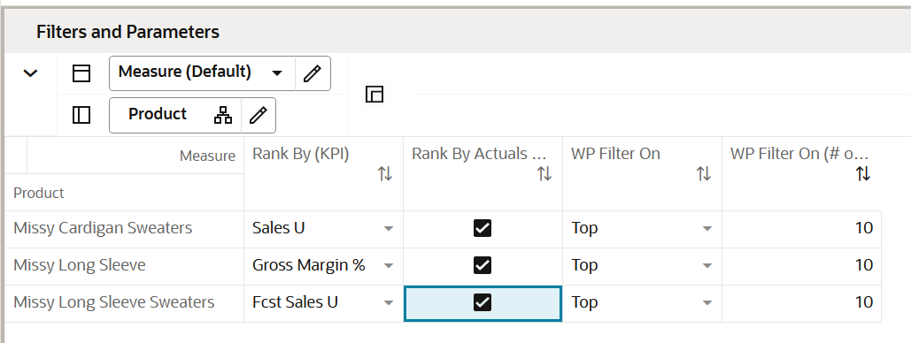

Filters and Parameters View
The Filters and Parameters view is used to select the KPIs that will be used in the Trend Analysis view.
The steps to complete this process:
In the Rank by (KPI) measure, select the KPI that you wish to review in Trend Analysis.
If checked, the Rank by Actuals Only Boolean flag measure will rank items by actual sales results only.
If left unchecked, the ranking will be based on actuals and plan.
The WP Filter On and WP Filter On (# of Items) measures default to Top and 10, which will show the top 10 items in the Trend Analysis view.
You can also choose to show the lowest ranked items by selecting Bottom from the WP Filter On measure drop-down list.
Click Calculate to set your selections for view in the Trend Analysis view.
Figure 12-1 Filters and Parameters View
