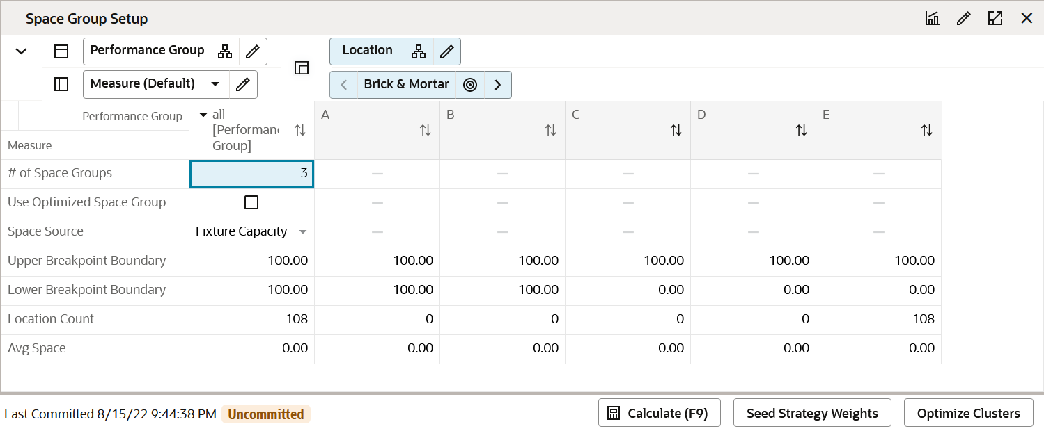

  • If using Space Groups, determine the number of space groups and the space source.

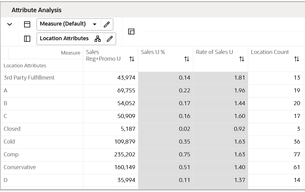

Attribute Analysis View
The Attribute Analysis view is used to show attributes that are assigned to each location, along with performance data that corresponds to the Sales Source measure (Plan, Forecast, Actuals) and the calendar periods selected in the wizard process. Reviewing and analyzing the data provides input to you when deciding which attributes to use in the clustering process.
Figure 6-1 Attribute Analysis View
Measure Table
Table 6-1 Attribute Analysis View Measures
Label Definition
Sales U
The sales units for the categories, calendar periods, and sales source that were selected in the wizard process shown by location attribute.
Sales U %
The sales unit contribution to the total for each attribute, for the categories, calendar periods, and sales source that were selected in the wizard process, shown by location attribute.
Rate of Sales U
The weekly rate of sales for the categories, calendar periods, and sales source that were selected in the wizard process, shown by location attribute.
Location Count
The number of locations assigned to each attribute.
Measure Profile
Default Profile
The Default profile is used to review performance data by attribute, to determine which attributes will create meaningful clusters.

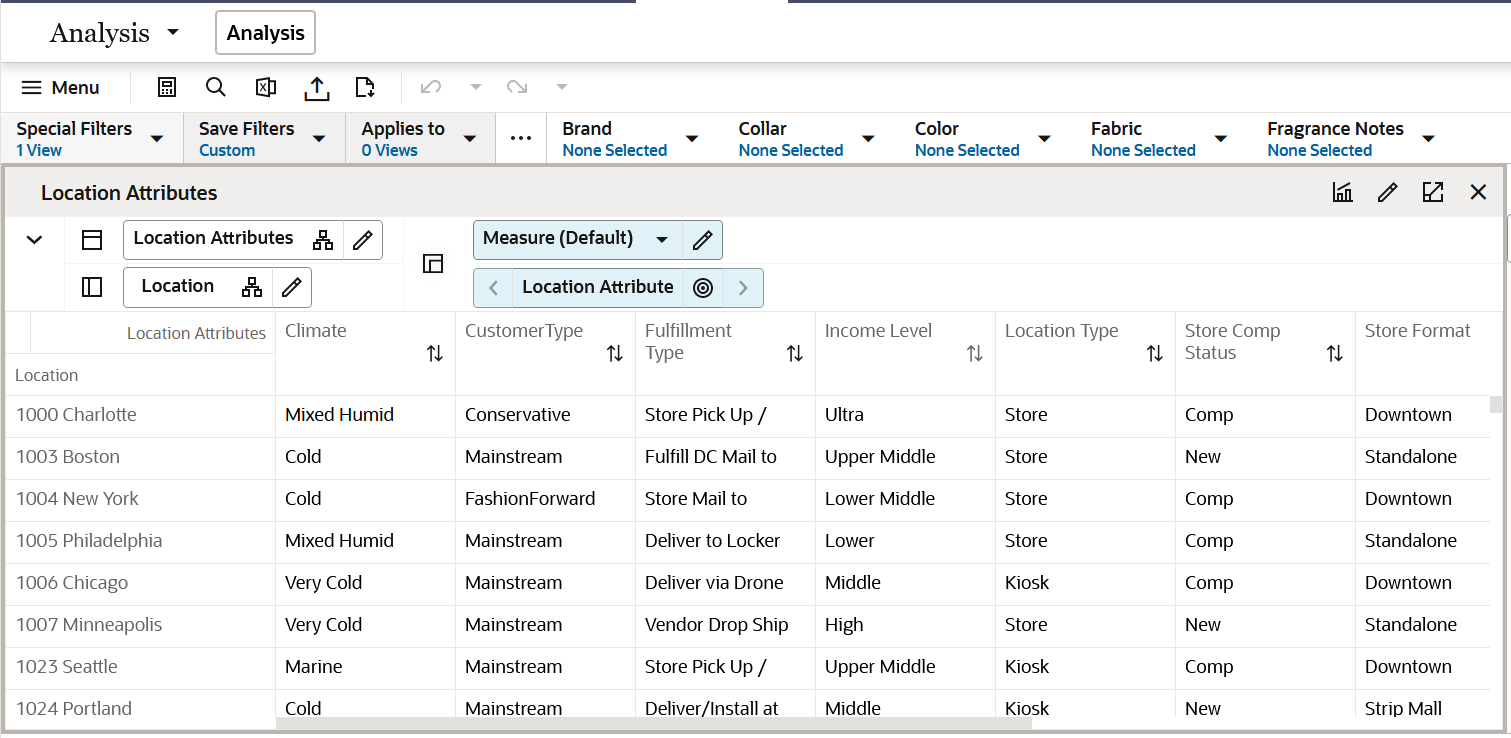

Location Attributes View
The Location Attributes view allows you to review all the attributes and characteristics defined for every single store. This is a read-only view displaying the data set up in the location setup located in the planning Administration section. You can review the attributes to make key decisions on location clustering.
Figure 6-2 Location Attributes View
Measure Table
Table 6-2 Location Attributes View Measure
Label Definition
Location Attributes
The location attributes measure holds the different attributes of each store.

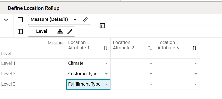

Define Location Rollup View
The Define Location Rollup view is used to select Location attributes to view in an alternate hierarchy. This is available in the tab to display the Store level. The Nested Location attribute rollup is provided with three levels. You can set up to three different combinations for nested rollup with a maximum of three levels in each combination. Nesting of dynamic attributes is a configurable option.
You can analyze, review, and edit the clustering decisions based on important attributes. You may select up to three attributes at a time for the dynamic rollup.
The steps to complete this process:
  • Select up to three dynamic location attributes from the drop-down list.
  • Run the Refresh Location Rollup Application Action.
  • To view the location attribute:
    • In a view that displays the store level, click the Location Hierarchy tile.
    • Select the attribute (Attribute 1 or 2 or 3) that you would like to view in the nested dynamic rollup.
    • Click OK.
Figure 6-3 Define Location Rollup View

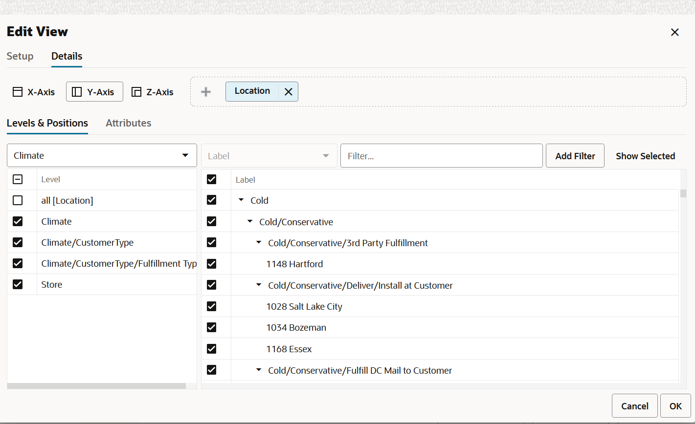

Figure 6-4 Edit View
Edit View
When selecting the alternate dynamic hierarchy defined in the Define Location Rollup View, you can see the subtotals at each nested level. For all the editable measures, you can edit these subtotals to spread the values to all the associated positions.
Measure Table
Table 6-3 Define Location Rollup View Measure
Label Definition
Location Attribute 1, 2, 3
Drop-down list to present Location attributes for nested dynamic Location hierarchy rollup.

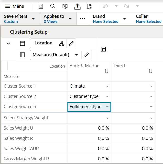

Clustering Setup View
The Clustering Setup view allows you to select up to three location attributes that can be used to create clusters and to seed or assign Strategy Weights for the category, based on business knowledge of the strategy for the category.
The total sum of the weights assigned to all the metrics should be 100%; if the weights do not sum up to 100%, they are re-normalized upon the next commit and refresh.
Things to consider when choosing the Sales Perf Group attribute:
  • Which performance measure, or combination of performance measures, should I choose? The category strategy should inform this decision. For example, if the category is a traffic driver, then choosing units as the performance metric makes sense. If the category's purpose is to drive profit, then choosing Gross Margin makes sense.
    Your company may have a defined performance strategy for each category, which would be assigned in the Administrator segment. If so, then seed the weights.
  • How many Performance Groups do I want for this category? You may select from 1 to 5. Selecting 1 is a good option if you do not want to break your clusters down by sales grade. As you select more groups, you will have more clusters to manage, with fewer locations assigned to each cluster.
If neither the Perf Group Setup nor the Space Group Setup is selected, but at least one other attribute is selected, you can run the Create Cluster Application Action now, since performance and space setups do not need to be created. Keep in mind that as more attributes are selected, more clusters will be created, with a corresponding increase in workload.
The step to complete this process:
  • Select up to three location attributes for clustering.
  • If Sales Perf Group is selected as an attribute, performance weights must be seeded or assigned:
    • If seeding the performance weights, select the appropriate strategy for the category and clusters in the Select Strategy Weight drop-down list measure.
    • Run the Seed Strategy Weight Application Action to populate the corresponding performance metrics.
      The Strategy Weights were set by the Administrator.
    • You have the option of overriding the weights based on their business knowledge of the category strategy.
  • When selecting a clustering strategy, select a strategy that supports the goals for the category.
    For example, if the category is used to drive traffic, you should select a strategy that supports that goal and will likely have Units weighted highly or at 100%.
  • If not selecting Sales Perf Group or Space as attributes, run the Create Cluster Application Action.
Figure 6-5 Clustering Setup View

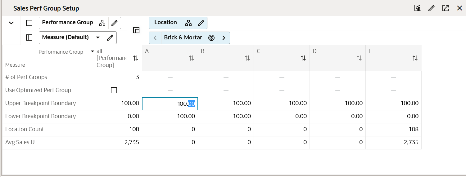

Sales Perf Group Setup View
The Sales Perf Group Setup view is used to define the number of performance groups and select the algorithm used for clustering. The maximum number of performance groups is five.
To review the definitions of Breakpoint and Optimized, see Key Concepts
If using the Breakpoint algorithm, the steps to complete this process:
  • Enter the number of performance groups you want to create for the category, with a maximum of five available.
  • Review the Upper Breakpoint Boundaries; adjust the upper boundaries if you have business knowledge that suggests a better result.
    If you adjust the upper boundary, it will only be valid for the current session and will not be committed to the segment. When you create a new segment, the system will revert to the recommended values.
  • Review the Location Count and Avg Sales U for each performance group.
  • Run the Create Cluster Application Action to create clusters.
If you make changes to any settings, you must rerun the Create Cluster Application Action to see updated results.
If using the Optimized algorithm, the steps to complete this process:
  • Enter the number of performance groups you want to create for the cluster, with a maximum of five available.
  • Check the Use Optimized Perf Group Boolean flag.
  • Run the Optimize Clusters Application Action.
If you make changes to settings, you must rerun the Optimize Clusters and Create Cluster Application Actions to see updated results.
Figure 6-6 Sales Perf Group Setup View

# of Perf Groups
A user-entered number used to calculate the number of performance-based clusters that will be created; the minimum is one and the maximum is five.
Enabling this checkbox selects the BaNG algorithm for use in location clustering.
Upper Breakpoint Boundary
The upper boundary of each performance group. When the upper boundary is edited, the lower boundary of the next performance group will recalculate. Note that user edits to the upper breakpoint will only be available in the current session and will not commit to the database.
Lower Breakpoint Boundary
The lower boundary of each performance group.
Location Count
The number of locations in each cluster. The number of locations by cluster will change if you select the Optimized or the Breakpoint algorithm methods or if you adjust the performance weights and recalculate using Application Actions. The total number of locations will always match the number of locations selected in the wizard process.
Avg Sales U
The average sales units for the performance group.
Measure Profile
Default Profile
The Default profile is used to define the number of performance groups and select and modify the clustering algorithm to be used.

Space Group Setup View
The Space Group Setup view will only be used if space-aware metrics (Avg # of fixtures, Fixture Capacity, Square Feet, Square Meter) are loaded into the solution by an Administrator.
The Space Group Setup view is used to define the number of space groups and select the algorithm used for clustering. The maximum amount of space groups is five and will be used with both the Breakpoint and Optimized algorithms.
  • Enter the number of space groups you want to create for the cluster, with a maximum of five available.
  • Select the appropriate Space Source value from the Space Source drop-down list.
  • Review the Location Count and Avg Space of each performance group.
If you make changes to any settings, you must rerun the Create Cluster Application Action in order to see updated results.
  • Check the Use Optimized Space Group Boolean.
  • Select the appropriate Space Source value from the Space Source picklis.t
  • Review the Location Count and Avg Space for each performance group.
If you make changes to settings, you must rerun the Optimize Clusters and Create Cluster Application Actions in order to see updated results.
Measure Table
Table 6-6 Space Group Setup View Measures
Label Definition
# of Space Groups
A user-entered number used by the system to calculate clusters that will be created.
Space Source
Drop-down list for the user to decide which space metric to use in determining space-based clusters.
Location Count
The number of locations in each cluster. The number of locations by cluster will change if you select the Optimized or the Breakpoint algorithm methods or if you adjust the performance weights and recalculate. The total number of locations will always match the number of locations selected in the wizard process.
Avg Space
The average space for each space group based on the user-selected Space Source.
Measure Profile
Default Profile
The Default profile is used to define the number of space groups and select and modify the clustering algorithm to be used.
Application Actions
Optimize Clusters
The Optimize Clusters Application Action signals the system to run the BaNG algorithm process to create clusters using the K-means science-based methodology.
Create Cluster
The Create Cluster Application Action calculates location clusters based on the user-defined parameters selected in the Initial Setup. If attributes, performance metric weights, # of performance groups, or the clustering method is updated, the Create Cluster Application Action must be rerun to see updated results.

Analysis Tab
This tab is used to analyze the location performance measures, scaled scoring, performance groups, and clusters assigned to each location.
Location Analysis View
  • Review the cluster assignments to ensure you agree.
  • If you do not agree with the cluster assignment, you have several options:
    • Override the performance group assignment in the Override Perf Group measure. For example, if a location was ranked as B, you can manually override it to an A or a C, based on your business knowledge.
    • Return to the Setup step to:
      • Adjust performance measures. For example, you could change the performance measure of Sales U to Sales R. Keep in mind that the measures being used should correspond to the category strategy.
      • Adjust performance weights. For example, you could change the weights that are assigned to Sales U to Sales R. Keep in mind that the weights and measures being used should correspond to the category strategy.
      • Adjust the number of performance groups. For example, you could increase or decrease the number of performance-based clusters. This will increase or decrease the number of clusters created.
      • Adjust the location attributes used in clustering. For example, you could choose a different combination of attributes or remove an attribute if you deem it unimportant after analyzing the results.
If you make changes to settings, you must rerun the Optimize Clusters (if using the Optimize algorithm) and Create Cluster Application Actions to see updated results.
Figure 6-8 Location Analysis View
Shows attribute 1, 2, 3 chosen in the Initial Setup Step.

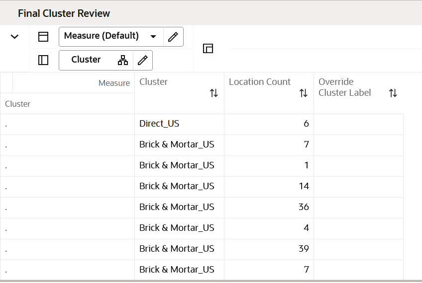

Final Cluster Review View
  • Review the location count by each cluster.
  • In Override Cluster Label, you can enter new a label name for clusters, if desired:
    • The cluster label can be used to identify the attributes of the cluster.
    • If you use the Override Cluster label, you must run the Approve Application Action after the labels are entered.
Measure Table
Table 6-8 Final Cluster Review View Measures
Label Definition
Cluster
Displays the attributes that comprise the cluster.
Location Count
Displays the number of locations in each cluster.
Optional user input field to rename a cluster. If a label override is used, the user input name will be seen in wizard selections and segments that contain the cluster.
Measure Profile
Default Profile
The Default profile is used to rename each cluster for easier identification.

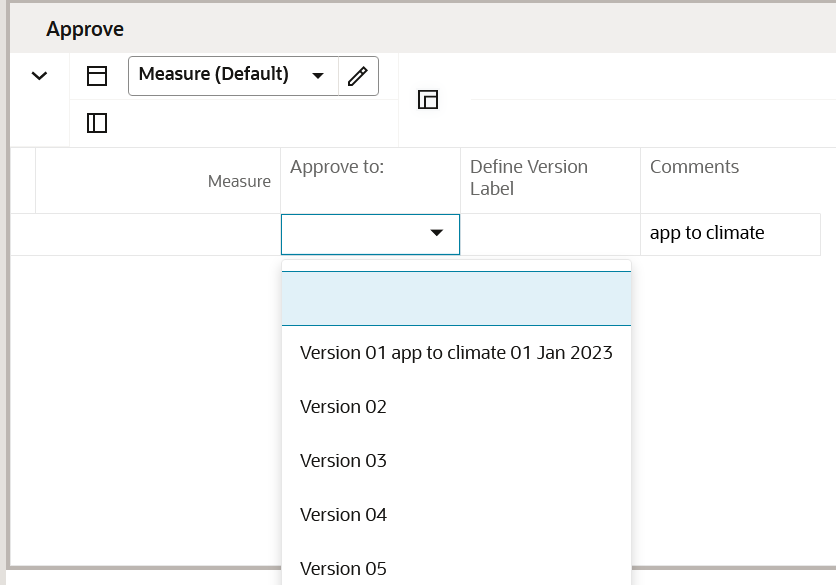

Approve View
  • In the Approve To measure drop-down list, select the version you wish to approve to:
    • The ability to have multiple versions of clusters allows you to have a library of versions that can be assigned to different Assortment Periods.
    • If a cluster version has already been used, you may override its contents by selecting and running the Approve Application Action.
      Unused cluster versions will have this naming convention: Version01, Version02, and so on.
  • I n Define Version Label, you can enter a new label for the version, if desired.
    The version label can be used to identify the attributes of the version for easier identification when assigning the version in Assortment Maintenance.
  • Run the Approve Application Action.

Approve View
Measure Table
Table 6-9 Approve View Measures
Label Definition
Approve to:
Drop-down list to select which version to approve clusters to. If the version has not been used yet, it will show Version 1, Version 2, Version 3, Version 4 and Version 5. If a version has been used, it will show an approved cluster version label. You can select a version that has been used and reapprove a new set of clusters which will override the prior clusters.
Optional user input field to rename a version. If a label override is used, the user input name will be seen in wizard selections and segments that contain the cluster version.
Comments
Comments entered here will appear as a reference in the Assortment Maintenance task.
Measure Profile
Default Profile
The Default profile is used to approve clusters as well as optionally rename the version and enter comments.
Application Action
Approve
The Approve Application Action creates a version of clusters that can be used to assign to an Assortment Period in Assortment Maintenance. Multiple versions of clusters can be approved, to be reused and assigned to different Assortment Periods. You select which version to approve to before running the Approve Application Action.

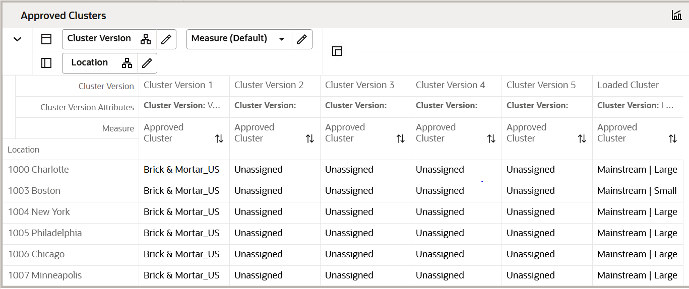

Review Cluster Versions Tab
The Review Cluster Versions tab is used to provide an overview of all available cluster versions.
Approved Cluster View
Use the Approved Clusters view to provide visibility to all cluster versions that have been created for the category. You can compare how different locations are classified in the different cluster versions.
  • Review cluster versions.
Figure 6-11 Approved Clusters View
Measure Table
Table 6-10 Approved Clusters View Measures
Label Definition
Approved Cluster
Displays the names of approved clusters.
Location Count
Displays the number of locations in the cluster.
Measure Profile
Default Profile
The Default profile is used to display approved clusters and the location count in the cluster.
