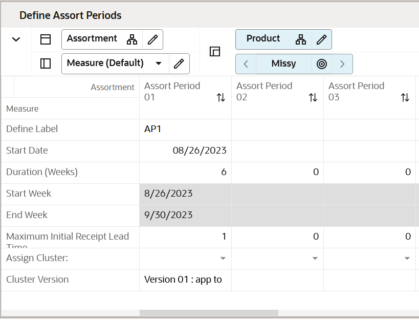

Define Assort Periods View
The Define Assort Periods view is used to assign weeks to an Assortment Period and to assign a cluster version to an Assortment Period.
The steps to complete this process:
In the Define Label measure field, input a name for the Assortment Period that makes business sense to identify the Assortment Period.
This label will be shown in the Assortment Services wizards when selecting Assortment Periods.
In the Start Date measure, enter or select the first week of the Assortment Period.
The Start Week measure will populate.
In the Duration (Weeks) measure, enter the number of weeks of the Assortment Period.
The End Week measure will populate.
In the Maximum Initial Receipt Lead Time measure, enter the maximum number of weeks that receipts can be received before the start of the Assortment Period.
Within the Item Planning segment, you will be able to choose which week the receipts should arrive before the start week of the assortment period, up to the maximum that is set here.
In the Assign Cluster measure drop-down list, select the appropriate cluster version and assign it to the Assortment Period.
Run the Assign Cluster Application Action.
Run the Approve Application Action.
Note that weeks may not overlap between Assortment Periods, and a real-time alert will appear if they do. You must resolve the alert before data will be committed to the database.
Figure 7-1 Define Assort Periods View

Table 7-1 Define Assort Periods View Measures
| Label | Definition |
Define Label |
A user-entered label for an Assortment Period. The label will be visible in the Item Planning wizard when selecting Assortment Periods to help the planner identify the correct Assortment Period to plan. |
Start Date |
The first date of the Assortment Period. |
Duration (Weeks) |
The number of weeks in the Assortment Period. |
Start Week |
The first week of the Assortment Period, calculated from the Start Date and the Duration entered. |
End Week |
The last week of the Assortment Period, calculated from the Start Date and the Duration entered. |
Maximum Initial Receipt Lead Time |
The maximum number of weeks for initial receipt lead time (before the Start Week that the initial receipts arrive). |
Assign Cluster |
A drop-down list measure populated with approved cluster versions. It is used to select the appropriate version to assign to an Assortment Period. |
Cluster Version |
Reference measure that is populated after running the Assign Cluster Application Action with the cluster version assigned to an Assortment Period. |

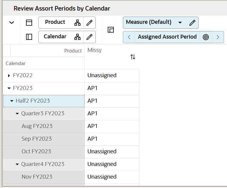

Assort Periods by Calendar View
The Assort Periods by Calendar view is used for reference purposes only, to allow you to view the assortment periods by different levels of the calendar hierarchy (week, month, quarter, half, year). It provides visibility to how the Assortment Periods line up to the dates in the calendar.
The step to complete this process:
View Assortment Periods by category, week, month, quarter, half, or year, as desired.
Figure 7-2 Assort Periods by Calendar View
Measure Table
Table 7-2 Assort Periods by Calendar View Measure
Assigned Assort Period |
Used to view Assortment Period assignment to the calendar hierarchy. |
