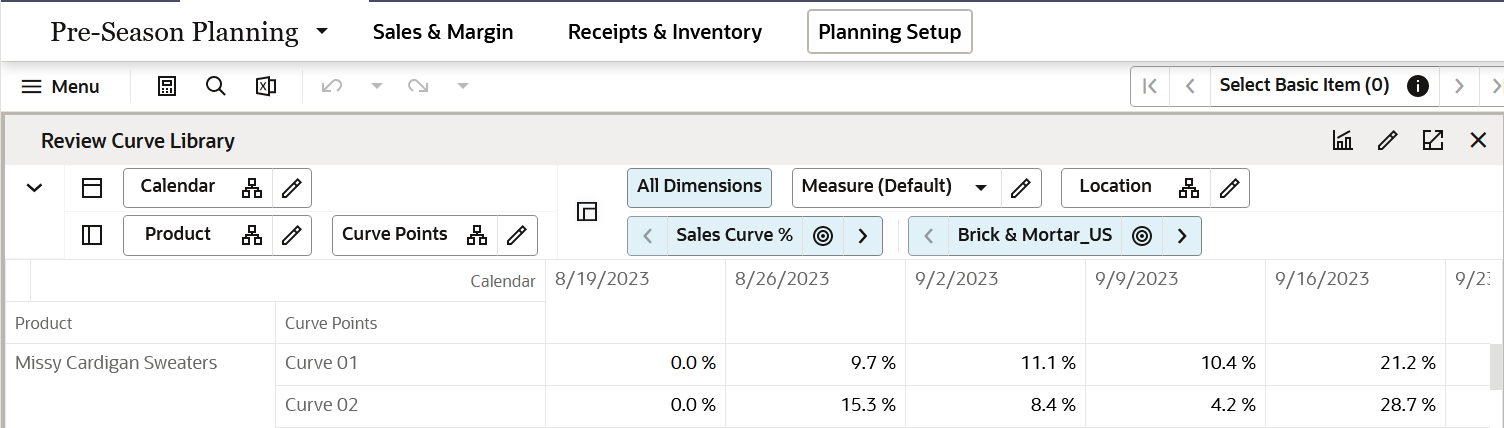

Review Curve Library View
The Review Curve Library view is a reference-only view used to review curves that were set up in Curve Maintenance. The curves can be applied to the sales, to intelligently spread sales over time, which is later used for planning receipt flows. For more information about the different types of curves and their functionality, see the Curve Maintenance task.
The step to complete this process:
Review the sales percent to totals for each curve, as necessary.
Figure 11-3 Review Curve Library View
Measure Table
Table 11-3 Review Curve Library View Measures
| Label | Definition |
Sales Curve % |
Used to |
Measure Profiles
Default Profile
The Default profile is used to view each curve.

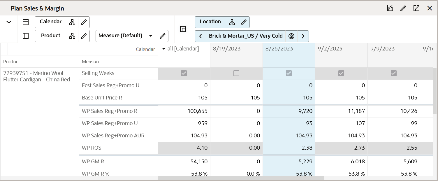

Plan Sales and Margin View
The next sub-step in the Pre-season Item Planning process is Sales & Margin. The Plan Sales and Margin view is used to plan regular and promotional sales by item, week, and location cluster.
Running the Create Weekly Sales Application Action creates the following logic for each Assorted Item denoted by the WP Assorted Item Boolean flag being checked:
Source Sales Units are spread to week based on the source selected.
Units are multiplied by the Base Unit Price and Base Unit Cost to get Retail and Cost.
Base Unit Price and Cost are interfaced from a source system for existing items and entered for placeholder items in the Item Administration segment.
The steps to complete this process:
Review and adjust each item/week/cluster Regular and Promotional Sales:
It is a best practice to seed sales before planning the sales buckets so that there is a demand curve in Reg and Promo Sales from which to begin your plan.
If there is no seeding and no prior data entered, then planning WP Sales will spread proportionally (since there is no demand curve the data will spread evenly) to Reg and Promo Sales.
If that is not the desired behavior, plan Reg Sales and Promo Sales before planning Sales, so that a demand curve is in place before planning WP Sales.
Review and adjust Sales after having planned Regular and Promotional Sales, if necessary.
User-Defined Exceptions are a helpful way to identify exceptions that would need to be manually adjusted. For detailed information on these capabilities, see the Oracle Retail Predictive Application Server Cloud Edition User Guide.
Review AUC and GM measures to ensure the financial viability of the plan.
Figure 11-5 Plan Sales and Margin View
Measure Table
Table 11-5 Plan Sales and Margin View Measures
Selling Weeks |
A Boolean flag measure used to indicate the week the item begins selling in the assortment. |
WP Sales Reg R, U, AUR |
Regular Sales Retail, Units, and Average Unit Retail. |
WP ROS |
Working Plan Rate of Sales. |
WP Sales Promo R, U, AUR |
Promotional Sales Retail, Units, and Average Unit Retail. |
WP Sales GM R, GM R % |
Sales Gross Margin value and Gross Margin percent for an item. |
Fcst Sales U |
Forecasted Sales Units from IPOCS-Demand Forecasting. |
Base Unit Price R |
An item's retail value, that can differ by location. |
WP Sales R, U, C, AUR, AUC |
Working Plan Sales Retail, Units, Cost, Average Unit Retail, and Average Unit Cost. |
Measure Profile
Default Profile
The Default profile is used to plan regular and promotional sales by item and cluster.

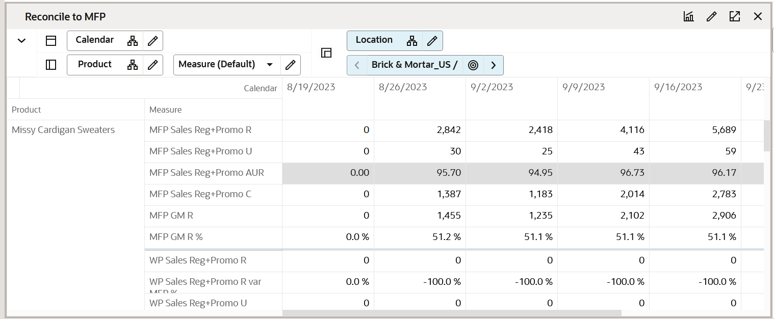

Reconcile to MFP View
The Reconcile to MFP view is used to compare the working plan of the item plan to the approved MFP Current Plan (MFP Tgt) for each subclass and cluster.
Review WP Sales var MFP Tgt % measures to identify variances that are outside of acceptable parameters.
Review Sales R, Sales U, Sales C, and GM variances to ensure that all of the financial numbers meet targets.
Make adjustments to the sales and the receipt plans to be within an acceptable variance.
Repeat this process for each subclass and cluster in the assortment.
If a Location Plan is not available, the MFP CP view displays the MFP Current Plan by subclass spread to Location using last year's location sales' proportionality. If a Location Plan is available, the MFP CP view displays the MFP Current Plan by subclass spread to Location using the Location Plan CP sales' proportionality.
Figure 11-6 Reconcile to MFP View
Measure Table
Table 11-6 Reconcile to MFP View Measures
MFP Sales Reg + Promo R, U, C, AUR, GM R, GM R% |
MFP Full price Sales Retail, Units, Cost, Average Unit Retail, Gross Margin Retail, Gross Margin Retail % |
WP Sales Reg + Promo R, U, AUR, C,AUC, GM R, GM R% |
IP Working Plan Retail, Units, Average Unit Retail, Cost, Average Unit Cost, Gross Margin value, Gross Margin percent. |

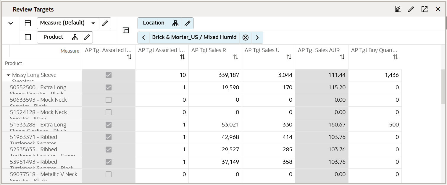

Review Targets View
In the Review Targets view, you can review the targets from the assortment planning and also rollup to the needed attributes that are important to review or analyze.
Figure 11-7 Review Targets View
Measure Table
Table 11-8 Review Targets View Measures
AP Tgt Assorted Item |
A Boolean flag measure used to indicate that an item is carried in the approved Assortment Plan, best viewed at the subclass and/or category level by cluster or All Location. |
AP Tgt Assorted Item Count |
The number of items carried in the approved Assortment Plan. |
AP Tgt Buy Quantity |
The Assortment Plan Current Plan Buy Quantity Units. |

Reconcile to MFP
Use the Reconcile to MFP view to compare the working plan of the item plan to the approved MFP Current Plan (MFP Tgt) for each subclass and cluster.
Review Sales R, Sales U, Sales C, and GM variances to ensure that all of the financials meet targets.
Figure 11-9 Reconcile to MFP
Measure Table
Table 11-11 Reconcile to MFP Measures
