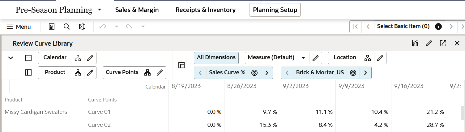

Review Curve Library View
The Review Curve Library view is a reference-only view used to review curves that were set up in Curve Maintenance. The curves can be applied to the sales, to intelligently spread sales over time, which is later used for planning receipt flows. For more information about the different types of curves and their functionality, see the Curve Maintenance task.
The step to complete this process:
Review the sales percent to totals for each curve, as necessary.

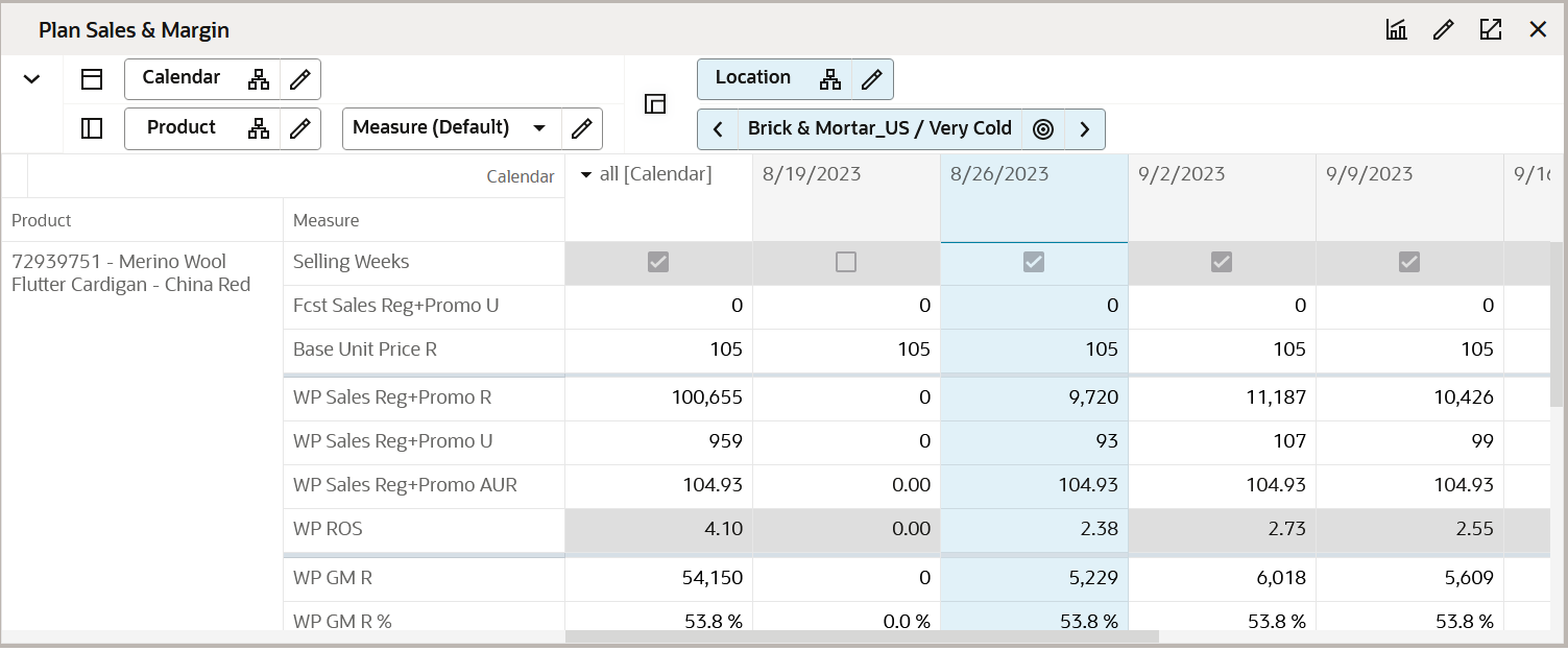

Plan Sales and Margin View
The next sub-step in the Pre-season Item Planning process is Sales & Margin. The Plan Sales and Margin view is used to plan regular and promotional sales by item, week, and location cluster.
Running the Create Weekly Sales Application Action creates the following logic for each Assorted Item denoted by the WP Assorted Item Boolean flag being checked:
Source Sales Units are spread to week based on the source selected.
Units are multiplied by the Base Unit Price and Base Unit Cost to get Retail and Cost.
Base Unit Price and Cost are interfaced from a source system for existing items and entered for placeholder items in the Item Administration segment.
The steps to complete this process:
Review and adjust each item/week/cluster Regular and Promotional Sales:
It is a best practice to seed sales before planning the sales buckets so that there is a demand curve in Reg and Promo Sales from which to begin your plan.
If there is no seeding and no prior data entered, then planning WP Sales will spread proportionally (since there is no demand curve the data will spread evenly) to Reg and Promo Sales.
If that is not the desired behavior, plan Reg Sales and Promo Sales before planning Sales, so that a demand curve is in place before planning WP Sales.
Review and adjust Sales after having planned Regular and Promotional Sales, if necessary.
User-Defined Exceptions are a helpful way to identify exceptions that would need to be manually adjusted. For detailed information on these capabilities, see the Oracle Retail Predictive Application Server Cloud Edition User Guide.
Review AUC and GM measures to ensure the financial viability of the plan.

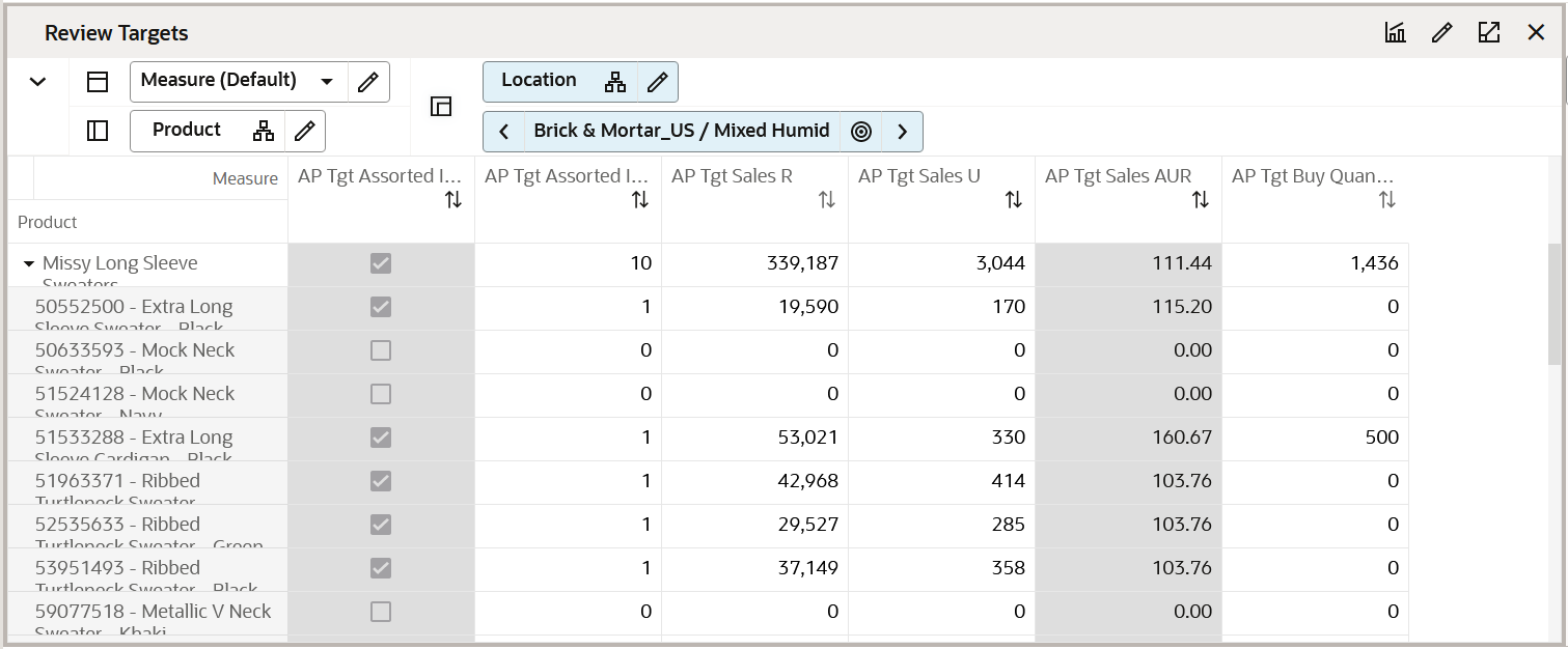

Review Targets View
In the Review Targets view, you can review the targets from the assortment planning and also rollup to the needed attributes that are important to review or analyze.
Figure 11-7 Review Targets View
Measure Table
Table 11-8 Review Targets View Measures
Label | Definition |
AP Tgt Assorted Item |
A Boolean flag measure used to indicate that an item is carried in the approved Assortment Plan, best viewed at the subclass and/or category level by cluster or All Location. |
AP Tgt Assorted Item Count |
The number of items carried in the approved Assortment Plan. |
AP Tgt Buy Quantity |
The Assortment Plan Current Plan Buy Quantity Units. |
AP Tgt Sales R, U, AUR |
The Assortment Plan Current Plan Sales Retail, Units, and Average Unit Retail values. |

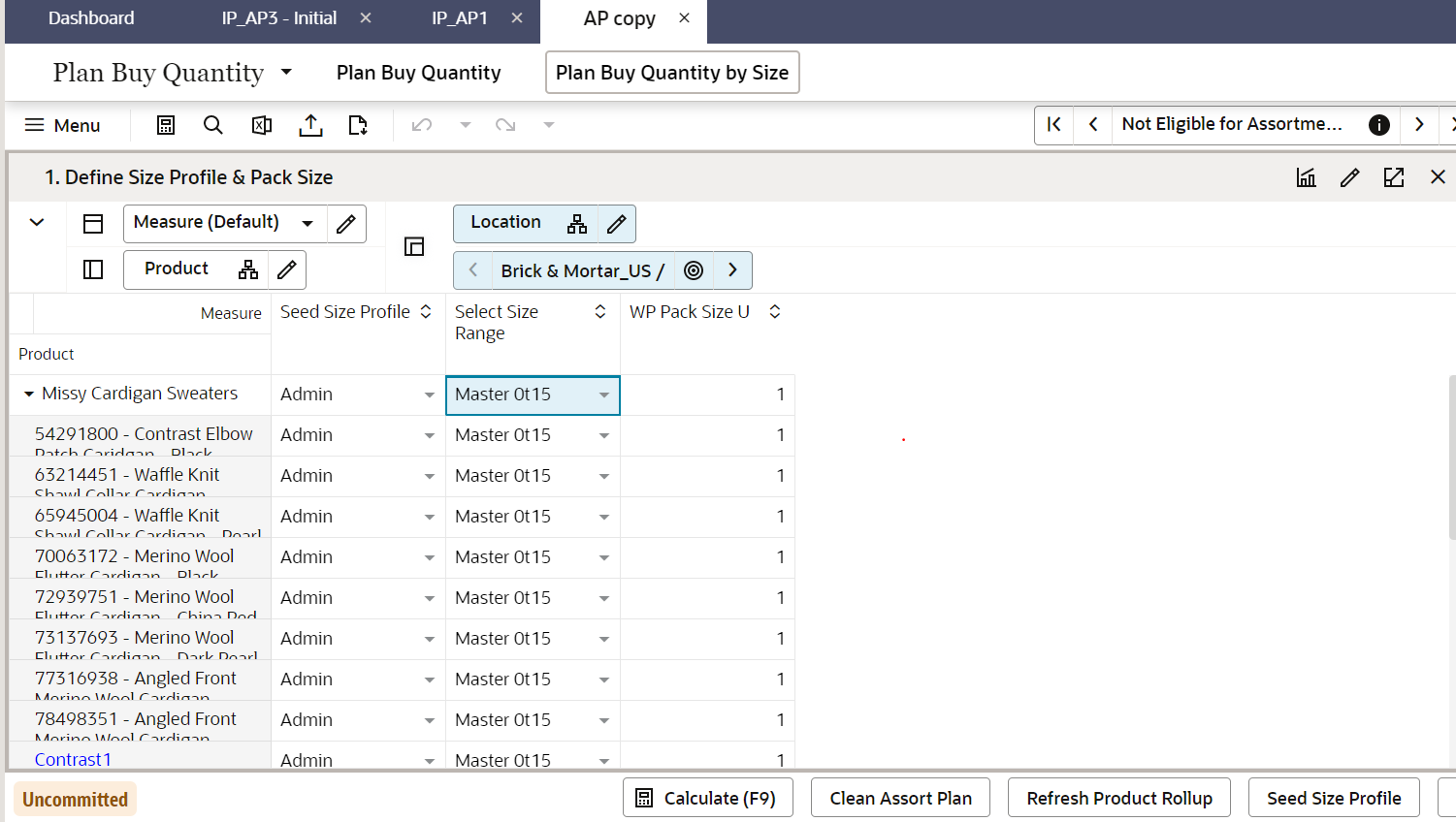

Receipts by Size Tab
This tab is used to split the Buy Quantity by size based on the size profiles available.
Seed Size Profile View
The Seed Size Profile view is used to seed the size profiles to split the Buy Quantity by Size. You have the option to seed the size profile from two sources. Seed from Admin will seed the size profile from Admin Size Profile % loaded by Admin or manually created by Admin. Seed from SPO will seed the size profile from the profile received from Oracle AI Foundation or any other external size profile and optimization engine. You are also allowed to set the pre-pack information for each size in the Wp Pack Size U measure. You should have determined the Buy Quantity before executing this step.
Choose the seed source from any of the available sources and run the Application Action, Seed Size Profile.
Figure 11-10 Seed Size Profile
