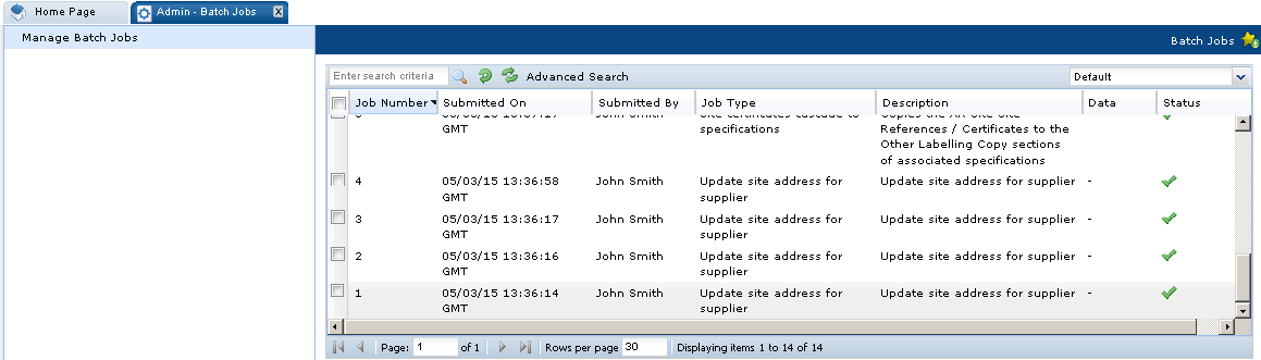

To manage batch jobs, select Batch Jobs from the Admin list. The Manage Batch Jobs page shows the list of all jobs. The jobs are shown in descending order with the most recent job at the top of the list.
Figure 4-1 Manage Batch Jobs Page
The following columns are shown for each job:
Job Number
Submitted On: Date and time when the job was submitted.
Submitted By: Name of the user who submitted the job.
Job Type
Description: Any comments entered when the job was submitted. If no comments were entered, the filename of any uploaded files will appear here.
Data: If a job was submitted using a spreadsheet, an icon is shown in this column. The user can click the spreadsheet icon and select whether to open or download the spreadsheet.
Status: The following icons show the job status:
