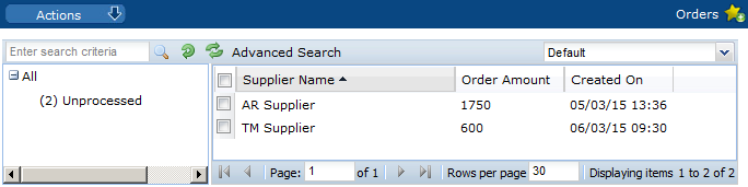

Order Requests
This option is used to manage registration order requests.

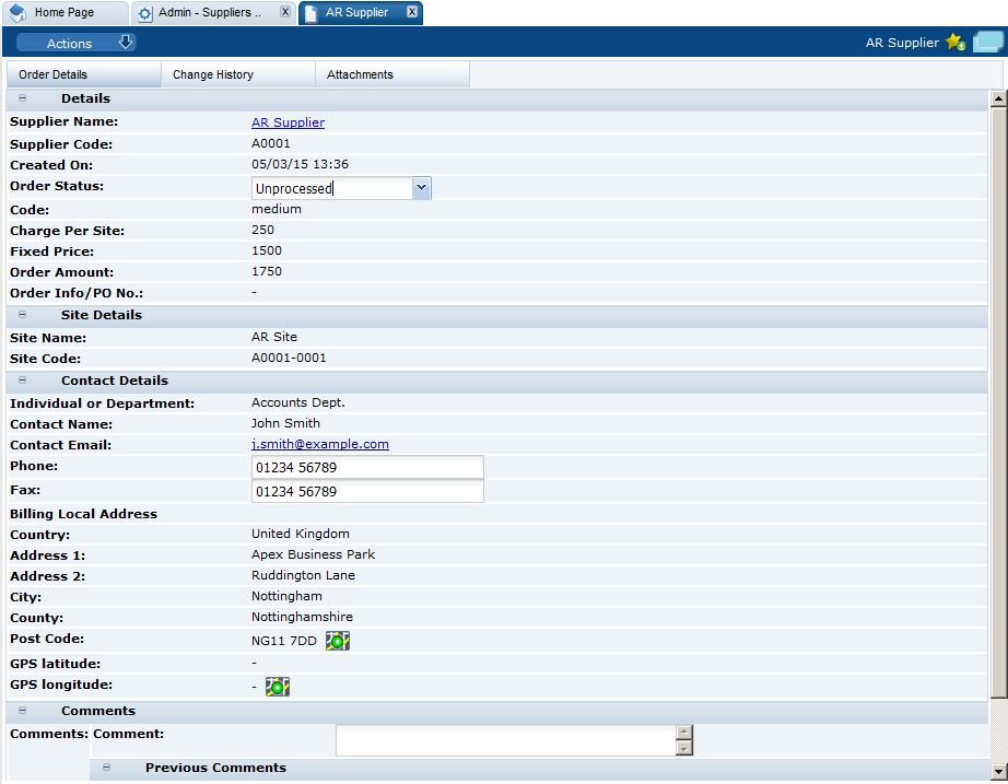

To work with orders:
Select Order Requests. The list of orders appears. It is sorted into processed and unprocessed orders.
Figure 7-3 Orders Page
To see the details for an order, select the order and then select the View action. A new tab opens with the order details in read-only mode. For an example of the content, see Figure 7-4.
To edit an order, select the order an then select the Edit actions. A new tab opens with the order record in edit mode.
Figure 7-4 Order Details Page
Order status: Choose the status from the drop-down list. The status can be updated to Processed once the supplier has been billed.
Contact Details: The Phone and Fax fields can be updated.
Comments: Enter any comments.

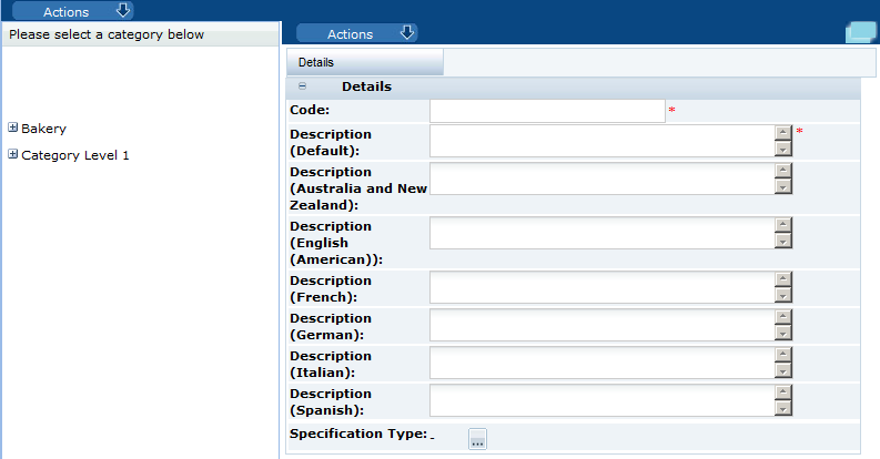

To create a new top-level category:
Click Create new top-level category. The Business Category Details page opens.
Figure 7-8 Add Business Category Details Page
Enter the details for the new category:
Enter the code. This is a mandatory field.
Enter the description for the default language. This is a mandatory field. Enter any translations.
To select the specification types for this level, click the icon. The Select Specification Types dialog box appears. Select the specifications for this level and click Ok.
Select the Save action. The business category is added to the list of categories.
To add child categories, select the top-level category and then select the Add Child Category action.
Enter the details for the child level and select the Save action.

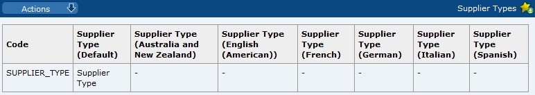

Supplier Types
This option is used to define the types of suppliers that can be created.
Figure 7-9 Supplier Types Page
To edit the list of supplier types, select the Edit action. The table opens in edit mode. For existing supplier types, only the translated descriptions that do not already exist can be edited. To add a supplier type, click Add. A new row is added to the table. Enter the new supplier type and description in the default language. Enter any translations. Select the Save action.

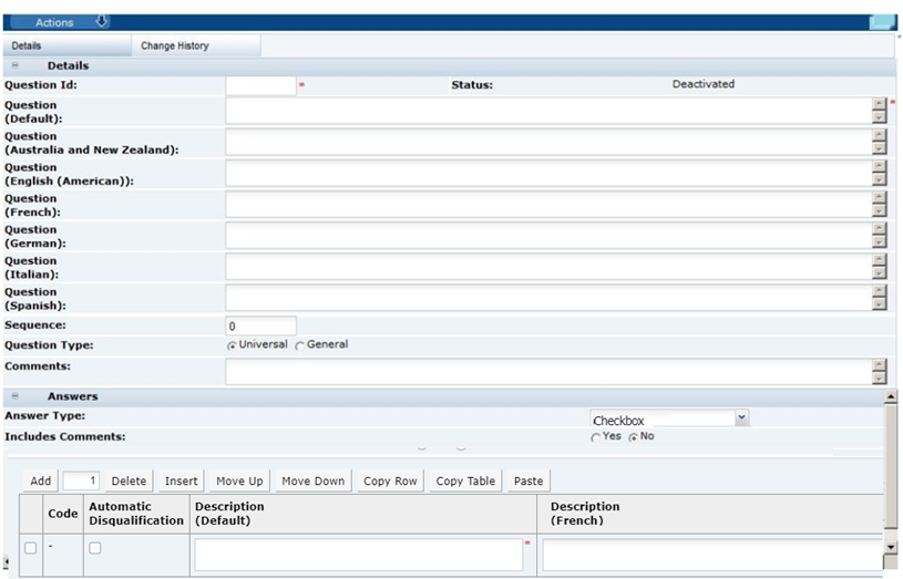

Assessment Questions

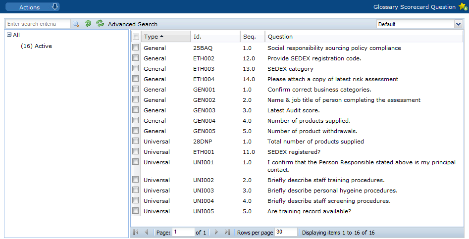

Each assessment template is comprised of a series of questions which may be selected from this glossary.
Figure 7-19 Glossary Assessment Question Page
To edit a question, select the question and then select the Edit action. A tab opens with the record in edit mode.
To create a new assessment question:
Select the New Question action. The Assessment Question tab opens.
Figure 7-20 New Assessment Question Page
In the Details section:
Question Id: Enter the ID for this question. The ID must be between 3 and 10 characters and unique. The value cannot be changed once the question has been created. This field is mandatory.
Status: The status is set to Deactivated.
Question: Enter the question in the default language. This field is mandatory.
Sequence: Enter the sequence number for this question. The sequence number is used to set the default order of questions within the assessment template.
Question Type: Select the type of question:
Universal questions are automatically added to a assessment template. These questions may be removed and individually re-added as required (if configured in System Parameters to allow removal).
General questions are manually added to a assessment template from the questions glossary. This is the default.
Comments: Enter any comments. This field is not mandatory.
In the Answers section:
Answer Type: Select the type of answers allowed for this question.
The available options are:
- Text - for descriptive responses.
- Radio - for a single response from multiple options.
- Checkbox - for one or more responses from multiple options.
- Single-select Picker - where the response is a single selection from a predefined list of options – see Assessment Picklists below.
- Multi-select Picker - as Single-select Picker but multiple response options can be selected.
- Tabular - for responses in the form of a table, where rows can be added to a table of predefined columns.
- Date - the response is a selected from a date picker.
- Numeric - requires the response to be a number.
- URL - when the answer is viewed it is shown as a link to the location given as the response.
Includes Comments: If set to Yes, a text field is included in the questionnaire to enable the user to enter any comments.
For Radio and Checkbox answer types, to add an answer choice, click Add. Enter the answer in the default language. This is a mandatory field. Enter any translations.
For Picklist answer types, select an option from the list of Assessment Picklists, click Ok. This is a mandatory field.
For Tabular answer types, configure the table columns by populating the table (each row represents a table column):
- Type is the type of data the column will accept – the options are Text, Numeric, URL or Single-select Picker.
- Assessment Picker is used when Type is Single-select Picker, to set the picklist to be presented, in which case this is a mandatory field.
- Description is the column heading. Enter the answer in the default language. This is a mandatory field. Enter any translations.
- The answer types that offer a choice have a Code automatically assigned to give each answer a unique reference.
The answer types that offer a choice can have answers set to Automatic Disqualification; when completing the Assessment, if the user chooses the option as their response, the Assessment it is flagged as being disqualified.
The disqualifications and a count of them are shown in the Assessment, to retailer users only.
When updating a question, the change is cascaded to any Assessment Templates and future Assessments which use the question. A batch job is submitted to apply the updates. Depending on the number of templates and assessments to be updated, the job may take some time to complete.

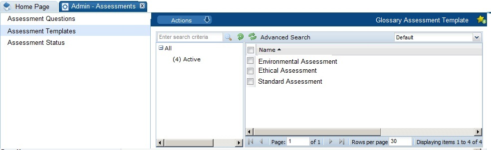

Assessments provide a means for the retailer to assess their suppliers on an on-going (or ad hoc) basis against a set of predefined criteria. Assessments are made up of a series of questions which may be answered by the suppler as a self-assessment or completed by the retailer.
Any number of types of assessment can be configured, with the option to use weighted scoring for the overall grading of suppliers' responses. On completion of a assessment, the next one can be automatically scheduled based on a predefined periodic or quarterly frequency.
Assessment templates define the rules that control the behavior of the different types of assessments. Every assessment is created from a template which defines the rules for how it behaves within the system, that is, the set of questions and permitted answers, the setting of basic default values, and whether certain fields are used or hidden.
Figure 7-21 Glossary Assessment Templates Page
To edit a template, select the entry and then select the Edit action. A tab opens in edit mode to enable you to edit the template. For an example of the content, see Figure 7-22.

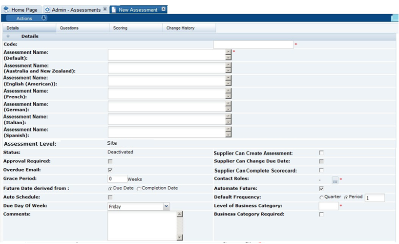

To create a new template:
Select the New Assessment Template action. The New Assessment Template tab opens.
Figure 7-22 New Assessment Template Page
Table 7-1 describes the fields in the Details section.
Table 7-1 New Assessment Template Fields
Field Description Code
Enter a unique code for this template. This field is mandatory.
Assessment Name
Enter the name for the template in the default language. This field is mandatory. Enter the translations.
Assessment Level Indicates that this type of assessment is to assess a Site. Status
Supplier Can Create Assessment
If checked, the supplier user can choose to create this type of assessment. The default is unchecked.
Supplier Can Change Due Date
If the supplier can create this type of assessment and this field is checked, the supplier user may also change the due date of this type of assessment. The default is unchecked.
Supplier Can Complete Assessment
If checked, the supplier user may choose to complete this type of assessment. The default is unchecked.
Approval Required
If the supplier can complete this type of assessment and if this field is checked, the retailer user is required to approve this assessment before the supplier can complete it. The default is unchecked.
Grace Period
Enter the number of days or weeks after the assessment's due date when it becomes overdue.
Overdue Email
If checked, an email is automatically generated to the supplier if the supplier has not completed the assessment by the time it becomes overdue.
Contact Roles
Select the roles for which supplier users receive the notifications if the assessment becomes overdue. The field is mandatory.
Future Date Derived From
These fields are used to control the rules for automatically scheduling subsequent assessments of this type, and when a assessment becomes overdue.
Automate Future versus Auto Schedule
If a assessment’s template is set to Automate Future the system will automatically create the next future assessment of this type for active sites that have previously had this type of assessment and do not already have one currently scheduled, or do have one scheduled but its due date has been reached. This ensures all sites that have this type of assessment always have one scheduled.
If a assessment’s template is set to Auto Schedule, the system prompts the user with the option to auto-schedule the next future assessment of this type for the site when the existing assessment is completed.
Automate Future
Auto Schedule
Default Frequency
Due Day Of Week
Level of Business Category
Enter the number of levels of business category to be recorded for this type of assessment. Set to zero if none are required. This is a mandatory field.
Business Category Required
If checked, the business category becomes mandatory when the assessment is completed.
Comments
Enter a comment regarding this template.
Set the questions for this type of assessment in the Questions tab using the tables of questions for Universal, General, and Ad Hoc Questions:
Universal questions are automatically added.
General Questions are selected from the glossary of Assessment Questions.
Ad Hoc questions can be entered specifically for this type of assessment.
The Preview indicates any answers that have been set as being an Automatic Disqualification, for example:
Once the questions have been added, the Refresh Preview action can be used to show the assessment as it will be presented to the supplier.
Select any scoring rules for this type of assessment in the Scoring subtab.
