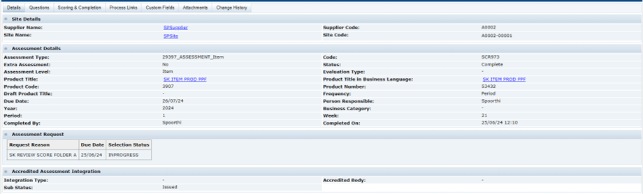

To view an assessment, double-click a row in the list. A tab opens with the assessment details.
Figure 8-1 Assessment Details Page
This figure shows the Assessment Details page.
The following table describes the fields on this page.
Field Description
Site Details
Supplier Name Name of the supplier.
Supplier Code Code assigned to the supplier.
Site Name Name of the site.
Site Code Code assigned to the site.
Assessment Details
Assessment Type Name of the template used to create the assessment.
Code The assessment’s unique reference id.
Status
Status of the assessment:
  • Future
  • In progress
  • Awaiting approval
  • Awaiting amendment
  • Complete
Assessment Level Identifies as being an assessment for an Item (product).
Evaluation Type If the assessment is aligned with a specific evaluation type.
Product Title The name of the product the assessment relates to.
Product Code The unique reference id of the related Product Record.
Product Number The product’s retailer reference number.
Draft Product Title If the assessment is not yet linked to a Product Record it will have a draft product title.
Due Date Date the assessment is due to be completed.
Year Year that corresponds to the due date based on the system calendar.
Period Period that corresponds to the due date based on the system calendar.
Week Week that corresponds to the due date based on the system calendar.
Quarter Start Date Quarter start date that corresponds to the due date based on the system calendar.
Quarter End Date Quarter end date that corresponds to the due date based on the system calendar.
Extra Assessment Set if this assessment was scheduled based on a frequency override.
Frequency Frequency for scheduling this assessment.
Person Responsible Name of the technologist responsible for the assessment.
Business Category Business categories applicable to this assessment.
Auto generation of this
assessment
If the Status field is Future, select whether to automatically reschedule this assessment when it is completed or becomes due.
Completed by Name of the user who submitted or completed the assessment.
Completed on Date the assessment was submitted or completed.
Assessment Request
Request Reason A table of request reason folder that the assessment appears within, as a result of being created using the Assessments Request wizard.
Due Date Date the assessment is due to be completed for the request reason folder.
Selection Status The current status of the request reason folder.
Accredited Assessment Integration
Integration Type If the assessment is eligible for integration with a third party for sourcing of data, the integration type will be Supplier Owned or Retailer Owned - depending in whether the supplier or retailer manages its progress with the third party.
Accredited Body If the assessment is integrated, the name of the nominated third party.
Sub Status If the assessment is integrated, the current status of the integration. The workflow stages are Issued, Pending, Retrieved, Responded.

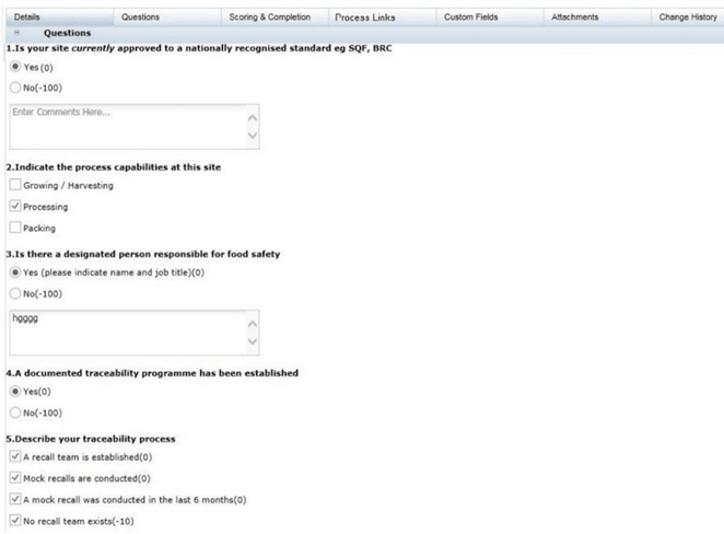

Questions Tab
To see the assessment questions, select the Questions subtab. The questions are presented as configured in the assessment's template for the supplier to provide their answers.

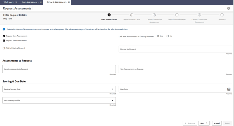

  1. Open the Assessments list view and Select the Request Assessments action. The wizard opens at step 1 (Enter Request Details).
    Figure 8-4 Enter Request Details
    This figure shows the Request Assessments page.
  2. Select whether creating Item and/or Site Assessments, and the types of assessments to be created.
    If creating Item Assessments, choose if the assessments are to be linked to existing Product Records.
    Enter a unique Reason for Request to group the assessment together, otherwise choose to add them to an existing group.
    Assign the person to be responsible for the assessments and the due date to be applied.
    If scoring is to be used for comparison and selection purposes, select the Review Scoring rule.

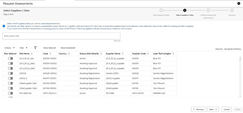

    Figure 8-5 Select Suppliers/Sites
    This figure shows the Select Suppliers/Sites page.
    Select the sites to have assessments created for them.
    If creating Item Assessments which are not linked to a Product Record, enter a Draft Product Title.

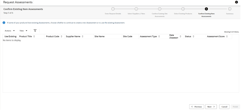

    Figure 8-8 Confirm Existing Item Assessments
    This figure shows the confirmation page.
    Select any existing assessments to be used. In this case, new assessments will not be created for this combination of assessment type and product; otherwise new assessments will be created.

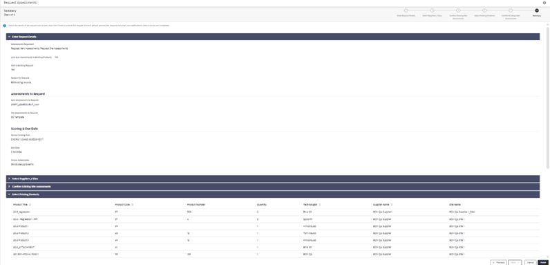

  7. Click Next to progress to the next step. This presents a summary of the selections that have been made in the preceding steps.
    Figure 8-9 Summary
    Click Finish to confirm the selections. A batch job is submitted to create the assessments. You will receive an email notification when it is complete.

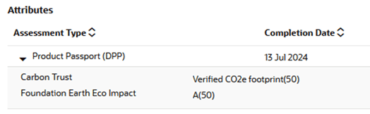

Summary Attributes
Assessment questions may be configured as summary attributes, meaning that the responses to the questions can be displayed in the info panel of the Assessment and associated Product Record or Site.
Each summary attribute has a label to identify what information the attribute represents. Within the info panel the summary attributes are grouped by their assessment as a list of pairs of labels and the values given as responses to the summary attribute questions.
This figure shows the summary attributes.
