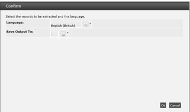

Extracting Suppliers
To extract Suppliers:
  1. Open a list view of Suppliers.
  2. Use the Advanced Search facility to filter the contents to the suppliers you wish to extract.
  3. Select the Extract Data action. The Confirm Data Extract dialog box appears.
    Figure 8-1 Confirm Data Extract Dialog Box
    This figure shows the Confirm Data Extract dialog box.
  4. Click the icon to select a language for which locale-dependent fields are to appear in the extract file. The default is your locale/language. This is a mandatory field.
  5. Click the icon to select a report output folder where the generated data file is to be saved.
  6. To continue with the extract, click Ok. To return to the list view, click Cancel.
    A submission confirmation message box is shown. Click Ok to return to the Suppliers list view.
    A Supplier-Site Data Extract batch job is submitted to create the extract file. On completion, you will receive an email notification with a link to the file in the Data Extracts area of the Report Outputs (see Viewing Extract Files).
    In the event of the maximum file size being exceeded, the extract file will truncated at the end of the last complete record and a final row output, reading: FILE TRUNCATED - SIZE LIMIT EXCEEDED. In this case, the file name will be prefixed: * INCOMPLETE.

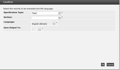

Extracting Product Specifications
To extract Product Specifications or Produce Product Specifications:
  1. Open a list view of Specifications or Produce Specifications.
  2. Use the Advanced Search facility to filter the contents to the specifications you wish to extract.
  3. Select the Extract Data action. The Confirm Specification Data Extract dialog box appears.
    Figure 8-2 Confirm Specifications Data Extract Dialog Box
    This shows Confirm Specifications Data Extract dialog box.
  4. Select the specification type. If no specifications of the selected type appear in the list view, the extract file will be empty. This field is omitted if extracting Produce specifications, otherwise it is mandatory.
  5. Select which section's data is to be extracted. The options are filtered based on the selected Specification Type. If no specifications of the selected type that appear in the list view contain the selected section type, the extract file will be empty. The field is mandatory.
  6. Click the icon to select a language for which locale-dependent fields are to appear in the extract file. The default is your locale/language. This is a mandatory field.
  7. Click the icon to select a report output folder where the generated data file is to be saved.
  8. To continue with the extract, click Ok. To return to the Confirm dialog box, click Cancel.
    A submission confirmation message box is shown. Click Cancel to return to the Specifications list view.
    A Product Specification Data Extract batch job is submitted to create the extract file. On completion, you will receive an email notification with a link to the file in the Data Extracts area of the Report Outputs (see Viewing Extract Files).

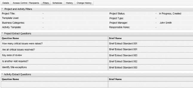

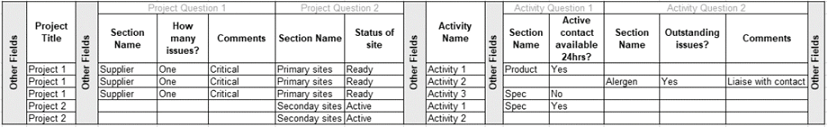

Process & Activity Brief Extracts
A data extract of Process and Activity Brief data can be scheduled as a report, utilizing pre-configured criteria for filtering Processes, Activities, and their Brief questions.
The Process & Activity Brief Extracts glossary is used to configure reusable data extract criteria. When scheduling the report, setting the report type as a Process & Activity Brief Extract allows for the extract criteria to be selected.
The extract is created as a spreadsheet, containing columns that represent data from the Process and Activity records, and their Brief questions and answers, as defined by the extract criteria. The generated extract is output to a Process & Activity Brief Extracts folder in the Report Outputs library. The user is emailed a link to the report output on completion.
A less comprehensive version of the Brief Extract is available for selection from the Processes and Activities list views. The output is also placed in the Process & Activity Brief Extracts folder in the Report Outputs library, and a link to the report output is emailed to the user on completion. Section Name is not visible in the Brief Extract confirmation step as it is not available to select as a list view field, however it is included in the generated output.

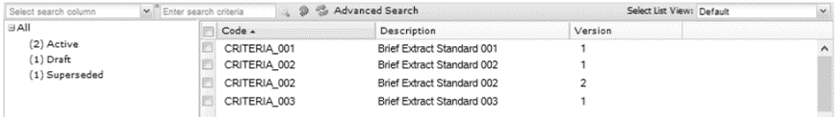

Maintaining the Extract Criteria
An Extract Criteria glossary is used to maintain a library of reusable extract criteria for applying filters to the Brief Extract reports, by optionally selecting Processes, Activities, and questions from the associated Process and Activity Briefs and current Brief template glossary records.
To access the Extract Criteria, select the Manage Process & Activity Brief Extracts option in the Reporting Admin area. This is only accessible to users with the Advanced Reporting Administrator authority profile.
Figure 8-4 Extract Criteria Page
This figure shows the Extract Criteria page.
To see the details for a specific extract criteria, double-click the row. A tab opens with the details. You can also select the View or Edit actions.
Extract Criteria glossary records cannot be imported and exported using the Import and Export list view actions.

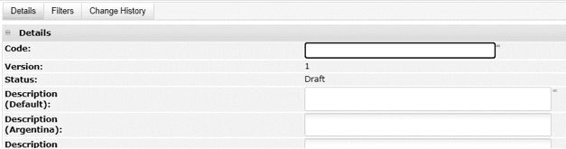

  1. Select the New action. The New Extract Criteria page appears.
    Figure 8-5 New Extract Criteria Page
    This figure shows the New Extract Criteria page.
  2. Enter the details.
    Table 8-2 New Extract Criteria Page
    Details Description
    Code
    Enter a unique uppercase code for this extract criteria. Mandatory field.
    Version
    The version will default to 1. Read-only field.
    Status
    This will default to Draft. Read-only field.
    Description
    Enter the description for this extract criteria in the supported languages. The description for the default language is mandatory.

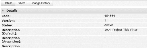

Editing an Extract Criteria
To edit an extract criteria, select the extract criteria on the Extract Criteria page and then select the Edit action. The extract criteria record opens in edit mode in a new tab.
Extract Criteria are maintained as a versioned glossary. When the extract criteria is created, it is assigned version 1 and the status will be Draft. At this status, the code, version, and status may not be edited.
Figure 8-6 Extract Criteria Details
This figure shows the Extract Criteria Details page.

Filters
Use the Filters page to define the extract criteria to be applied as the filter when generating the Brief Extract report.
Figure 8-7 Extract Criteria Details - Filters
This figure shows the Extract Criteria Details for filters.
To add a filter to an extract criteria:
  1. Open the extract criteria in edit mode and navigate to the Filters page.
  2. Add a row to the Questions tables and click Add.
  3. Enter the details.
    Table 8-3 Filters
    Details Description
    Process Filters
    Optionally choose any specific Processes to be included in the extract by selecting any combination of Process Titles, Parent Processes, Process Status, Process Templates, Process Types, Business Categories, and Process Managers.
    The Proposed Start and End dates can also be used to apply filters:
    • Proposed Start Date (From) includes Processes with a start date later than that specified; Proposed Start Date (To) includes Processes with a start date earlier than that specified. Use of both the filters creates a date range between which Process records will be included.
    • Proposed End Date (From) includes Processes with an end date later than that specified; Proposed End Date (To) includes Processes with an end date earlier than that specified. Use of both the filters creates a date range between which Process records will be included.
    If none are selected, all will be included (subject to other filters).
    Activity Filters
    Optionally choose any specific Activities to be included in the extract by selecting any combination of Activity Templates and Responsible Roles.
    Process Extract Questions
    When adding a row to the Process Extract Questions table, a list of Process Briefs is presented for the selection of their questions.
    Activity Extract Questions
    When adding a row to the Activity Extract Questions table, a list of Activity Briefs is presented for the selection of their questions.
  4. Save the changes and exit. If no Process or Activity questions have been selected, validation will show a warning message.

The following provides a guide to the extract layout.
Figure 8-9 Process & Activity Brief Extract Layout
This figure shows the Process & Activity Brief Extract layout.
