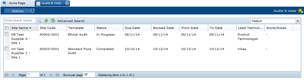

To work with audits and visits, select the Audits & Visits option from the Supplier drop-down list. The Audits & Visits tab opens.
Figure 6-1 Audit & Visits Page
This figure shows the Audits & Visits page.
The following columns are shown:
  • Site Name
  • Site Code
  • Template
  • Status
  • Due Date
  • Booked Date
  • From Date
  • To Date
  • Lead Technologist
  • Score/Grade
To edit an entry, select the row and then the Edit action. A tab opens in edit mode. For information on the fields shown for this tab, see Table 6-1.
To view details on an audit, double-click a row. A tab opens with the details.
