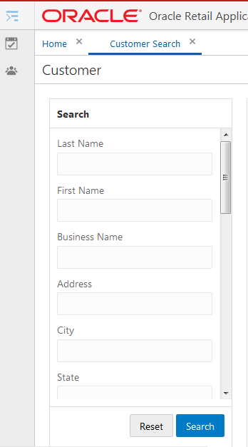

Customer Search
To search for a customer, enter any combination of the following search criteria and select Search. Optionally, select Reset to clear the entered search criteria.
Figure 4-1 Customer Search
This figure shows the Customer Search.

Search Criteria
  • Last Name - Customer last name.
  • First Name - Customer first name.
  • Business Name - Name of the customer's business.
  • Address - Address line for the customer. Searches address line 1 in the customer's primary address.s
  • City - City of the customer's primary address.
  • State - State or province of the customer's primary address.
  • Postal Code - Postal Code or ZIP Code of the customer's primary address.
  • Email Address - Customer's primary email address.
  • Phone Number - Customer's primary telephone number.
  • Second First Name - Customer's second first name.
This field appears only if the system is configured to display additional customer names. See the Implementation Guide for more information.
  • Second Last Name - Customer's second last name.
  • Customer ID - A unique identifier assigned by Customer Engagement. Searching on customer ID requires an exact match.
  • Alternate Key - Customer Alternate Key. A unique identifier assigned to identify the customer in an integrating system. Searching on Alternate Key requires an exact match.
  • Card Number - Card Number associated with the customer. Searching on card number requires an exact match.
  • Card Serial Number - Serial Number of the card associated with the customer. Searching on card serial number requires an exact match.
  • Associate ID - ID of an Associate assigned to the customer. Searching on associate ID requires an exact match.
  • Segment - Name and ID of a customer segment. Segments are listed alphabetically by Segment Name in ascending order with All segments at the top. Optionally, select an existing segment from the list to restrict results to customers in the segment, or leave this field set to All.
  • Franchisee - Name of the Franchisee. Franchisees are listed alphanumerically by franchisee name. Optionally, select a franchisee from the list to restrict results to customers associated with the franchisee, or leave this field set to All.
This field appears only if the Franchisee Support is enabled. See the Implementation Guide for more information.

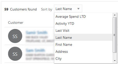

Figure 4-3 Sort-by Options
This figure shows the Sort by Options.
Sorting Customers
You can use the Sort by drop-down list to sort the list of Customers found by the following options:
  • Average Spend LTD - Select this option to list customers in descending order by average spend life-to-date (the total amount of the customer's purchases life-to-date divided by the number of purchases).
  • Activity YTD - The total amount of the customer's purchases year-to-date, displayed in the base system currency.
  • Last Visit - Select this option to list customers in descending order by the date of last visit (purchase).
  • Last Name [default] - Leave this option selected to list customers alphabetically by last name.
  • First Name - Select this option to list customers alphabetically by first name.
  • Address - Select this option to list customers alphanumerically by street address.
  • City - Select this option to list customers alphabetically by city name. Customers in the same city are listed alphabetically by last name.
  • State - Select this option to list customers alphabetically by state or province. Customers in the same state or province are listed alphabetically by last name.
