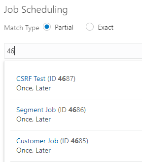

Job Quick Search
Job Quick Search displays a list of results as you type in characters in the search box. To use the Job Quick Search do the following:

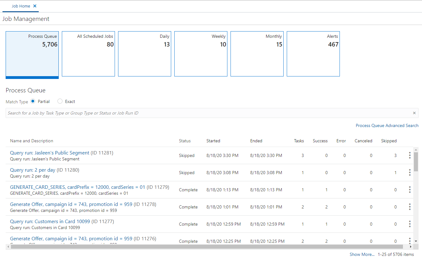

Click Job Home. The Job Management window opens.

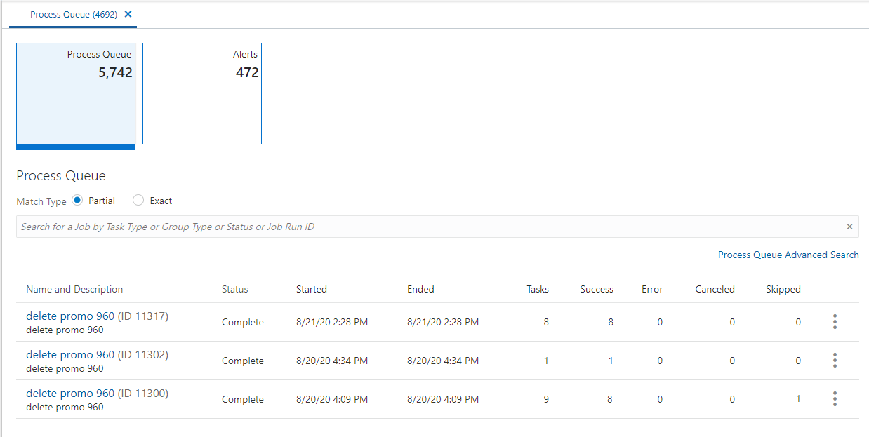

Figure 12-1 Job Management - Process Queue Tile
Select a Metric Tile, options include:
Process Queue
All Scheduled Jobs
Daily
Weekly
Monthly
Alerts
Job Quick Search - Process Queue and Alerts Tiles
These tiles display the following information for each job.
Name and Description - Name and Description of the Job.
Job Run ID - ID Number of the Job.
Status - Current status of the Job.
Started - The date and time at which the Job started running.
Ended - The date and time at which the Job stopped running.
Tasks - The number of Tasks performed by the Job.
Success - The number of Tasks completed successfully by the Job.
Error - The number of Tasks in the Job that resulted in an Error.
Canceled - The number of Tasks in the Job that were canceled.
Skipped - The number of Tasks in the Job that were skipped, possibly because an error occurred in a previous task.

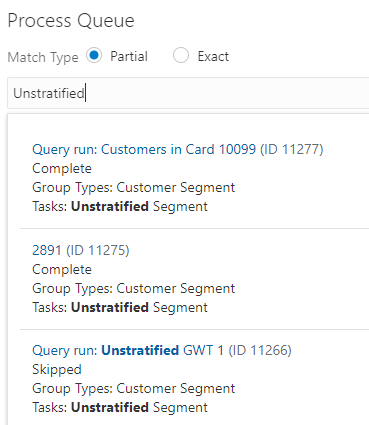

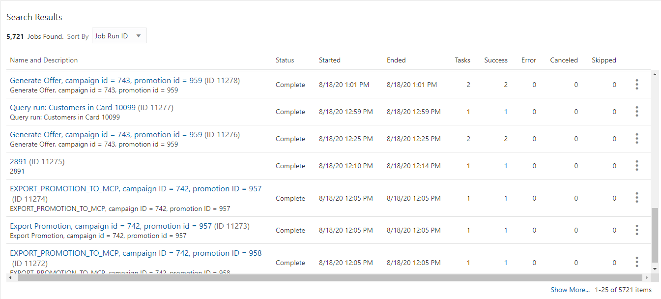

Perform the following steps to search for a Job:
Click the Process Queue or Alerts tile.
In the Search for a Job field, enter the Task Type, Group Type, Status or Job ID of the Job you want to search for. Select Partial to search for Jobs that partially match the search text, or select Exact, to search for an exact match.
Figure 12-2 Process Queue Quick Search Results
If more than 25 Jobs match the search criteria, the first 25 Jobs are displayed. Select Show More... at the bottom of the page to display more Jobs.
Click the Name which appears as a link for any Job to open the Job Details. See Viewing a Job in Process Queue for more information. Click the Action Menu to Refresh the Task Run details.
Figure 12-3 Action Menu Options - Quick Search

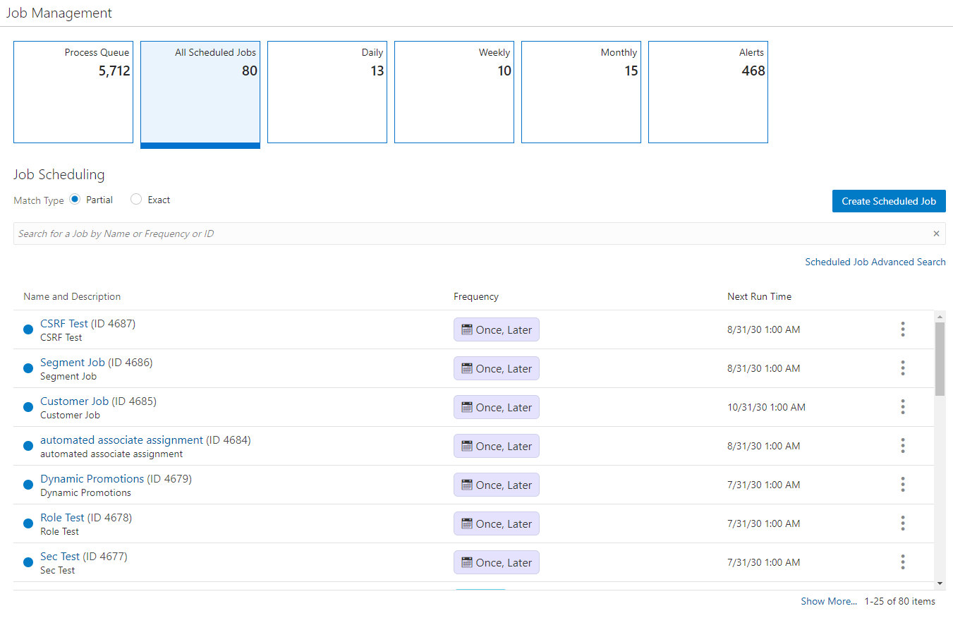

Figure 12-4 Job Management - All Scheduled Jobs Tile
The Job Scheduling Tiles displays the following information for each Job:
Job Status - Indicates whether the Job is currently enabled. A full circle indicates the Job is active. An empty circle indicates the job is inactive.
Frequency - The frequency at which the Job is performed.
Next Run Time - The Time at which the Job is run next.

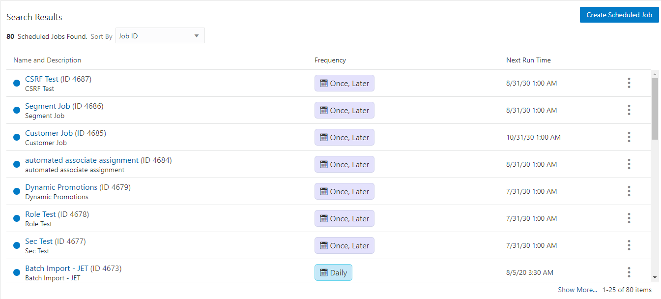

Figure 12-5 Jobs Scheduling Quick Search Results
Click the Name which appears as a link for any Job to open the Job Details. See Viewing a Scheduled Job for more information. Click the Action Menu to Delete, Disable, Edit, Enable, Run Job Immediately, or View Job in Process Queue.

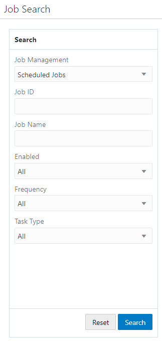

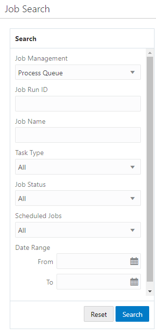

Job Advanced Search
The Job Advanced Search allows you to select more criteria that are not available in the Job Quick Search box. The Job Advanced Search is accessed by the following methods:
Click the Advanced Search link underneath the Job Quick Search box in the Job Home window.
Click Job Search in the Job Management menu. See Navigation for more information.
Job Advanced Search - Process Queue
Figure 12-7 Job Advanced Search - Process Queue
The following search fields are available when Job Management is set to Process Queue:

Job Advanced Search - Scheduled Jobs
Figure 12-8 Job Advanced Search - Scheduled Jobs
The following search fields are available when Job Management is set to Scheduled Jobs:
Job ID
Job Name
Enabled
All - Default
Yes
No
Frequency
All - Default
Once, Immediately
Once, Later
Daily
Daily, Business Days Only
Weekly
Monthly
Task Type - The type of task. The values in this Selection menu depend upon configuration. See the Oracle Retail Customer Engagement Implementation Guide for information about configuring custom task types.
Searching Jobs
Once all the desired information has been entered, click Search to see the results. If more than 25 results are returned, click the Show More… link to show the next 25 Jobs.
Figure 12-9 Advanced Search Results - Process Queue
Figure 12-10 Advanced Search Results - Scheduled Jobs
Click Reset to clear all fields and return list values to the default selections. You can also click Search without entering any criteria to see a complete list of Jobs.

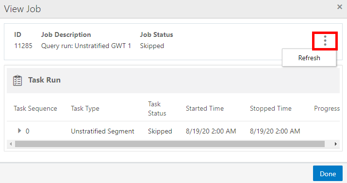

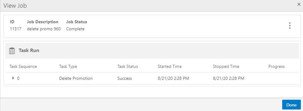

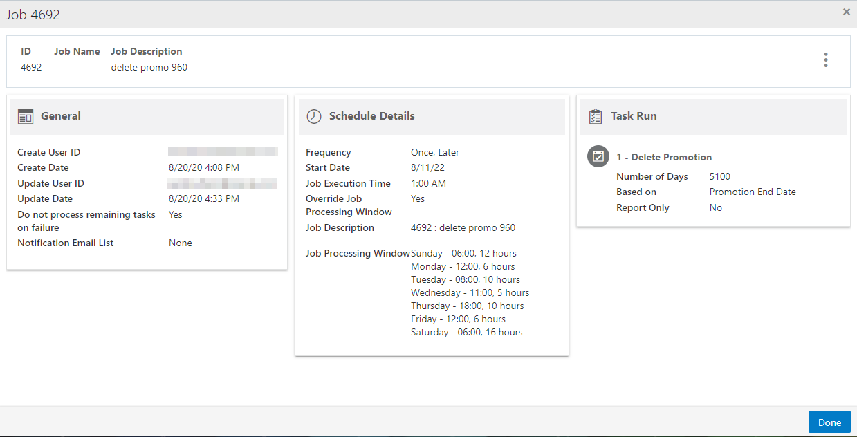

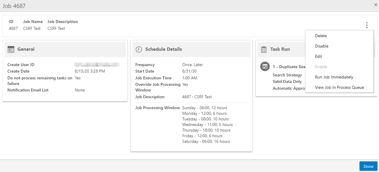

To view a scheduled job:
Search for a Job. See Job Quick Search or Job Advanced Search.
For the Job you want to view, click the Action Menu.
Click View. The Job opens.
Figure 12-11 Job View
Click Done to return to the Scheduled Job List.
To use the available options in the Action Menu, see Deleting a Job, Disabling a Job, Editing a Job, Enabling a Job, Running a Job Immediately, or Viewing a Job in Process Queue.

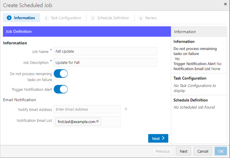

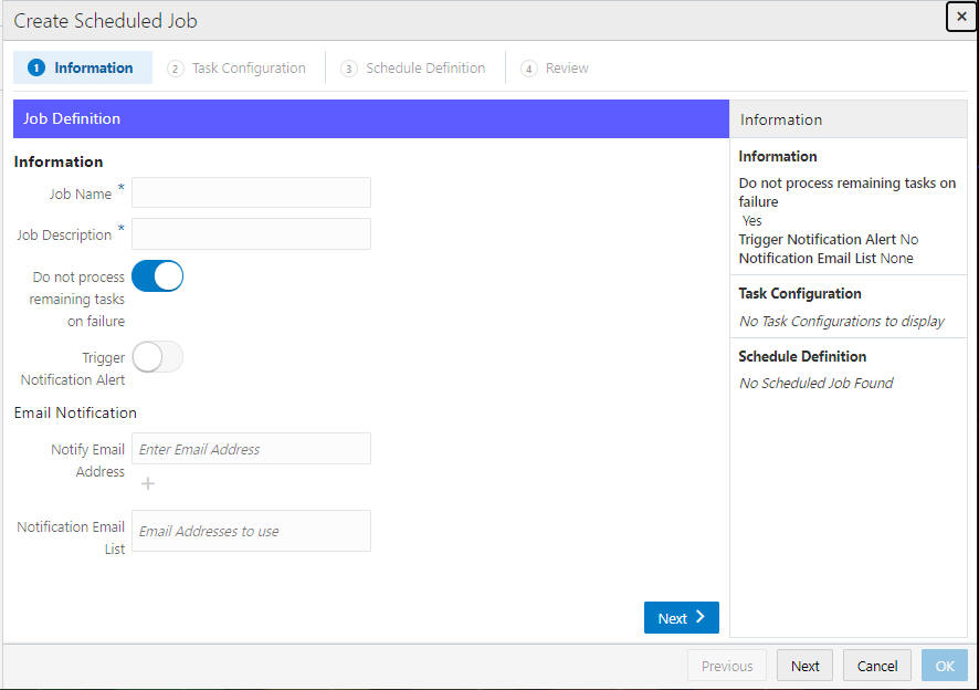

Enter the following for the Information tab.
Figure 12-14 Information Tab
Job Name (required)
Job Description (required)
Do Not Process Remaining Tasks on Failure - Default is ON.
Trigger Notification Alert - Toggle to ON to set up an alert that notifies users to items needing their attention when creating a scheduled job to be run in Customer Engagement. See Notifications for more information.
Notify Email Address - Enter one or more email addresses using the Plus icon to move each email address to the Notification Email List.
Notification Email List - This field populates as email addresses are entered.
Figure 12-15 Information Tab - Notification Email List
Click Next to continue to the Task Configuration tab.

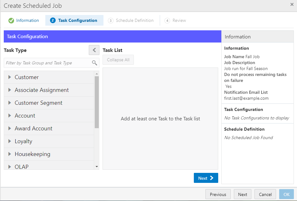

Figure 12-16 Task Configuration

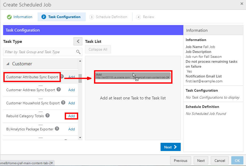

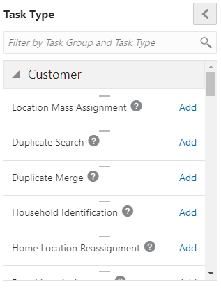

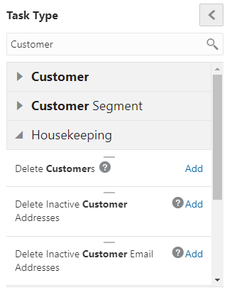

Building the Task List
To start the Task List selection, you can either filter by Task Group and Task Type or you can select one of the Templates to expand the Task Type selections.
To filter by Task Group and Task Type: In the Filter by Task Group and Task Type box, enter part or all of a Task Group or Task Type.
Press Enter, or click the Search icon.
Figure 12-17 Task Type - Filtered

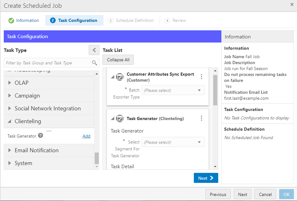

To see the available tasks in your filtered list, expand the Template to see the available choices from which to select.
To reset the filter, highlight the words and press Delete. Then press Enter, or click the Search icon.
In the Task Type selection list, click a Template Group to expand its list of Task List options. See Jobs and Tasks for more information about Task Type group organization.
Figure 12-18 Expanded Task Type List
Click the Add link, or drag and drop the Task Type Name into the Task List window.
Figure 12-19 Adding Task Types to Task List
Figure 12-20 Added Task Types
Repeat Step 3.e until all tasks are added.

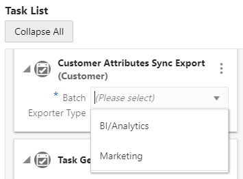

Enter the Task List Criteria into the appropriate fields. See Jobs and Tasks for more information about Task List fields.
Figure 12-21 Tasks
Figure 12-22 Task List Options

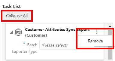

After entering the search criteria you can collapse or expand the details at any time. To collapse a task in the list, click the arrow next to each task. To change all tasks at once, click Collapse All/Expand All to Collapse/Expand.
When you need to clear a task from the Task List, click the Action Menu and then click Remove.

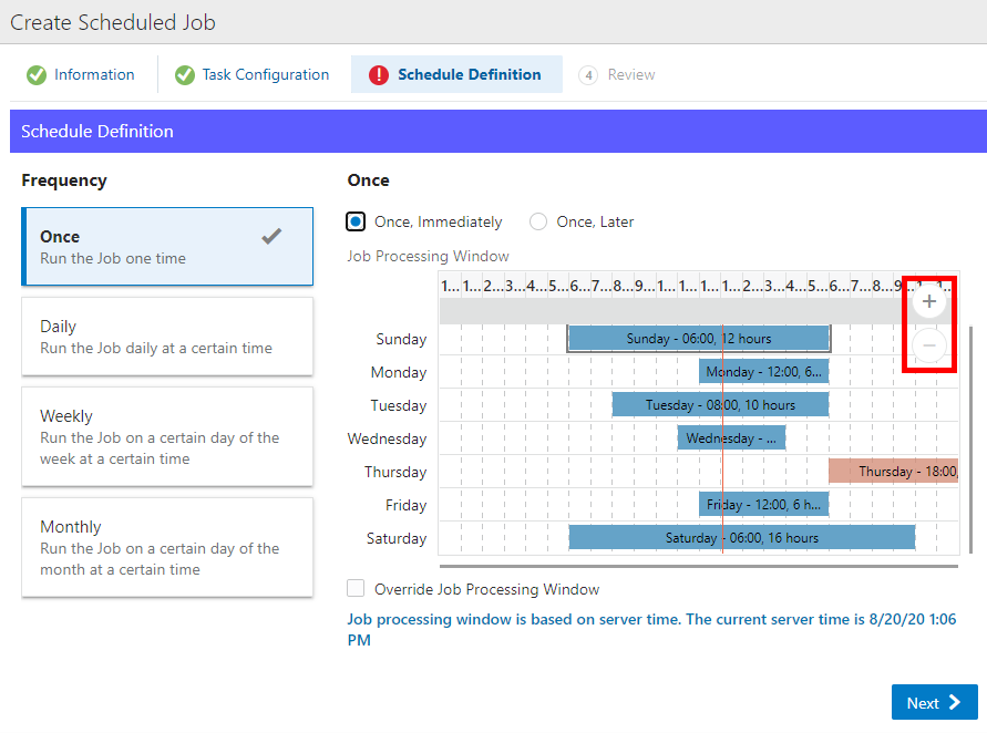

Enter the following for the Schedule Definition tab:
Figure 12-23 Schedule Definition Tab

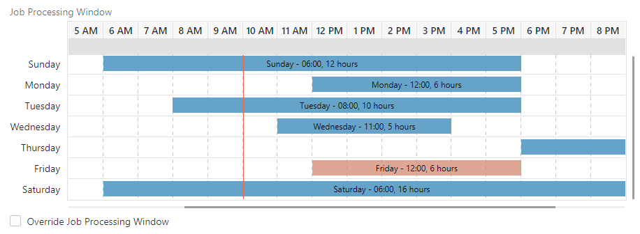

As shown in Figure Figure 12-23, hovering the mouse over the Job Processing Window enables the Zoom in and Zoom out icons. Click these icons to better view the days and times.
Select one of the following Job Execution Frequencies:
Once, Immediately to run the Job immediately, once you have finished creating/saving this job. If you select this option, continue with Step 6.f.
Once, Later to run the Job at a later date. If you select this option, continue with Step 6.a.
Daily to run the Job every day. If you select this option, continue with Step 6.a.
Daily, Business Days Only to run the Job only on business days (that is, Monday through Friday). If you select this option, continue with Step 6.a.
Weekly to run the Job once each week. If you select this option, continue with Step 6.a.
Monthly to run the Job once each month. If you select this option, continue with Step 6.a.
Use the Start Date Calendar Menu to select the start of the date range in which the Job will run. If you selected a Job Execution Frequency of Once, Later, continue with Step 6.e.
Use the End Date Calendar Menu to select the end of the date range in which the Job will run.
For Daily, Daily, Business Days Only, Weekly, and Monthly, if Disable End Date is selected, the End Date configuration is deactivated, leaving the Job in effect, forever. To enable the End Date Calendar Menu, clear the check box.
If you selected a Job Execution Frequency of Daily, or Daily, Business Days Only, continue with Step 6.e.
If you selected a Job Execution Frequency of Weekly, continue with Step 6.c.
If you selected a Job Execution Frequency of Monthly, continue with Step 6.d.
Use the Day of Week Selection check boxes to select the days of the week that you want the Job to run. Continue with Step 6.e.
Use the Day of Month Selection Menu to select the day of the month on which the Job will run.
Use the Job Execution Time Menus to determine the time at which the Job will run.
It is recommended that you select a time that is within the Job Processing Window. If you select a time outside the Job Processing Window, the Override Job Processing Window setting (see Step 6.f) must be checked for the Job to run.
Use the Override Job Processing Window Check Box to indicate whether the Job should run, even if it is scheduled outside the Job Processing Window. See the Job Processing Window for more information on how the Job Processing Window works.

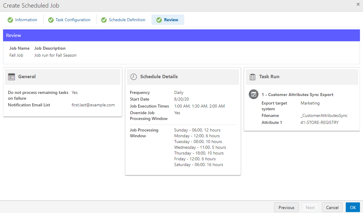

After defining the schedule, click Next to proceed to the Review tab.

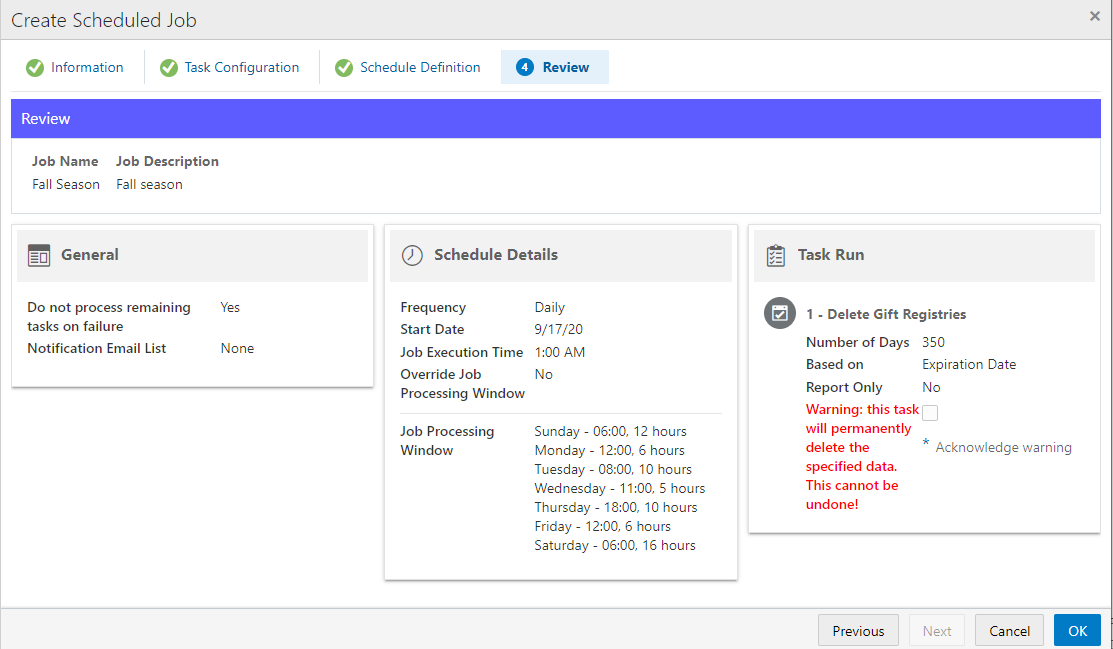

Figure 12-24 Review Tab
Before you can submit certain jobs, you need to acknowledge any warning in the Review step.
Figure 12-25 Review Tab - Confirm Choice Warning
Review the entered information to ensure that it is correct. Click OK to save the Job, or click Cancel to close the Job without saving. Click Previous or any Tab to return to any point of the Create Scheduled Job process.
Clicking OK triggers a confirmation notification to confirm the job has been created successfully.
Figure 12-26 Confirmation Notification

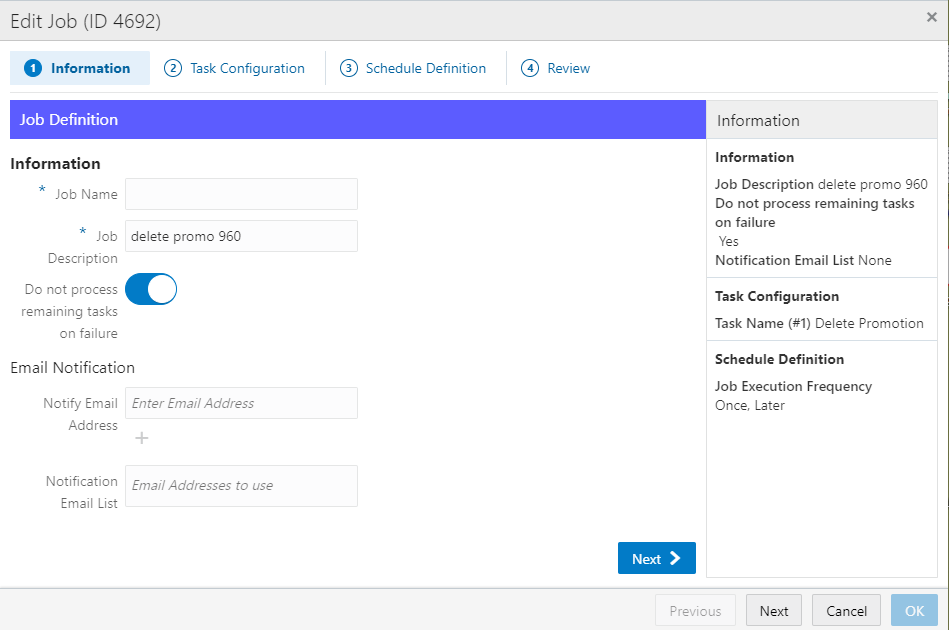

For the Job you want to edit, click the Action Menu.
Click Edit. The Job Create Wizard opens with all fields populated with the current configuration information.
Figure 12-28 Edit Job
Use Wizard Navigation to make any necessary changes. See Creating a Scheduled Job for a description of the fields and information.

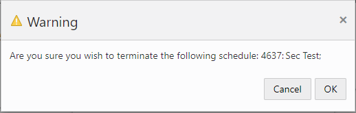

A warning message appears.
Figure 12-29 Warning Message
Click Ok to delete the job or Cancel to return to the Job.
To run an existing job immediately:
View a Job. See Viewing a Scheduled Job.
Click the Action Menu.
Click Run Job Immediately.
Figure 12-32 Confirmation Notification
A confirmation notification appears to confirm the job has been run.
Click Done to close the job and return to the Job List.
To view a job in the Process Queue:
Click View Job in Process Queue. The Process Queue opens with all of the previous runs of the selected Job in the Process Queue.
Figure 12-33 View Job in Process Queue
For the run you want to view details for, click the Action Menu.
Click View. The specific Job Run appears.
Figure 12-34 Job Run Details
Click the Action Menu and then click Refresh to update the Task Run fields.
Click Done to close the job and return to the Process Queue for that job.
Jobs and Tasks
Jobs include one or more tasks that are chained together to run sequentially.
Each Job has additional parameters that must be configured. For information about these parameters, see Configure Job Parameters.The type of tasks that can be scheduled within a job are described in this section.
Customer Tasks
This section describes customer tasks.
Location Mass Assignment
This task searches Customer transaction histories in a selected date range and assigns each Customer to a Home Location, based on where the Customer shopped most frequently over the chosen date range.
In the database, there are two location fields: Home Location and Sign-Up Location. The system expects to see the Sign-Up Location populated from the POS or other data entry client. This field is static.
The Home Location field is intended to be the location to which the Customer is assigned as their primary location. As an example; it is possible that a Customer signs up in a location during a trip. However, there is a location in the Customer's neighborhood and subsequent to sign up, the Customer is seen to shop there regularly. As a basic management function, the administrator wants to assign the Customer to this location.
As Customers move around and as a retailer opens and closes locations it is a common, on-going requirement to assign and re-assign Customers to a home location. The Location Mass Assignment task will re-assign Customers to the home location where they shopped most frequently during the selected date range.
See Location Mass Assignment for job scheduling details.

Customer Attributes Sync Export
Create a file for export to a marketing system or a business intelligence/analytics system. The data includes details on customer attributes.
See Customer Attributes Sync Export for job scheduling details and generated files.

Housekeeping Tasks
This section describes housekeeping tasks.
When a database contains large amounts of old data, database performance and response may be slowed. To prevent the overburdening of the database with old, unneeded information, housekeeping tasks can be performed to remove old information.
Delete Award Inquiry Activities
This task deletes old award inquiry activities.
See Delete Award Inquiry Activities for job scheduling details.
Delete Batch Process Tracking
This task deletes old Batch Process Tracking records. Consolidated daily, weekly, and monthly records are stored in XMLAPI record tables in the database, and used to display information at the Batch Process Tracking pages.
See Delete Batch Process Tracking for job scheduling details.
Delete Customers
The Delete Customers task removes old Customer records that are no longer needed.
See Delete Customers for job scheduling details.
The parameters that must be configured for a given task depend upon the task being defined.
The processes performed by these jobs are described above in Jobs and Tasks.
The following sections describe the fields that configure each task.
This Task has the following parameters:
Date Range Type - This Selection Menu determines the Date Range used.
Start Date - This Calendar Menu determines the first date of the Date Range (only available if Date Range Type is set to Specific Date Range).
End Date - This Calendar Menu determines the final date of the Date Range (only available if Date Range Type is set to Specific Date Range).

Customer Address Sync Export
This task has the following parameters:
Batch Exporter Type - Defaults to BI/Analytics and cannot be changed.
Export type - Defaults to Export all active records and cannot be changed.
Specify export filename - The setting of the Retail Insights Customer Activities Sync Default Filename property is displayed and cannot be changed.
This task has the following parameter:
Batch Exporter Type - Select either Marketing or BI/Analytics.
Customer Attributes Sync Export - Marketing
If you select a Batch Exporter Type of Marketing, complete the following parameters:
Specify export filename - These fields control the creation of the CSV file containing new or updated customer attribute records. At least one entry (prefix, static name, or suffix) is required:
Prefix - The date and time stamp format to use as a prefix for naming the export file:
no prefix - Do not use a date and time stamp prefix on the file name.
yyyyMMdd_HHmmss - Use a date and time stamp prefix in this format (for example, 20160630_123456 where the year is 2016, the month is June, the date is 30, and the time is 12:34:56).
yyyy-MM-dd_HHmmss - Use a date and time stamp prefix in this format (for example, 2016-06-30-123456, where the year is 2016, the month is June, the date is 30, and the time is 12:34:56).
The setting of the Responsys Export Filename Default Prefix property defaults.
Static Name - The text string to include in the file name between the prefix and suffix, if any. The setting of the Responsys Customer Attributes Sync Default Filename property defaults.
Suffix - The date and time stamp format to use as a suffix for naming the export file. The date and time stamp format options for the suffix are the same as for the prefix, described above. The setting of the Responsys Export Filename Default Suffix property defaults.
Filename - Displays an example of the export file name with the prefix and suffix format, if any. This field is blank if you have not yet selected a prefix format, suffix format, or static name.
Seq and Attribute - Use the drop-down list to select each attribute to include in the export file. Only attributes that have the Publish To Batch Exporter and Open Access flags selected are available for selection from the drop-down.

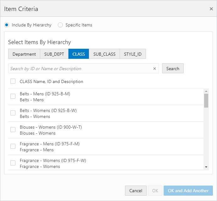

Include by Hierarchy
There are two ways to search for items in the Include by Hierarchy option, either:
Select one of the Hierarchy choices (Department or Class, for example) and click Search to retrieve all associated hierarchies.
Select one of the Hierarchy choices and enter part or all of the ID, Name, or Description in the field, and click Search to retrieve your refined search criteria.
After locating the items, then select or clear the check boxes from the list.
Figure 12-35 Item Criteria - Include By Hierarchy
Click OK to add the item to the Task or click OK and Add Another to add another item. Click Cancel to close the window without adding the item.
Click X to remove added items.

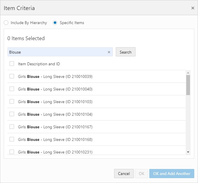

Specific Items
To search for items by specific items:
Enter the ID or Description of the Item.
Click Search.
Figure 12-36 Item Criteria - Specific Items
Select or clear the check boxes from the list.
Click X to remove items.

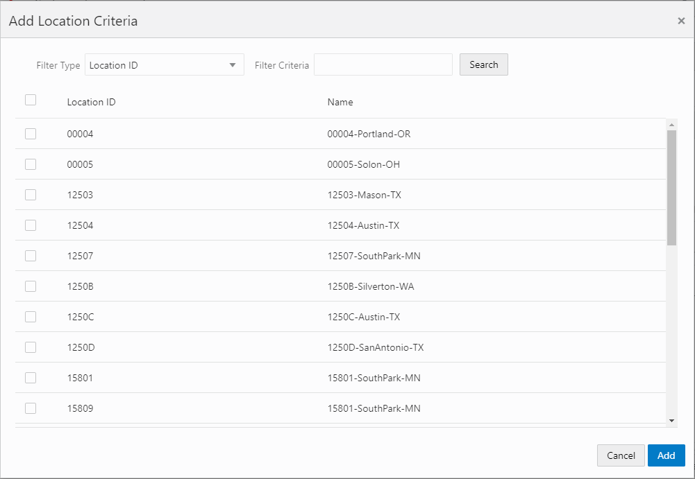

When Select criteria from list is selected, the Item and Location Criteria appear. To configure Location Criteria do the following:
Click +Add Location Criteria.
Figure 12-37 Add Location Criteria
Click the list arrow to select a Filter Type.
Click Search to return all Locations that meet the Filter Type Criteria.
You can use the Filter Criteria field before or after a search. The Filter Criteria is determined by your implementer.
The Filter Criteria field accepts partial input.
Click Add to add the location to the task. Click Cancel to close the window without adding the location.
Click X to remove added locations.

Segment Sync Export - BI/Analytics
If you select a Batch Exporter Type of BI/Analytics, the following parameters are displayed:

Select target batch exporter system - Set to Marketing by default.
Export type - Controls which records to include in the export file:
Export all active records - Include all active award account and award coupon records.
Export updated records only - Include award account and award coupon records only if they have changed since the last export. With this selection, the Once Immediately and Once Later options for scheduling the job are not available
Note that, regardless of your selection here, the first time you run the export all, active award account and award coupon records are included.
Specify export filename - These fields control the creation of the file containing new or updated award account records.
Prefix - The date and time stamp format to use as a prefix for naming the export file.
Static Name - The text string to include in the file name between the prefix and suffix, if any. The setting of the Responsys Award Account Sync Default Filename property defaults.
Specify export filename - These fields control the creation of the file containing new or updated award coupon records.

Loyalty Account Sync Export
Before you submit this task, you must select an export target system of either Marketing for a system such as Responsys, or BI/Analytics for a system such as Retail Insights. The Supported Batch Exporter Types property controls which of these options are available. See the Oracle Retail Customer Engagement Implementation Guide for more information about System Configuration.
Loyalty Account Sync Export - BI/Analytics
If you select BI/Analytics as the export target system, the following options are displayed:
Export all active records - Include all active loyalty account records.
Export updated records only - Include loyalty account records only if they have changed since the last export. With this selection, the Once Immediately and Once Later options for scheduling the job are not available.
Note that, regardless of your selection here, the first time you run the export all active loyalty account records are included.
Specify export filename - If you selected an Export type of BI/Analytics, the setting of the Retail Insights Loyalty Account Sync Export Default Filename property is displayed and cannot be changed.

Delete Customers
Number of Days - This Text Field defines the number of days after a Customer's Last Purchase Date on which a Customer is deleted.
Based On - A field that describes what the Number of Days field is determined by.
Report Only - This toggle indicates whether the Task only reports the number of Customers that would be deleted, or if the Customers are deleted.
On () - Only a count of the Customers are reported.
Off () - The Customers are deleted.
Delete Inactive Customers
Number of Days - This Text Field defines the number of days after a Customer's Last Update Date on which a Customer is deleted.
On - Only a count of the Customers are reported.
Off - The Customers are deleted.

Delete Promotion
Number of Days - This Text Field defines the number of days after a Promotion's End Date on which a Promotion is deleted.
Report Only - This toggle indicates whether the Task only reports the number of Promotions that would be deleted, or if the Promotions are deleted.
On - Only a count of the Promotions are reported.
Off - The Promotions are deleted.

Delete Gift Registries
Number of Days - This Text Field defines the number of days after a Gift Registry's Expiration Date on which the Gift Registry is deleted.
Report Only - This toggle indicates whether the Task only reports the number of Gift Registries that would be deleted, or if the Gift Registries are deleted.
On - Only a count of the Gift Registries are reported.
Off - The Gift Registries are deleted.

Task Generator
Select Segment For Task Generator - This Selection Menu determines the Segment for which tasks are generated.
Task Type - This field cannot be edited.
Subject - [required] This Text Field defines the subject line for the tasks.
End after X days - This Text Field defines the number of days from the present day that the task will end.
Skip if issued within X days - This Text Field defines a number of days before the present date in which, if the customer had a task created within those days, the job will not generate a task for that customer.
Status - This field cannot be edited.
Priority - This Selection Menu defines the priority for the created tasks.
Associate Assignment Detail - These Radio Buttons determine the associate role for the associate who is assigned each task.
Assign to Primary - Assign each task to the customer's primary associate.
Assign to Role - Assign each task to the associate assigned to a specified role.
If Assign to Role is selected, a Selection Menu is enabled for determining the associate role to use when assigning the tasks.
Note Type - This Selection Menu determines the type of note (if any) to add to each task.
Note - This Text Area Field is used to enter the text of a note (if any) to add to each task.
