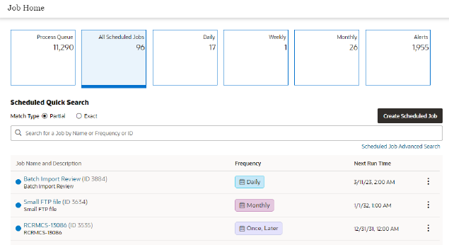

In Customer Engagement, Job Management is used to view and edit Jobs scheduled to be run in Customer Engagement.
Job Quick Search
Job Quick Search displays a list of results as you type in characters in the search box. To use the Job Quick Search do the following:
Click the Menu icon.
Click Job Management.

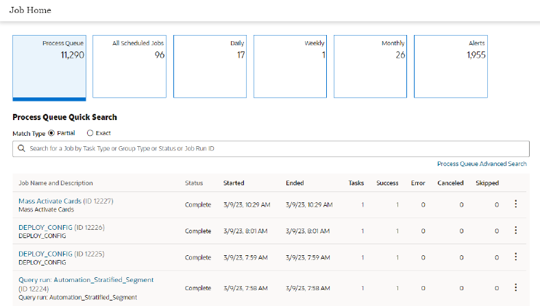

Click Job Home. The Job Management window opens.
Figure 12-1 Job Management - Process Queue Tile
Select a Metric Tile, options include:
Process Queue
All Scheduled Jobs
Daily
Weekly
Monthly
Alerts
Job Quick Search - Process Queue and Alerts Tiles

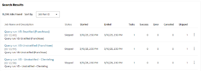

These tiles display the following information for each job.
Name and Description - Name and Description of the Job.
Job Run ID - ID Number of the Job.
Status - Current status of the Job.
Started - The date and time at which the Job started running.
Ended - The date and time at which the Job stopped running.
Tasks - The number of Tasks performed by the Job.
Success - The number of Tasks completed successfully by the Job.
Error - The number of Tasks in the Job that resulted in an Error.
Canceled - The number of Tasks in the Job that were canceled.
Skipped - The number of Tasks in the Job that were skipped, possibly because an error occurred in a previous task.

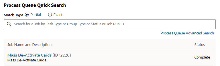

Perform the following steps to search for a Job:
Click the Process Queue or Alerts tile.
In the Search for a Job field, enter the Task Type, Group Type, Status or Job ID of the Job you want to search for. Select Partial to search for Jobs that partially match the search text, or select Exact, to search for an exact match.
Figure 12-2 Process Queue Quick Search Results
Click the Name which appears as a link for any Job to open the Job Details. See Viewing a Job in Process Queue for more information. Click the Action Menu to Refresh the Task Run details.

Job Quick Search - Job Scheduling Tiles
Scheduled Jobs are a list of Jobs that are configured to be run by the system. They include the following tiles:
All Scheduled Jobs
Daily
Weekly
Monthly
Figure 12-4 Job Home - All Scheduled Jobs Tile
The Job Scheduling Tiles displays the following information for each Job:
Job Status - Indicates whether the Job is currently enabled. A full circle indicates the Job is active. An empty circle indicates the job is inactive.
Frequency - The frequency at which the Job is performed.
Next Run Time - The Time at which the Job is run next.

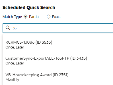

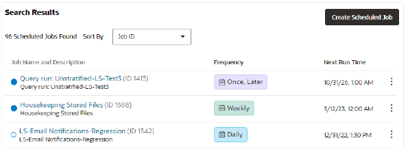

Perform the following steps to search for a Job.
Click the All Scheduled Jobs, Daily, Weekly, or Monthly tile.
In the Search for a Job field, enter the Name, Frequency, or Viewing a Job in Process Queue of the Job you want to search for. Select Partial to search for Jobs that partially match the search text, or select Exact, to search for an exact match.
Figure 12-5 Jobs Scheduling Quick Search Results
Click the Name which appears as a link for any Job to open the Job Details. See Viewing a Scheduled Job for more information. Click the Action Menu to Delete, Disable, Edit, Enable, Run Job Immediately, or View Job in Process Queue.
Figure 12-6 Action Menu Options - Quick Search

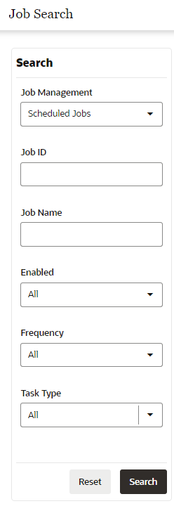

Job Advanced Search
The Job Advanced Search allows you to select more criteria that are not available in the Job Quick Search box. The Job Advanced Search is accessed by the following methods:
Click the Advanced Search link underneath the Job Quick Search box in the Job Home window.
Click Job Search in the Job Management menu. See Navigation for more information.

The following search fields are available when Job Management is set to Scheduled Jobs:
Job ID
Job Name
Enabled
All - Default
Yes
No
Frequency
All - Default
Once, Immediately
Once, Later
Daily
Daily, Business Days Only
Weekly
Monthly
Task Type - The type of task. The values in this Selection menu depend upon configuration. See the Oracle Retail Customer Engagement Implementation Guide for information about configuring custom task types.
Searching Jobs
Once all the desired information has been entered, click Search to see the results.
Figure 12-9 Advanced Search Results - Process Queue
Figure 12-10 Advanced Search Results - Scheduled Jobs
Click Reset to clear all fields and return list values to the default selections. You can also click Search without entering any criteria to see a complete list of Jobs.

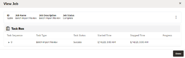

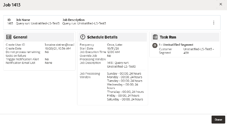

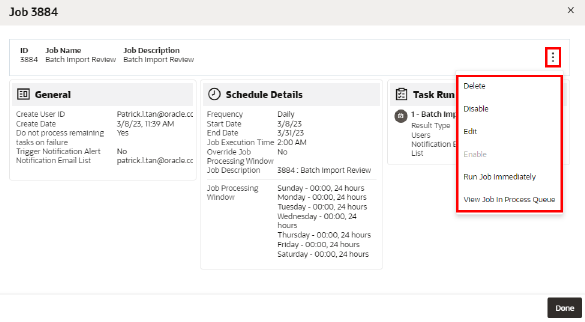

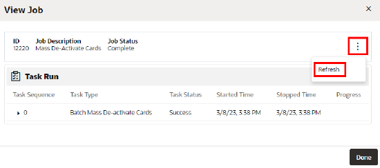

To view a scheduled job:
Search for a Job. See Job Quick Search or Job Advanced Search.
For the Job you want to view, click the Action Menu.
Click View. The Job opens.
Figure 12-11 Job View
Click Done to return to the Scheduled Job List.
To use the available options in the Action Menu, see Deleting a Job, Disabling a Job, Editing a Job, Enabling a Job, Running a Job Immediately, or Viewing a Job in Process Queue.
Creating a Scheduled Job
There are a two choices available to start the process of creating a Scheduled Job. Access the Create Scheduled Job button from either:
Job Home
Job Search
To access the Create Scheduled Job wizard: Proceed to Step 2.
Or use this alternate method:

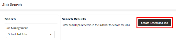

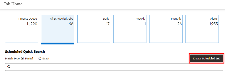

To Create a new Scheduled Job from Job Search: Click the Create Scheduled Job button, which will open the Scheduled Job wizard on the Information tab. .
From Job Home, click Create Scheduled Job which opens the Schedule Job Wizard on the information tab. Proceed to Step 2
Figure 12-12 Job Home
To access the Create Scheduled Job button, you must select either the All Scheduled Jobs, Daily, Weekly, or Monthly tile.
From Job Search, click Create Scheduled Job which opens the Scheduled Job wizard on the Information tab. Proceed to Step 2
Figure 12-13 Job Search

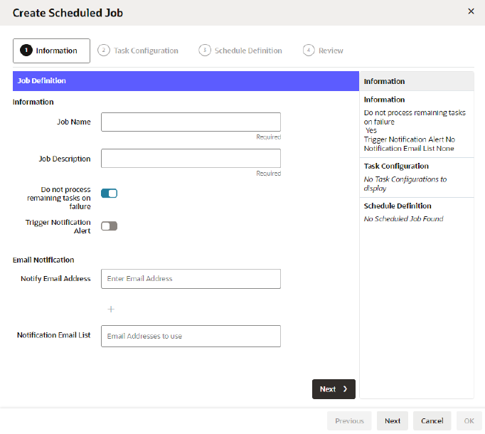

Enter the following for the Information tab.
Figure 12-14 Information Tab
Job Name (required)
Job Description (required)
Do Not Process Remaining Tasks on Failure - Default is ON.
Trigger Notification Alert - Toggle to ON to set up an alert that notifies users to items needing their attention when creating a scheduled job to be run in Customer Engagement. See Notifications for more information.
Notify Email Address - Enter one or more email addresses using the Plus icon to move each email address to the Notification Email List.
Notification Email List - This field populates as email addresses are entered.
Click Next to continue to the Task Configuration tab.

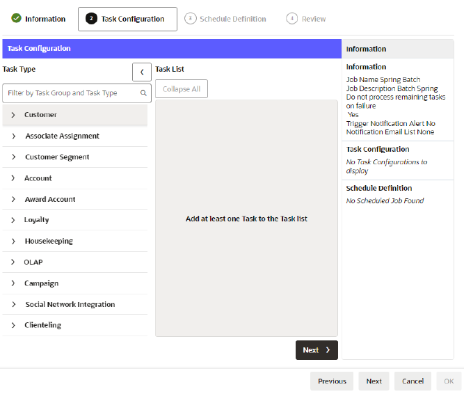

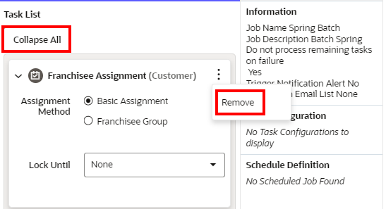

Figure 12-15 Task Configuration

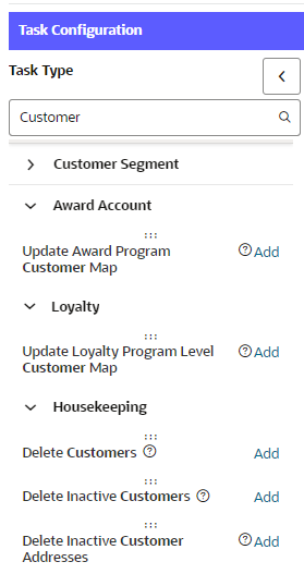

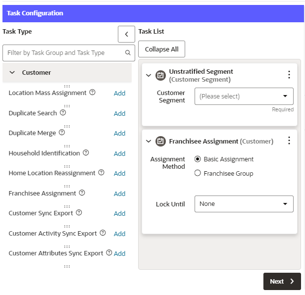

Building the Task List
To start the Task List selection, you can either filter by Task Group and Task Type or you can select one of the Templates to expand the Task Type selections.
To filter by Task Group and Task Type: In the Filter by Task Group and Task Type box, enter part or all of a Task Group or Task Type.
Press Enter, or click the Search icon.
Figure 12-16 Task Type - Filtered
To see the available tasks in your filtered list, expand the Template to see the available choices from which to select.
To reset the filter, highlight the words and press Delete. Then press Enter, or click the Search icon.
In the Task Type selection list, click a Template Group to expand its list of Task List options. See Jobs and Tasks for more information about Task Type group organization.
Figure 12-17 Expanded Task Type List
Click the Add link, or drag and drop the Task Type Name into the Task List window.
Figure 12-18 Adding Task Types to Task List
Figure 12-19 Added Task Types
Repeat Step 3.e until all tasks are added.

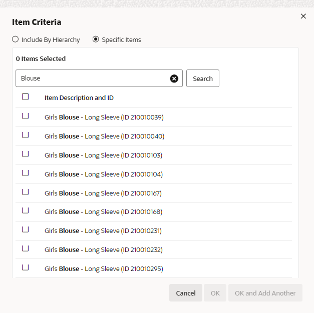

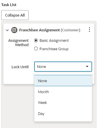

Enter the Task List Criteria into the appropriate fields. See Jobs and Tasks for more information about Task List fields.
Figure 12-20 Tasks
Figure 12-21 Task List Options
After entering the search criteria you can collapse or expand the details at any time. To collapse a task in the list, click the arrow next to each task. To change all tasks at once, click Collapse All/Expand All to Collapse/Expand.
When you need to clear a task from the Task List, click the Action Menu and then click Remove.
Click Next to go to the Schedule Definition tab.

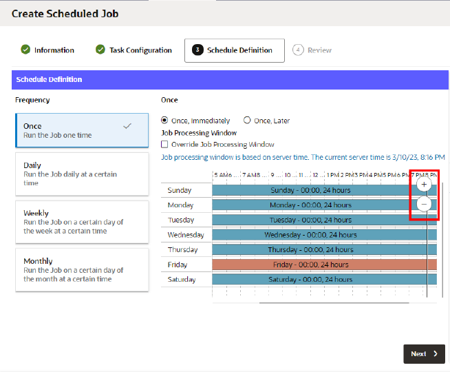

Enter the following for the Schedule Definition tab:
Figure 12-22 Schedule Definition Tab

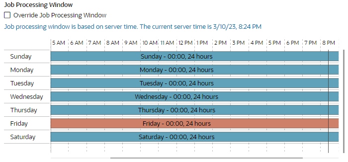

As shown in Figure Figure 12-22, hovering the mouse over the Job Processing Window enables the Zoom in and Zoom out icons. Click these icons to better view the days and times.
Select one of the following Job Execution Frequencies:
Once, Immediately to run the Job immediately, once you have finished creating/saving this job. If you select this option, continue with Step 6.f.
Once, Later to run the Job at a later date. If you select this option, continue with Step 6.a.
Daily to run the Job every day. If you select this option, continue with Step 6.a.
Daily, Business Days Only to run the Job only on business days (that is, Monday through Friday). If you select this option, continue with Step 6.a.
Weekly to run the Job once each week. If you select this option, continue with Step 6.a.
Monthly to run the Job once each month. If you select this option, continue with Step 6.a.
Use the Start Date Calendar Menu to select the start of the date range in which the Job will run. If you selected a Job Execution Frequency of Once, Later, continue with Step 6.e.
Use the End Date Calendar Menu to select the end of the date range in which the Job will run.
For Daily, Daily, Business Days Only, Weekly, and Monthly, if Disable End Date is selected, the End Date configuration is deactivated, leaving the Job in effect, forever. To enable the End Date Calendar Menu, clear the check box.
If you selected a Job Execution Frequency of Daily, or Daily, Business Days Only, continue with Step 6.e.
If you selected a Job Execution Frequency of Weekly, continue with Step 6.c.
If you selected a Job Execution Frequency of Monthly, continue with Step 6.d.
Use the Day of Week Selection check boxes to select the days of the week that you want the Job to run. Continue with Step 6.e.
Use the Day of Month Selection Menu to select the day of the month on which the Job will run.
Use the Job Execution Time Menus to determine the time at which the Job will run.
It is recommended that you select a time that is within the Job Processing Window. If you select a time outside the Job Processing Window, the Override Job Processing Window setting (see Step 6.f) must be checked for the Job to run.
Use the Override Job Processing Window Check Box to indicate whether the Job should run, even if it is scheduled outside the Job Processing Window. See the Job Processing Window for more information on how the Job Processing Window works.

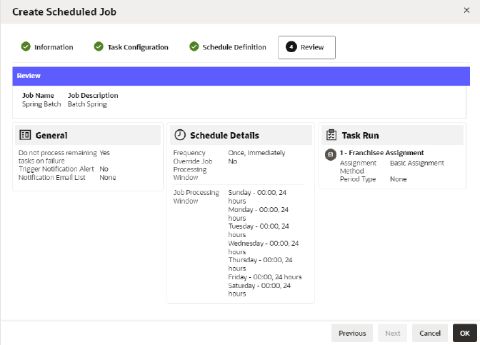

After defining the schedule, click Next to proceed to the Review tab.
Figure 12-23 Review Tab

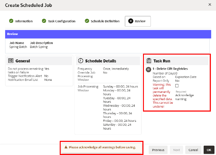

Before you can submit certain jobs, you need to acknowledge any warning in the Review step.
Figure 12-24 Review Tab - Confirm Choice Warning
Review the entered information to ensure that it is correct. Click OK to save the Job, or click Cancel to close the Job without saving. Click Previous or any Tab to return to any point of the Create Scheduled Job process.
Clicking OK triggers a confirmation notification to confirm the job has been created successfully.

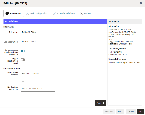

Editing a Job
To edit an existing Job:
Navigate to Job Home. See Job Quick Search.
Click the All Scheduled Jobs tile.
The Scheduled Jobs list appears.
Search for the Job. See Job Quick Search - Job Scheduling Tiles or Job Advanced Search.
For the Job you want to edit, click the Action Menu.
Click Edit. The Job Create Wizard opens with all fields populated with the current configuration information.
Figure 12-27 Edit Job
Use Wizard Navigation to make any necessary changes. See Creating a Scheduled Job for a description of the fields and information.
When you are finished making changes to the Job, do one of the following, either:
Click Save to save the Job with the current settings and return to the Scheduled Jobs List or
Click Cancel to delete all changes and return to the Scheduled Jobs List.

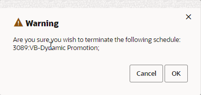

Deleting a Job
To delete an existing job:
View a Job. See Viewing a Scheduled Job.
Click the Action Menu.
Click Delete.
A warning message appears.
Figure 12-28 Warning Message
Click Ok to delete the job or Cancel to return to the Job.
Click Enable. A confirmation notification appears to confirm the job is enabled.
Figure 12-30 Confirmation Notification
Click Done to close the job and return to the Job List.
A filled circle before the Job Name indicates the job is enabled.
To run an existing job immediately:
Click Run Job Immediately.
Figure 12-31 Confirmation Notification
A confirmation notification appears to confirm the job has been run.
To view a job in the Process Queue:
Click View Job in Process Queue. The Process Queue opens with all of the previous runs of the selected Job in the Process Queue.
Figure 12-32 View Job in Process Queue
For the run you want to view details for, click the Action Menu.
Click View. The specific Job Run appears.
Figure 12-33 Job Run Details
Click the Action Menu and then click Refresh to update the Task Run fields.
Click Done to close the job and return to the Process Queue for that job.

Jobs include one or more tasks that are chained together to run sequentially.
Each Job has additional parameters that must be configured. For information about these parameters, see Configure Job Parameters.The type of tasks that can be scheduled within a job are described in this section.

Unstratified Segment
This task finds Customers to be entered into an Unstratified Segment and counts the number of Customers in the Segment. For more information on Unstratified Segments, see Unstratified Segments.
See Unstratified Segment for job scheduling details.
Stratified Segment
This task organizes Customers into user-defined levels and counts the number of Customers in each strata level. For more information on Stratified Segments, see Stratified Segments.
See Stratified Segment for job scheduling details.

Batch Import Review
Allows the Batch Import Review settings to be maintained.
See Batch Import Review for job scheduling details.

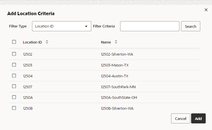

To add a Location:
Click the Click here to select Link. A Search Home Location Window opens.
Select the Location in the Selection Menu.
Click the OK button. The Search Home Location Window closes and the Location is added to the Reassign to area.
To delete a Location:
Click to select the Location in the Reassign to area.
Click the Delete Link. The Location is removed.

Franchisee Assignment
This task has the following parameters:
Assignment Method - These Radio Buttons determine how Customers are assigned to Franchisees.
Basic Assignment - [default] Check whether the Franchisee Assignment for each Customer record needs to be changed.
Franchisee Group - Assign Customers from one Franchisee among a set of Franchisees.
Currently Assigned To - This Selection Menu determines which Franchisee's Customers are reassigned. This field is only shown when Franchisee Group is selected in the Assignment Method Radio Buttons.
Franchisee Group - The area displays the set of Franchisees among which the Customers are reassigned. This field is only shown when Franchisee Group is selected in the Assignment Method Radio Buttons.
Lock Until - After a Customer is assigned to a Franchisee by this task, that Customer cannot be assigned to a new Franchisee during the period of time determined by this Selection Menu.

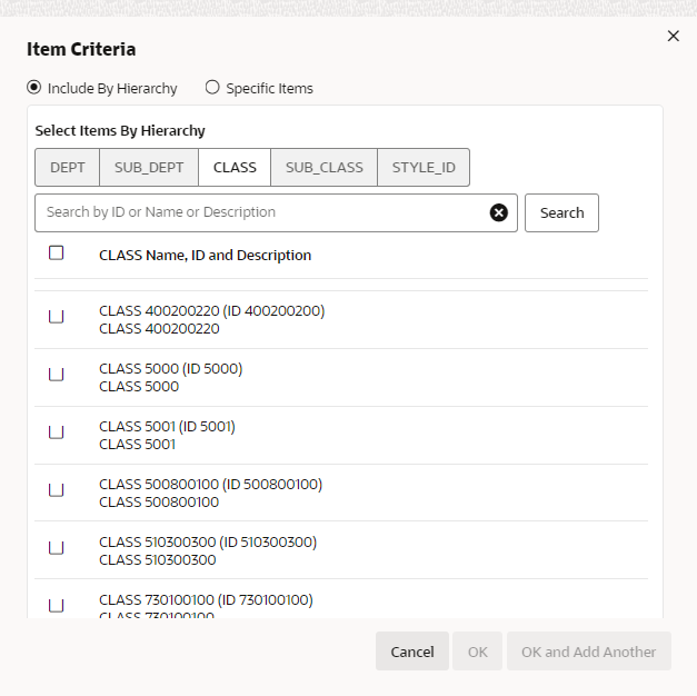

When Select criteria from list is selected, the Item and Location Criteria appear. To configure Item Criteria, perform on of the following options:
Use the Quick Add option to enter a known ID which you wish to associate with this task. Click Add.
Click the Actions Menu and select Add Item Criteria.
Click +Add Item Criteria.
Include by Hierarchy
There are two ways to search for items in the Include by Hierarchy option, either:
Select one of the Hierarchy choices (Department or Class, for example) and click Search to retrieve all associated hierarchies.
Select one of the Hierarchy choices and enter part or all of the ID, Name, or Description in the field, and click Search to retrieve your refined search criteria.
After locating the items, then select or clear the check boxes from the list.
Figure 12-34 Item Criteria - Include By Hierarchy
Click OK to add the item to the Task or click OK and Add Another to add another item. Click Cancel to close the window without adding the item.
Click X to remove added items.
Specific Items
To search for items by specific items:
Enter the ID or Description of the Item.
Click Search.
Figure 12-35 Item Criteria - Specific Items
Select or clear the check boxes from the list.
Click X to remove items.
When Select criteria from list is selected, the Item and Location Criteria appear. To configure Location Criteria do the following:
Click +Add Location Criteria.
Figure 12-36 Add Location Criteria
Click the list arrow to select a Filter Type.
Click Search to return all Locations that meet the Filter Type Criteria.
You can use the Filter Criteria field before or after a search. The Filter Criteria is determined by your implementer.
The Filter Criteria field accepts partial input.
Click Add to add the location to the task. Click Cancel to close the window without adding the location.
Click X to remove added locations.

Delete Customers
This Task has the following parameters:
Number of Days - This Text Field defines the number of days after a Customer's Last Purchase Date on which a Customer is deleted.
Based On - A field that describes what the Number of Days field is determined by.
Report Only - This toggle indicates whether the Task only reports the number of Customers that would be deleted, or if the Customers are deleted.
On () - Only a count of the Customers are reported.
Off () - The Customers are deleted.
Delete Inactive Customers
Number of Days - This Text Field defines the number of days after a Customer's Last Update Date on which a Customer is deleted.
On - Only a count of the Customers are reported.
Off - The Customers are deleted.

Delete Gift Registries
Number of Days - This Text Field defines the number of days after a Gift Registry's Expiration Date on which the Gift Registry is deleted.
Report Only - This toggle indicates whether the Task only reports the number of Gift Registries that would be deleted, or if the Gift Registries are deleted.
On - Only a count of the Gift Registries are reported.
Off - The Gift Registries are deleted.
