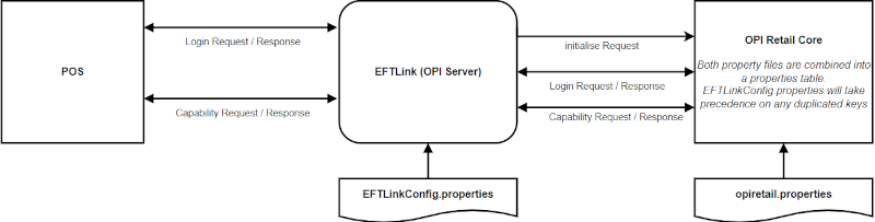

This chapter describes the concept and the configuration of running EFTLink Dynamic Cores.
Dynamic configuration is controlled via the EFTLinkConfig.properties setting DynamicConfiguration (true by default) and can either be set to true or false.
This allows a POS to override the configuration of EFTLink and any active core that would normally receive their instruction from their respective properties files. This is achieved by the POS sending through an Administrative Service request. There are five sub types of Administrative Service request, these are detailed in the table below:

An Initialise request must be sent before a logon request. If an Initialise request is sent specifying an EPSCore, then EftlinkConfig.properties is not used and all properties that deviate from defaults setting must come from within the request. Any properties specified inside an EPSCore element is targeted to that core only whereas any properties specified outside are used for all specified cores declared in the service request. Core properties are read in from their respective property files. However, any properties specified within this request will take precedence. |

Figure 3-1 EFTLink and Core Initialized through the reading in of Property Files followed by Capability Request
