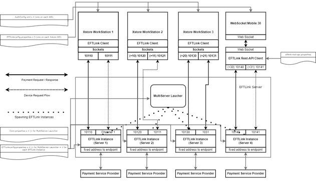

EFTLink Server - (static one-to-one)
An EFTLink server is essentially multiple instances of EFTLink running where each instance is communicating over its own TCP socket. This allows for a POS/register and the EFTLink instance to have a static 1-1 mapping where each EFTLink instance can communicate using one or more active cores to the corresponding PSP’s.
Figure 2-1 EFTLink Server - static one-to-one
EFTLink Server -static one-to-one
The diagram above shows EFTLink Server running 4 instances of EFTLink which bridges a POS to a dedicated PSP. This configuration can be achieved by following the below configuration steps.

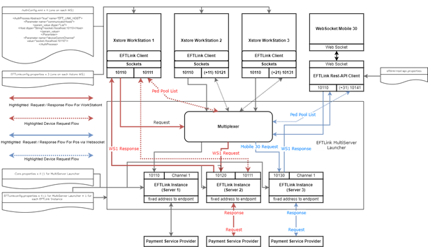

EFTLink Server - PEDPooling
Many-to-many mapping between POS and payment system/terminal. Each POS is allocated a fixed pair of sockets (channel 0/1) that connect to a multiplexer/switch. The multiplexer implements rules and/or uses interactive dialogs with the POS operator to determine which EFTLink instance to pass the request on to.
Figure 2-2 EFTLink Server - PEDPool Remote Mode
The diagram above shows EFTLink Server running 3 instances of EFTLink which are serving four clients. Three of the clients are communicating directly by TCP sockets whereas the fourth client is using websockets so requires the EFTLink Rest-api-client to interpret the requests into EFTLink.

There are two different ways that Xstore can be set up to use with EFTLink in Server Mode.
All configurations illustrated below are part of the Xstore AuthConfig.xmlconfiguration file.
One to One Port Mapping
(Static Server Mode)
This is where there is one Xstore or Xstore Mobile client served from the Jetty instance. It will divert all requests to a single port pairing that is managed inside the EFTLink Server instance. If another POS client is configured to use the same port pairing, it will potentially be blocked out until the port pair becomes free. In this mode, EFTLink Server will allow a single device to use many PEDs through the PED pooling functionality. EFTLink Server does not support load balancing of requests through one port pair so this configuration is not recommended if there are many Xstore mobile clients in the store solution.
If this configuration is suitable then the Xstore Mobile configuration is identical to the standard Xstore configuration. The 'communicatorHosts' parameter is used to set the channel 0 URL and 'deviceCommChannel' is used to set the channel 1 URL, as illustrated below. In this configuration when Xstore or Xstore Mobile starts an authorization request EFTLink will process the authorization request in the expected way, or if PED pooling is enabled, it will send a list of available PEDs for an associate to choose. Once the associate has chosen a PED, the authorization will proceed in the expected way.
<AuthProcess name="EFT_LINK_HOST" Abstract="true">
    <Parameter name="communicatorHosts">
      <param_value dtype="List">
        <Host dtype="String">socket://localhost:10100;timeout=1000</Host>
      </param_value>
    </Parameter>
    <Parameter name="deviceCommChannel" value="socket://localhost:10101" />
    <Parameter name="additionalWorkstationHostsMap">
      <param_value dtype="Map">
        <MapEntry>
          <key dtype="Integer">1</key> <!-- workstation id -->
          <value dtype="EFTLinkCommunicationChannels">
            <Channel0 dtype="String">socket://localhost:10110</Channel0>
            <Channel1 dtype="String">socket://localhost:10111</Channel1>
          </value>
        </MapEntry>
       <MapEntry>
          <key dtype="Integer">2</key> <!-- workstation id -->
            <Channel0 dtype="String">socket://localhost:10120</Channel0>
            <Channel1 dtype="String">socket://localhost:10121</Channel1>
          </value>
        </MapEntry>
      </param_value>
    </Parameter>
  </AuthProcess>

In order to setup Xstore this way, the EFTLinkConfig.properties in the main folder in EFTLink (for example, C:\eftlink) should be copied in the working directory of Xstore or Xstore mobile (for example, C:\xstore or C:\xstoremobile). The list of POS, should be the same as in the EFTLink server side.
pos1.description = POS 1
pos2.description = POS 2
pos3.description = POS 3
The additional WorkstationHostsMap parameter is not needed anymore. If the default channel zero is used (for example, ServerChannel0 = 10100), then make sure to update the port in the Host section of the communicatorHosts to 10110. If ServerChannel0 is different, simply add 10 to it. Then deviceCommChannel's port is plus 1 of the Host's port.
        <Host dtype="String">socket://localhost:10110;timeout=1000</Host>
      </param_value>
    </Parameter>
    <Parameter name="deviceCommChannel" value="socket://localhost:10111" />
  </AuthProcess>
