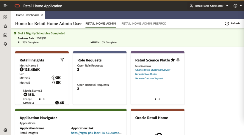

Figure 2-3 Retail Home Dashboard

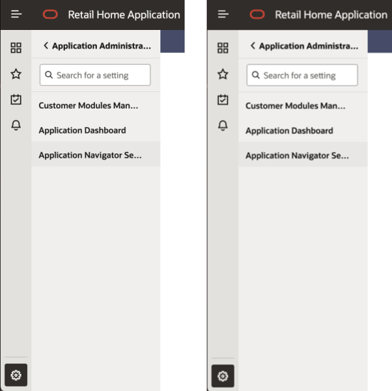

The Application Navigator Setup page can be launched from the Retail Home Settings menu's Application Administration section.
Figure 2-4 Application Navigator Setup Link in Settings

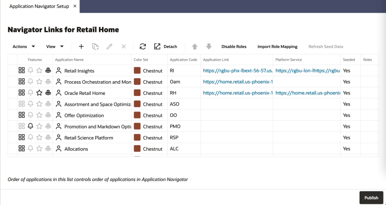

The Application Navigator Setup page shows a table of all the application navigator entries currently configured in Retail Home.
Figure 2-5 Application Navigator Setup Page
Retail Home Application Navigator Setup
The following information is shown for each application:
  • Features - Displays whether these features are enabled or not for this application: Application Navigator, Notifications, Favorites, and Resource Bundle Customizations.
  • Application Name - The name that will be displayed in Application Navigator menus and in Retail Home Dashboard Tiles.
  • Color Set - The color scheme used to display this application in the Retail Home Application Navigator menu and in Retail Home Dashboard Tiles.
  • Application Code - The unique code associated with a Retail Application. This is required to support features such as Favorites, Notifications and Resource Bundle Customization.
  • Application Link - The URL used to launch the application from Application Navigator menus or from the header of a dashboard tile.
  • Platform Service - The URL used to access Platform ReST Services. This is required to support features such as Favorites, Notifications and Resource Bundle Customization.
  • Seeded - Shows whether the application was seeded by Retail Home
The table toolbar gives users the ability to add, duplicate, edit, delete, refresh and reorder applications, as well as manage roles associated with each application.
Table Toolbar

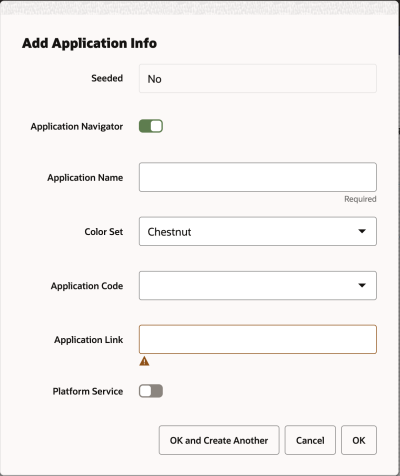

The Add icon Add Icon on the table toolbar allows users to add a new Application Navigator entry in Retail Home.
To add an application navigator entry, users enter the following information in the "Add Application Info" dialog:
  • Seeded - Shows whether the application is a seeded application or not.
  • Application Navigator Switch - Controls whether the application will be displayed in the Retail Home Application Navigator menu.
  • Application Name - A unique name for the application that will be displayed in the Application Navigator menus and in the Retail Home Dashboard Tile header.
  • Color Set - The color scheme used to display this application in the Retail Home Application Navigator menu and for the background of the Retail Home Dashboard Tile.
  • Platform Service Switch - Controls the display of options under platform services (URL & sup-ported features).
  • Platform Service URL - The URL used to access Platform ReST Services. This is required to support features such as Favorites, Notifications and Resource Bundle Customization.
  • Platform Service Supported Features - Check boxes to determine whether Notifications, Favorites & Resource Bundle Customization is available for the application.
Figure 2-6 Add Application Info Dialog
Add Applicatio Info Dialog
Saving the New Application Navigator Entry
The OK and OK and Create Another buttons in the "Add Application Info" dialog will save all entered values in the dialog into Retail Home.
