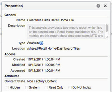

BI templates require one or more BI Analysis Catalog Locations. The BI Analysis Catalog Location is the path to the analysis within RI.
The analysis path is a combination of the analysis's Location and Name, as found in the analysis's Properties within RI.
For example:
/shared/Retail Home/Dashboard Tiles/Clearance Sales Retail Home Tile
Figure 6-6 Clearance Sales Retail Home Tile - Analysis Path
In the above example, the analysis's Location is /shared/Retail Home/Dashboard Tiles and the analysis's Name is Clearance Sales Retail Home Tile. The full BI Analysis Catalog Path is formed by joining the Location and Name with a /.
