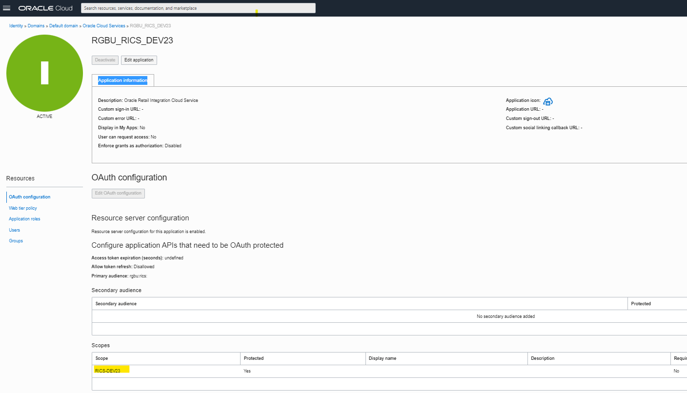

Use Client Credentials grant type with scope to provide access to resource.
Following is the screen shot of a sample IDCS app with scope added
Follow IDCS documentation for detailed instruction on setup.
