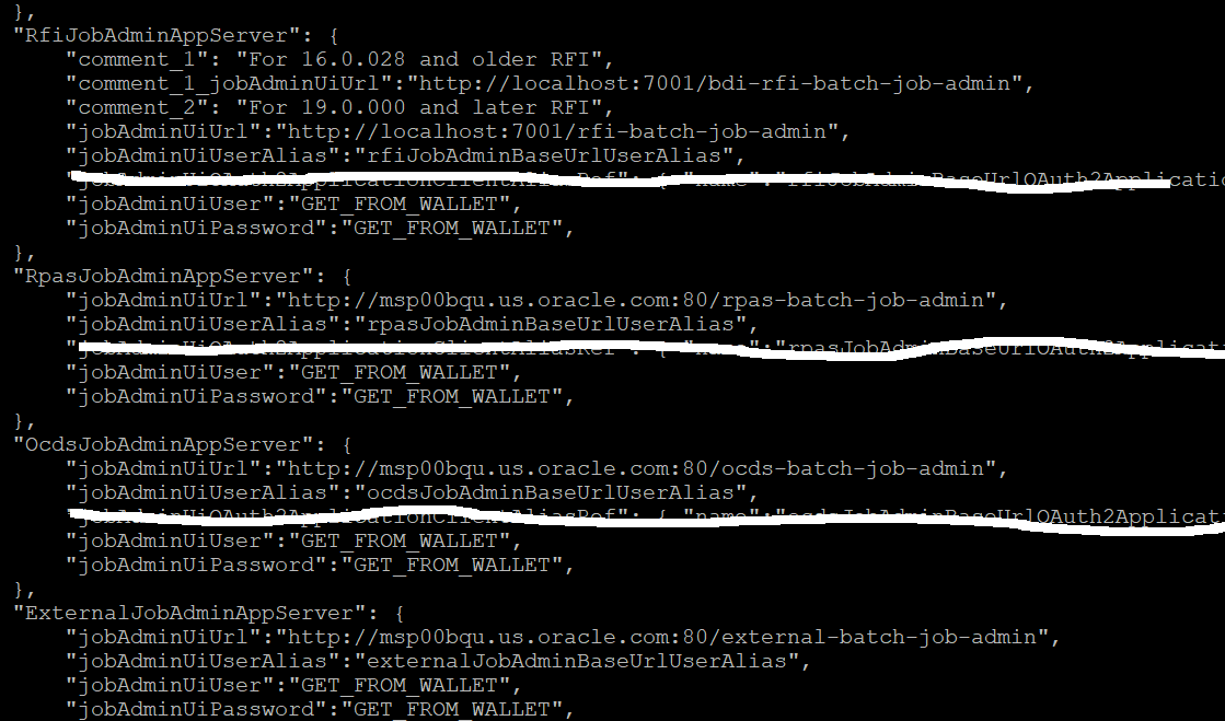

Below are the changes for bdi-job-admin-deployment-env-info.json.
Below json snippet is to support OAuth2 with IDCS for Job Admin.
"CentralAuthenticationSystem":{ "IdcsAuthenticationProvider":{ "oauth2AuthorizationServerUrl":"https://idcs-4ff493196128425c80ce4ecbfc8352e5.identity.c9dev1.oc9qadev.com/oauth2/v1/token", "oauth2Application":[ { "oauth2ApplicationName" : "RICS", "oauth2ApplicationScopeOfAccess" : {"name":"oauth2.default.scopeOfAccess.*", "val-ue":"urn:opc:idm:__myscopes__"}, "oauth2ApplicationClientAlias" : "ricsOauth2ApplicationClientAlias", "oauth2ApplicationClientId" : "GET_FROM_WALLET", "oauth2ApplicationClientSecret" : "GET_FROM_WALLET" }, { "oauth2ApplicationName" : "MFCS", "oauth2ApplicationScopeOfAccess" : {"name":"oauth2.default.scopeOfAccess.*", "val-ue":"urn:opc:idm:__myscopes__"}, "oauth2ApplicationClientAlias" : "mfcsOauth2ApplicationClientAlias", "oauth2ApplicationClientId" : "GET_FROM_WALLET", "oauth2ApplicationClientSecret" : "GET_FROM_WALLET" } ] }, "OamAuthenticationProvider":{ } }

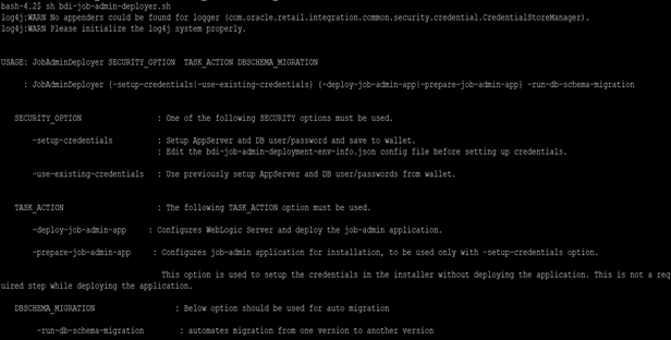

Run the deployer script to create the data sources and deploy BDI RMS Batch Job Admin. While deploying, the user needs to provide the IDCS client secret ID & password for ricsOauth2ApplicationClientAlias, mfcsOauth2ApplicationClientAlias
cd bdi-edge-rms-job-home/bin bdi-job-admin-deployer.sh -setup-credentials -deploy-job-admin-app

If you have already configured the credentials and can use the same credentials (typically when redeploying the app), you can run the deployer with the -use-existing-credentials option as follows, and you will not be prompted for the credentials again for the deployment.
bdi-job-admin-deployer.sh -use-existing-credentials -deploy-job-admin-app

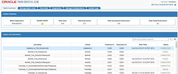

Testing the Deployment
After you deploy to the server successfully, BDI RMS Batch Job Admin can be accessed using the following URL:
http://<server>:<port>/rms-batch-job-admin
Log in using credentials provided during the installation and verify that jobs are displayed in the Manage Batch Jobs tab and configuration is displayed in the Manage Configurations tab.

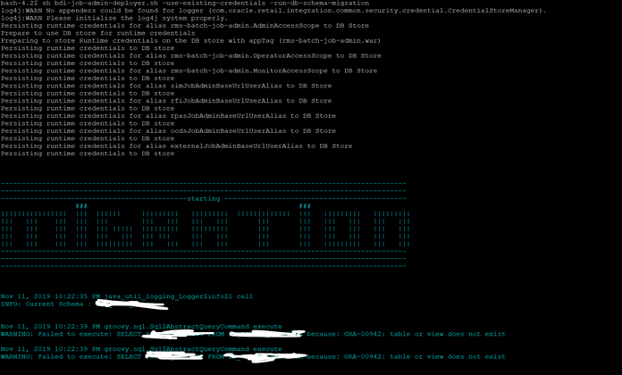

Deploy the BDI Edge job app using -setup-credential option (Follow BDI Installation Guide). -use-existing-credential option will not work the first time, since there is a new entry (IDCS client credentials) now. While deploying user needs to provide the IDCS client secret ID & password for ricsOauth2ApplicationClientAlias, mfcsOauth2ApplicationClientAlias. Cd to <appName>-job-home/bin and run the below command to upgrade and deploy the bdi job app.
sh bdi-job-admin-deployer.sh -use-existing-credentials } -run-db-schema-migration -deploy-job-admin-app
Database schema auto migration feature should be used from >=16.0.028 version.

How to Install BDI without IDCS
To deploy without OAuth, we need to rename or remove the OAuth2 aliases for example:- jobAdminUiOAuth2ApplicationClientAliasRef from bdi-job-admin-deployment-env-info.json, and then deploy. No other extra steps needed for deployment.
"RfiJobAdminAppServer": { "comment_1": "For 16.0.028 and older RFI", "comment_1_jobAdminUiUrl":"http://localhost:7001/bdi-rfi-batch-job-admin", "comment_2": "For 19.0.000 and later RFI", "jobAdminUiUrl":"http://localhost:7001/rfi-batch-job-admin", "jobAdminUiUserAlias":"rfiJobAdminBaseUrlUserAlias", "jobAdminUiUser":"GET_FROM_WALLET", "jobAdminUiPassword":"GET_FROM_WALLET", }, "ExternalJobAdminAppServer": { "jobAdminUiUrl":"http://localhost:7001/external-batch-job-admin", "jobAdminUiUserAlias":"externalJobAdminBaseUrlUserAlias", "jobAdminUiUser":"GET_FROM_WALLET", "jobAdminUiPassword":"GET_FROM_WALLET", } "CentralAuthenticationSystem":{ "IdcsAuthenticationProvider":{ "oauth2AuthorizationServerUrl":"https://idcs-4ff493196128425c80ce4ecbfc8352e5.identity.c9dev1.oc9qadev.com/oauth2/v1/token", "oauth2Application":[ { "oauth2ApplicationName" : "RICS", "oauth2ApplicationScopeOfAccess" : {"name":"oauth2.default.scopeOfAccess.*", "value":"urn:opc:idm:__myscopes__"}, "oauth2ApplicationClientAlias" : "ricsOauth2ApplicationClientAlias", "oauth2ApplicationClientId" : "GET_FROM_WALLET", "oauth2ApplicationClientSecret" : "GET_FROM_WALLET" }, { "oauth2ApplicationName" : "MFCS", "oauth2ApplicationScopeOfAccess" : {"name":"oauth2.default.scopeOfAccess.*", "value":"urn:opc:idm:__myscopes__"}, "oauth2ApplicationClientAlias" : "mfcsOauth2ApplicationClientAlias", } ] } }Continue with regular installation
In case any similar errors like ORA-00942: table or view does not exist Verify if the corresponding tables present in the schema or not, as there are cases where Bdi<App>ReceiverServiceDataSource and Bdi<App>JobAdminDataSource might have configured to different schemas.RTG maintains only one migration script for upgrades. Please ignore those errors.
