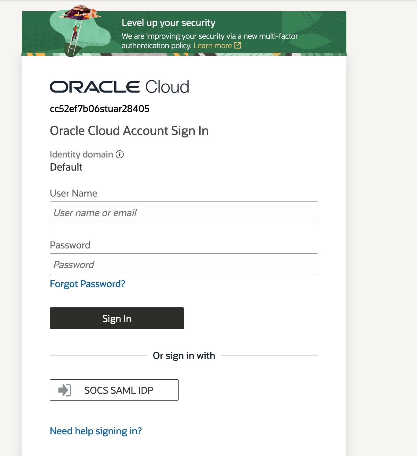

Log in to RIHA
This procedure explains how to log in to the application.
  1. Enter the application URL: in the address bar of the browser.
    Using Mozilla Firefox Web browser is recommended.
    Login Screen
  2. In the User Name field, enter the user name configured at the time of installation of the application.
  3. In the Password field, enter the password.
  4. Click Login. The application home page appears.

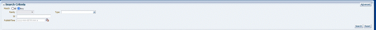

Basic Search
By default, the basic search option is enabled. Basic search is done using the Equal to operator against the given search values.
Click Reset to clear the data from search fields.
To perform a Basic Search:
  1. Log in to the application.
    Search Criteria
  2. In the Search Criteria section, enter or select the criteria to limit your search in one or more of the following fields:
    • Family
    • ID
    • Publish Time
    • Message Type
    Select All to match all fields in the search. Select Any to match
    any field in the search criteria.

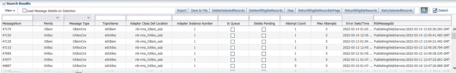

  3. Click Search. The hospital records that match the search criteria are populated in the search results table.
    Search Results

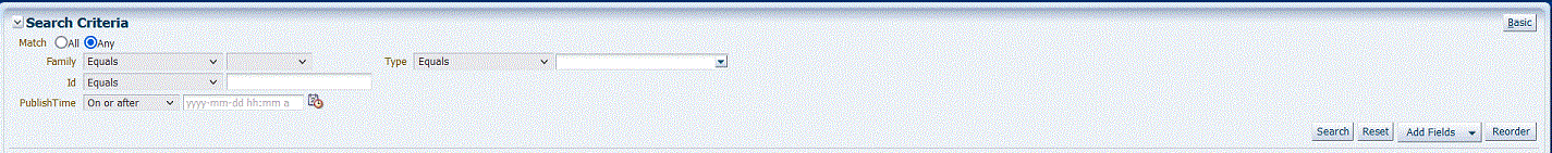

Advanced Search
By default, the basic search option is selected in the application. In the search panel, click Advanced to switch to advanced search option. Advanced search allows you to add more search fields to the search criteria. Click Add Fields to add more fields.
In the advanced search, the operators of each search field can be changed to other available options.
Click Basic to switch back to the basic search option.
To perform an Advanced Search:
  2. Click Advanced in the search panel.
    Advanced Search Fields
  3. Click Add Fields. Additional fields are listed. Select the required fields to add to the search criteria.
    • Click the red cross mark icon besides the field to remove the field from the search criteria.
  4. Enter values in the respective fields and click Search. The hospital records that match the search criteria are populated in the search results table.

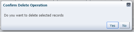

Delete a Message
This procedure explains how to mark a message for deletion from the RIB Hospital.
  2. Search for hospital records.
  3. Select a row that represents a hospital record.
  4. Click Delete. A confirmation dialog box appears.
    Confirm Delete Operation Window
  5. The message is deleted when the hospital retry adapters and/or process checks for messages to be deleted from the RIB Hospital.

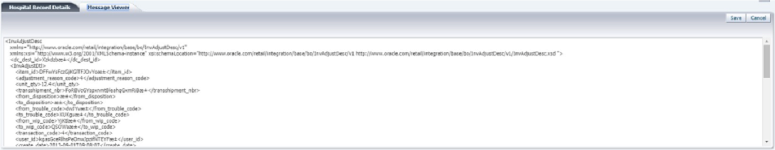

View and Edit a Message
This procedure explains how to view a message.
  3. Click the Load Message Details on Selection check box located in the search results table.
  4. Select a row to view the payload of hospital records.
  5. Click the Message Viewer tab. The message viewer displays the payload in text mode.
    Message Viewer
  6. You can edit the message shown and click Save to save the message.

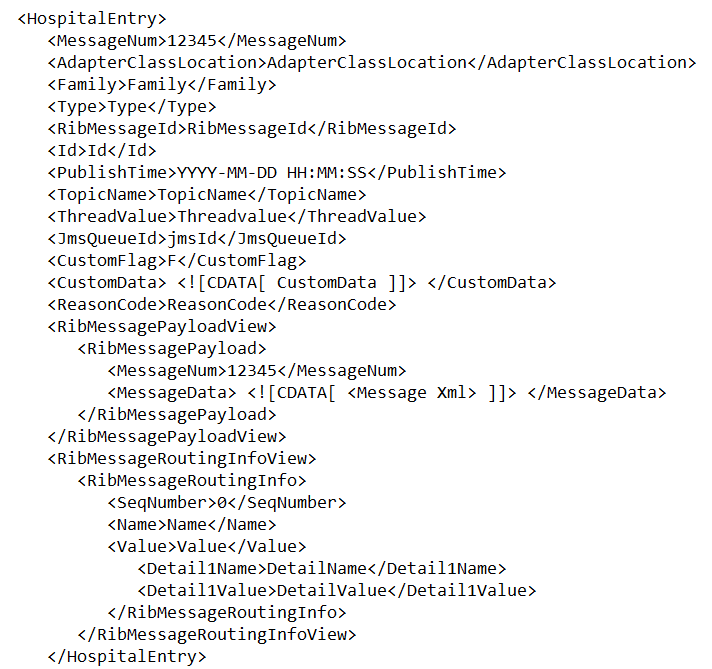

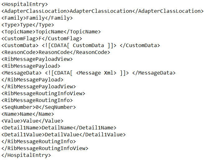

Import a New Hospital Record to Hospital Tables
This procedure explains how to retrieve a message from a local location.
  1. Click Import
  2. Search for a message and select a row.
    • A popup browser opens with an option to browse for a hospital entry to be
The message must be in the following specified format:
Message XML Format

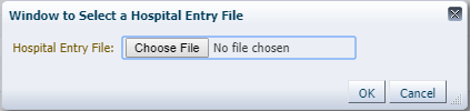

  4. Click Import.
    Select a Hospital Entry File Window
The message must be in the same format in which it was saved.
Format the hospital entry to be updated.
Hospital Message XML Format

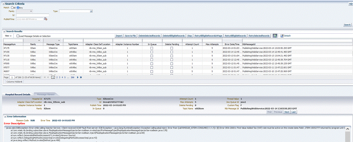

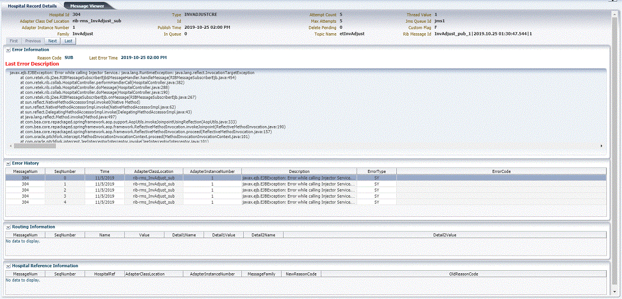

View Hospital Record Details
This procedure explains how to see detailed information about a hospital record.
  1. Search for a message (see "View and Edit a Message").
  2. Select a row that represents a hospital record.
    • By default, the Hospital Records Detail tab is active and displays the selected row’s hospital record details.
    • The size of the pane can be adjusted by using the arrow mark located in the right side of the pane.

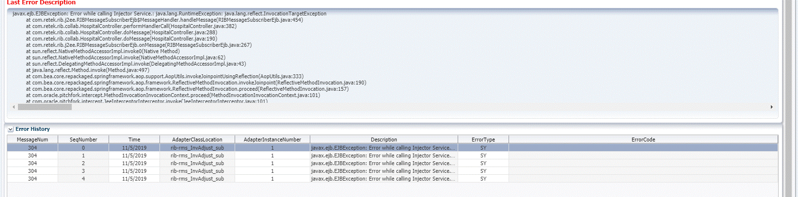

View the Error History of a Message
This procedure explains how to view a message's error history.
Hospital Message Error History
    • By default the Hospital Records Details tab is active and displays hospital record details for the selected row.
    • Click on the arrow located near the error history. This will expand the pane and display errors associated with each of the possible retry attempts.

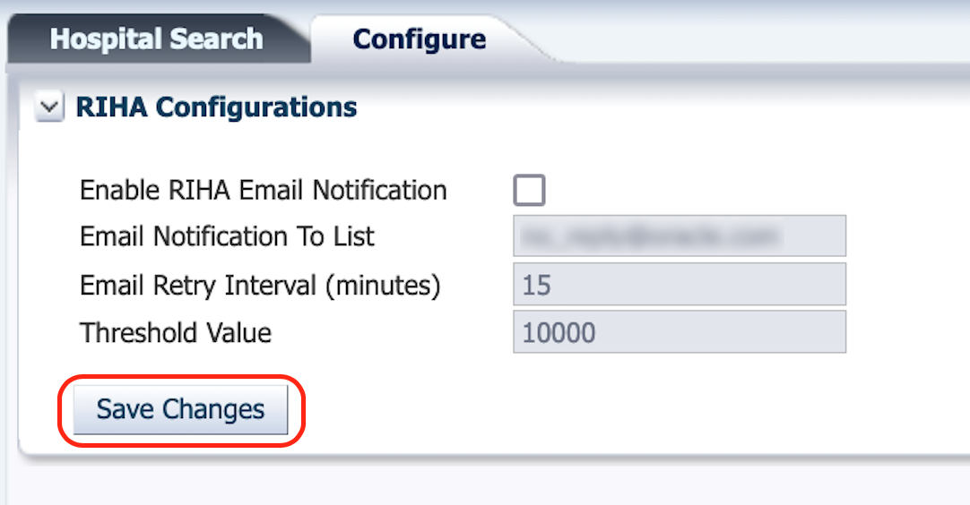

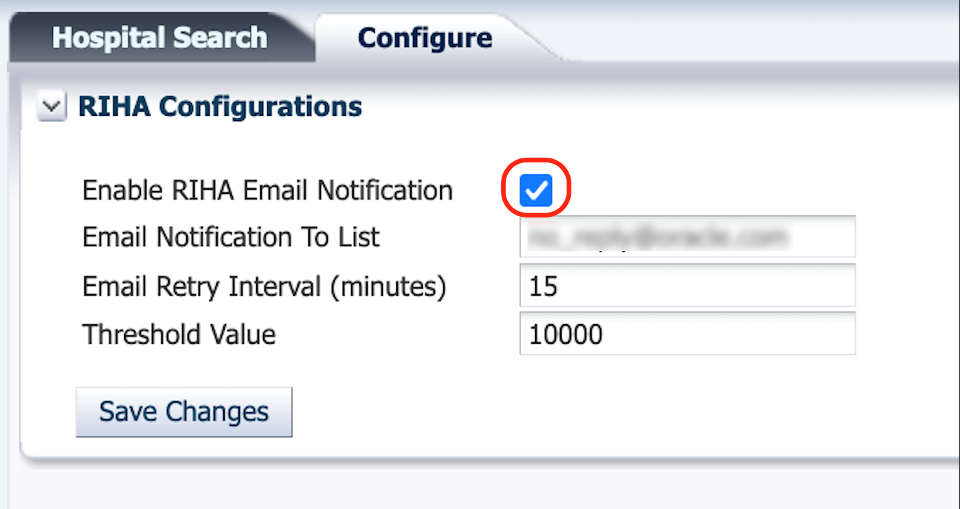

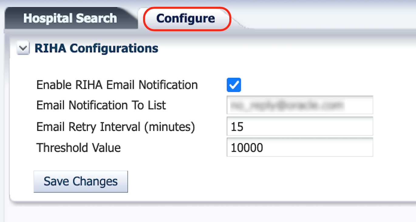

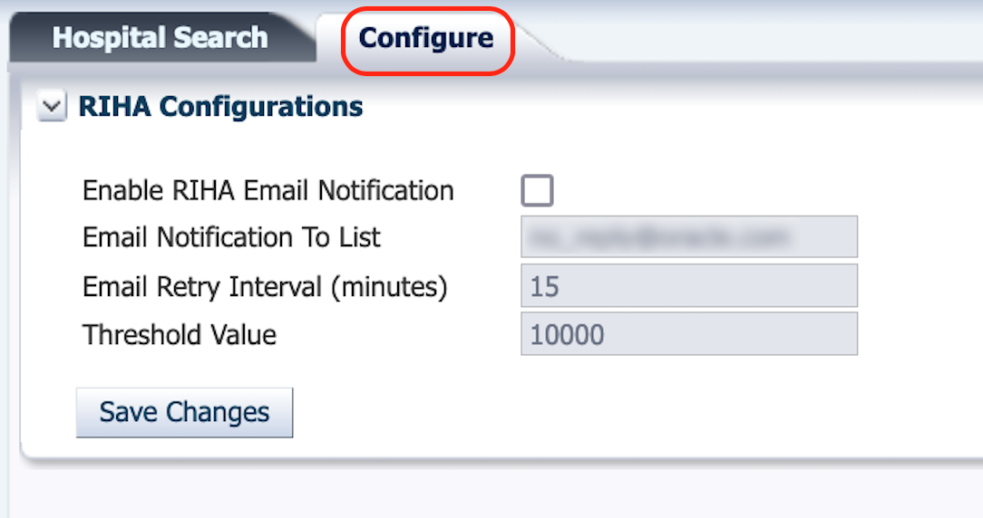

Enable RIHA Email Notification
  1. Log into RIHA and go to the Configure Tab.
    RIHA Configure Tab
  2. Click the Enable RIHA Email Notification Checkbox and update the required fields:
    1. Email Notification to List: Email ID or list of email IDs to which the email needs to be delivered to (Use comma-separated email IDs).
    2. Threshold Value: Max threshold value of failed messages.
    3. Email Retry Interval (minutes): Email Retry interval in minutes.

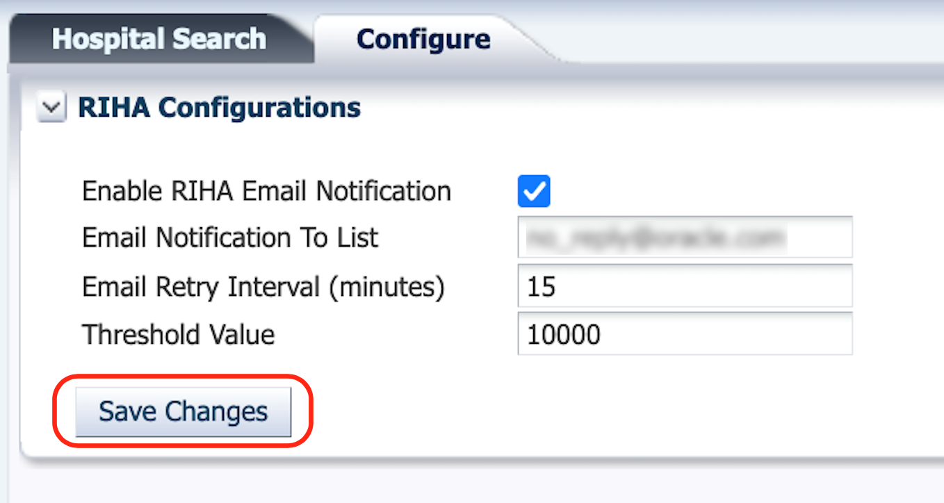

      Configuration changes will take effect within a maximum of 10 minutes after saving the changes.
  3. Click the Save button to save the changes.
    Save Changes

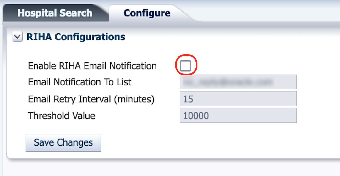

Disable RIHA Email Notification
  1. Login into RIHA and go to the Configure tab.
    RIHA Configure Tab
  2. Click Enable RIHA Email Notification Checkbox to uncheck the box.
  3. Click on Save button to save changes.
    Save Changes

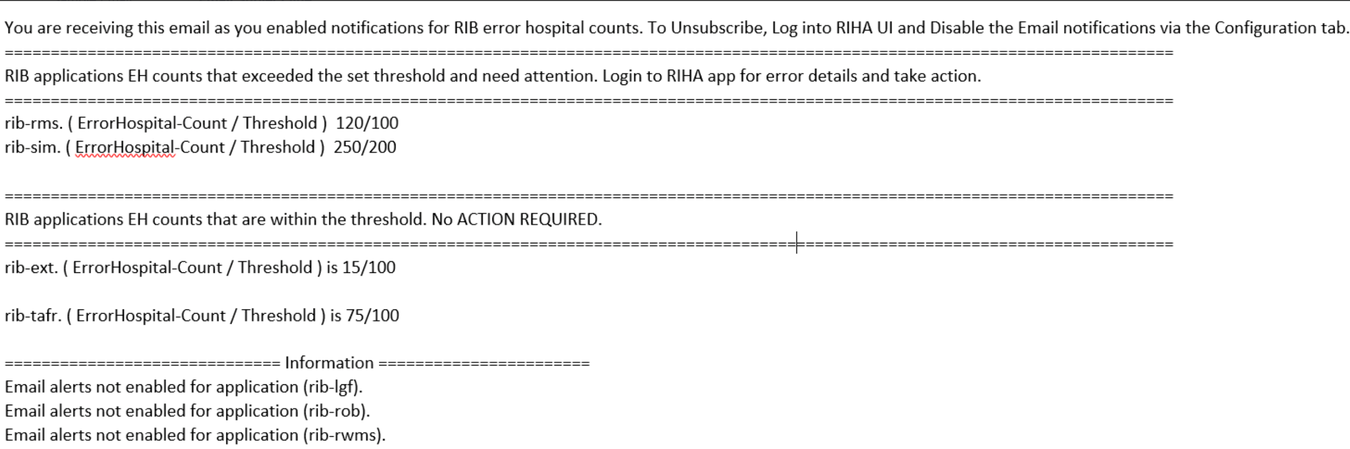

Sample Email
  1. Email Subject line: The subject line mentions the alert is generated from which subnamespace/customer environment.
    For example: “Oracle Retail RIB exceeded the set error threshold and needs attention. [<SubNamespace>/rics-tools-riha-ms-pod-0/RIHA]
  2. Email Content:
    • Section 1: This section needs attention from the email recipient. Action mandatory.
      Includes a list of all the RIB applications whose Error Hospital Record count has exceeded the threshold.
      In this example, the Error Hospital record count for both rib-rms and rib-sim have exceeded the configured threshold.
      The thresholds can be different for each application. However, it is advisable to have a generic setting.
    • Section 2: This section provides information about the current error hospital count for RIB applications, even though threshold has not been exceeded. No action needed.
    • Section 3: This section is just an FYI section to let the user know that email alerts are not configured for certain applications.
      If email notification is not enabled, users will not receive the alerts even if the threshold is met.
Sample Email
