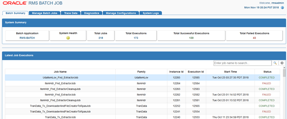

Batch Summary Tab
Figure 5-1 Batch Summary Tab
This tab shows the summary of the system and details about the latest batch job executions. It can be used to quickly find out whether the latest jobs are successful or not. The last section of this page displays the step summary of the selected job.

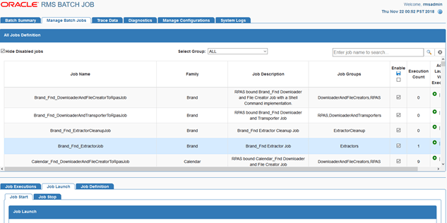

Manage Jobs Tab
This tab displays the list of available jobs with their details and allows you to Start a job, Restart failed jobs, enable or disable the jobs, list the executions of a job.
By default all the jobs are enabled. Select the job row and check/uncheck the check box of each job and click on save image button in enable column. Only enabled jobs can be launched/restarted. The Launch/Restart button is disabled for the disabled jobs. There is an option to enable or disable all the jobs at a time by clicking on checkbox, present in the enable column, highlighted in red and click on save image button.
Only enabled jobs can be launched or restarted.
The Launch or Restart button is disabled for the disabled jobs.
Figure 5-2 Manage Jobs Tab
Job Executions
This tab shows the executions of the selected jobs. It can be used to restart the failed executions of a job. The Restart button is available only for restartable executions in the status column. When the user clicks the restart button it is redirected to the job launch tab with the restart option and pre-populated value of the job parameters from last run of the execution. Only enabled jobs can be restarted otherwise the Restart button is disabled. User can edit the value of the existing parameters except the dataSetId and enter new parameters in comma separated format.
Editing the dataSetId during restart can result in errors.
The url is a infrastructure parameter, the user is not allowed to change its value.
DataSetId in job parameter is not supposed to be edited, and updating same during restart can result into errors.

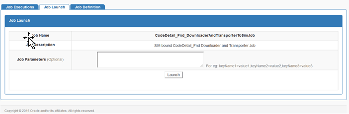

Job Launch
This tab can be used to launch the jobs. Only enabled jobs can be launched. The Launch button is disabled for the disabled jobs. Job Parameters is an optional input to launch the jobs. Multiple job parameters can be entered in comma separated value format. On restart, the user is redirected to the Job Launch tab, and the launch button is replaced with the restart button. The Job parameters values are pre-populated from the last failed run of the instance. The user has an option to add or update existing key values, except dataSetId.
Figure 5-3 Job Launch

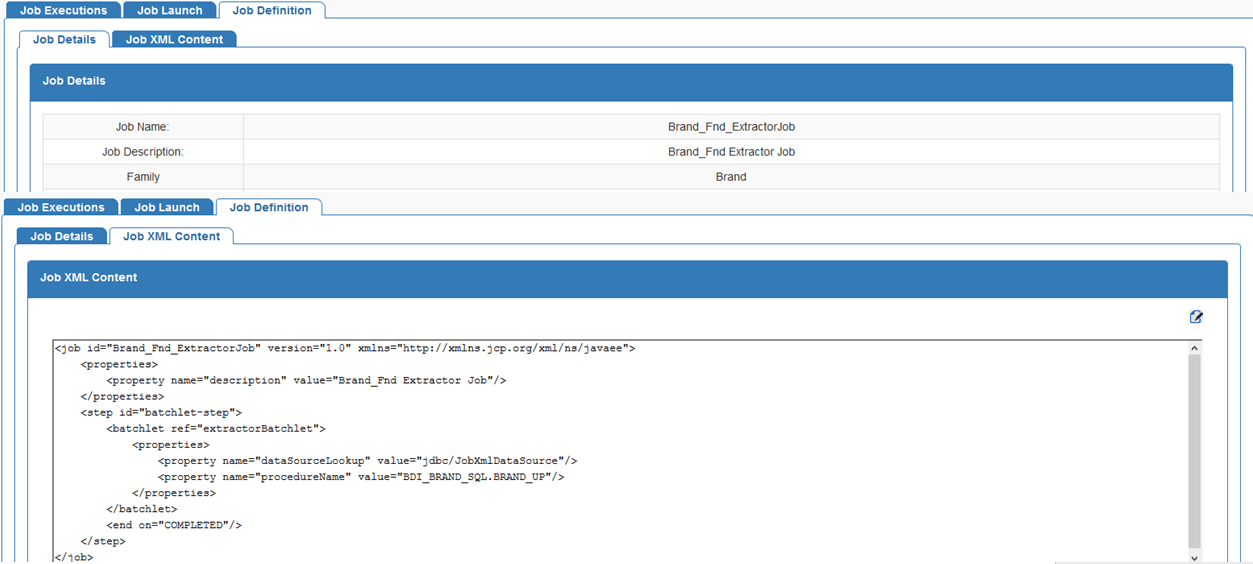

Job Details
This tab shows the details of the selected job such as Job Description, Family, Rest Service Url and Job Xml content.
Figure 5-4 Job Details

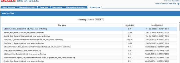

System Logs Tab
This tab shows logs at job and system level. If a job fails, the job level log provides details about the failure. Information about a job in the log file starts and ends with a banner that shows details such as job name, instance id, execution id and so on.
Figure 5-5 System Logs Tab

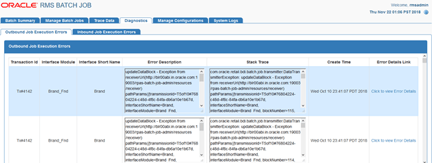

Diagnostics Tab
This tab shows general job level error information such as error description, stack trace etc as well as job specific error information. Use this tab to identify where a job failed and fix the issue.
Outbound Job Execution Errors
Figure 5-6 Outbound Job Executions Errors
The following information is displayed for outbound job execution errors. There can be multiple outbound job execution errors for a job instance.

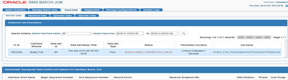

Trace Data
This tab shows data movement in the BDI. Use this tab to verify that data moved from the sender to destination inbound tables.
Sender Data
Figure 5-7 Sender Data
This tab shows the following information about the sender data by the sender side Job Admin (for example rms-batch-job-admin)
Field Name | Description |
Transaction Id |
Transaction Id (Tx#<Job Instance Id>_<Current Time in millis>_<Source System Name>) of the job |
Interface Module |
Name of the interface module |
Job Name |
Name of the batch job |
Data Set Ready Time |
Time when sender moved the data outbound tables |
Data Set Type |
Type of data set (FULL or PARTIAL) |
Status |
Status of the job (COMPLETED or FAILED) |
Transaction Duration |
Duration of the job |

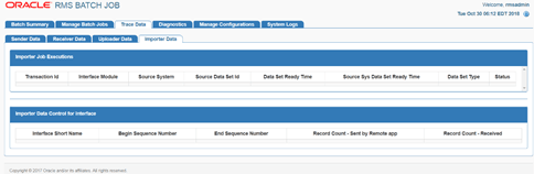

Importer Job Executions
Transaction Id |
Transaction Id (Tx#<Job Instance Id>_<Current Time in millis>_<Source System Name>) of the uploader job |
Interface Module |
Name of the interface module (for example Diff_Fnd) |
Source System |
Name of the source system (for example RMS) |
Source Data Set ID |
Generated by extractor job for group of data |
Time when importer job uploaded data set to inbound tables |
Source Sys Data Set Ready Time |
Time when source system moved data set to inbound tables |
Data Set Type |
Status |
Status of importer job (COMPLETED or FAILED) |
Importer Data Control for Interface
Interface Short Name |
Name of the interface |
Begin Sequence Number |
Begin sequence number of data set in the inbound table |
End Sequence Number |
End sequence number of data set in the inbound table |
Record Count - Sent by Remote App |
Record count sent by remote application |
Record Count - Received |
Record count received |

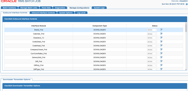

Manage Configurations
This tab allows you to view and edit configurations for the BDI jobs, and it also allows the user to view, edit and create System Options.
Outbound Interface Controls
Figure 5-10 Outbound Interface Controls
This tab allows the user to manage the outbound interfaces and downloader and transmitter options for BDI jobs. The user with Admin privileges can edit the configurations.

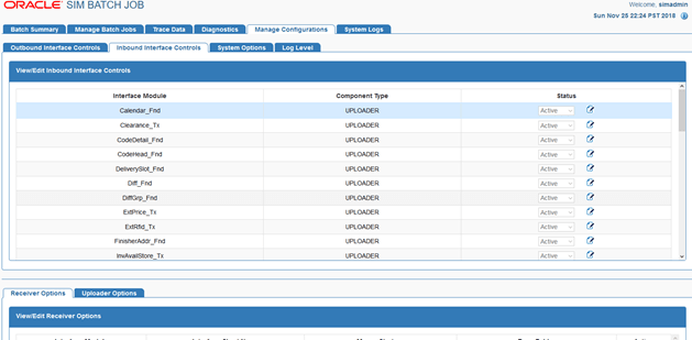

Inbound Interface Controls
Figure 5-11 Inbound Interface Controls
This tab allows the user to manage the inbound interfaces, receiver and uploader options for BDI jobs. The user with Admin privileges can edit the configurations.

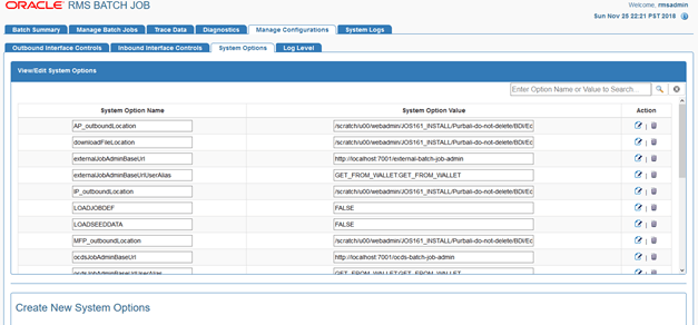

System Options
Figure 5-12 System Logs
This tab allows the user to view, edit and create system options. This page displays the list of system options of the application. The user can modify the value of the existing system options, create new system options and delete the existing system options. The user needs admin privileges for editing and creating system options. The Search option based on system options name and value is also provided on this page.
