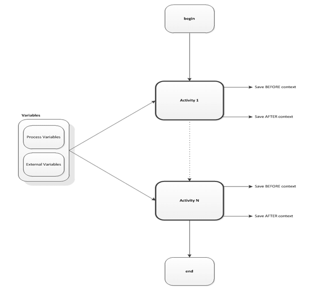

6 Process Flow
A process flow is a composition of one or more activities. It is written in a DSL script that contains all the activities that make a data flow from source to destination complete.
A process flow is a generic concept and is not limited to BDI. However all the out-of-box process flows are for data transfers from a retail application to one or more retail applications.
A process flow encapsulates a sequence of activities. An activity can be synchronous or asynchronous. In BDI some of these activities are invocations of batch jobs.
Figure 6-1 Process Flow

Begin Activity
The "begin" activity in process flow definition appears as the first activity. There should be only one "begin" activity. The out of the box process flows may not contain any executable statements in this activity. This activity is intended to be the one used for any initialization needed for the process flow.
Activity
Activity has two parts. Name and Action. Name attribute is mandatory and should be used to name the activity.
The Action section is where the executable code should reside. Any Groovy or Java code can be coded in this section.
There can be one or more Activities in a process.
End Activity
The "end" activity in the process flow definition appears as the last activity. There should be only one "end"activity. The out-of-the-box process flows may not contain any executable statements in this activity. This activity is intended to be the one used for any finalization needed for the process flow.
Process Variables
Variables used between activities can be created and stored in the processVariables map. The process engine also uses some of the variables for its own working in the process variable map. These variables are prefixed with "bdi_internal_". These variables must not be modified inside any custom code.
Here is how you can use the process variable map for your own use.

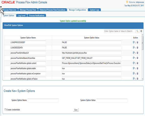

External Variables
Some of the system level configuration values are available in the externalVariables map. These values are read-only. The process flow DSL can use these values, but should not attempt to change it.
For example,
externalVariables["rmsJobAdminBaseUrlUserAlias"]

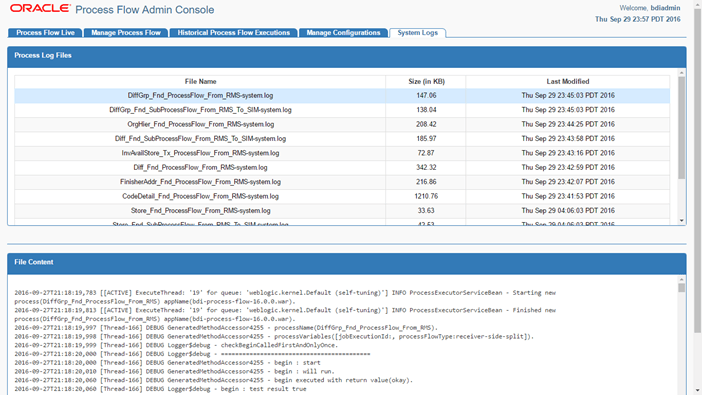

log.info
log.debug
log.error
log.debug "Activity Name:
$activityName"
Adds information to log file.

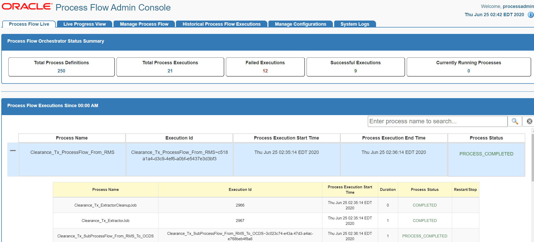

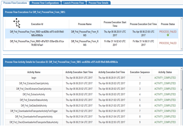

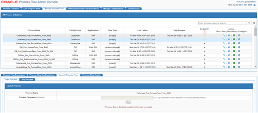

Process Flow Instrumentation
When the process engine executes the process flow, the before and after snapshots of the activity are recorded in the process schema.
The information is reported through the Process Flow Admin application. Process Flow Admin is a web application that provides a GUI to manage task workflows. This is useful for tracking the process flows as well as troubleshooting. The snapshots also help when restarting a failed process. From the schema, the process engine can recreate the context to execute a restart and can resume execution from the activity that failed in the previous run.
Process Flow Monitor Web Application
Process Flow (Admin UI) is a web user interface provided by Process Flow where users can view and execute processes, including managing, updating process flow, manually running processes, viewing process executions and process flow logs.
The following describes various functions available in the Process Flow UI in the current release.

Process Flow Live tab
Figure 6-2 Process Flow Live Tab
The Process Flow Live tab shows the details of the currently running processes. The first section shows the summary of all processes running in the system. The next section shows the list of all processes running since midnight. The last section shows the activity details of the selected process. Users also have the option to search for a process by its name.
Build version and date is displayed on the info icon when a user selects the same. The icon is on the extreme right top corner of the page.

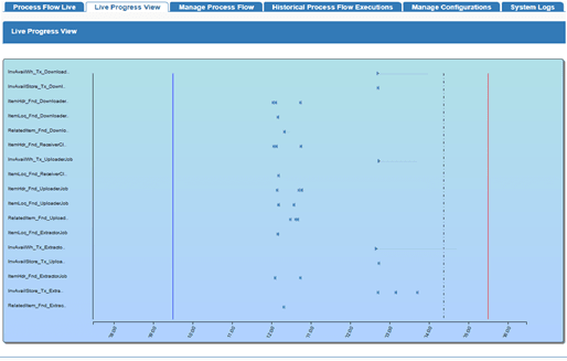

Live Progress View Tab
Live progress graph shows the batch status for a time window. Here are the details of the graph.
  • It shows all the jobs from all the JobAdmins configured in the process flow.
  • Currently the time window is 10 hours before the current time and one hour ahead of the current time.
  • Current time is the dotted line axis. The batch start time is the blue axis and batch end time is the red axis
  • The graph will refresh itself every second. So the axis, jobs and all related information will update
  • The time window will move as the current time axis nears the end of the graph
  • Each job is represented by an arrow. The color of the arrow will be red (errored jobs), blue (running jobs) or green (completed jobs). The length of the arrow will be same as the time taken for the job.
  • Same jobs will appear in the same line.

Process Flow Executions
Figure 6-6 Process Flow Executions
Process FlowExecutions
This tab shows the executions of the selected process. It can be used to restart the failed executions of a process. The Restart button is available only for restartable executions in the status column. When the user clicks the restart button it is redirected to the process launch tab.

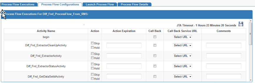

Process Flow Configurations
Figure 6-7
This tab provides various features for activity configurations for the selected process like Skip, Hold, Callback. Admin and operator have permissions to update activity configurations.
Launch Process Flow
Figure 6-8 Launch Process Flow
Launch Process Flow
This tab can be used to start or stop process the selected process. Start Process subtab used to launch Process. Only enabled processes can be launched. The run button is disabled for the disabled processes. Process Parameters is an optional input from the user to launch the process. Process parameter acts as query parameter and refers to a key value pair. Multiple process parameters can be entered in comma separated value format. Stop Process subtab is used to Stop a process execution. Stop will be a graceful stop, which means current executing activity will be first completed and then process will be stopped. If activity is not running, Stop will not bring any action.

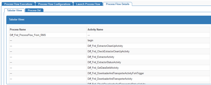

Process Flow Details
Figure 6-9 Process Flow Details
This tab shows process definition in form of a DSL file configured during deployment of the selected process. The Admin user also has the option to modify process DSL. Once updated the process DSL from the UI, changes will take into effect into the BDI_PROCESS_DEFINITION table and no need for process redeployment.

Manage Configurations Tab
Figure 6-11 Manage Configurations Tab
The Manage Configurations tab allows users to view, edit and create system options, configure process notifications and log levels. This page displays the list of system options of the application. The User can modify the value of the existing system options, create new system options and delete the existing system options. The User needs admin privileges for editing and creating system options. The Search option based on the system options name and value is also provided on this page.

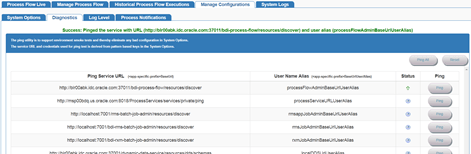

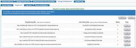

Diagnostics Tab
Ping Feature: The ping utility is to support environment smoke tests and thereby eliminate any bad configuration in System Options.
  • The service URL and credentials used for ping test is derived from pattern based keys in the System Options.
  • The default Ping Service URL is combination of App specific BaseUrl + Discover service as suffix. POAM ping service URL is combination of BaseUrl + Default ping service as prefix (services/private/ping)
  • User can ping individual app URL and see the success/failure message on the TOP. Also, there will be a status column which shows UP Arrow image for success and DOWN arrow image for failure.
  • User can also use Ping All feature to ping all the URLs at one time and the responses will be shown on the status column against each URL.
  • Reset button is to reset the cache and do a fresh service call.
  • All roles are able to ping services i.e. MonitorRole, OperatorRole and AdminRole users.
Figure 6-12 PING with Success Message
PING with success message
Figure 6-13 PING with Failure Message
Figure 6-14 PING All with Message
System Logs Tab
Figure 6-15 System Logs Tab
System Logs Tab
The System Logs tab shows all the log files created by the process flow execution. Clicking on the View icon will show the log file contents in the screen.

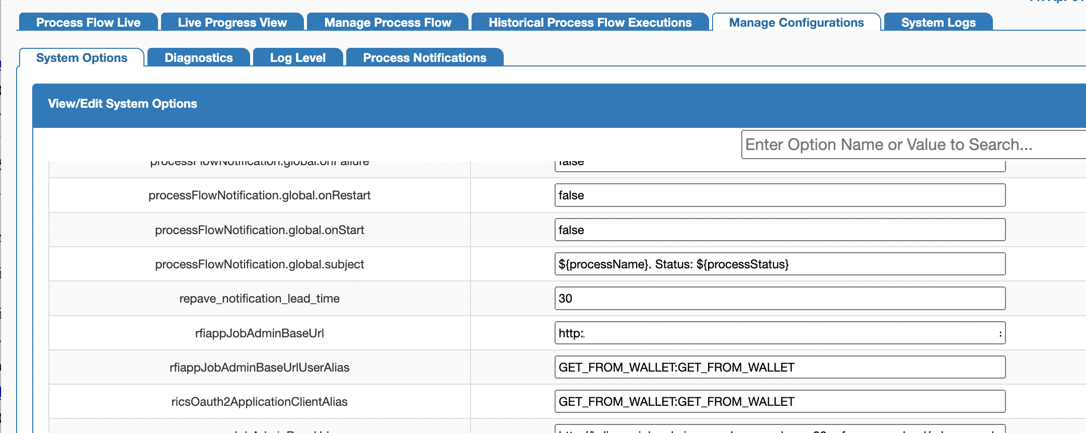

Process Flow Notification Feature
The Process Flow notification options can be set in the System Options of the Process Flow. This can be done either at deployment time (through seed data) or at runtime (through the Manage Configuration tab of the Process Flow Monitoring application)
The options available for notification are:
  • processFlowNotification.<scope>.enable - value must be True or false. This is for global enabling or disabling of process flow notification.
  • processFlowNotification.<scope>.onStart - value must be True or false. True means notification will be sent at the start of the process.
  • processFlowNotification.<scope>.onRestart - value must be True or false. True means notification will be sent at the restart of the process.
  • processFlowNotification.<scope>.onCompletion - value must be True or false. True means notification will be sent at the completion of the process.
  • processFlowNotification.<scope>.onFailure - value must be True or false. True means notification will be sent when the process fails.
  • processFlowNotification.<scope>.recipients - list of recipient email ids
  • processFlowNotification.<scope>.subject – Template of the email subject line
  • processFlowNotification.<scope>.content – template of email content
where <scope> value is global or the Process Name.
If Process Name is specified, the global notification option is ignored for that process. For Subject and Content, if nothing is specified either at the global or process scope, an internal default format is used.
If Mail Session is not setup in WebLogic, notifications will not be sent. If processFlowNotification.<scope>.recipients is not set, the value from mail.to property in the WebLogic Mail Session is used.

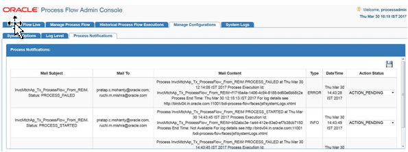

Persisting Process Notifications
All process notifications are persisted to the BDI_EMAIL_NOTIFICATION table. There is a subtab Process Notifications added in Manage Configurations tab which displays all the notifications.
One notification icon appears right top corner of the screen adjacent to the user if there is any notification in PENDING status. User will be navigated to the Process Notifications subtab by clicking on the image.
User can modify the status to COMPLETED after going through the notification and click on save button so that next time it doesn't appear on the screen.
Figure 6-16 Persisting Process Notifications
Repave.Notification lead time by default is 30. It can be modified by the user through System Options by editing the repave_notification_lead_time.

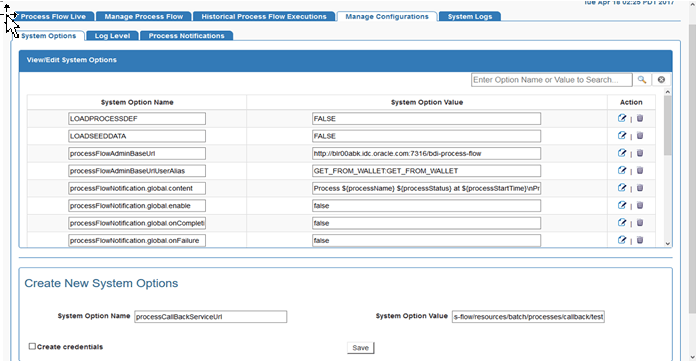

  • Setup the callback URL in processflow system options. To configure a callback URL you should add system options like <serviceName>CallbackServiceUrl, for eg., processCallbackServiceUrl.
    • In Process Flow admin console, navigate to Manage Configurations tab and System Options sub-tab.
      Figure 6-18 System Options Tab
      System Options Tab
    • Scroll down to Create New System Options, enter System Option Name and System Option Value. Url should be a valid ReST Service.
      Figure 6-19 Create New System Option Value

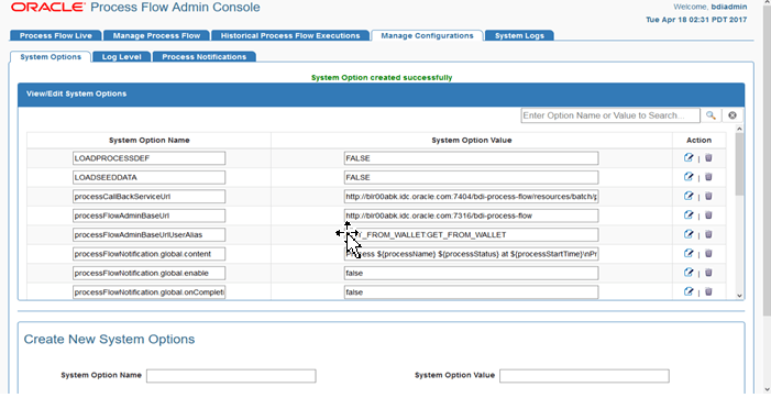

    • Click Save.
      Figure 6-20 View/Edit System Options

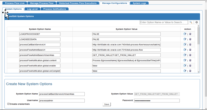

  • Setup the callback URL credential alias in process flow. To add callback URL credential alias you should add credential alias like <serviceName>CallbackServiceUrlUserAlias, for eg., processCallbackServiceUrlUserAlias.
    • In the Create New System Options section, select Create Credentials checkbox.
      Figure 6-21 Create Credentials
      Create Credentials
  • Enter System Option Name, Username and Password for the URL provided in the previous step. If the System Option Name for the URL is processCallbackServiceUrl then System option name for credential should be processCallbackServiceUrlUserAlias.
    Figure 6-22 View/Edit System Options

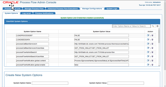

  • Click Save.
    Figure 6-23 Save System Options and Credentials

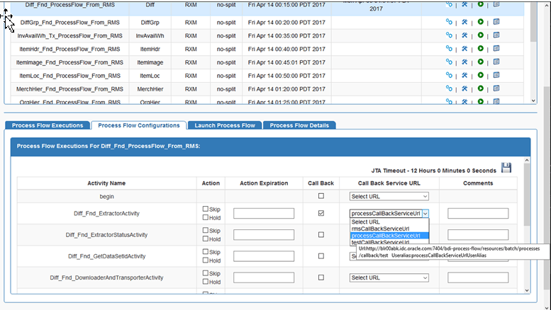

  • Navigate to Manage Process Flow tab and select process flow, go to Process Flow Configurations sub-tab.
  • Select Callback checkbox for the activities you want callback to be enabled. Select Callback URL from drop down list.
    Figure 6-24 Process Flow Configurations

Enable or Disable a Process Flow using REST Service
This endpoint enables or disables the process flows using name, processEnableStatus and returns the name, processEnableStatus and message.
Path: /batch/processes/enable-disable
HTTP Method: POST

BDI_SYSTEM_OPTIONS
This table has all the system level information like URLs, credential aliases etc.

Follow below steps to update auto purge configurations.
Turn OFF/ON auto purge:
  1. Login to BDI batch job admin UI with valid Credentials.
  2. Navigate to "Manage Configurations" tab. Select "System Options".
  3. Update value of " autoPurgeProcessFlowInfraData" to true/false to turn off/on auto purge
  4. If " autoPurgeProcessFlowInfraData" is not available add it using "Create New System Options" option.
Update delay:
  3. Update value of " autoPurgeProcessFlowInfraDataDelay" to desired delay.
    If "autoPurgeBatchInfraData" is not available add it using "Create New System Options" option.
