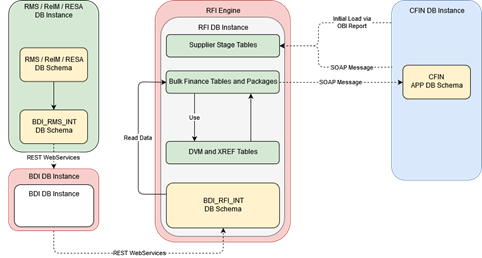

Database Schema Topology
This topology diagram shows how different schemas are integrated with each other.
Figure 3-1 RFI Database Schema Topology (Cloud Financials)
