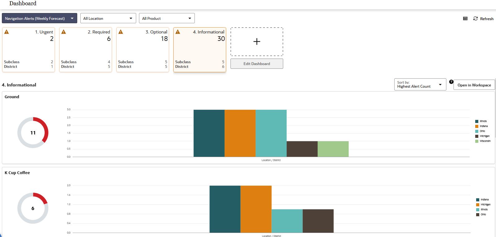

Navigations Alerts
The approval exceptions are very helpful in deciding what product/locations are approved and which ones need review. However, reviewing unapproved product/locations in order of critically, makes the reviewing process much more efficient. You can start reviewing Urgent items, then move on to Required, and if time permits you can review Optional and then Informational.
Figure 2-7 Navigation Exceptions
Exceptions
The product/locations presented in this dashboard are virtually the same as the ones in the Approval Exceptions. The difference is that the product locations are sorted in order of priority, which is a proxy for the importance to the business. The rules to determine the priorities are set up in the Business Rule Engine, as detailed in the Appendix: Business Rule Engine.
