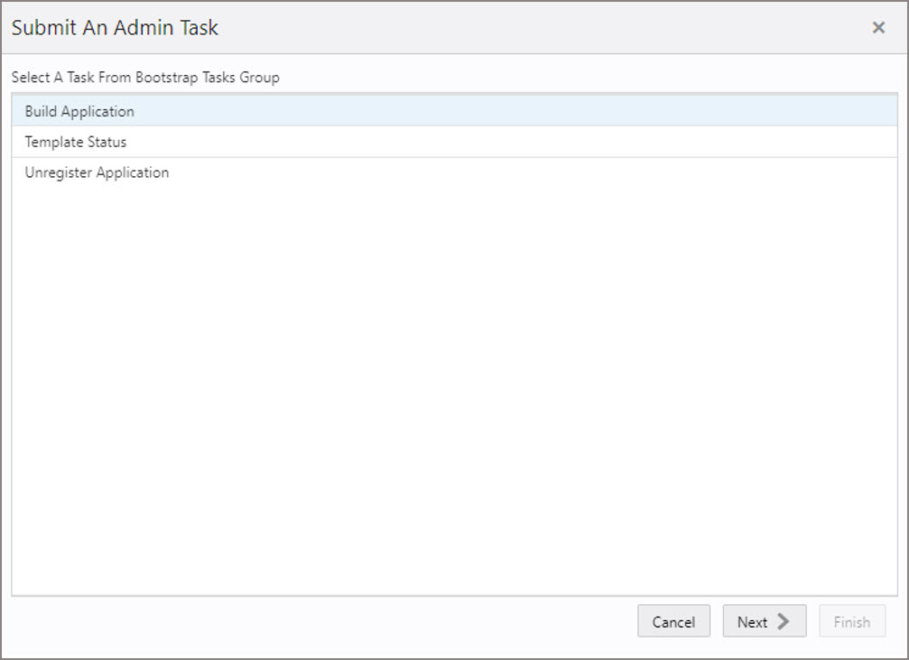

In the Tasks list, select Administration and then Online Admin Tools. Click Submit a New Admin Task. Select Bootstrap Tasks.
Select the Build Application task and click Next.

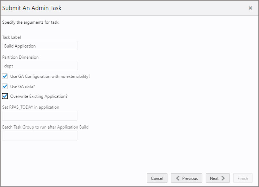

Set the arguments for the task:
Figure 2-2 Select Build Application Task Arguments
Enter the Task Label.
Partition Dimension is defaulted to
deptdimension in for IPOCS-Demand Forecasting / IPOCS-Lifecycle Allocation and Replenishment. The application is internally partitioned based on this dimension to allow parallel processing of data in the batch. -
Select the Use GA Configuration with no extensibility check box, only if you need to deploy the pure template configuration without any changes, otherwise clear this box and upload the new configuration to the Object Store. If no configuration is found in Object Store, the deploy job will fail.
Select the Use GA data option only if the customer wants to deploy the application using the GA data set readily available for the application. If the customer wants to deploy and use their own data set, upload the files to Object Store.
If the application was already created and needs to be overwritten, select the Overwrite Existing Application option; otherwise, do not select this option. Selecting this option will drop the existing application and all associated meta data stored, so it will also lose connection to the environment. The customer will need to log out and log in again to view the status of the deploy.
RPAS_TODAYis an optional parameter. It is needed only if the customer is planning to use the GA data set. For IPOCS-Demand Forecasting / IPOCS-Lifecycle Allocation and Replenishment GA data, the preferredRPAS_TODAYdate is 20190331. -
Select the Batch Task Group to run after the Application Build. This is an optional parameter with the default value of post_build.
Application Deploy without any batch will not load any hierarchy or data into the application, so the customer may need to run tasks to load hierarchy and data after domain build if they are not providing any task to run during the Application Build.

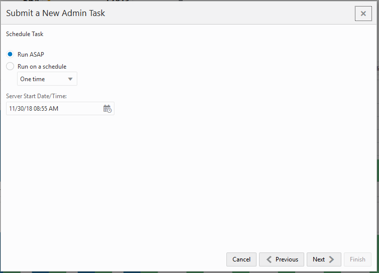

Select the time to schedule the task and click Next. Click Run ASAP if the Administrator wants to run the task now or the task can be scheduled by selecting the Run on a Schedule option.
Figure 2-3 Schedule Task

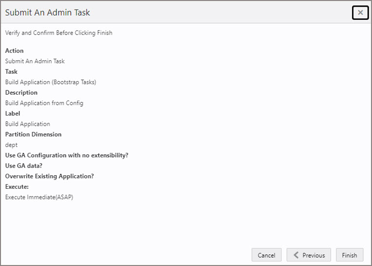

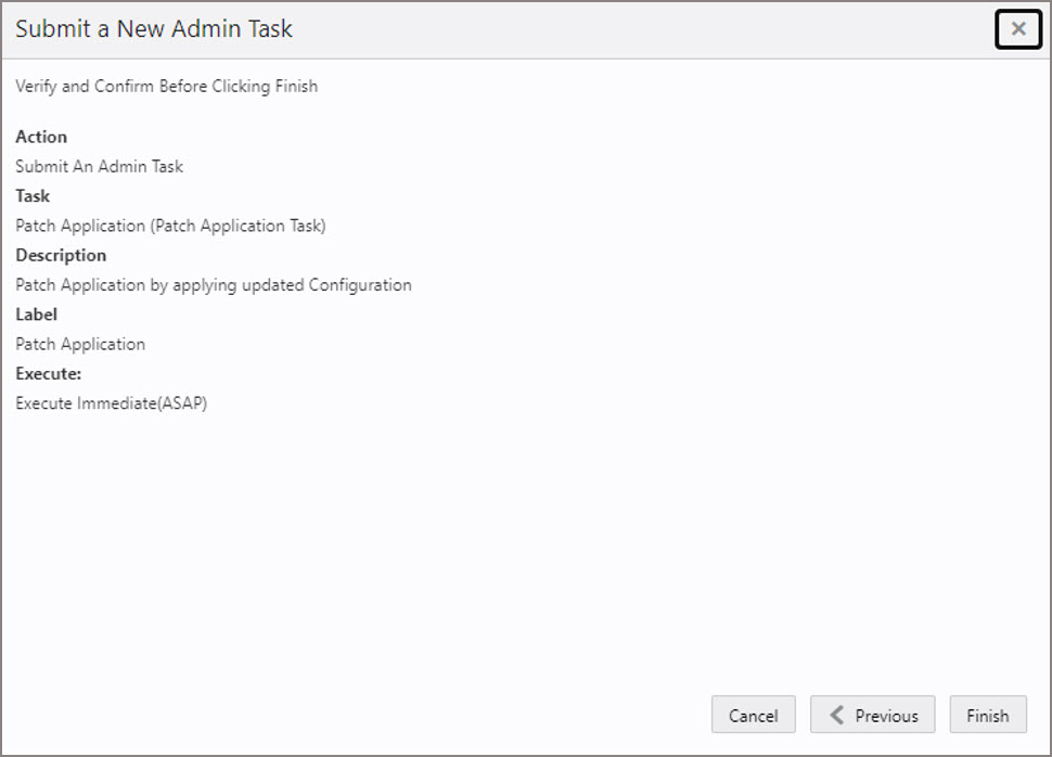

Review the selections and click Finish.
Figure 2-4 Verify and Confirm Selections
After submitting, review the status of that task in the dashboard similar to any other standard administration tasks.

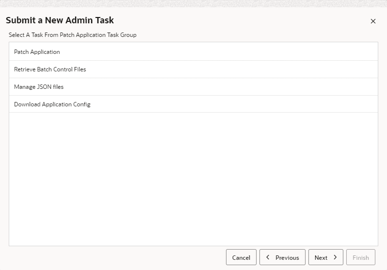

Select Patch Application Task and then click Next.
Figure 2-5 Select Patch Application Task
Select Patch Application and set the arguments for the task:

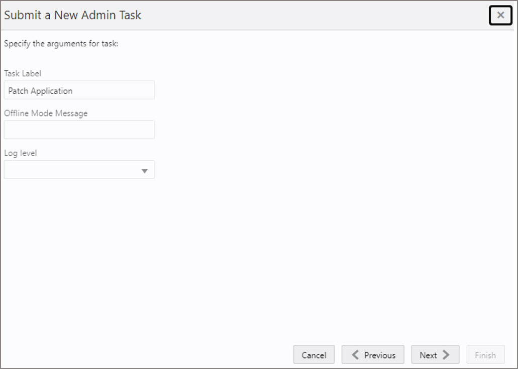

Figure 2-7 Select Patch IPOCS-Demand Forecasting / IPOCS-Lifecycle Allocation and Replenishment Domain Task Arguments
Enter the Offline Mode Message.
If patching with an updated customer configuration, ensure that the customer configuration has been previously uploaded to the Object Store
After choosing all the necessary options, click Next.

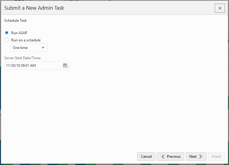

Select the time to schedule the task and click Next. Click Run ASAP if the administrator wants to run the task now or the task can be scheduled by selecting the Run on a Schedule option.
Figure 2-8 Schedule Task
Figure 2-9 Verify and Confirm Selections
