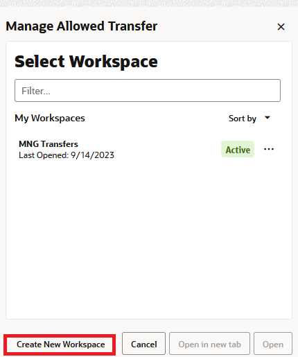

Click Manage Allowed Transfer. The Manage Allowed Transfer wizard opens.
You can open an existing workspace, but to create a new workspace, click Create New Workspace.
Figure 18-2 Create New Workspace
Enter a name for your new workspace in the label text box and click OK.

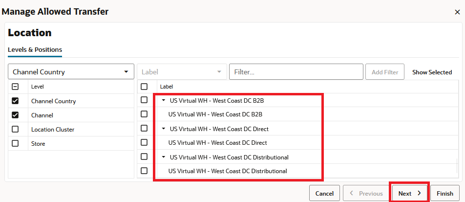

Select the locations you want to work with and click Next.
Figure 18-3 Workspace Wizard: Select Location

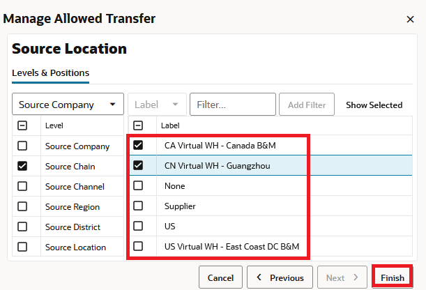

Select the source locations you want to work with and click Finish.
Figure 18-4 Workspace Wizard: Select Source Location

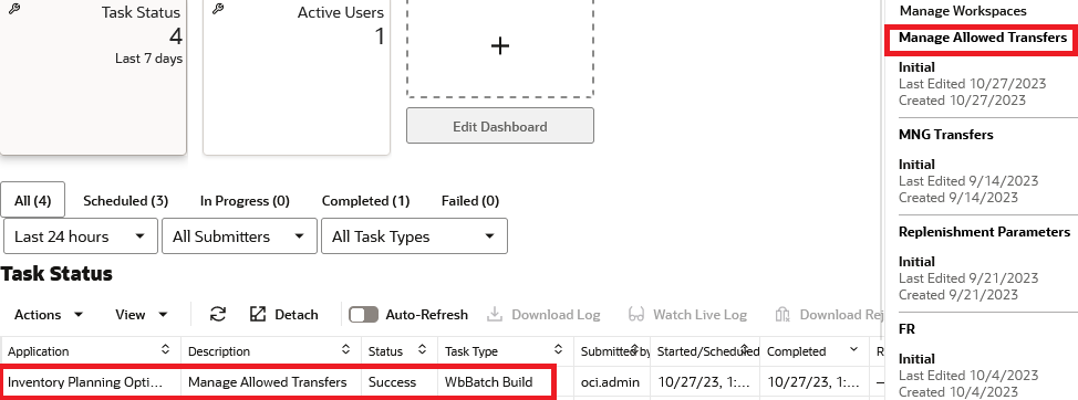

The wizard notifies you that your workspace is being prepared. Successful workspaces are available from the Dashboard.
Figure 18-5 Successful Workspace Build: Manage Allowed Transfer

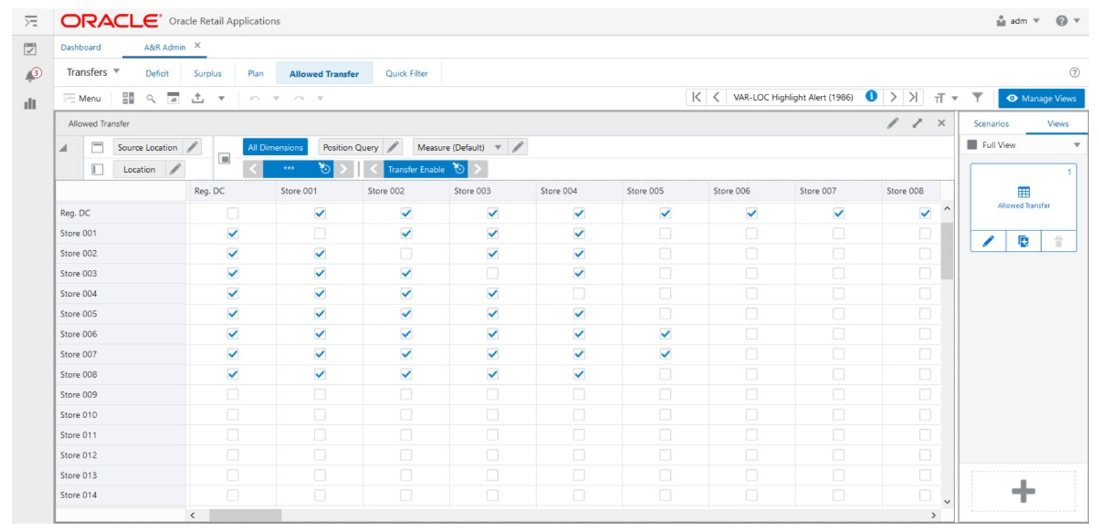

Allowed Transfer View
The Allowed Transfer View, under the Allowed Transfer tab, allows you to manage which locations are allowed to have transfers. You can manage a location matrix to select if a transfer between the locations in the matrix is allowed or not. The columns in the view represent the transfers’ destination location and the rows represent the transfers’ source location.
Figure 18-6 Allowed Transfer View

Transfer Enable
This is an editable measure for you to allow or disallow transfers between source locations and destination locations. When selected, transfers are allowed. A transfer that is clear is not allowed.
