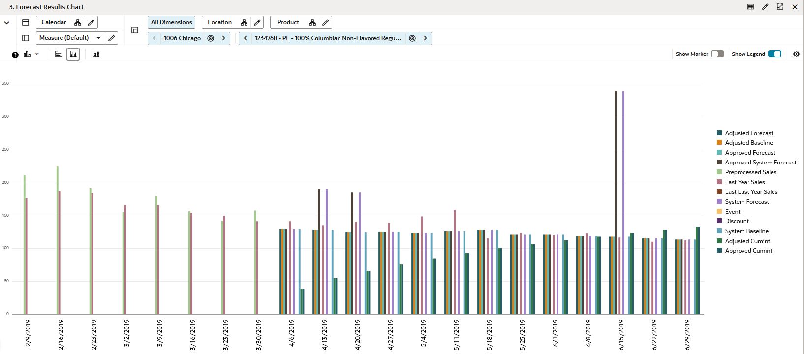

Forecast Results Chart View
The Forecast Results view shows all information related to forecast generation. It shows the forecast with its components, baseline and promotional peaks. It also shows sales of last year, and cumulative interval information.
The navigation of this worksheet is very conveniently driven by real time or workbook alerts.
There is a duplicate of this view - Forecast Results View- that is intended to show the information in table form.
If not already in chart mode, you need to change the view type from pivot table to chart and save the format. This is a one-time action.
Figure 5-12 Forecast Results Chart View
Measures: Forecast Results Chart View
The Forecast Results Chart view contains the following measures.
Adjusted Forecast
This is a read-only measures that equals the adjusted baseline plus the adjusted peaks.
Adjusted Baseline
The value in this field initially defaults to the System Baseline if the forecast is automatically approved by the system or through a Forecast Approval Alert. Otherwise, the value in the Adjusted Baseline is different than the System Baseline if:
  • Adjusted Baseline has been updated by you.
  • Keep Last Changes is selected.
  • Update Last Weeks Forecast is set to Replicate.
  • Changes to the Adjusted Baseline are automatically approved. The Approval view updates with the date of the adjustment and the name of the user who made the adjustment.
  • Demand transference is selected as the adjustment method in forecast setup and significant demand transference effects are available.
Approved Forecast
The Approved Forecast is the forecast quantity that was approved at the time of the task build. The values contained in this measure are read-only. If changes are made to the Adjusted Forecast, then click Calculate to show the new value in the Approved Forecast.
Approved System Forecast
The Approved System Forecast is populated with the last System Forecast approved for a time series:
  1. Approval Method set to Automatic Approval
  2. Approval Method set to a Forecast Approval Alert and the alert is not triggered
  3. Update Last Weeks Forecast is set to Use Forecast
Preprocessed Sales
This read-only measure is the demand data used to generate the forecast. This allows you to compare Actuals to forecast values. The preprocessed sales are based on the historical sales which are undergoing several rounds corrections.
Last Year Sales
Event
This measure displays at the item, location, and week level if one or more offers were active. This usually goes together with the Discount measure.
Discount
This is the discount from the full price for which a product was sold at a given location for a given time period.
Last Last Year Sales
System Forecast
This is a read-only measures that equals the system baseline plus the system peaks.
System Baseline
The System Baseline displays the system generated baseline forecast. The values contained in this field are read-only. The system baseline incorporates level, trend, seasonality, but no causal-related information.
What-if Baseline
In the What-if Parameters view you can change some forecast parameters and see how they impact the forecast. The resulting forecast is stored in this measure. If you like the change, you can run the Copy What-if custom menu, and the forecast is copied in the Adjusted Forecast measure
Adjusted Cumint
Cumulative Intervals are used in safety stock calculation within allocation and replenishment systems. Its value is similar to a running total of a percentage of the actual forecast and is read-only.
Approved Cumint

Preprocessing Details View
The Preprocessing Details view shows all necessary information to determine how the loaded sales were transformed into unconstrained demand. You can review the numbers after each step, and also have the possibility to override the total demand. Unconstrained demand is what an item would have sold at a location without the influence of any outside factor. These factors can include:
  • Out of stock situations where an item would have likely sold more
  • Outliers like fatty fingers or Software bugs
  • Promotions that can boost sales
  • Weather that can boost or lower sales. Examples include hurricanes for water bottles, or rain for barbecue items.
For details on how the corrections are made refer to the Oracle Retail AI Foundation Cloud Service User Guide.
Figure 5-14 Preprocessing Details View
Measures: Preprocessing Details View
The Preprocessing Details view contains the following measures.
Depromote Adjustment
This measure displays the units that were removed from the historical sales, because they were caused by the lift in demand due to one or more offers.
Outage Adjustment
This measure displays the units that were added to the historical sales, because they were caused by the artificial drop in demand due to stockouts.
Outlier Adjustment
This measure displays the units that were added to the historical sales, because they were caused by the artificial drop in demand due unusual events, like human error, or extreme bottle water sales during a hurricane.
Outage Indicator
This measure is either loaded or calculated by the rules in the custom menu. It is used during the pre-processing run that corrects sales for lost sales.
Promotion Indicator
This measure is usually calculated as the OR of all available offers that are active for a Product/Location/calendar combination. It is used during the preprocessing run that removes promotional sales.
Baseline Sales
This measure represents the demand that was sold at a location without the influence of any outside factor.
Historical Discount
When the Historical Discount or Historical Event measures are not blank, it is likely that the Promotion Indicator is On, and the Depromote Adjustment will also have a non-zero value.
Historical Event
Outlier Indicator
This measure is either loaded or calculated by the rules in the custom menu. It is used during the pre-processing run that corrects the sales for outliers.
Raw Sales
This measure is loaded and it represents the historical sales at a Product/Location/calendar period level. It is different from demand because it may be constrained by stockouts, outliers, weather, and so on.
Preprocessed Sales
This measure represents the demand – including promotion and offer data that was sold at a Product/Location/calendar. If configured properly, the stockout and outliers impact is removed.
User Override
After reviewing all the above measures, this is the place to override the demand at the Product/Location/calendar level. This can be useful for special cases (introduction of key items) as well as extreme situations when entire departments were hurt by natural events, like a pandemic.
