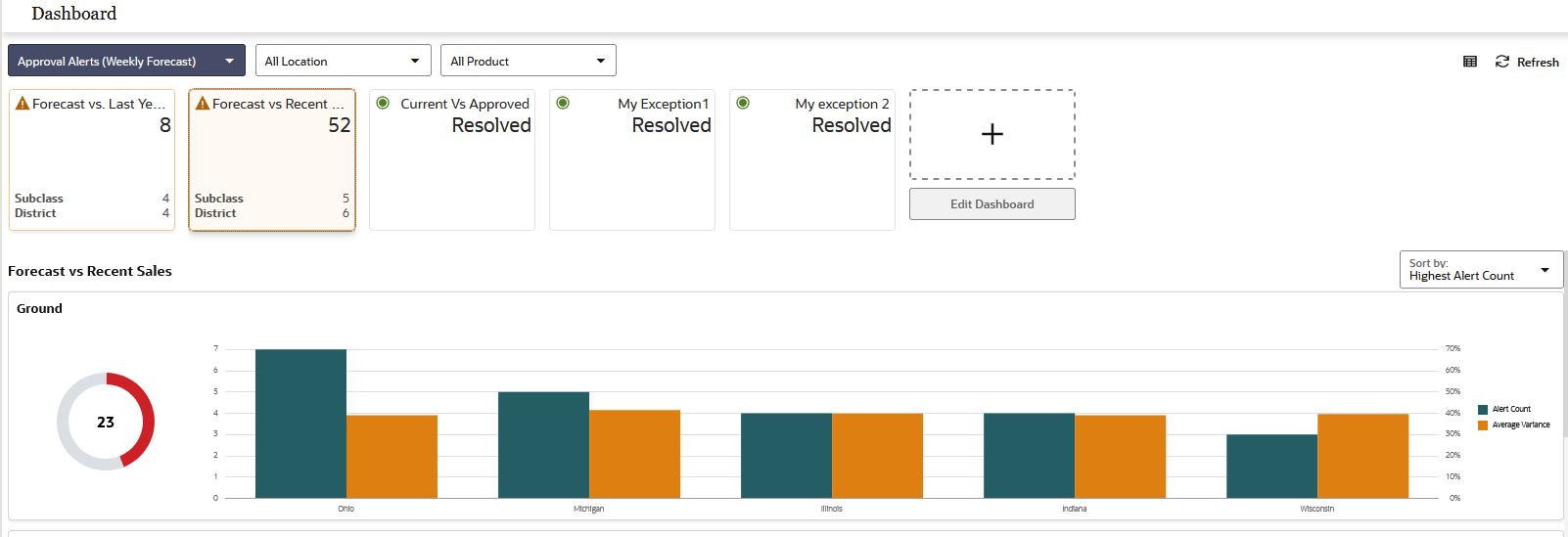

Approval Alerts
This is the exception profile that shows the result of the approval business rules.
Figure 2-6 Approval Exceptions
Approval Exceptions
Exceptions
The information displayed in the tiles is based on exceptions, or business rules defined to check if the forecasts are within bounds with respect to some thresholds. The exceptions definitions and expressions are detailed in Appendix: Forecast Approval Exceptions.
Number of Hits Count
The main metric in the tiles is the number of hits count which is based on the product and location filter settings. If the filter settings range products and locations to a narrower selection than, All Product and All Location, then the number should be reflected in the tile; that is, it should decrease.
Number of Subclass and Districts
The secondary metric on the tiles display the number of subclass and districts that are affected. Note that the dimensions are configurable.
Charts
Each tile comes with a set of charts where the hit count information is broken down to lower levels and sorted based on hit count, or average variance.
The average variance represents how much off the forecast is versus its target. For example we compare the forecast against last year sales. If the sales are 10 units and the forecast is 15 units, the variance is 5 units. The average variance is the average of all the differences between forecast and last year sales.
The hit count represents how many times the forecast did not pass the configured business rules. The average variance represents by how much the forecasts were off. This is useful, because if a subclass is heavily alerted, but the forecasts only barely miss the threshold, the user may want to concentrate on other merchandise, potentially less alerted, but where the forecasts were off by a larger amount.

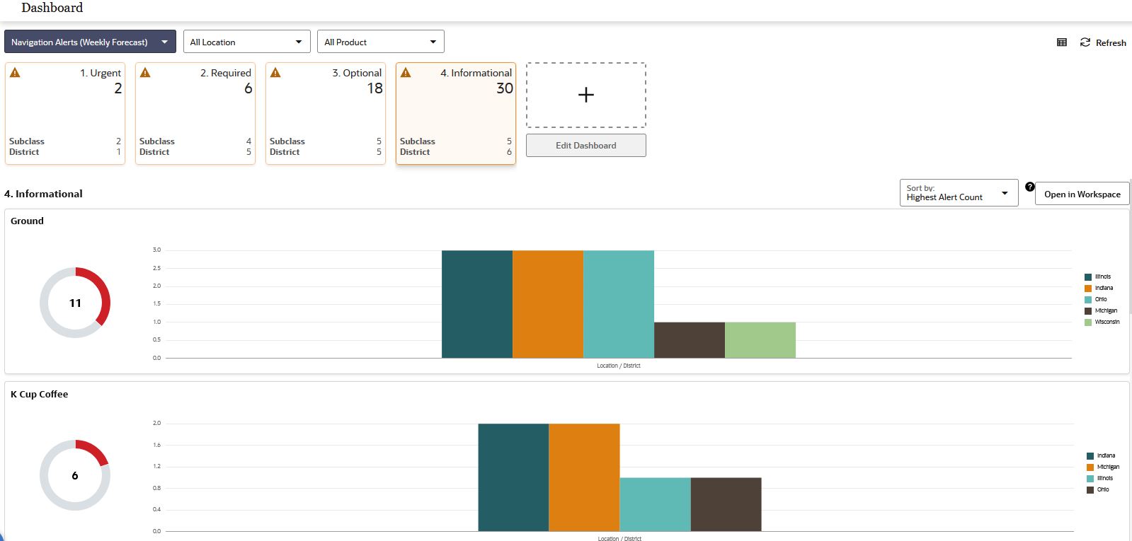

Navigations Alerts
The approval exceptions are very helpful in deciding what Product/Locations are approved and which ones need review. However, reviewing unapproved Product/Locations in order of critically, makes the reviewing process much more efficient. You can start reviewing Urgent items, then move on to Required, and if time permits you can review Optional and then Informational.
Figure 2-7 Navigation Exceptions
Exceptions
The Product/Locations presented in this dashboard are virtually the same as the ones in the Approval Exceptions. The difference is that the product locations are sorted in order of priority, which is a proxy for the importance to the business. The rules to determine the priorities are set up in the Business Rule Engine, as detailed in the Appendix: Business Rule Engine.
Forecast Review Workspace
Finally, when a user makes a decision as to which merchandise and locations to review, the user can launch directly in the Forecast Review workspace by clicking Open in Workspace, with the locations and product ranged down to the desired selection. Once in the workspace, you can choose to use the navigation alerts to navigate to Product/Locations. Every navigation exception can have a workspace counterpart. Using these exceptions you are guided to the exact product, location, and time period that needs your attention.
The Open in Workspace button is located in the right corner above the top chart
Alternatively, you can right-click on any exception chart and select Open in Workspace
