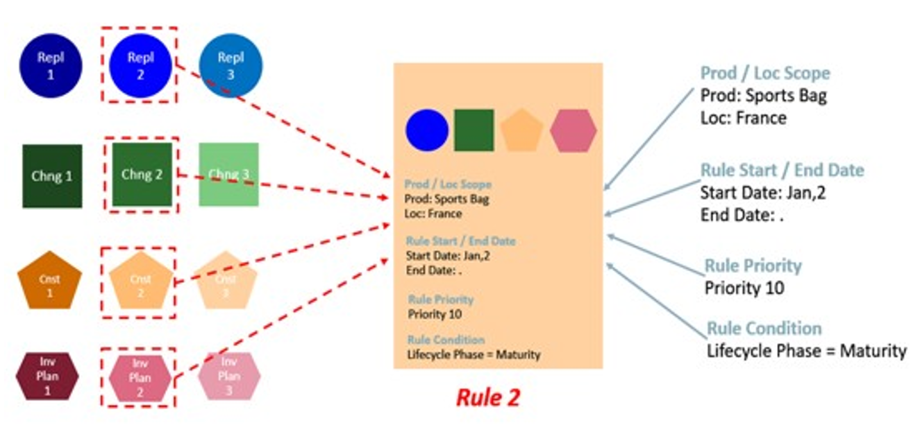

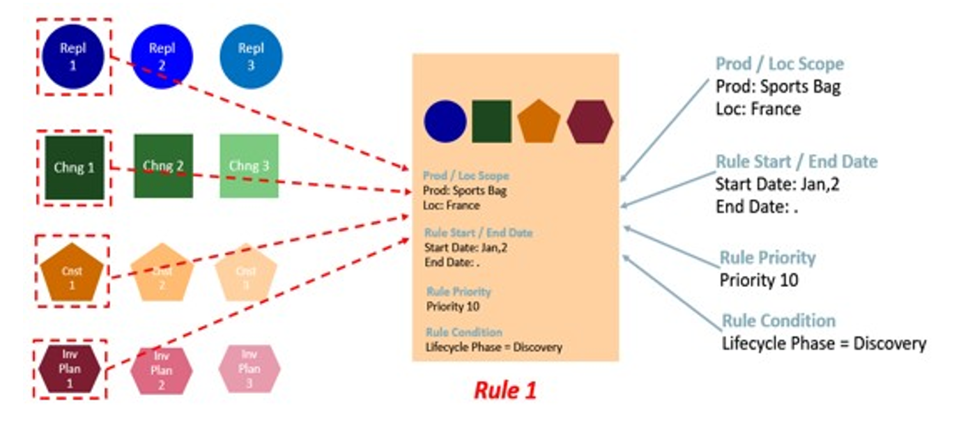

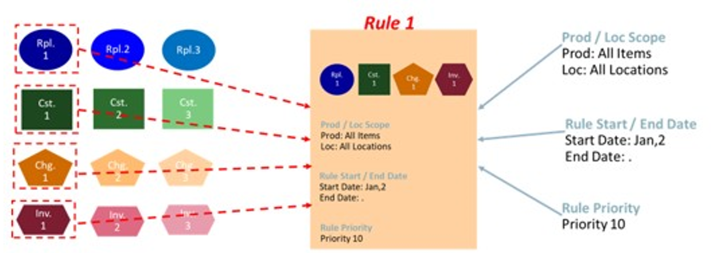

You can further specify the priority and the period where the rule should apply (start and end date if applicable). Based on the set up, the rules engine determines the most appropriate rule and then distributes the parameter to each item and location.
Figure 20-1 Rules Engine Process

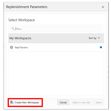

The Replenishment Parameters wizard opens. You can open an existing workspace, but to create a new workspace, click Create New Workspace.
Figure 20-3 Replenishment Parameters Wizard

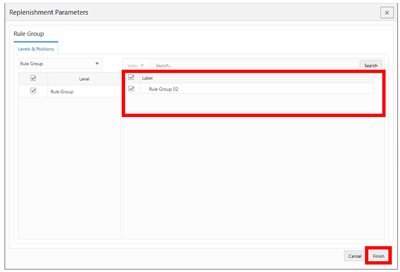

Select the rule groups you want to work with and click Finish.
Figure 20-5 Workspace Wizard: Rule Groups
Only the rule groups that are from the Replenishment rule group type are available for selection. The rule group type value is managed in the Manage Rule Groups workspace.

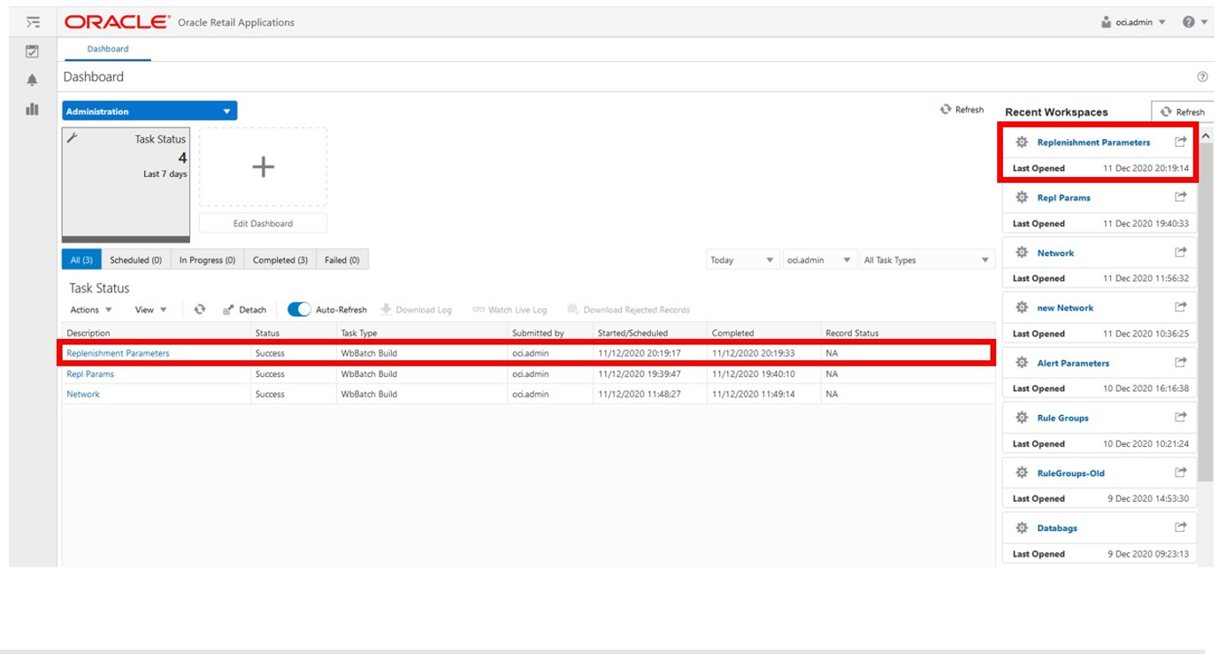

The wizard notifies you that your workspace is being prepared. Successful workspaces are available from the Dashboard.
Figure 20-6 Successful Workspace Build

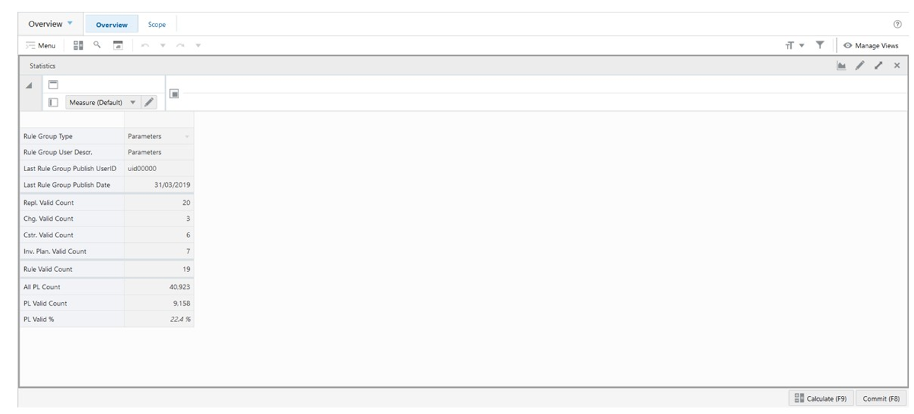

The Statistics View, under the Overview tab, allows you to review the statistics of the Replenishment Parameters. The view has statistical information regarding the number of valid counts for each set up (for example, Replenishment Parameters, Change Parameters) and rules. It also provides the number of product and location combinations within the workspace.
Figure 20-7 Statistics View
Statistics View - Default Profile Measures
The Statistics view contains the following measures.
Rule Group Type
Rule Group Type is a loaded read-only measure used to display the rule group type that was set up for the rule group in the Manage Rule Group workspace.
Rule Group User Description
Rule Group User Description is a loaded read-only measure used to display the user-description that was set up for the rule group in the Manage Rule Group workspace.
Last Rule Group Publish User ID
Last Rule Group Publish User ID is a loaded read-only measure used to display the user-identifier that performed the last rule group’s change in the Manage Rule Group workspace.
Last Rule Group Publish Date
Last Rule Group Publish Date is a loaded read-only measure used to display the date and time when the last rule group’s change was performed in the Manage Rule Group workspace.
Replenishment Valid Count
Replenishment Valid Count is a calculated measure used to display the total number of valid replenishment parameters that are set up for the rule group.
Change Valid Count
Change Valid Count is a calculated measure used to display the total number of valid change parameters that are set up for the rule group.
Constraint Valid Count
Constraint Valid Count is a calculated measure used to display the total number of valid constraint parameters that are set up for the rule group.
Inventory Plan Valid Count
Inventory Plan Valid Count is a calculated measure used to display the total number of valid inventory plan parameters that are set up for the rule group.
Rule Valid Count
Rule Valid Count is a calculated measure used to display the total number of valid rules that are set up for the rule group.
All Product Location Count
All Product and Location Count is a calculated measure used to display the total number of product and location combinations that have a lifecycle phase value.
Product Location Valid Count
Product and Location Valid Count is a calculated measure used to display the total number of product and location combinations that have a valid rule assigned.
Product Location Valid %
Product and Location Valid Percentage is a calculated measure used to indicate, in percentage, how much the product and location combinations with a valid rule assigned represent in the total of product and location combinations with a lifecycle phase value. The measure is calculated as:

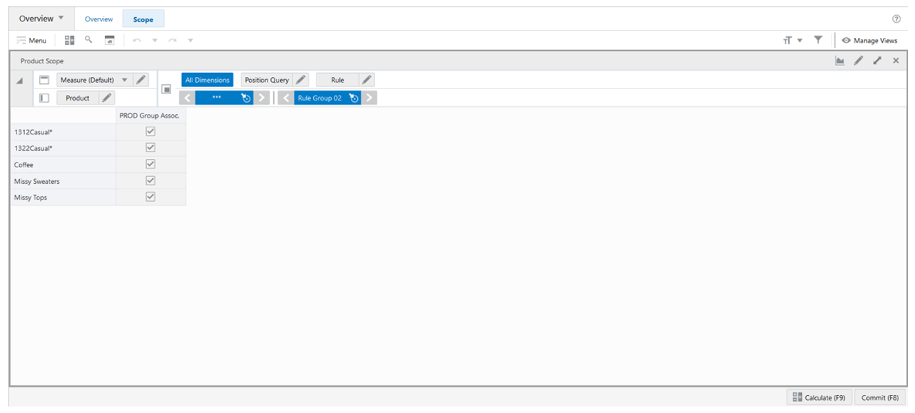

Product Scope View
The Product Scope View, under the Scope tab, allows you to review what specific products are in the scope of a rule group and loaded into the workspace.
Figure 20-10 Product Scope View
Product Scope View - Default Profile Measures
The Product Scope view contains the following measure.
Product Group Association
Product Group Associated is a loaded read-only measure used to indicate the products groups that are associated with the rule group. This measure is managed in the Manage Rule Groups workspace.

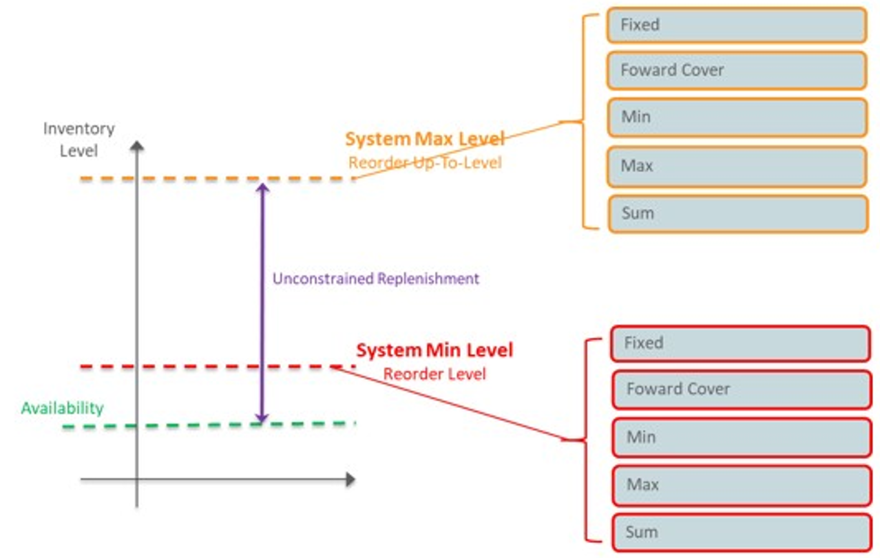

Replenishment Key Concepts

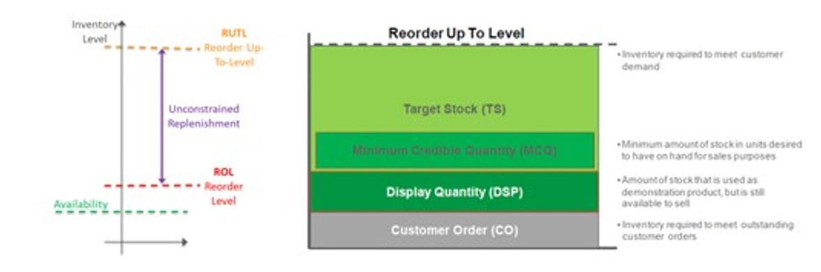

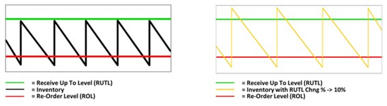

Replenishment parameters are used to specify the Reorder Level (ROL) and the Reorder Up to Level (RUTL) methods along with the associated parameters that is used in generating point in time planned orders.
Reorder Level (ROL) is the inventory level that determines whether an order for replenishment should be placed at the time of review or not. At the time of review, if the stock levels are less than the ROL, then an order for replenishment is placed, otherwise it is ignored until the next cycle.
Reorder Up to Level (RUTL) is level that must be maintained to meet expected service levels for demand fulfilment.

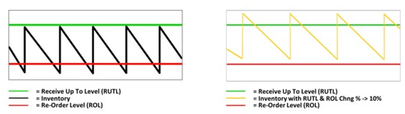

Figure 20-11 Reorder Level (ROL) and Reorder Up to Level (RUTL)

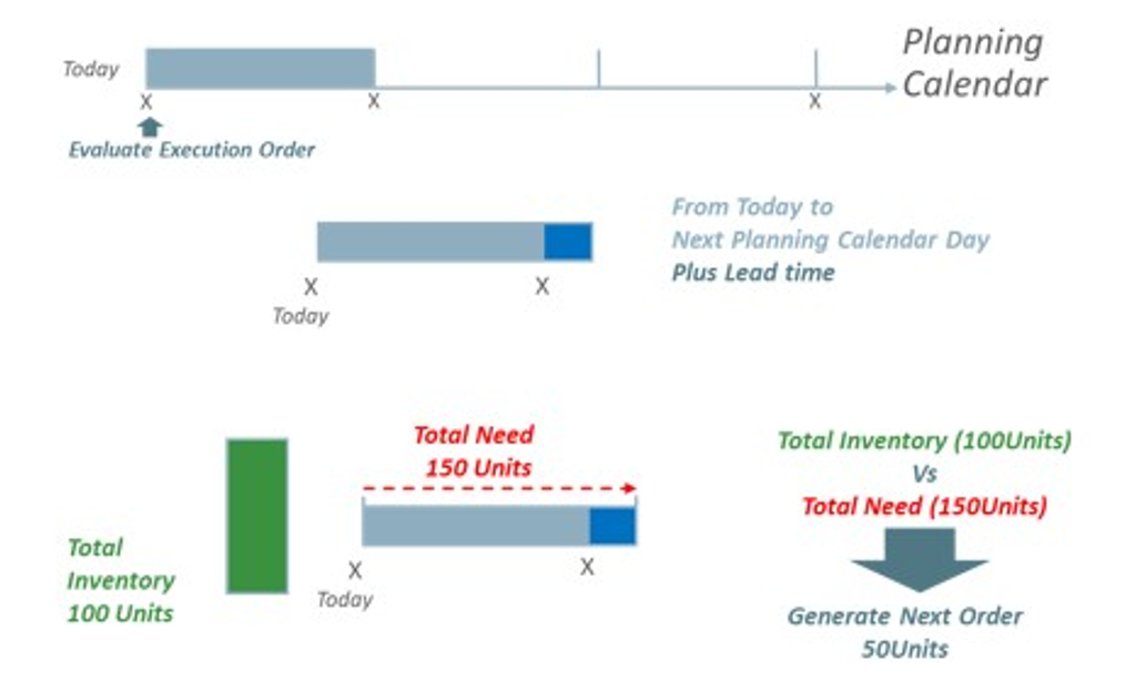

The replenishment is a point in time replenishment. In another words, it calculates the replenishment units, for a particular product and location combination, to fulfil the demand from the system date until the next planning day in the Planning Calendar plus the lead time.
Figure 20-12 Point in Time Replenishment

Lifecycle Inventory Planning has the following replenishment methods for the ROL and RUTL calculations.
ROL Methods
Statistical Safety Stock: This replenishment method calculates the ROL taking into account the cumulated demand forecast from current date up to the number of days set as Lead Time plus Next Review Time. It considers the Target Service Level (Target SL %) and Volatility (Volatility %) in the calculation too
Minimum Time Supply: This replenishment method calculates the ROL taking into account the cumulated demand forecast from current date up to the number of days defined as minimum time to supply (in days).
Minimum Quantity: This replenishment method calculates the ROL taking into account the value defined as the minimum quantity units.
Minimum Safety Time: This replenishment method calculates the ROL to the cumulated demand forecast from the first forecast date up to the number of days set to Lead Time plus Next Review Time plus the number of days to shift set in Minimum Safety Time (days).
Minimum: This replenishment method calculates the ROL to the minimum of the active ROL methods.
Maximum: This replenishment method calculates the ROL to the maximum of the active ROL methods.
Sum: This replenishment method calculates the ROL to the sum of the active ROL methods.
RUTL Methods
Maximum Quantity: This replenishment method calculates the RUTL taking into account the value defined as the maximum quantity units.
Maximum Time Supply: This replenishment method calculates the RUTL taking into account the cumulated demand forecast from current date up to the number of days defined as maximum time to supply (in days).
Target Days Of Supply:This replenishment method calculates the RUTL taking into account the cumulated demand forecast from current date up to the number of days defined as days of supply or up to the number of days of Lead Time plus Next Review Time. The application picks the highest number of days between the two options.

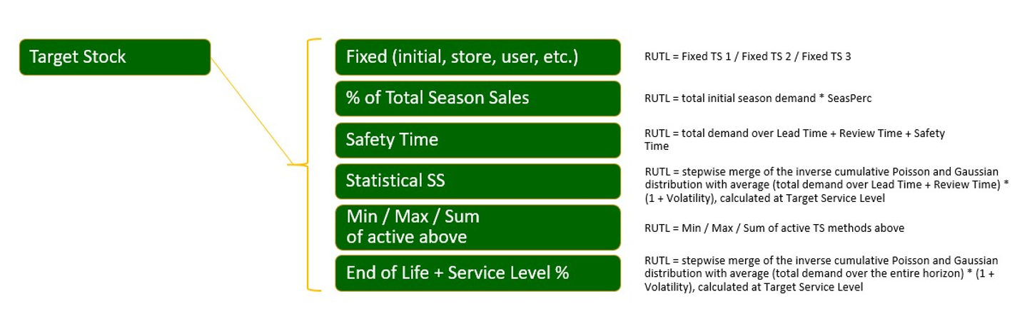

Target Stock: This replenishment method more suitable to the short lifecycle products. The replenishment engine calculates the RUTL based on a target stock quantity. The target stock quantity can be calculated using the following options.
Fixed 1: This method sets the target stock to the initial allocation quantity (loaded from external sources).
Fixed 2: This method sets the target stock to an user-entered allocation quantity (managed within IPOCS-Lifecycle Allocation and Replenishment).
Fixed 3: This method sets the target stock to any other potential source for the initial allocation (this is a placeholder than can be used by customers).
Season Sales Percentage: This method sets the target stock a percentage of the total season sales. Used to define percentage to calculate the value from the total initial forecast for the season.
Stock Safety Time: This method sets the target stock to the cumulated demand forecast from the first forecast date in the future up to the number of days set to Lead Time plus Next Review Time plus the number of days to shift.
Statistical Safety Stock: This method sets the target stock to the cumulated demand forecast from current date up to the number of days set as Lead Time plus Next Review Time. It considers the Target Service Level (Target SL %) and Volatility (Volatility %) in the calculation too.
End of Life: This method sets the target stock to the cumulated demand forecast from current date up to the end of life date. It considers the Target Service Level (Target SL %) and Volatility (Volatility %) in the calculation too.
Minimum: This method sets the target stock to the minimum of the active Target Stock methods (excluding End of Life).
Maximum: This method sets the target stock to the maximum of the active Target Stock methods (excluding End of Life).
Sum: This method sets the target stock to the sum of the active Target Stock methods (excluding End of Life).
Minimum: This replenishment method calculates the RUTL to the minimum of the active RUTL methods.
Maximum: This replenishment method calculates the RUTL to the maximum of the active RUTL methods.
Sum: This replenishment method calculates the RUTL to the sum of the active RUTL methods.

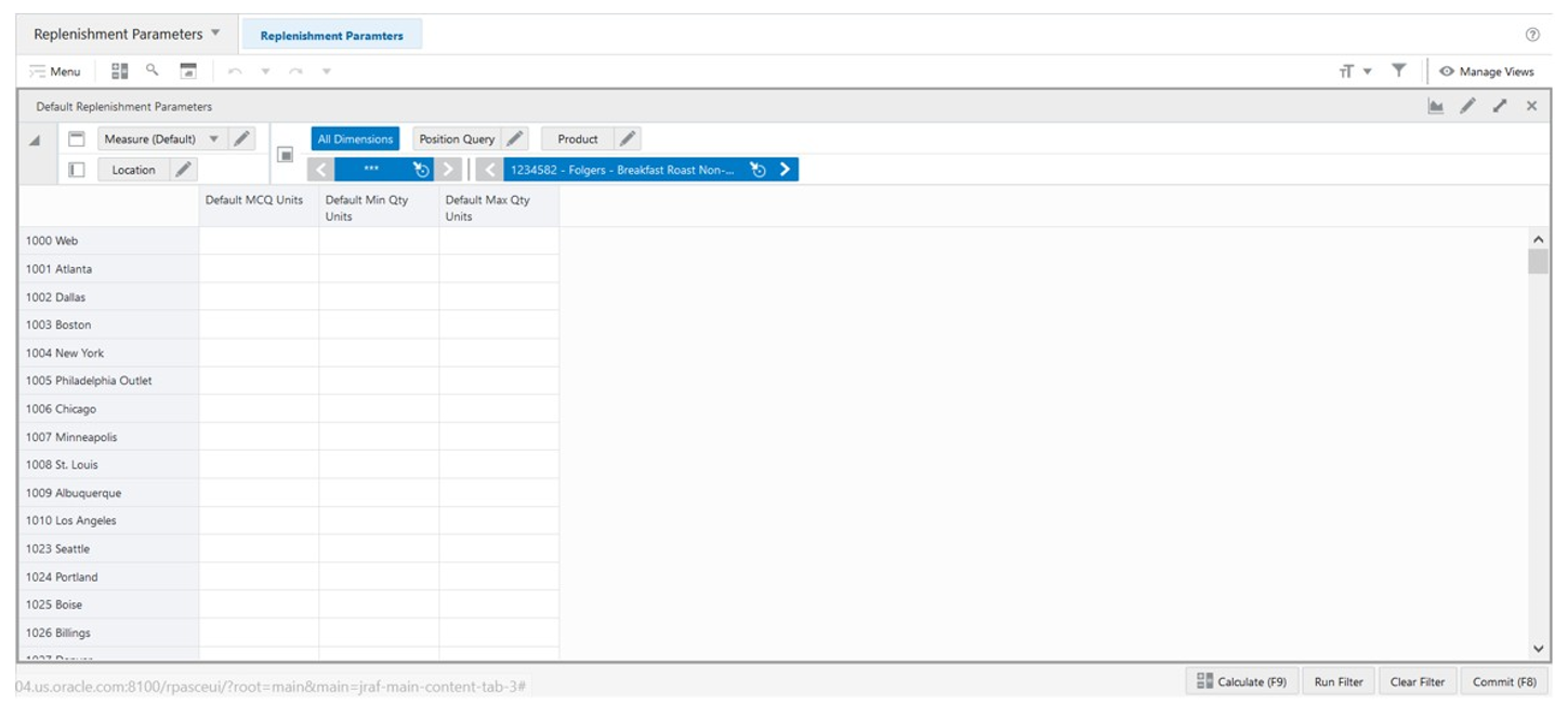

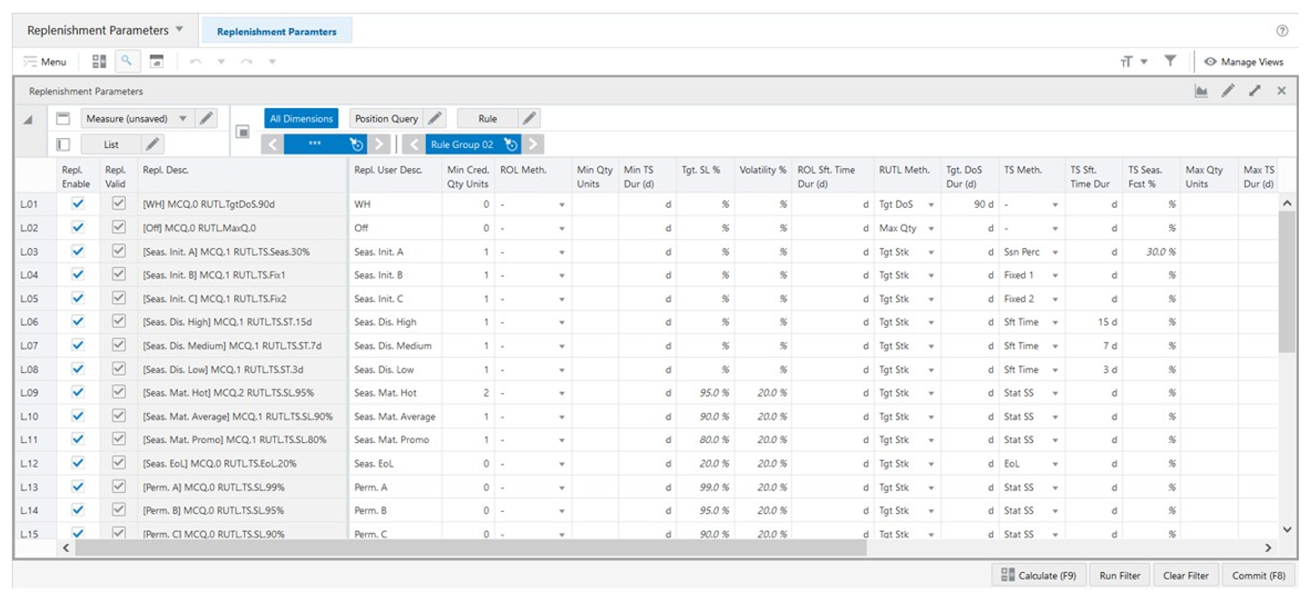

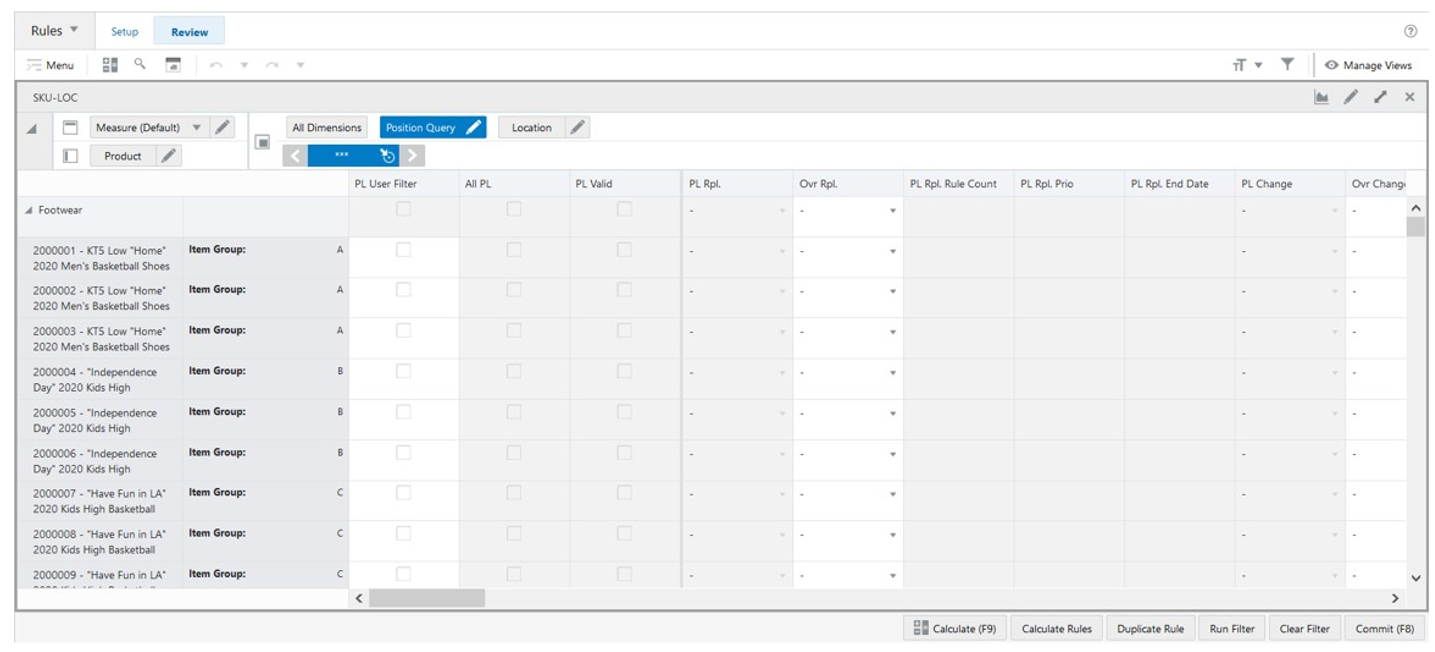

Replenishment Parameters View
The Replenishment Parameters View, under the Replenishment Parameters tab, allows you to set up of all possible Replenishment Parameters that can be used by the replenishment parameters rules to be applied on products and locations for the Replenishment (Point-In-Time) calculation. Each list (row) in the view represents a different replenishment parameter set up.
Figure 20-16 Replenishment Parameters View
Replenishment Parameters View - Default Profile Measures
The Replenishment Parameters view contains the following measures.
Replenishment Enable
Replenishment Enable is an editable measure used to enable or disable a replenishment parameter. Each row (or list) represents a different replenishment parameter.
Replenishment Valid
Replenishment Valid is a calculated measure used to indicate if the set up of the replenishment parameter is valid or not. For example, if the Reorder Level (ROL) and Reorder Up to Level (RUTL) methods are missing then the replenishment parameter is not valid for the rule engine.
Replenishment Description
Replenishment Description is a calculated measure used to indicate the replenishment parameter description. The description is calculated based on the replenishment parameter user-defined description and the replenishment parameter set up selected by you.
Replenishment User Description
Replenishment User Description is an editable measure used to enter a user-defined replenishment parameter description. The final replenishment parameter description takes the user-defined description into consideration. The entered value must not contain a colon punctuation mark (:).
Minimum Credible Quantity Units
Minimum Credit Quantity Units is an editable measure used to define the minimum amount of stock desired to have on hand for sales purposes.
Reorder Level (ROL) Method
Reorder Level Method is an editable measure to select the method to be used by the replenishment engine to calculate the ROL. Valid values are:
Option to clear the ROL Method.
Minimum Quantity
Option to set up the ROL Method as the Minimum Quantity method. When selected the ROL is calculated to the value set in the measure Minimum Quantity Units.
Minimum Target Stock
Option to set up the ROL Method as the Minimum Time Supply method. When selected the ROL is calculated value of the cumulated demand forecast from current date up to the number of days set in the measure Minimum Target Stock Duration (day).
Stat Safety Stock
Option to set up the ROL Method as the Statistical Safety Stock method. When selected the ROL calculation uses the lead time, the next review time in the Planning Calendar, the service level set in the measure Target Service Level % and the volatility set in the measure Volatility %.
When the RUTL method is set to Target Stock the RUTL and ROL will have the same value. No need to select the ROL method in this case.
Minimum Quantity Units is an editable measure used to fix the minimum amount of stock desired when the ROL method is set to Minimum Quantity.
Minimum Time Supply Duration (day) is an editable measure used to fix the number of days to use to calculate the ROL value from the cumulative demand forecast. This measure is used when the ROL method is set to Minimum Target Stock.
Target Service Level Percentage is an editable measure used to define the service level. This value is used in the ROL and RUTL calculation when the statistical safety stock method is used.
Volatility %
Volatility Percentage is an editable measure used to define the volatility. This value is used in the ROL and RUTL calculation when the statistical safety stock method is used.
ROL Stock Safety Time Duration (day) Reorder Up to Level (RUTL) Method
Reorder Level Stock Safety Time Duration (day) Reorder Up to Level Method is an editable measure to select the method to be used by the replenishment engine to calculate the RUTL. The valid values are:
Option to clear the RUTL Method.
Maximum Quantity
Option to set up the RUTL Method as the Maximum Quantity method. When selected the RUTL is calculated to the value set in the measure Maximum Quantity Units.
Maximum Target Stock
Option to set up the RUTL Method as the Maximum Time Supply method. When selected the RUTL is calculated to the value of the cumulated demand forecast from current date up to the number of days set in the measure Maximum Target Stock Duration (day).
Target Days of Supply
Option to set up the RUTL Method as the Target Days of Supply method. When selected the RUTL is calculated to the value of the cumulated demand forecast from current date up to the highest number of days from the following options.
Number of days fixed in the measure Target Days of Supply Duration (day)
Number of days of lead time plus number of days to the next review time
Target Stock
Option to set up the RUTL Method as the Target Stock method. When selected the RUTL is calculated using the method selected in the measure Target Stock Method
Target Days of Supply Duration (day) is an editable measure used to fix the number of days to use to calculate the RUTL value from the cumulative demand forecast. This measure is used when the RUTL method is set to Target Days of Supply.
Target Stock Method
Target Stock Method is an editable measure to select the target stock method to be used by the replenishment engine when the RUTL method is Target Stock. The valid values are:
Option to clear the target stock Method.
Fixed 1
When selected the target stock is calculated to the value set in the measure Target Stock Fixed 1 (initial allocation).
Fixed 2
When selected the target stock is calculated to the value set in the measure Target Stock Fixed 2 (manual allocation).
Fixed 3
When selected the target stock is calculated to the value set in the measure Target Stock Fixed 3 (placeholder for other source of allocation).
Stock Seasonal Percentage
When selected the target stock is calculated as a percentage of the total forecast sales for the season. The percentage used in the calculation is the one set in the measure Target Stock Seasonal Forecast %.
Stock Safety Time
When selected the target stock is calculated to the value of the cumulated demand forecast from current date up to the number of days of the lead time plus the number of days to the next review time plus the number of days for the Target Stock Safety Time Duration (measure Target Stock Stock Safety Time Duration (day)).
When selected the target stock is calculated to the value of the cumulated demand forecast plus the safety stock from current date up to the number of days of the Lead Time plus the number of days for the next review time plus the number of days for the Target Stock Safety Time Duration (measure Target Stock Stock Safety Time Duration (day)). It also considers the service level set in the measure Target Service Level % and the volatility set in the measure Volatility % when calculating the target stock.
End of Life
When selected the target stock is calculated to the value of the cumulated demand forecast plus the safety stock from current date up to the number of days to reach the end-of-life date. It also considers the service level set in the measure Target Service Level % and the volatility set in the measure Volatility % when calculating the target stock.
Minimum
When selected the target stock is the minimum value from the methods of Fixed, % of Total Season Sales, Safety Time and Statistical SS.
Maximum
When selected the target stock is the maximum value from the methods of Fixed, % of Total Season Sales, Safety Time and Statistical SS.
Target Stock Stock Safety Time Duration (day) is an editable measure used to set the number of days for the stock safety. This value is used in the target stock calculations when the RUTL method (RUTL Method) is set to Target Stock and the target stock method (Target Stock Method) is set either to Stock Safety Time or to Statistical Safety Stock.
Target Stock Seasonal Forecast Percentage is an editable measure used to set the percentage of the Seasonal Forecast that should be used to calculate the target stock. This value is used when the RUTL method (RUTL Method) is set to Target Stock and the target stock method (Target Stock Method) is set Season Sales Percentage.
Maximum Quantity Units is an editable measure used to fix the maximum amount of stock desired when the RUTL method is set to Maximum Quantity.
Maximum Target Stock Duration (day) is an editable measure used to fix the number of days to use to calculate the RUTL value from the cumulative demand forecast. This measure is used when the RUTL method is set to Maximum Target Stock.
Order Round
Order Round is an editable measure used to set the percentage on when to round up the orders if the pack size is greater than 1.
Rule Replenishment Count
Rule Replenishment Count is a calculated measure used to display the total number of rules that are using the replenishment parameter.
Product Location Replenishment Count
Product and Location Replenishment Count is a calculated measure used to display the total number of product and location combinations that associated with the replenishment parameter.
Product Location Replenishment %
Product and Location Replenishment Percentage is a calculated measure used to indicate, in percentage, how much the product and location combinations associated with the replenishment parameter represents in the total of product and location combinations with a lifecycle phase value. The measure is calculated as:

Replenishment Change Parameters Concept
Replenishment change parameters allows you to set up parameters to override the system calculated Re-Order Level (ROL) and the Re-Order Up to Level (RUTL) values (calculated from the replenishment parameters set up).
The change replenishment parameters provide the following capabilities. You can:
Define a percentage to increase or decrease the system calculated ROL and RUTL.
Override the replenishment parameters status. When a replenishment parameter status is enabled, the change parameter can force the replenishment parameter status to disable and the other way around.
As an example, the replenishment change parameters can be leveraged to prepare for an upcoming event by incising the RUTL providing the adequate stock to cover the upcoming demand.
Following are some examples of a set up for the change parameters:
ON – Overrides replenishment parameters status to Enable OFF – Overrides replenishment parameters status to Disable
RUTL +10% – Overrides the system calculated receipt up to level to increase it by 10%
RUTL +25 % – Overrides the system calculated receipt up to level to increase it by 25%
RUTL -10 % – Overrides the system calculated receipt up to level to decrease it by 10%
RUTL -25 % – Overrides the system calculated receipt up to level to decrease it by 25%
Figure 20-18 Replenishment Change Parameters RUTL +10%
Figure 20-19 Replenishment Change Parameters RUTL +10% & ROL +10%

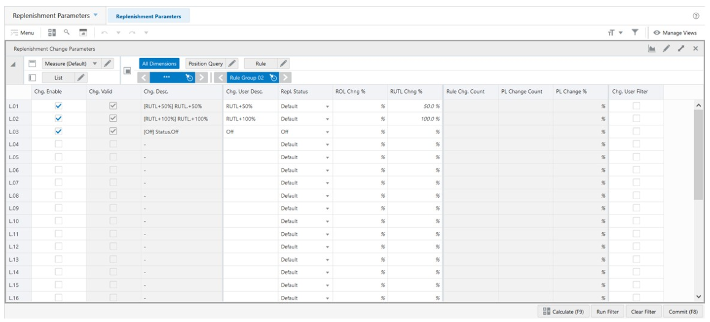

Replenishment Change Parameters View
The Replenishment Change Parameters View, under the Replenishment Parameters tab, allows you to set up changes to the existing replenishment set up. The change parameters allows you to increase or decrease the calculated Reorder Up to Level (RUTL) and Reorder Level (ROL) values and also allows you to override the replenishment status by enabling or disabling it.
Figure 20-20 Replenishment Change Parameters View
Replenishment Change Parameters View - Default Profile Measures
The Replenishment Change Parameters view contains the following measures.
Change Enable
Change Enable is an editable measure used to enable or disable a replenishment change parameter. Each row (or list) represents a different replenishment change parameter.
Change Valid
Change Valid is a calculated measure used to indicate if the set up of the replenishment change parameter is valid or not. For example, if the replenishment status is kept as default and no ROL and/or RUTL change percentage are indicated then the replenishment change parameter is not valid for the engine.
Change Description
Change Description is a calculated measure used to indicate the replenishment change parameter description. The description is calculated based on the replenishment change parameter user-defined description and the replenishment change parameter set up selected by you.
Change User Description
Change User Description is an editable measure used to enter a user-defined replenishment change parameter description. The final replenishment change parameter description takes the user-defined description into consideration. The entered value must not contain a colon punctuation mark (:).
Replenishment Status
Replenishment Status is an editable measure that allows you to override the replenishment status. The valid values are: Default : Option to not change the replenishment status and keep the system generated replenishment status.
On — Option to force the replenishment to turn on the replenishment
Off— Option to force the replenishment to turn off the replenishment
Reorder Level Change %
Reorder Level Change Percentage is an editable measure used that allows you to increase or decrease the system generated ROL value by the percentage value set in this measure. When the ROL should be increase then enter a positive value. When the ROL should be decreased then enter a negative value.
Reorder Up to Level Change %
Reorder Up to Level Change Percentage is an editable measure used that allows you to increase or decrease the system generated RUTL value by the percentage value set in this measure. When the RUTL should be increase then enter a positive value. When the RUTL should be decreased then enter a negative value.
Rule Change Count
Rule Change Count is a calculated measure used to display the total number of rules that are using the replenishment change parameter.
Product Location Change Count
Product and Location Change Count is a calculated measure used to display the total number of product and location combinations that associated with the replenishment change parameter.
Product Location Change %
Product and Location Change Percentage is a calculated measure used to indicate, in percentage, how much the product and location combinations associated with the replenishment change parameter represents in the total of product and location combinations with a lifecycle phase value. The measure is calculated as:
Figure 20-21 Calculation
Change User Filter
Change User Filter is an editable measure used to select the replenishment change parameter to filter the views by the selected replenishment change parameter. This measure is used by the Run Filter action button responsible to calculate the filters applied to the views within the Replenishment Parameters Rules workspace.
Default Replenishment Parameters View
The Default Replenishment Parameters view allows you to set up the default replenishment strategies.
Figure 20-22 Default Replenishment Parameters View
Default Replenishment Parameters View - Default Profile Measures
The Default Replenishment Parameters view contains the following measures.
Default Minimum Credible Quantity Units
Default Minimum Credible Quantity Units an editable measure used to define the default Minimum Credible Quantity for the product and location combination.
Default Minimum Quantity Units
Default Minimum Quantity Units is an editable measure used to define the default the minimum amount of stock desired when the ROL method is set to Minimum Quantity.
Default Maximum Quantity Units
Default Maximum Quantity Units is an editable measure used to define the default maximum amount of stock desired when the RUTL method is set to Maximum Quantity.
Inventory Plan Parameters Step
This step contains this view, Inventory Plan Parameters View.
Inventory Planning Parameters Key Concept
Use Inventory planning parameters to generate the time-phased inventory planning. Inventory parameters specify the System Minimum (which is the reorder level) and the System Maximum (which is the reorder up to level) methods along with the associated parameters is used in generating the time phased plans.
System Minimum (ROL) is the inventory level that determines whether an order for replenishment should be placed at point of receipting week. At the point of receipting week, if the stock levels are less than the System Minimum, then an order for replenishment is placed, otherwise it is ignored until the next cycle.
System Maximum (RUTL) is the target inventory level. While the replenishment point in time generates the orders at the system date. The time-phased inventory planning provides you with a weekly view on the inventory and the orders to be placed (the inventory plan is a projection based on current point in time network and product lifecycle status).
Time-Phased Replenishment Methods
IPOCS-Lifecycle Allocation and Replenishment has the following replenishment methods for the System Minimum (ROL) and System Maximum (RUTL) calculations.
Fixed
This method uses the point-in-time replenishment values and does not calculate at every receipt opportunity. Either the ROL or RUTL values can be chosen from the point in time replenishment.
Forward Cover
This method calculates the value to cover the demand for the minimum number of days that should set by you in this method.
Minimum
This method uses the calculated value from the Fixed and Forward Cover methods and results is the lowest value between the two.
Maximum
This method uses the calculated value from the Fixed and Forward Cover methods and the result is the highest value between the two.
Sum
This method uses the calculated value from the Fixed and Forward Cover methods and the result is the sum both values.
Fixed
This method sets the value to a fixed user-defined value.
Forward Cover
This method calculates the value to cover the demand for the maximum number of days that should set by you in this method.
Minimum
Maximum
Sum
Figure 20-23 Time-Phased Replenishment Methods

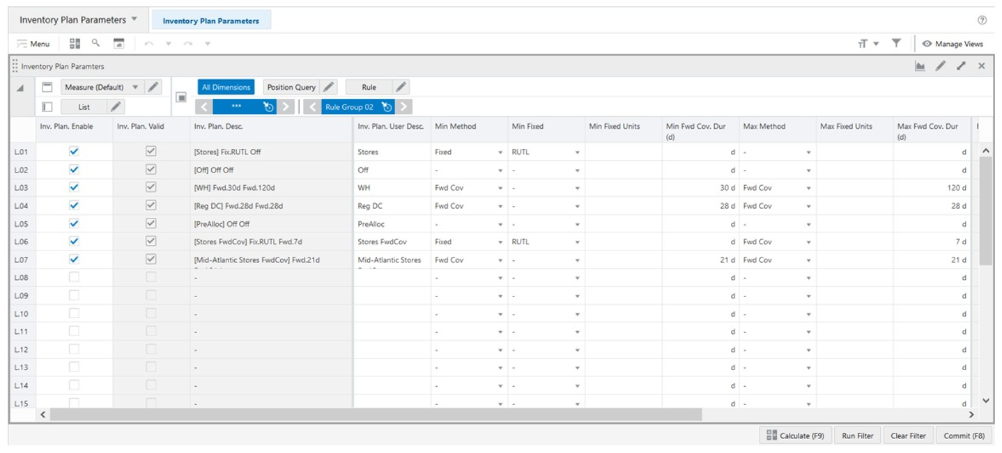

The Inventory Plan Parameters View, under the Inventory Plan Parameters tab, allows you to set up all the possible Minimum and Maximum Level Methods for the Inventory Plan that can be used to set up the replenishment rules that will then be used by the engine to generate the time-phased replenishment.
Figure 20-24 Inventory Plan Parameters View
Inventory Plan Parameters View - Default Profile Measures
The Inventory Plan Parameters view contains the following measures.
Inventory Plan Enable
Inventory Planning Enable is an editable measure used to enable or disable an inventory planning parameter. Each row (or list) represents a different inventory planning parameter.
Inventory Planning Valid is a calculated measure used to indicate if the set up of the inventory planning parameter is valid or not. An inventory planning parameter is considered valid if it is enabled.
Inventory Plan Description
Inventory Planning Description is a calculated measure used to indicate the inventory planning parameter description. The description is calculated based on the inventory planning parameter user-defined description and the inventory planning parameter set up selected by you.
Inventory Plan User Description
Inventory Planning User Description is an editable measure used to enter a user-defined inventory planning parameter description. The final inventory planning parameter description takes the user-defined description into consideration. The entered value must not contain a colon punctuation mark (:).
Minimum Method
Minimum Method is an editable measure used to select the method to calculate the System Minimum (which is the reorder level) value. The valid values are:
Fixed
When this option is selected, then the point-in-time replenishment is used for the calculation and in the measure Minimum Fixed.
Forward Cover
When this option is selected, then the calculation calculates the demand to cover the amount of stock required for the number of days indicated in the measure Minimum Forward Cover Duration (day).
Minimum
When this option is selected, then the calculation sets the value to the minimum value resulted from the Fixed and Forward Cover methods.
Maximum
When this option is selected, then the calculation sets the value to the maximum value resulted from the Fixed and Forward Cover methods.
Sum
When this option is selected, then the calculation sets the value to the sum of the values resulted from the Fixed and Forward Cover methods.
Minimum Fixed
Minimum Fixed is an editable measure used to select how the Fixed method calculates the System Minimum (which is the reorder level) value. The valid values are:
When this option is selected the result is set to the value in the measure Minimum Fixed Units.
ROL
When this option is selected the result is set to the ROL value from the point-in-time replenishment.
RUTL
When this option is selected the result is set to the RUTL value from the point-in-time replenishment.
Minimum Fixed Units
Minimum Fixed Units is an editable measure used to define the minimum fixed quantity to be used when the Minimum Method is Fixed and the Minimum Fixed is -.
Minimum Forward Cover Duration (day) is an editable measure used to define the minimum number of days of cover to be used when the Minimum Method is Forward Cover.
Maximum Method
Maximum Method is an editable measure used to select the method to calculate the System Maximum (which is the reorder up-to level) value. The valid values are:
Fixed
When this option is selected the calculation sets it to the value in the measure Maximum Fixed Units.
Forward Cover
When this option is selected, then the calculation calculates the demand to cover the amount of stock required for the number of days indicated in the measure Maximum Forward Cover Duration (day).
Minimum
Maximum
Sum
Maximum Fixed Units
Maximum Fixed Units is an editable measure used to define the maximum fixed quantity to be used when the Maximum Method is Fixed.
Maximum Forward Cover Duration (day) is an editable measure used to define the maximum number of days of cover to be used when the Maximum Method is Forward Cover.
Rule Inventory Planning Count
Rule Inventory Planning Count is a calculated measure used to display the total number of rules that are using the inventory planning parameter.
Product Location Inventory Planning Count
Product and Location Inventory Planning Count is a calculated measure used to display the total number of product and location combinations that associated with the inventory planning parameter.
Product Location Inventory Planning %
Product and Location Inventory Planning Percentage is a calculated measure used to indicate, in percentage, how much the product and location combinations associated with the inventory planning parameter represents in the total of product and location combinations with a lifecycle phase value. The measure is calculated as:
Figure 20-25 Calculation
Inventory Planning User Filter
Inventory Planning User Filter is an editable measure used to select the inventory planning parameter to filter the views by the selected inventory planning parameter. This measure is used by the Run Filteraction button responsible to calculate the filters applied to the views within the Replenishment Parameters workspace.

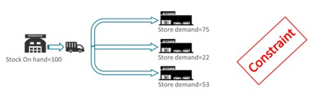

Replenishment Constraint Parameters Concept
Replenishment Constraint Parameters allows you to set up parameters to indicate to the replenishment engine how to ration the stock when there is a stock constraint (for example, shortage). When facing stock shortages, the engine needs to adapt and fulfil the remaining stock to the stores in a way that ensures that the highest probability of sales is covered.
Figure 20-26 Example of a Replenishment Constraint
Rationing constrained stock is not solely based on store priority; allocating to the biggest (most important) stores can create missed sales. The replenishment engine approaches rationing based on the concept of layers. It tries to fulfill the most important on all stores requiring stock (using the store priority) before moving to the next layer. In this manner, the replenishment engine maximizes both service levels and the ability to sell.
The following available layers within IPOCS-Lifecycle Allocation and Replenishment are listed from the highest priority to the lowest priority:
Customer Orders
Display Quantity
Target Stock - Reorder Level (ROL)
Target Stock - Reorder Up-To Level (RUTL)
Target Stock - Pack
Target Stock - Push
Figure 20-27 Example of Rationing based on Layers
As illustrated in the previous image the engine prioritizes the Store 3 despite the fact it is not the store with the higher priority. However, the Store 3 is where the layer with the higher priority needs to be fulfilled first. Once that layer is fulfilled, the engine moves to the stores the next layer with more priority needs to be fulfilled and so on until the available stock is distributed. Note that if there are two stores for the same layer priority to be fulfilled then the store priority is used.

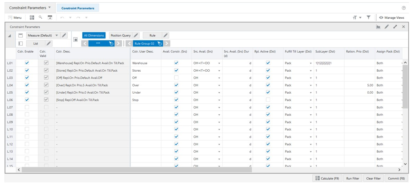

Constraint Parameter View
The replenishment engine utilizes constraint parameters to define the allocation of stock by changing the priorities of the destination location and/or changing the layer of allocation to fulfill. You may also set the destination location to active or not and the source location to constrained or unconstrained.
Figure 20-28 Constraint Parameters View
Constraint Parameters View - Default Profile Measures
The Constraint Parameters view contains the following measures.
Constraint Enable
Constraint Enable is an editable measure used to enable or disable a replenishment constraint parameter. Each row (or list) represents a different replenishment constraint parameter.
Constraint Valid
Constraint Valid is a calculated measure used to indicate if the set up of the replenishment constraint parameter is valid or not. A replenishment constraint parameter is considered valid if it is enabled.
Constraint Description
Constraint Description is a calculated measure used to indicate the replenishment constraint parameter description. The description is calculated based on the replenishment constraint parameter user-defined description and the replenishment constraint parameter set up selected by you.
Constraint User Description
Constraint User Description is an editable measure used to enter a user-defined replenishment constraint parameter description. The final replenishment constraint parameter description takes the user-defined description into consideration. The entered value must not contain a colon punctuation mark (:).
Available Constraint (Source)
Available Constraint (Source) is an editable measure used to enable or disable the constraint for the source location.
Source Available (Source)
Source Available (Source) is an editable measure to select which stock units are used from the source locations. The valid values are:
OH
Option to use stock on hand as the available stock.
OH+IT
Option to use stock on hand plus the stock in transit as the available stock.
OH+IT+OO
Option to use stock on hand plus the stock in transit plus the stock on-order as the available stock.
Source Available Order
This measure allows the ability to decide from which bucket to choose the units while allocating purchase orders. The options are:
OH followed by OO
The on-hand units are used first, then the on-order.
OO followed by OH
The on-order units are used first, then the on-hand.
Source Available (Source) Duration (day)
Source Available (Source) Duration (day) is an editable measure used to define the number of days to get the in-transit and on-order stock. This number of days is used to calculate the available stock at the source location, measure Source Available (Source), when the in-transit and/or on-order option is selected.
Replenishment Active (Destination)
Replenishment Active (Distribute) is an editable measure used to enable or disable the replenishment for the destination location.
Fulfill Till Layer (Destination)
Fulfill Till Layer (Distribute) is an editable measure used to select the layer until which the engine should fulfill the demand at the destination location. You should select one of the following options:
1st layer = Customer Order
2nd layer = Display Quantity
3rd layer = Minimum Credible Quantity
4th layer = Reorder Level
5th layer = Reorder Up to Level
6th layer = Pack
7th layer = Push
SubLayer (Destination)
SubLayer (Distribute) is an editable measure used to define the sublayer at the destination location for each of the layers until the selected layer in the measure FulFill Till Layer (Destination). Use the | character to separate the number of sublayers between layers. For example, if the layer selected in the measure FulFill Till Layer (Destination) is the 5th layer = Reorder Up-To Level and the sublayers are as follows:
Customer Order has one layer
Display Quantity has two layers
Minimum Credible Quantity has two layers
Reorder Level (ROL) has two layers
Reorder Up to Level (RUTL) has two layers
Then the value for this measure is: 1|2|2|2|2

Following are two examples and illustrations of rules for the Replenishment Parameters task.
Rule 1
Should be configured to apply the Replenishment Param 1, Change Param 1, Constraint Param 1, and Inventory Plan Param 1.
The scope of the rule group where it is being configured (for example, Sport Bag products and the country France).
The condition where the rule applies is for all locations and products in the scope where the product-location lifecycle phase attribute is Discovery.
Rule 2
Should be configured to apply the Replenishment Param 2, Change Param 2, Constraint Param 2, and Inventory Plan Param 2.
The condition where the rule applies is for all locations and products in the scope where the product-location lifecycle phase attribute is Maturity.
The condition is used by the rule engine to apply the set up to the product and location combinations that match the condition within the rule scope. The rule scope is defined by the Product Groups and Location Groups associated with the rule’s rule group.
Figure 20-31 Illustration for a Rule 1
Figure 20-32 Illustration for a Rule 2

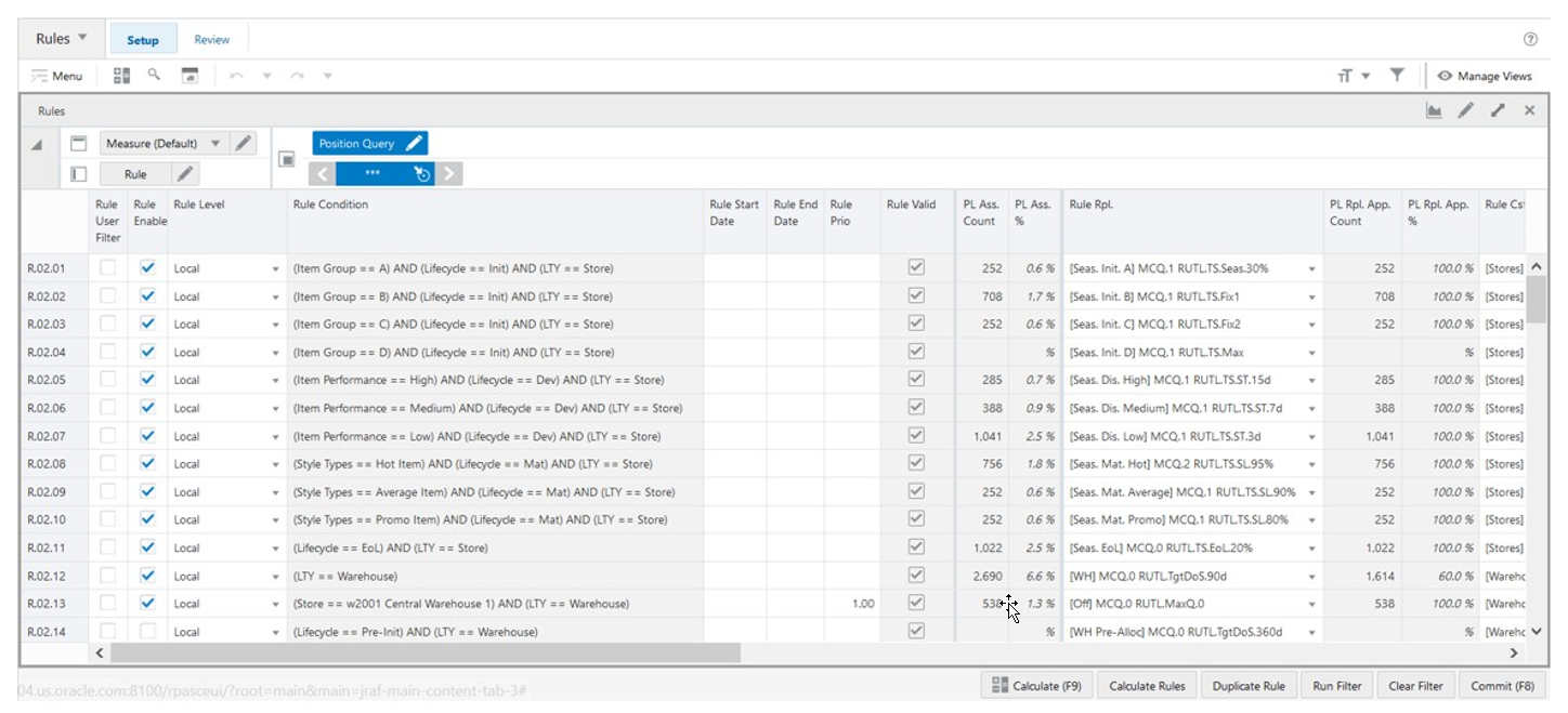

Rules View
The Rules View, under the Setup tab, allows you to configure the rules by enabling them and defining the rule start date, end date and priority for each one. Once configured you can set up the rule by selecting the replenishment parameters, replenishment change parameters, replenishment constraint parameters and inventory planning parameters that the rule uses. The product and locations that applies the rule set up is based on the scope of the rule’s rule group (Product Scope and Location Scope views) and the rule’s condition that is set up and managed in the Conditions view.
Figure 20-33 Rules View

Item-Location View
The Item-Location View, under the Review tab, allows you to review the results of running the rule engine calculation based on the rules set up in the workspace. In this view you can review to the results at the lowest level, item and location levels, and can also create exceptions, at the item-location level, to overwrite the replenishment set up calculated by the rule engine (for example, a particular item and location that should apply a different replenishment parameter from all the other item locations in the same rule).
Figure 20-40 Item-Location View
Item-Location View - Measure Profiles
The Item-Location View contains the following profiles to change the measures that are visible in the view:
Default
This profile is used as default by the view. All the available/visible measures are listed and described in the section Measure: Default Profile.
Change
This profile displays a subset of measures from the default profile. It focuses on the replenishment change parameters measures only. All other parameter related measures are left out of the visible measures.
Constraint
This profile displays a subset of measures from the default profile. It focuses on the replenishment constraint parameters measures only. All other parameter related measures are left out of the visible measures.
Inventory Plan
This profile displays a subset of measures from the default profile. It focuses on the inventory planning parameters measures only. All other parameter related measures are left out of the visible measures. Replenishment: This profile displays a subset of measures from the default profile. It focuses on the replenishment parameters measures only. All other parameter related measures are left out of the visible measures.
Item-Location View - Default Profile Measures
The Item-Location View contains the following measures.
Product Location User Filter
Product and Location User Filter is an editable measure used to select the product and location combinations to filter the views by the selected the product and location combinations. This measure is used by the Run Filter action button is responsible to calculate the filters applied to the views within the Supply Chain Network workspace.
All Product and Location is a calculated measure used to indicate if a product and location combination is valid or not. If the combination is valid for a lifecycle phase, it displays as selected.
Product and Location Valid is a calculated measure used to indicate if a product and location combination has a valid rule from where the rule engine calculates the replenishment parameters. If the product-location combination is valid, it displays as selected.
Product and Location Replenishment is a calculated measure used to indicate the replenishment parameter applied to the product and location combination. The replenishment parameter displayed is the one calculated by the rule engine using the replenishment rules set up.
Over Replenishment
Over Replenishment is an editable measure that allows you to create exceptions at the item-location level. You can select the replenishment parameter to override the assigned replenishment parameter (measure Product Location Replenishment). This measure is a list populated with all valid replenishment parameter that were set up in the Replenishment Parameters view.
Product Location Replenishment Rule Count
Product and Location Replenishment Rule Count is a calculated measure used to indicate the total number of replenishment parameters that are assigned to the product and location combination based on the Rules set up. Note that a product and location combination can only have one replenishment parameter active. The one that is active is the one from the rule with the highest priority or the user-exception override.
Product Location Replenishment Priority
Product and Location Replenishment Priority is a calculated measure used to indicate the priority of the rule from where the replenishment parameter was calculated for the product and location combination.
Product Location Replenishment End Date
Product and Location Replenishment End Date is a calculated measure used to indicate the end date of the rule from where the replenishment parameter was calculated for the product and location combination.
Product and Location Change is a calculated measure used to indicate the replenishment change parameter applied to the product and location combination. The replenishment change parameter displayed is the one calculated by the rule engine using the replenishment rules set up.
Over Change
Over Change is an editable measure used that allows you to create exceptions at the item-location level. You can select the replenishment change parameter to override the assigned replenishment change parameter (measure Product Location Change). This measure is a list populated with all valid replenishment change parameters that were set up in the Replenishment Change Parameters view.

Default MCQ Units
Default Minimum Credible Quantity Units is an editable measure used to define the default Minimum Credible Quantity for the product and location combination.
Minimum Credible Quantity @ Today Units
Minimum Credible Quantity at Today Units is a calculated measure used to indicate the Minimum Credible Quantity applied to the product and location combination at the system date. The Minimum Credible Quantity displayed is the one calculated by the rule engine using the replenishment rules set up. In case there is no Minimum Credible Quantity from the replenishment rule set up the value from the measure Default MCQ Units is used instead.
Reorder Level Method @ Today
Reorder Level Method at Today is a calculated measure used to indicate the ROL method applied to the product and location combination at the system date. The ROL method displayed is the one calculated by the rule engine using the replenishment rules set up.

Filter Step
This step contains this view, Filter Parameters View.
The Filter Parameters View, under the Filter tab, allows you to set up the filter that can change the scope of the products and locations displayed in all relevant views under the Rules Step within the Replenishment Param. Rules Workspace.
Figure 20-41 Filter Parameters View
Filter Parameters View - Default Profile Measures
The Filter Parameters view contains the following measures.
Filter Not Valid
Filter Not Valid is an editable measure to change the scope of the products and locations displayed in all relevant views under the Rules Step. If the measure is selected, the Run Filter action button is responsible to calculate the filters that only display non-valid product and location combinations. When clear the filter only displays valid product and location combinations. By default, the measure is clear. The measure Product Location Valid identifies whether or not a product and location combination is valid.
Rule -> Product Location Filter
Rule -> Product Location Filter is an editable measure to select how the filter should work in the Item- Location view. Valid values are:
Associated
The view is filtered to display the product and location combinations that are associated with the rules selected in the Rules view (measure Rule User Filter). Note that a product and location combination can fit in more than one rule. When they fit in a rule they are associated regardless, if that rule is the actual one to be applied.
Applied
The view is filtered to display the product and location combinations that apply the rules selected in the Rules view (measure Rule User Filter). The rule is consider as applied when the LIP CS Rule Engine sets the replenishment set up for the product and location combination based on the rule (for example, Bill of Distributions, Planning Calendar, and so on).
Product Location -> Rule Filter
Product and Location -> Rule Filter is an editable measure to select how the filter should work in the Rules view. Valid values are:
Associated
The view is filtered to display rules that are associated with the product and location combinations selected in the Item-Location view (measure Product Location User Filter). Note that a product and location combinations can fit in more than one rule. When they fit in a rule they are associated regardless, if that rule is the actual one to be applied.
Applied
The view is filtered to display rules that are associated with the product and location combinations selected in the Item-Location view (measure Product Location User Filter). The rule is consider as applied when the LIP CS Rule Engine sets the replenishment set up for the product and location combination based on the rule (for example, Bill of Distributions, Planning Calendar, and so on).
In the same way as in the Supply Chain Network workspace, the measure in this view is used by the Replenishment Parameters Run Filter action button to filter the relevant views within the Replenishment Parameters workspace.
Replenishment Parameters Action Buttons
The Replenishment Parameters workspace has the following action buttons available:
Run Filter
Use the Run Filter action button for applying the filters in the Rules views based on the filter set up completed within the workspace. For example, filter based on the User Filter measures.
Clear Filter
Use the Copy-Paste Exceptions action button for removing all filters applied in the Rules views and clears all the User Filter measures within the workspace.
Calculate Rules
Use the Calculate Rules action button for running the rules engine to calculate which rule’s replenishment and inventory planning parameters set up would be applied to the product and location combination level and applying the rule’s replenishment and inventory planning parameters set up down to the product and location combination level.
Duplicate Rule
Use the Duplicate Rule action button to copy all the rules information from the rule selected as the source of the copy and paste it into all the rules selected as the destination of the copy. This action copies all the information in the Rules view and Conditions view.
