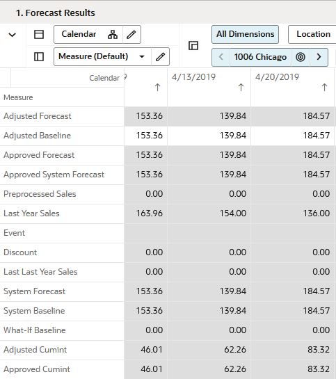

Forecast Results View
The Forecast Results view shows all information related to forecast generation. It shows the forecast with its components, baseline and promotional peaks. It also shows sales of last year, and cumulative interval information.
The navigation of this worksheet is very conveniently driven by real time or workbook alerts.
There is a duplicate of this view - Forecast Results Chart View- that is intended to show the information in chart form.
If not already in chart mode, you need to change the view type from pivot table to chart and save the format. This is a one-time action.
Figure 5-8 Forecast Results View

Adjusted Forecast
This is a read-only measures that equals the adjusted baseline plus the adjusted peaks.
Adjusted Baseline
The value in this field initially defaults to the System Baseline if the forecast is automatically approved by the system or through a Forecast Approval Alert. Otherwise, the value in the Adjusted Baseline is different than the System Baseline if:
Adjusted Baseline has been updated by you.
Keep Last Changes is selected.
Update Last Weeks Forecast is set to Replicate.
Changes to the Adjusted Baseline are automatically approved. The Approval view updates with the date of the adjustment and the name of the user who made the adjustment.
Demand transference is selected as the adjustment method in forecast setup and significant demand transference effects are available.
Approved Forecast
The Approved Forecast is the forecast quantity that was approved at the time of the task build. The values contained in this measure are read-only. If changes are made to the Adjusted Forecast, then click Calculate to show the new value in the Approved Forecast.
Approved System Forecast
The Approved System Forecast is populated with the last System Forecast approved for a time series:
Approval Method set to Automatic Approval
Approval Method set to a Forecast Approval Alert and the alert is not triggered
Update Last Weeks Forecast is set to Use Forecast
Promo Demand
This read-only measure is the demand data used to generate the forecast. This allows you to compare Actuals to forecast values. The Promo Demand is based on the historical sales which are undergoing several rounds corrections.
Last Year Sales
Event
This measure displays at the item, location, and week level if one or more offers were active. This usually goes together with the Discount measure.
Discount
This is the discount from the full price for which a product was sold at a given location for a given time period.
Last Last Year Sales
System Forecast
This is a read-only measures that equals the system baseline plus the system peaks.
System Baseline

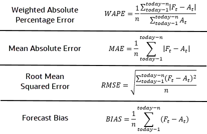

Error Metrics
To assist the forecast analyst in deciding which forecasts to review, there are several error metrics that can be reviewed.
When the accuracy is good with only a small error, the analyst may decide to move on and review other forecasts. When an item performs poorly, the analyst may want to spend some time to adjust the forecast values.
The error metrics are:
Weighted Absolute Percentage Error
Mean Absolute Error
Root Mean Squared Error
Forecast Bias
Figure 5-9 shows the error metrics calculations. Note that they are calculated for each time period
Figure 5-9 Error Metrics Calculations

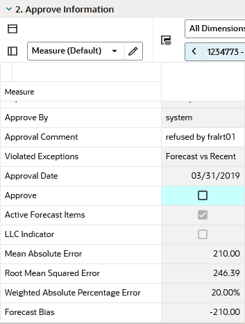

Approve Information View
The Approve Information view shows information around the approval process, like which user approved the forecast, when it was approved and potential notes.
Figure 5-10 Approve Information View

Approve By
Approved By is a read-only field that
displays the name of the user to approve forecasts for an item/location.
This field may be populated with Sys if the
system was set to automatically approve forecasts during the batch
forecast process.
Approval Comment
Approval Comment is a field in which notes may be entered regarding the forecast values or any pertinent information for specified Product/Location combinations.
Violated Exceptions
This field displays which (if at all) approval exception business rule was violated.
Approval Date
Approval Date is a read-only field that displays the date that the forecast quantity is approved either automatically during the batch forecast process or when changes are made to the Adjusted Forecast. This information is necessary for IPOCS-Demand Forecasting to carry out any subsequent processes, such as replenishment procedures.
Approve
This field may be selected if you want to accept the System Forecast quantity for a time series that has yet to be approved. The flag is also activated when a change is made to the Adjusted Forecast and Calculate occurs. When this flag is activated, the time series for an item/location are approved and both the Approval Date and Approved By fields are updated.

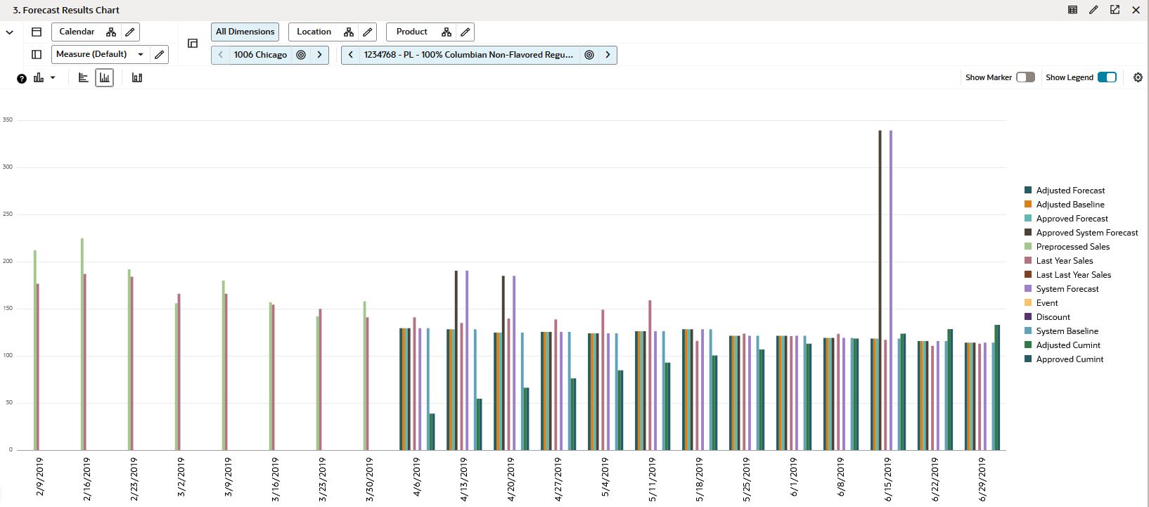

There is a duplicate of this view - Forecast Results View- that is intended to show the information in table form.
Figure 5-12 Forecast Results Chart View

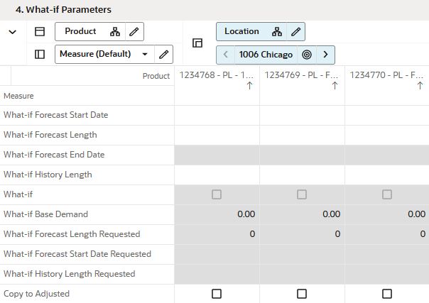

What-if Parameters View
The What-if Parameters view allows you to adjust some forecast parameters and immediately view the effects on the forecast in the Forecast Results view.
If you like the new adjusted forecast, you first have to Approve the forecast to get the forecast in the approved forecast measure. Next you have to Commit to update the database with the approved forecast as well as with the What-if forecast parameters settings. These parameters are used the next time the forecast batch is run.
Parameters that can be adjusted will affect base demand as well as total forecast.
Figure 5-13 What-if Parameters View

What-if Forecast Start Date
This measure lets you specify a different forecast start date then the default used in batch, which is RPAS_TODAY.
What-if Forecast Length
This measure lets you specify a forecast length, which is likely not the default forecast end date less forecast start date used in batch. The value used will be reflected in the Forecast End Date measure.
What-if Forecast End Date
This measure displays the date based on the entries in the Forecast Start Date and Forecast Length. Forecast End Date = Forecast Start Date + Forecast Length.
What-if History Length
This measure lets you specify the number of periods used to calculate the base demand.
What-if
This Boolean measures specifies if the user can perform what-if. If it is unchecked, no what-if is triggered. To perform what-if you need to select at least one of the following measures:
If the What-if flag is on, you can run it by clicking on the What-if custom menu.
What-if Base Demand
This measure displays the value for the base demand based on the new history length.
What-if Forecast Length Requested
This measure displays the requested forecast length. This is useful, because after running the What-if custom menu, the What-if Forecast Length measure will be blanked out. It is this measure where you keep track of the latest forecast length used.
What-if Forecast Start Date Requested
This measure displays the requested forecast start date. This is useful, because after running the What-if custom menu, the What-if Forecast Start Date measure will be blanked out. It is this measure where you keep track of the latest forecast stare date used.
What-if History Length Requested
This measure displays the requested history length. This is useful, because after running the What-if custom menu, the What-if History Length measure will be blanked out. It is this measure where you keep track of the latest history length used.
Copy to Adjusted
After you finish adjusting the parameters, you can either return to reviewing the forecast or you can apply the changes. Enable this measure by selecting the Boolean measure value to true.

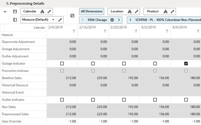

Preprocessing Details View
The Preprocessing Details view shows all necessary information to determine how the loaded sales were transformed into unconstrained demand. You can review the numbers after each step, and also have the possibility to override the total demand. Unconstrained demand is what an item would have sold at a location without the influence of any outside factor. These factors can include:

Figure 5-14 Preprocessing Details View
Measures: Preprocessing Details View
The Preprocessing Details view contains the following measures.
Depromote Adjustment
This measure displays the units that were removed from the historical sales, because they were caused by the lift in demand due to one or more offers.
Outage Adjustment
This measure displays the units that were added to the historical sales, because they were caused by the artificial drop in demand due to stockouts.
Outlier Adjustment
This measure displays the units that were added to the historical sales, because they were caused by the artificial drop in demand due unusual events, like human error, or extreme bottle water sales during a hurricane.
Outage Indicator
This measure is either loaded or calculated by the rules in the custom menu. It is used during the pre-processing run that corrects sales for lost sales.
Promotion Indicator
This measure is usually calculated as the OR of all available offers that are active for a Product/Location/calendar combination. It is used during the preprocessing run that removes promotional sales.
Baseline Demand
This measure represents the demand that was sold at a location without the influence of any outside factor.
Historical Discount
When the Historical Discount or Historical Event measures are not blank, it is likely that the Promotion Indicator is On, and the Depromote Adjustment will also have a non-zero value.
Historical Event
Outlier Indicator
This measure is either loaded or calculated by the rules in the custom menu. It is used during the pre-processing run that corrects the sales for outliers.
Raw Sales
This measure is loaded and it represents the historical sales at a Product/Location/calendar period level. It is different from demand because it may be constrained by stockouts, outliers, weather, and so on.
Promo Demand
This measure represents the demand – including promotion and offer data that was sold at a Product/Location/calendar. If configured properly, the stockout and outliers impact is removed.
User Override
After reviewing all the above measures, this is the place to override the demand at the Product/Location/calendar level. This can be useful for special cases (introduction of key items) as well as extreme situations when entire departments were hurt by natural events, like a pandemic.
