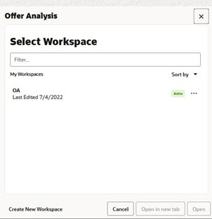

                        Click Promotion Analysis. The wizard opens. You can open an existing workspace, but to create a new workspace, click Create New Workspace. Figure 8-2 Offer Analysis Wizard

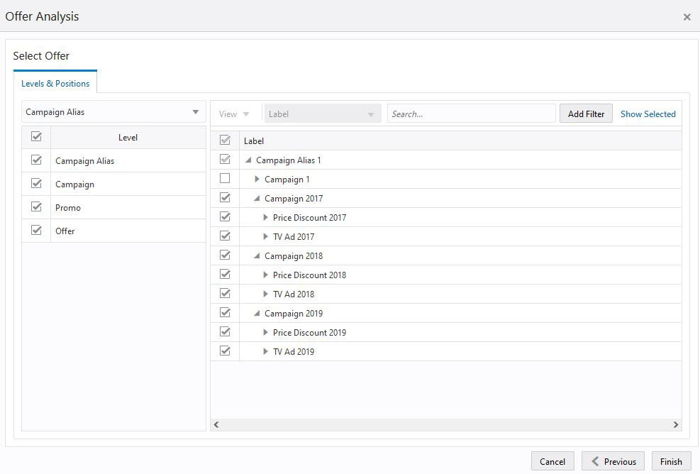

                        Select the offers you want to work with and click Finish. Figure 8-6 Workspace Wizard: Select Offers
