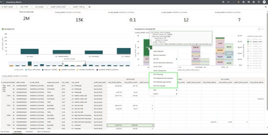

Once in the report, users can select the specific piece of information or data point that requires attention. By right-clicking on the selected item, a contextual menu will appear, offering the option to choose the relevant section within the IPO system where this information should be displayed. Upon selection, the IPO system will open in a new browser tab. The system is designed to recognize the data selected in the report, applying appropriate filters so that users are immediately presented with the most relevant information.
Figure 1-36 Right Click on Selected Portion of Data

  1. To see these alerts in Inventory Planning, right-click the bar chart on the right and select
  2. Click Open IPO - Planning.
  3. The Inventory Planning application will launch already filtered to the products and locations from the report.
