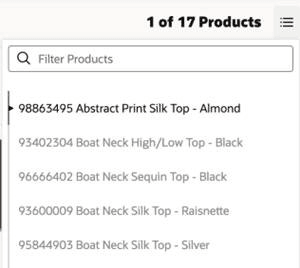

Click the Product Selection control (to the left of the arrow buttons) to display a list of products to select from. Use the search filter at the top to reduce the product list to those that contain the search term.
Figure 1-14 Product Selection
Product Selection

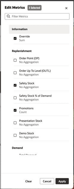

Click theEdit Metricsbutton to display the Edit Metrics panel where you can select metrics.
For each metric, the aggregation method is shown beneath the metric name. Some metrics do not have an aggregation method and will not appear in the aggregate area tables.
Figure 1-17 Metrics Selection
Metrics Selection

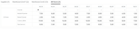

The top table is the "All Locations" table. This table aggregates data from the individual locations to display a summarized supply chain view. As with the rest of the Plan View, this area restricts information to those locations included in the filter that replenish the product currently in focus. Only metrics related to the chart are shown in the aggregate table.
Figure 1-18 Aggregate Table
Aggregate Table
For complete analysis of the time phased plan the individual location tables provide the complete set of replenishment metrics such as the Order Point, Order Up To Level, andother target stock level metrics.
The supply chain can be reviewed through the provided tabs:
  • Supplier - The Supplier tab displays information about those suppliers that provide the product into the supply chain
  • Warehouses – The Warehouse tabs displays information about those warehouses that handle the product for all the included stores. If the product passes through multiple warehouses on the way to the store, then multiple warehouse tabs will be displayed. Warehouse data is not aggregated into a single total
  • Store - The Stores tabs show information about those stores that replenish the product.
Data for the selected metrics will be shown in the tables either for each day (if Daily is selected) or each business week (if Weekly is selected). In the Inventory Plan, you will review the warehouse inventory of the sellable SKUs. This allows you to compare forecast demand and store need to the warehouse's availability. Alerts and replenishment needs are also calculated on the sellable SKU.
