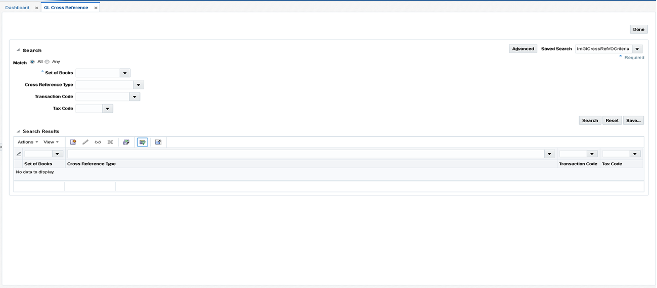

Search for a General Ledger Cross Reference
The GL Cross Reference window provides a way in which to search for already defined GL cross references.
Navigate: From the Tasks menu, select Foundation > GL Cross Reference. The GL Cross Reference window opens.
Figure 3-1 GL Cross Reference Window
From the GL Cross Reference window, use the following criteria to search for existing GL cross references:
Table 3-1 GL Cross Reference Search Fields
Field Description Set of Books
Enter the set of Books associated for which you wish to search.
Cross Reference Type
Enter the Cross Reference Type to be included in the search. Valid values are:
Basic Transactions (BT)
Non-merchandise Codes (NMC)
Reason Code Actions (RCA)
Transaction Code
The Transaction Code to be used in the search.
Transaction codes represent specific accounting transactions that occur in Invoice Match, and which need to be interfaced to an external financial system. Valid values will vary depending on the Cross Reference Type selected.
Tax Code
The Tax Code to be included in the search.
In a tax-off environment the Tax Code field will not be displayed.
After you have entered the desired search criteria, click Search.
If you would like to save your search criteria to use at a later date, click Save.
Your search results are displayed in the Search Results pane of the GL Options window.

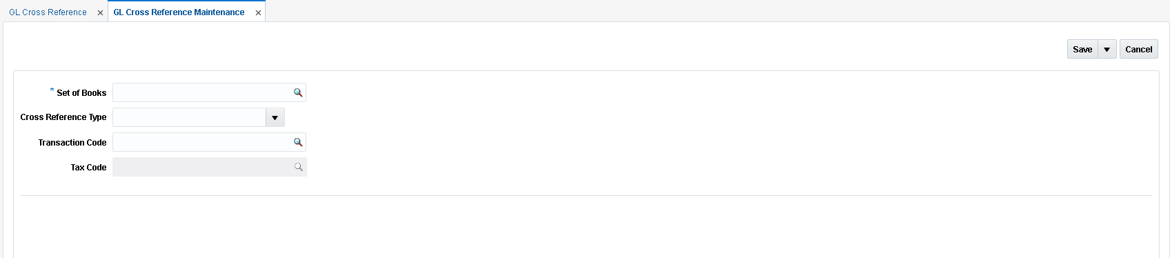

Create a General Ledger Cross Reference
From the Search Results pane of the GL Cross Reference window, select Create from the Action menu. The GL Cross Reference Maintenance window opens.
Figure 3-2 GL Cross Reference Maintenance Window
In the Set of Books ID field, enter the identifier that applies to this cross reference.
If there is only one Set of Books set up in RMS, this field is populated automatically.
In the Cross Reference Type field, select the account category. Valid values include:
Basic Transactions
Reason Code Actions
In the Transaction Code field, enter the transaction code for the new GL cross reference. Valid values for basic transactions include:
TAP – Trade Accounts Payable
TAX – Tax
UNR – Unmatched Receipt
VWT – Variance Within Tolerance
DWO – Discrepancy Write Off
RWO – Receipt Write Off
PPA – Pre-Paid Asset
DIRAR – Complex Deal Income Receivable
DIRAF – Fixed Deal Income Receivable
VCT – Variance Calc Tolerance
VCCT – Varance Calc Tax Tolerance
CRN – Credit Note
TAPNDI – Trade Accounts Payable Non-dynamic item
CRNNDI – Credit Note Non-dynamic item
TAXNDI – Tax Non-dynamic item
TAXRVC – Tax Reverse Charge
TAXRVO – Tax Reverse Offset
TAXACQ – Tax-Acquisition
TAXACO – Tax-Acquisition Offset
For non-merchandise cross reference type use the RMS non-merchandise codes as valid values.
For Reason Code Action cross reference type :
The Transaction Code can be sequentially assigned and disabled when in add mode. That is, the sequence number is incremented to assign the next available Transaction Code for Reason Code Actions.
This transaction code is then used on the 'Reason Code' Maintenance to assign specific accounting entries to a Reason Code. The structure allows for one Reason Code Action Transaction Code to be used by multiple Reason Codes, thereby reducing setup time.
In the Tax Code field, enter the tax code associated with the GL cross reference.
This field is disabled except when a transaction code of 'TAX', 'TAXNDI', 'TAXACQ', 'TAXACO', 'TAXRVC', or 'TAXRVO' is being created.
Click Save to save your changes. Alternatively, from the drop down menu, select Save and Close to save your changes and close the window or Save and Add Another to save your changes and add an additional GL cross reference.

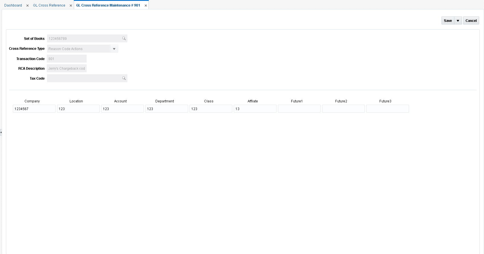

Maintain General Ledger Cross References
Perform a search for the GL cross reference you wish to edit. See Search for a General Ledger Cross Reference for additional information.
In the search results pane, select the GL cross reference you want to edit and select Edit from the Action menu. The GL Cross Reference Maintenance window opens.
Figure 3-3 GL Cross Reference Maintenance Window
From the GL Cross Reference Maintenance window, update the enabled fields as necessary.
