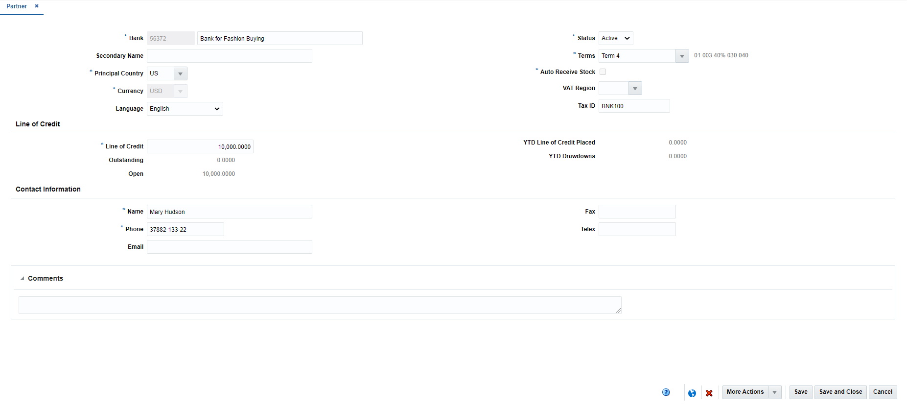

Figure 4-1 Partner Page
Header
The header section contains the following fields.
Table 4-1 Header - Fields and Description
Fields | Description |
Partner Type |
The Partner Type field is labeled according to the created partner, for example, Bank. The partner ID is generated automatically. Enter the name of the partner. This field is a required field. |
Secondary Name |
Enter a secondary name for the partner, if available. |
Principal Country |
Enter, select or search for the principal country code of the partner. This field is a required field. |
Currency |
Enter, select or search for the partner's currency code. This field is a required field. |
Status |
Select the status of the partner from the list. This field is a required field. |
Terms |
Enter, select or search for the payment terms. This field is a required field. |
Tax ID |
Enter the Tax Identification number to be associated with the partner. |
Language |
Select the partner's language from the list. |
Auto Receive Stock checkbox |
Select this checkbox to indicate that the system updates the stock for the external finisher when the 1st leg of the transfer is shipped. |
Line of Credit: |
Line of Credit |
Enter the credit limit. This field is a required field. |
Outstanding |
Contains the total amount of credit that the company has used or has charged against in the partner's currency. |
Open |
Displays the open credit amount. |
YTD Line of Credit Placed |
Contains the total amount of credit the company has used this year to this date in the partner's currency. |
YTD Drawdowns |
Contains the year to date payments the bank has made on behalf of the company in the partner's currency. |
Contact: |
Name |
Enter the name of the primary contact at the partner's site. This field is a required field. |
Phone |
Enter the phone number of the primary contact. This field is a required field. |
Email/Fax/Telex |
Enter additional contact information in the appropriate fields. |

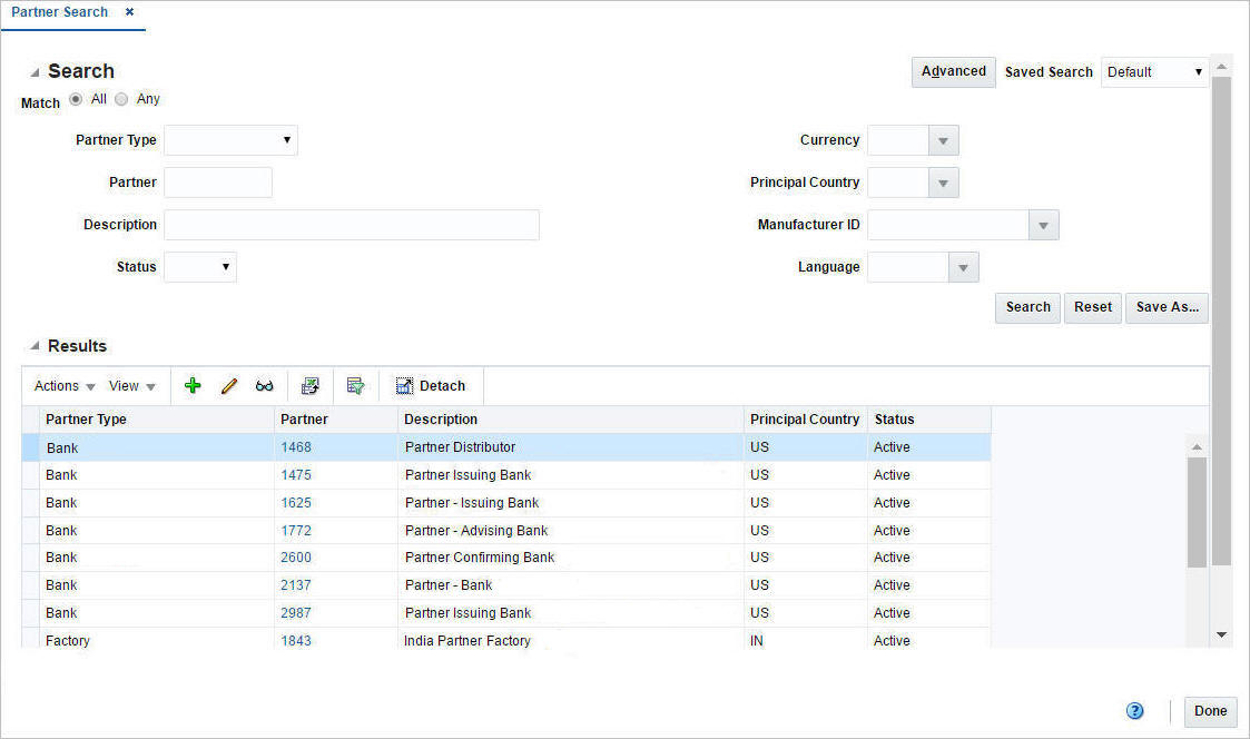

Figure 4-2 Partner Search Page
Searching for a Partner
To search for a partner:
From the Task menu, select Foundation Data > Suppliers and Partners > Manage Partners. The Partner Search page appears.
You can search for a partner by using basic or advanced search criteria, depending on the requirement. The basic mode is the default search mode.
Click Advanced to access the search section in advanced mode.
Click Basic to return to basic mode.
Searching for a Partner Through the Basic Search Criteria
To search for a partner by using basic search criteria:
Enter, select or search for one or all of the following basic search criteria.
Table 4-2 Partner Search - Basic Search Criteria and Description
Fields Description Match option
Check radio button All or Any.
All - only partners matching all entered search criteria are shown.
Any - partners matching any of the entered search criteria are shown.
Partner Type
Select the partner type from the list.
Partner
Enter, select or search for the partner ID.
Description
Enter, select or search for the partner description.
Status
Select the status of the supplier.
Currency
Enter, select or search for the currency.
Principal Country
Enter, select or search for the principal country.
Manufacturer ID
Enter, select or search for the manufacturer ID.
Language
Enter, select or search for the language.
Click the Saved Search list to select one of the saved search criteria. Selecting a saved search populates the search section with the saved search criteria. If the run automatically function is enabled for the search, the search is executed immediately.
You can also personalize your saved searches by selecting Personalize. The Personalized Saved Searches page appears.
For more information about the Personalized Saved Search, see Personalize Saved Search in the Oracle® Retail Merchandising Do the Basics User Guide.
Click Search. The partners that match the search criteria are displayed in the Results section.
Click Reset to clear the search section and results.
Click Save As... to save the current search criteria. The Create Saved Search page appears.
For more information about how to save your search criteria, see Create Saved Search in the Oracle® Retail Merchandising Do the Basics User Guide.
Click Done to close the page.
