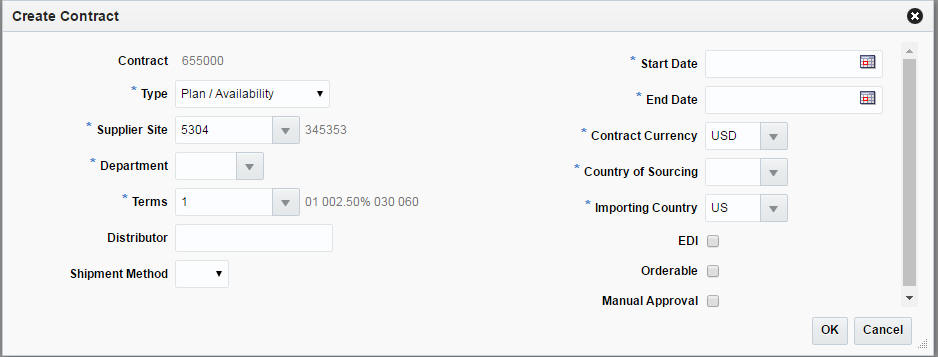

To create a contract follow the steps below:
From the Tasks menu, select Orders > Contracts > Create Contract. The Create Contract page appears.
You can also create a contract in the Contract Search page. For more information about how to create a contract in the Contract Search page, see the Manage Contracts chapter.
Figure 7-1 Create Contract Page
In the Contract field, the contract ID is filled in automatically.
In the Type field, select one of the following contract types:
Plan/Availability - refers to Type A contracts
Plan/No Availability - refers to Type B contracts
No Plan/No Availability - refers to Type C contracts
No Plan/Availability - refers to Type D contracts
When using a Type B (Plan/No Availability) contract, purchase orders are generated automatically. Manual and Replenishment orders are never created from a Type B contract.
In the Supplier Site field, enter, select or search for the supplier site. The fields such as Terms, Contract Currency and Importing Country are filled with default values based on the entered supplier site. You can change these values, if necessary. This is a required field.
A Type C contract (No Plan/No Availability) does not require a supplier to provide availability information; therefore, it is possible that an order can be placed that a supplier cannot fulfill.
In the Department field, enter, select or search for the department. Only items from this department can be placed on the contract. This field is a required field.
In the Terms field, enter, select or search for the contract terms, if you want to change the default value.
In the Distributor field, enter the distributor.
In the Shipment Method field, select the shipment method, for example, Air.
In the Start Date field, enter the contract start date or click the Calendar icon to specify the start date of the contract. This field is a required field.
In the End Date field, enter the contract end date or click the Calendar icon to specify the end date of the contract. This field is a required field.
In the Contract Currency field, enter, select or search for the currency of the contract, if you want to change the default value. This field is a required field.
In the Country of Sourcing field, enter, select or search for the country of sourcing for the contract. This field is a required field.
In the Importing Country field, enter, select or search for the importing country of the contract, if you want to change the default value. This field is a required field.
Check the EDI check box, to indicate that the contract is transmitted to the supplier via an EDI transaction.
Check the Orderable check box, to indicate that orders can be placed against this contract.
Check the Manual Approval check box, to indicate that all purchase orders will be created in Worksheet status and must be manually approved.
All required fields are marked with an asterisk. If you do not enter a value for one of the required fields, an error message is shown.
After you have entered all the necessary data for the contract, choose one of the following options.
Click OK, to create the contract. The Contract page appears in a new tab. For more information about the Contract page, see the Contract section.
Click Cancel, to reject all entries and close the Create Contract page.

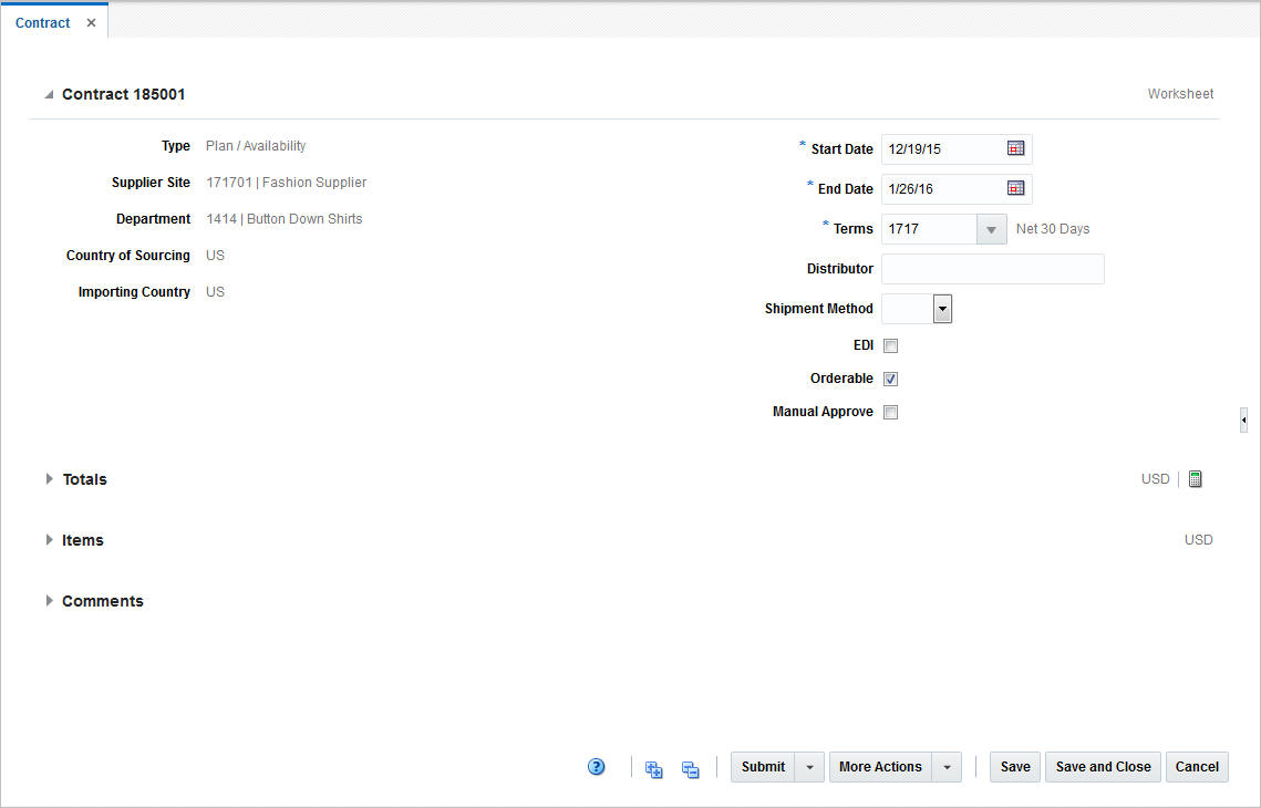

Contract
The Contract page allows you to create or maintain a contract. You can also add, edit and view the items, cost and distribution details on the contract. Moreover, you can navigate to the Parent/Diff summary screen, where you can view the details of the diffs for an item parent on a contract along with the quantity contracted, ordered, and received, as well as the ready date by diff value.
The Contract page consists of the following sections:
Figure 7-2 Contract Page
Contract Header
The Contract Header section contains the contract ID number and the status of the contract, for example Worksheet. Additionally the Contract Header section shows all values, entered in the Create Contract page. For more information about the values entered in the Create Contract page, see the start of the Create a Contract chapter.
Table 7-1 Contract Header - Fields and Description

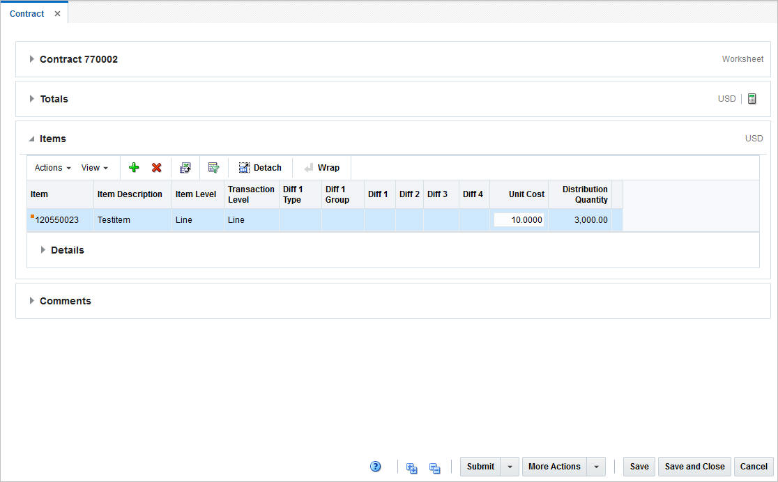

Items
The Items section contains the contract item, contract item description, item level, diffs and unit costs by default. You can add items to the contract in this section. For more details about how to add items to a contract, see the Add Items to a Contract section. Additionally, you can update the unit cost per item. For more information about how to update the unit cost for an item, see the Editing Unit Costs of Items on a Contract section.
Figure 7-4 Items Section

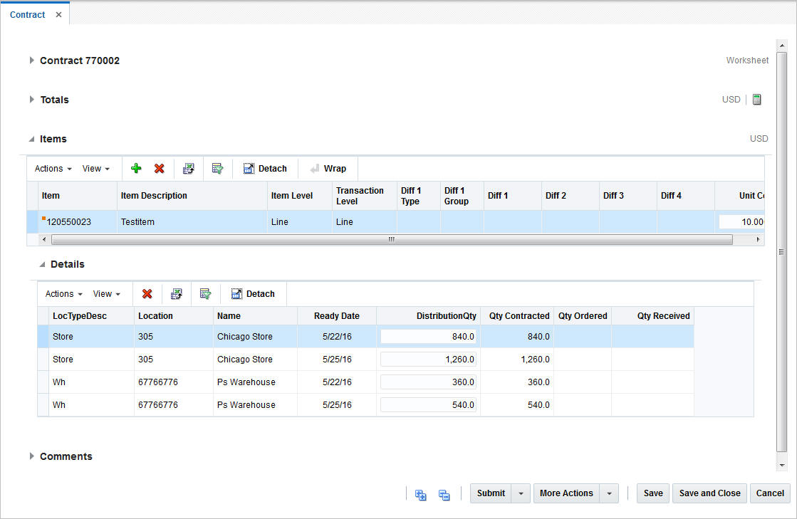

Details
The Details section displays the item distribution details by ready date and/or location. Columns shown are location type, location, name and ready date as well as the distribution, ordered and received quantity. The Details section is only displayed for Type A and B contracts, after items have been added and distributed.
You can edit the distribution quantity in this table. For more information about how to edit the distribution quantity, see the Manage Contracts chapter, section Editing the Distribution Quantity on a Contract section.
Figure 7-5 Items/Details Section

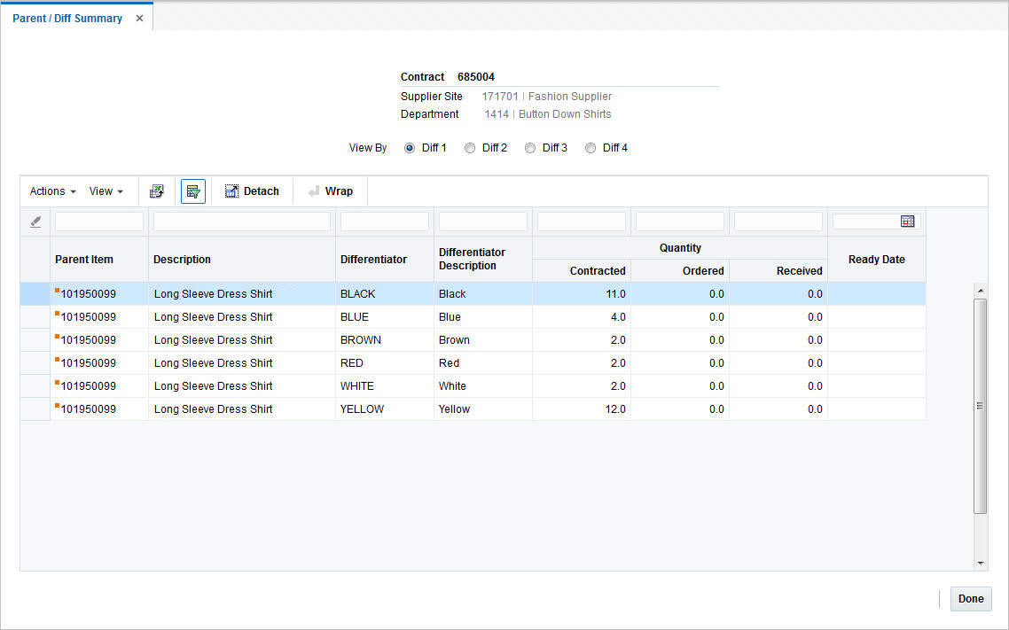

Parent Diff/Summary |
Opens the Parent Diff/Summary page. For more information about the parent diff/summary, see the Parent/Diff Summary section. |

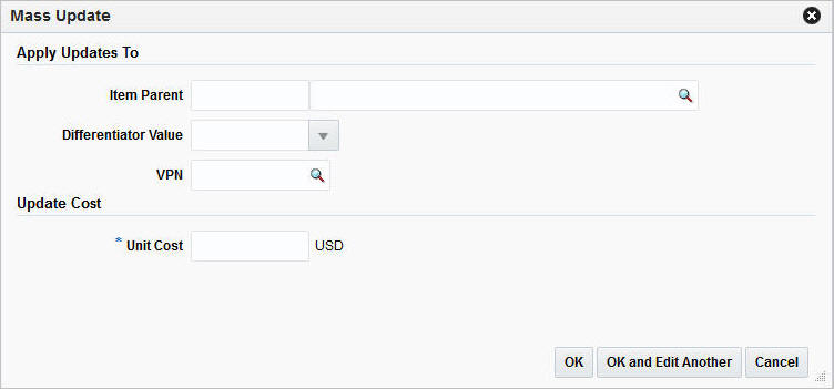

Mass Update Cost |
Opens the Mass Update page. For more information about how to update the costs for all items on a contract, see the Mass Update Cost section. |

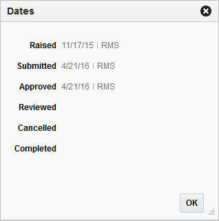

Dates |
Opens the Dates page. For more information on contract dates, see the Dates section. |

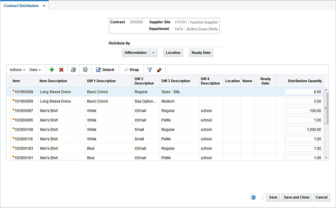

Figure 7-7 Contract Distribution Page

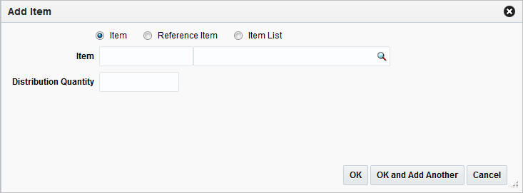

In the item table, select Actions > Add, or use the Add icon
to add an item, reference item or list item to the contract. The Add Item page appears.
Figure 7-8 Add Item Page
Select the item hierarchy level, you want to add item/items by. Items can be added at the transaction/item level, reference/item level or multiple items can be added by adding an existing item list.
In the Item/Reference Item/Item List field, select, enter or search for the item, reference item or item list.
In the Distribution Quantity field, enter the distribution quantity.
The Distribution Quantity field is only available for type A and B contracts. For type C and D contracts, the quantity is not required.
After you have entered all necessary data, choose one of the following options.
Click OK to add the item/items to the contract and exit the Add Item page. The system returns to the Contract Distribution page. The item/items is/are displayed in the item table.
Click OK and Add Another to add more items to the contract.
Click Cancel to reject all entries and close the page. The system returns to the Contract Distribution page.
When selecting items for a contract, the number of levels in the group and the transaction level of the item group must be considered. Items above the transaction level can only be added to a contract, if the Soft Contract Indicator is selected in the System Variables.
After you have added all items, choose one of the following options.
Distribute the added items. For more information on distributing items, see the Distributing Items of a Contract section.
Select Save and Close to save the entered records and close the Contract Distribution page.
Select Cancel to reject all entries and close the Contract Distribution page.
To distribute the items of a contract, see the Contract Distribution section.

In the Contract page, go to the Item section. Choose an item.
In the Unit Cost column, verify and/or edit the unit cost as necessary.
After you have entered the new unit cost for the item, choose one of the following options.

Mass Update Cost
You can update the unit costs for multiple or all items on a contract. You can apply the unit cost update by item parent, differentiator value or vendor product number (VPN).
To update the unit cost for all items on a contract follow the steps below.
From the Tasks menu, select Orders > Contracts > Manage Contracts. The Contract Search page appears.
Enter or select search criteria as desired to make the search more restrictive.
Click Search. The contracts that match the search criteria are displayed in the Results section.
In the Contract column, click the contract ID link, or mark a record and select Actions > Edit, or use the Edit icon
. The Contract page appears.
In the Toolbar, select More Actions > Mass Update Cost.
The Mass Update page appears.
Figure 7-9 Mass Update Page
If you want to apply the update to the item parent, you can choose the differentiator value or VPN.
Update by Item Parent: In the Item Parent field, enter or search for the corresponding item parent.
Update by Differentiator Value: In the Differentiator Value field, enter, select or search for the corresponding diff value, such as Small.
Update by VPN: In the VPN field, enter or search for the corresponding VPN.
In the Unit Cost field, enter the new unit cost.
After you have entered the necessary information:
Click OK to apply the mass update by the selected value and exit the Mass Update page. The system returns to the Contract page.
Click OK and Edit Another to apply another unit cost mass update.
Click Cancel to reject all entries and exit the Mass Update page.
The Contract Distribution page allows you to add or delete items on a contract and distribute those items. Items can be distributed by item parent or diffs. Additionally for Type A contracts you can distribute the items by ready date or location. For more information about distribution items of Type A contracts, see the Distributing Items of a Contract section. For Type B contracts the items can be distributed by location and by ready date. For more information about how to distribute items of Type B contracts, see the Distributing Items by Location and Distributing Items by Ready Date sections.
The Contract Distribution page consists of the following sections:
Figure 7-10 Contract Distribution Page
Contract Distribution Header
The header section of the Contract Distribution page displays the following information:
Contract ID
Supplier Site
Department
Distribute By
The Distribute By section contains options by which you can distribute the items of the contract.
Table 7-4 Distribute By Options
Buttons | Description |
Differentiator |
Opens list with Diff options 1 - 4. |
Location |
Opens the Distribute By Location page. You can distribute the item by location. For more information about this distribution method, see the Distributing Items by Location section. Only available for Type B contracts. |
Ready Date |
Opens the Distribute By Ready Date page. You can distribute the item by ready date. For more information about this distribution method, see the Distributing Items by Ready Date section. Only available for Type A and B contracts. |
Item Table
The Item table contains the contract items. By default the table displays the contract item, item description, diff 1-4 description, location, location name and ready date as well as distribution quantity.

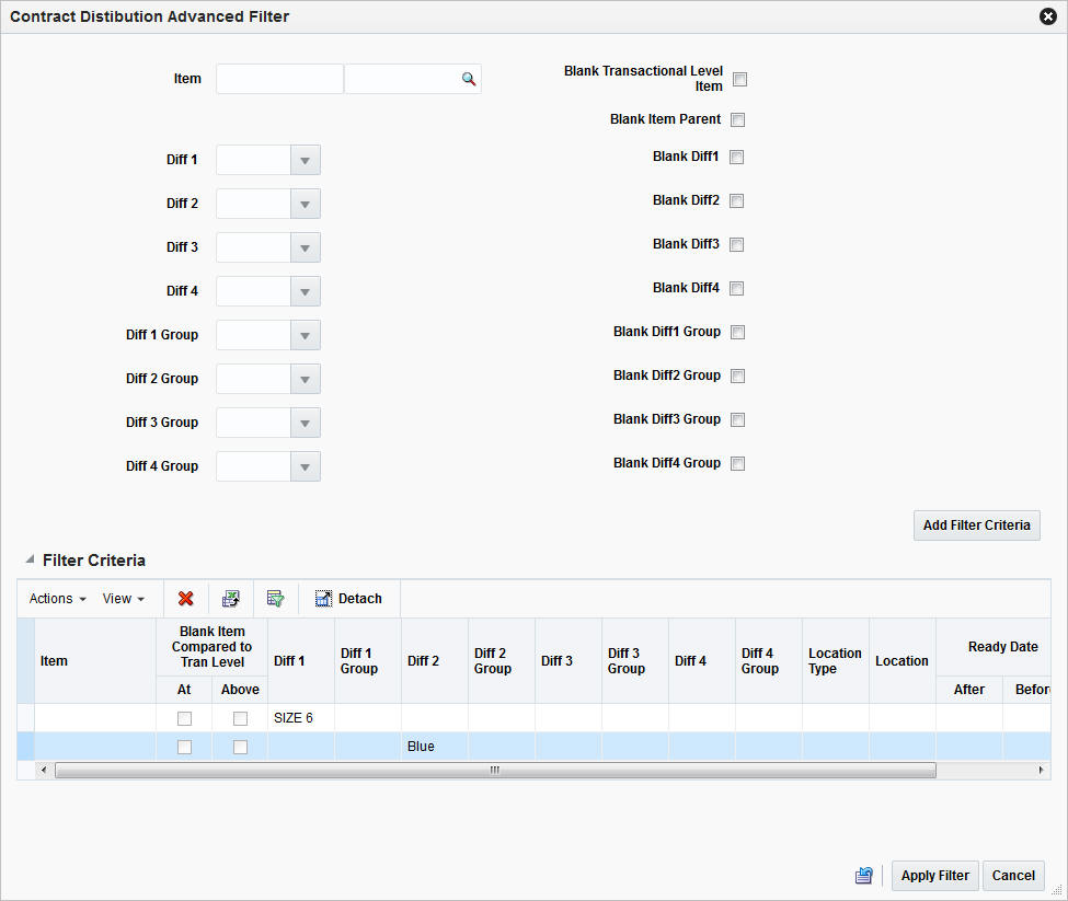

Contract Distribution Advanced Filter
The Contract Distribution Filter page allows you to filter the items that appear on the Contract Distribution page. You can then edit or distribute the resulting subset of items.
The Contract Distribution Advanced Filter page consists of the following sections.
Add Filter Criteria
Filter Criteria table
Toolbar
Figure 7-11 Contract Distribution Advanced Filter Page
Filter Items
To filter the items on a contract follow the steps below.
. The Contract page opens.
In the Toolbar select More Actions > Distribute. The Contract Distribution page appears.
To filter the items shown in the item table, click the Apply Filter icon
. The Contract Distribution Advanced Filter page appears.
Enter, select or search for the criteria by which you want to filter the item table.
Select Add Filter Criteria. The filtered criteria is added to the Filter Criteria table.
To delete a criterion from the Filter Criteria table, follow the steps below.
Select the record.
Select Actions > Delete or use the Delete icon
. You are prompted to delete the record.
Confirm with Yes. The record is removed from the Filter Criteria table.
After you have added all filter criteria, choose one of the following options.
Click Apply Filter, to display the results of the filter in the Order Distribution page and close the Contract Distribution Advanced Filter page.
Click Cancel, to reject the filter criteria and close the Contract Distribution Advanced Filter page.
Click the Reset icon
, to reject the filter criteria and stay in the Contract Distribution Advanced Filter page.

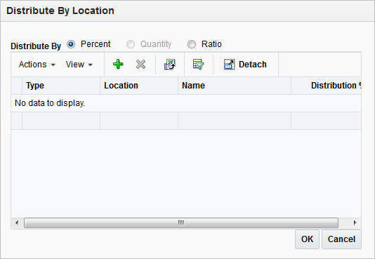

In the Distribute By section, click the Location button. The Distribute by Location page appears.
Figure 7-12 Distribute By Location Page
In the Distribute By section, select the method of distribution, such as percent, quantity or ratio.
You can distribute by quantity only, if you did not enter a quantity in the Contract Distribution page.
Select Actions > Add, or use the Add icon
to add locations for distribution. The Add Locations page appears.
Figure 7-13 Add Locations Page
In the Location Type field, select the type of location, for example, Store or Warehouse.
In the Location field, enter, select or search for the location.
After you have selected the location, choose one of the following options.
Click OK to add the current location and close the Add Locations page. The system returns to the Distribute by Location page. The location is shown in the table.
To delete a location from the table in the Distribute By Location page, mark the location. Then select Actions > Delete, or use the Delete icon
to delete the location.
Click OK and Add Another to add additional locations.
Click Cancel to reject all entries and close the Add Locations page. The system returns to the Distribute by Location page.
In the Distribute by Location page, enter the distribution percentage, quantity or ratio, depending on your distribution method. If you select the following distribution method:
Percent: Enter the percentage of the items you want at each location.
Quantity: Enter the number of items you want at each location, or the total items you want at each location.
You can distribute by quantity only if you did not enter a quantity in the Contract Distribution page.
Ratio: Enter the proportion of items that you want at each location.
You can distribute to a location and enter a quantity distribution or ratio of zero (0).
Choose one of the following options.
Click OK to save your changes and close the Distribute by Location page. The system returns to the Contract Distribution page. The item table displays the item by location and the corresponding distribution quantity.
Click Cancel to reject your entries and close the Distribute by Location page. The system returns to the Order Distribution page.

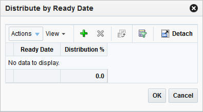

To distribute the items by ready date, follow the steps below.
From the Contract page select More Actions > Distribute. The Contract Distribution page appears. Go to the item table.
In the item table, select a record.
In the Distribute By section, click the Ready Date button. The Distribute by Ready Date page appears.
Figure 7-14 Distribute by Ready Date Page

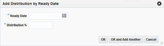

Click Actions > Add or use the Add icon
to add a ready date. The Add Distribution by Ready Date page appears.
Figure 7-15 Add Distribution by Ready Date Page
In the Ready Date field enter or use the Calendar icon to select a ready date.
In the Distribution % field, enter the percentage of the goods that are due by the ready date.
Then choose one of the following options.
Click OK to add the ready date and close the Add Distribution by Ready Date page. The entered ready date and distribution percentage are shown in the table of the Distribute by Ready Date Page.
Click OK to distribute the item. The system returns to the Contract Distribution page. The item table shows the item including the ready date and the corresponding distribution quantity.
Click Cancel to reject all entered records and close the Ready Date Page.
Click OK and Add Another to add additional ready dates for the selected item.
Click Cancel to reject all entered records and close the Add Distribution by Ready Date page.

Viewing a Parent/Diff Summary
To view the parent/diff summary of a contract follow the steps below.
In the Contract column, click the contract number link, or mark a record and select Actions > Edit, or use the Edit icon
In the Toolbar select the More Action > Parent/Diff Summary. The Parent Diff/Summary page appears.
The page displays the contract ID, the supplier site and the department in the Header section.
In the View By section select the differentiator 1, 2, 3 or 4.
Diff 1 is selected by default. If you selected Diff 2, the content of the summary table is refreshed to display details corresponding to differentiator 2.
The items are displayed in the Parent/Diff Summary table in the lower section of the page. The table contains the following information.
Parent Item
Description
Differentiator
Differentiator Description
Contracted, ordered and received Quantity
Ready Date
Use the header row of the Parent/Diff Summary table to further narrow down the displayed records. Enter a value in the corresponding column. To clear the filter, click the Clear All icon
To exit the Parent Diff /Summary page press Done.
Dates
The Dates page displays the following dates:
Raised - shows the date, the contract was issued
Submitted - shows the date, the contract was submitted
Approved - shows the date, the contract was approved
Reviewed- shows the date, the contract was reviewed
Cancelled - shows the date, the contract was cancelled.
To view the contract dates, follow the steps below:
In the Toolbar select More Actions > Dates, the Dates page appears.
Figure 7-17 Dates Page
View the displayed contract dates.
Click OK to close the page.
