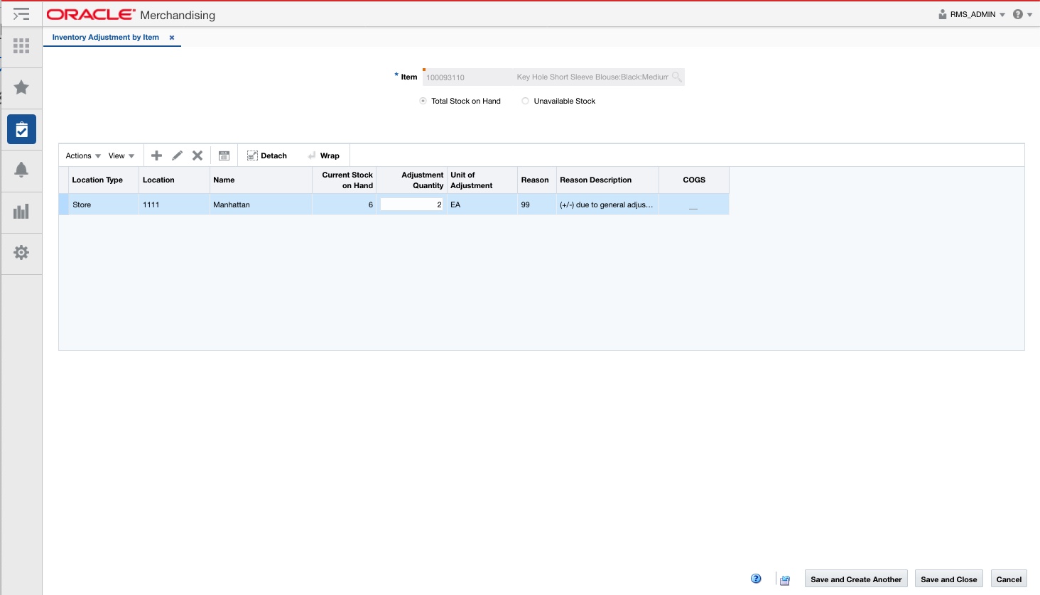

Create an Inventory Adjustment by Item
In the The Inventory Adjustment by Item page you can manually adjust the inventory of an item at one or more locations.
Adjusting Inventory by Item
To adjust inventory by item:
From the Tasks menu, select Inventory > Inventory Adjustments > By Item. The Inventory Adjustment by Item page appears.
Figure 7-1 Inventory Adjustment by Item Page
In the Item field, enter the item number or search for the item.
Select one of the following options:
Total Stock on Hand
Unavailable Stock
If you select Unavailable Stock, the Inventory Status field enables.
In the Inventory Status field, select an inventory status from the list.
The table lists the locations impacted and the quantity adjusted at each location. You can add, edit or delete inventory adjustments in this table.
You can edit the Adjustment Quantity and the Reason column directly in the table.

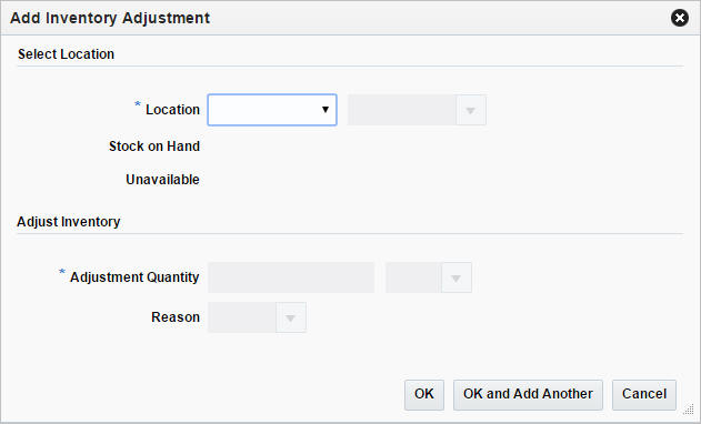

Figure 7-2 Add Inventory Adjustment
In the Location field, select the location type from the list. Then enter, select or search for the location. This field is a required field.
The Stock on Hand and Unavailable quantity are displayed. The Unavailable quantity only displays, if you select Unavailable stock in the header.
In the Adjustment Quantity field, enter the quantity you want to adjust. This field is a required field.
The unit of adjustment defaults to the standard unit of measure for the item. Change the value, if necessary.
Adjustments for pack items can only be made at warehouses.
If you are adjusting the total stock on hand, the reason code is required for the adjustment. The reason indicates why the total stock on hand is being adjusted.
Then choose one of the following options.
Click OK to add the inventory adjustment to the table and close the pop-up.
Click OK and Add Another to add additional inventory adjustments.
Click Cancel to reject all entries and close the pop-up.

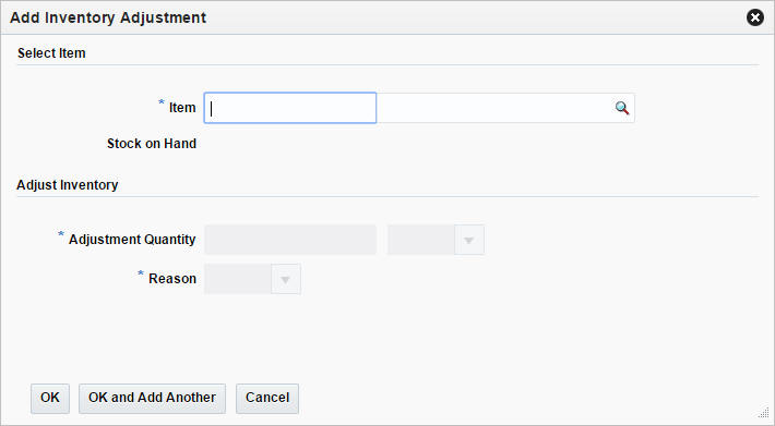

Adding Items and Adjustment Quantities
To add an inventory adjustment, follow the steps below.
In the table select Actions > Add, or use the Add icon. The Add Inventory Adjustment page appears.
Figure 7-4 Add Inventory Adjustment
In the Item field, enter or search for the item. This field is a required field.

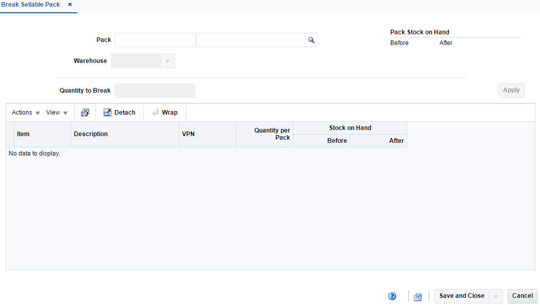

Break Sellable Pack
The Break Sellable Pack page allows you to break orderable packs down to their component items or inner pack levels. The inventory of packs and component items is adjusted accordingly. The number of packs is decremented and the number of inner packs or items is incremented. Pack items are inventoried at the warehouse level.
From the Tasks menu, select Inventory > Inventory Adjustments > Break Sellable Pack. The Break Sellable Pack page appears.
Figure 7-5 Break Sellable Pack Page
In the Pack field, enter the number of the pack item or select or search the pack.
In the Warehouse field, enter select or search for the warehouse.
The items that make up the pack appear in the table below. In addition the Pack Stock on Hand Before quantity, and Item Stock on Hand Before quantity is populated so you can view the quantities before making any adjustments. The After field in the Pack Stock section displays the value of stock on hand after the pack is broken down
If the selected pack contains an inner pack, the Break To radio buttons display, allowing you to select between breaking the pack into individual items or inner packs.
In the Quantity to Break field, enter the number of packs that you want to break down to the component level. This number must be less than the number displayed in the Stock on Hand: Before field.
Click Apply. The number of packs is decremented. The number of component items is incremented. The system displays the updated Stock on Hand values for the Pack and Item(s) in the After fields.

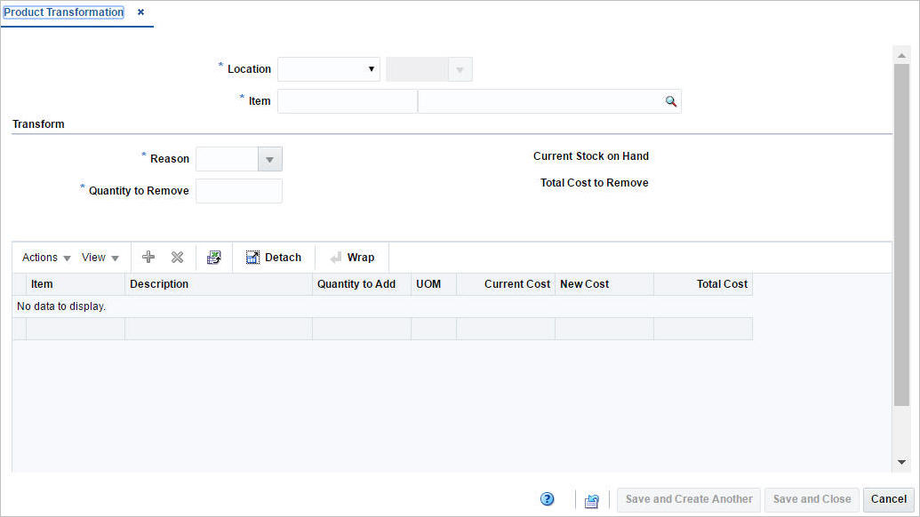

Product Transformation
The Product Transformation page allows you to manually adjust the inventory of a transformed item and the items derived from the transformed item.
For example, a grocer might buy and place into inventory a side of beef. The butcher may prepare steaks and ground beef from the side of beef. In this example, the grocer reduces inventory by one side of beef and increases inventory by the number of steaks and packages of ground beef. In addition to adjusting the quantities, you can adjust the cost of the items derived from the transformed item. The overall cost of the transaction, however, must remain the same.
Both the quantities and values of the stock on hand are adjusted in the stock ledger.
Inventory adjustments may also be initiated by an external system, such as a warehouse management system.
To access the Product Transformation page:
From the Tasks menu, select Inventory > Inventory Adjustments > Product Transformation. The Product Transformation page appears.
Figure 7-6 Product Transformation Page
In the Item field, enter the item number to be transformed or search for the item. This field is a required field.
In the Reason field of the Transform section, enter, select or search for the ID of the reason code for the adjustment.
In the Quantity to Remove field of the Transform section, enter the number of units subtracted from stock on hand. This field is a required field.
When the item is selected, the Current Stock on Hand field is populated to view the stock on hand quantity for the selected item before making any adjustments.
The Total Cost to Remove field is auto populated with the value based on the quantity to remove.
Add Items for the Product Transformation
In the table you must add the items that you will create from the transformed item.
Once added, the items and their attributes appear in the table. The Total Cost in the Summary Row will be updated. The Total Cost to Remove must equal the Total Cost to Add before an adjustment can be made. Therefore, you can adjust the Quantity to Add and the New Cost columns directly in the table.
To add items you want to create from the transformed item, follow the steps.
From the Actions menu after entering the required details, click Add or click the Add icon. The Add Item page appears.
In the Item field, enter, select or search for the item you want to create. This field is a required field.
In the Quantity to Add field, enter the quantity for the item. This field is a required field.
In the New Cost field displays the current costs of the item. Edit the costs, if necessary. This field is a required field.
Click OK to create the item and add it to the table and close the pop-up.
Click OK and Add Another to create additional items.
