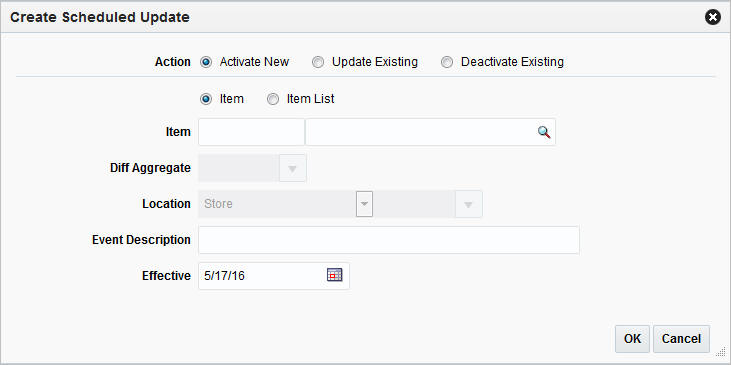

Create a Scheduled Update
The Create Scheduled Update window allows you to create a new scheduled replenishment and scheduled event to activate a new replenishment attribute, or to update, or deactivate an existing attribute.
To create a scheduled update, follow the steps below.
From the Tasks menu, select Replenishment > Create Scheduled Update. The Create Scheduled Update window appears.
Figure 4-1 Create Scheduled Update Window
In the Action section, select if you want to activate a new, update or deactivate an existing replenishment attribute.
Select, if the scheduled update is to be created by using item or item list.
In the Item/Item List field, enter, select or search for the item/item list.
In the Diff Aggregate field, enter, select or search for the differentiator associated with the selected item.
In the Location field, select the location type from the list. Then, enter, select or search for the location.
In the Event Description field, enter a description.
In the Effective field, enter the date the update takes place or use the Calendar icon to select an effective date.
Then choose one of the following options.
Click OK to create the scheduled update.
If you select the action Activate New or Update Existing, the Replenishment Attribute window appears, allowing you to enter additional information.
Click Cancel to reject all entries and close the window.

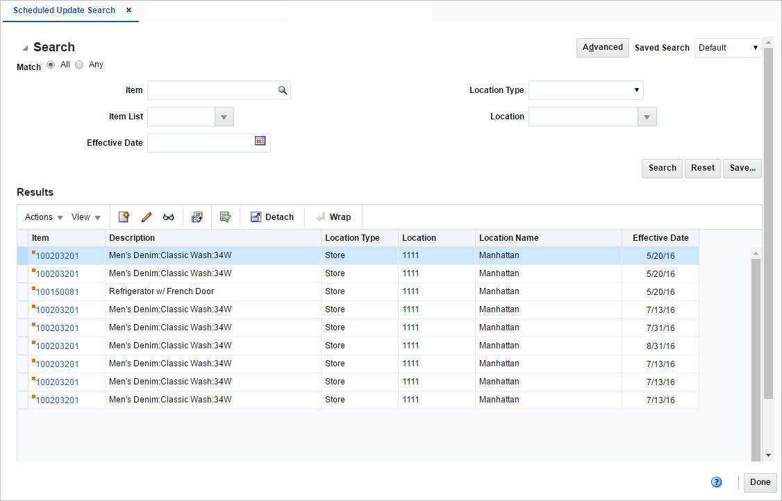

The Manage Scheduled Update option opens the Scheduled Update Search window. This window allows you to search for scheduled replenishment changes and view the results of the search.
The Scheduled Update Search window contains the following sections:
Search
For more information about how to search for a scheduled update, see the Searching for a Scheduled Update section.
Figure 4-2 Scheduled Update Search Window
To search for a scheduled update:
From the Task menu, select Replenishment > Manage Scheduled Update. The Scheduled Update Search window appears.
You can search for a scheduled update using basic or advanced search criteria, depending on the requirement. The basic mode is the default search mode.
Click Advanced to access the search section in advanced mode.
Click Basic to return to the basic mode.
Searching for a Scheduled Update Through the Basic Search Criteria
To search for a scheduled update using basic search criteria
