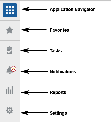

Task Bar Options
You can quickly access the tasks for Merchandising and switch to other Merchandising Suite solutions from the Navigation bar.
Figure 2-1 Sidebar Menu
The following navigation bar options are common across all the Merchandising Suite solutions:
Application Navigator
Favorites
Tasks
Notifications
Reports
Settings
Your view may vary, depending upon the features selected during the setup process.

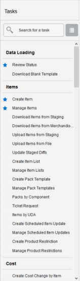

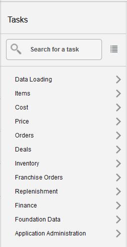

Tasks
A task is a link to a task flow to accomplish a business process or procedure. For example, a task may be creating a purchase order or editing a previously created item.
Your Tasks list appears in the Task Bar. You can either click on the specific task name to open, or use the Task Search component to search for a Task that you want to open.
Your task menu may appear slightly different, depending on which tasks you have privilege to access. By default the tasks are organized into folders in the Grouped View, clicking the List View button toggles to a fully expanded list of all the tasks which allows you to scroll more quickly to the desired task.
When the Merchandising end of day batch jobs are running, the online task flow screens are unavailable. Prior to the batch jobs starting, users are warned to save their work and exit. After a period of approximately five minutes, the batch run starts and users are logged out of the online application. They are not able to access any tasks in the applications until the batch schedule has completed.
Figure 2-4 Tasks Menu – Grouped View
Figure 2-5 Tasks Menu – List View

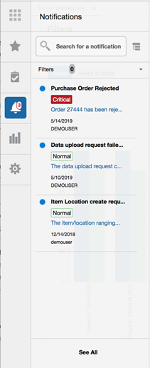

Notifications
The Notifications functionality is a component built into Merchandising to support raising events to a user's attention. For example, this could be used to alert you to the completion of a background process or the rejection of a transaction you submitted for approval.
If a notification has been raised, you will see the number on the notification icon on the task bar go up, similar to receiving a new email.
Clicking on this icon will show you a quick view of your most recent unread notifications, including a short description of what triggered the notification, its severity, when it was raised, and the user ID indicating whose action triggered it be raised. There will also be a hyperlink available for the notification. Clicking on this hyperlink will take you to the page where you can take action or view the details related to that specific notification. For example, if you are being notified that a purchase order that you submitted for approval was rejected, clicking on the hyperlink would take you to the purchase order so that you can review the comments from the approver and make the appropriate adjustments.
The following notifications are included in Merchandising:

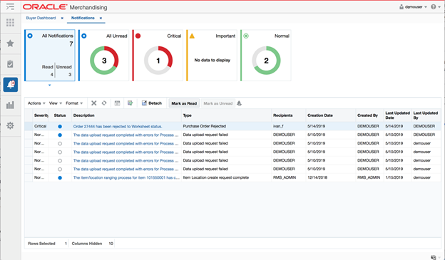

Managing Notifications
Clicking the See All option at the bottom of the notification pane will take you to a page where you can manage all your notifications, including those you previously reviewed. The actions that can be taken in this page include marking notifications read or unread, deleting old notifications, and reassigning notifications to another user. You can also use the hyperlinked description in this screen to access the page where action can be taken based on this notification.

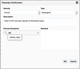

Reassign a Notification
To re-assign a notification, highlight the appropriate notification and select Reassign Notification from the Actions menu. This will display the Reassign Notification popup. Choose one or more recipients that should receive the re-assigned notification and then click OK when all have been added. As part of the reassignment, you can also change the severity of the notification that will be sent to the recipients and the type and description that will be shown to the new recipients.

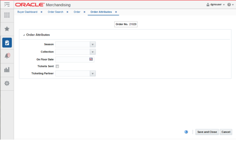

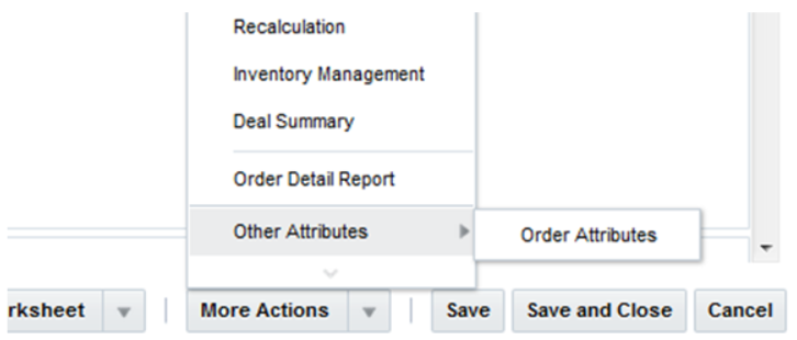

Other Attributes
In some pages, under the More Actions menu, there may be an additional menu option titled "Other Attributes". This indicates that custom flex attributes have been enabled for that functional area, such as the example below in the Order page. The sub-menus that are available under the Other Attributes option will vary by functional area, as configured for your business. Depending on how these attributes have been configured, they may be required to be entered in order to save or approve the entity where they exist.
Figure 2-8 Other Attributes Menu
When one of these sub-menu options are selected, a page will open, titled Other Attributes, which will show one or more groupings of attributes associated with the entity, as defined for your business. Below is an example of what the Other Attributes page might look like for attributes associated with a Purchase Order.
Figure 2-9 Other Attributes Page

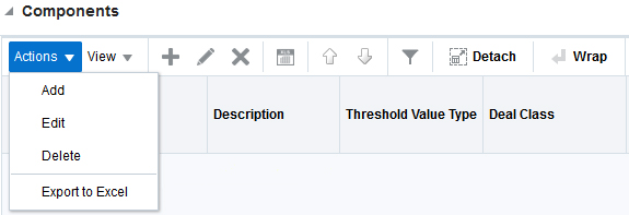

At the table level, there are two menus - Action and View - and several icons used for quick actions on the table. For more information on these options, see the sections Action Menu and Icons and View Menu.
The Actions menu provides the option to take different actions related to entries in the table. Depending on the nature of the table, these actions can be add, view, delete or edit table rows, or export the table contents to the spreadsheet.
The actions and icons described here are those used commonly throughout the solution. Some pages may provide additional options, based on the functionality of the page. The details on those more unique options can be found in the documentation for that particular page.
Figure 2-10 Actions Menu and Icons
Table 2-2 Actions Menu/Icons and Descriptions of Components Section
| Actions Menu/Icon | Description |
Add and Add icon |
You can add a record to the table by clicking Add from the Actions menu or by clicking the Add icon |
Create and Create icon |
You can create a record in the table by clicking Create from the Actions menu or by clicking the Create icon |
Create from Existing icon |
You can create from an existing record by
clicking Create from Existing from the Actions menu or by clicking
the Create from Existing icon |
Edit and Edit icon |
You can edit a record in the table by clicking Edit from the Actions menu or by clicking the Edit icon |
Delete and Delete icon |
You can delete a record in the table, by
clicking Delete from the Actions menu or by clicking the Delete
icon |
Export to Excel icon |
You can copy the contents of the table to
a Microsoft Excel spreadsheet by clicking the Export to Excel option
from the Actions menu or by clicking the Export to Excel icon |
Move Up and Down icon |
You can move the selected row up or down
in the table by clicking the Move Up and Down icons |
Wrap icon |
You can wrap the values in the table column
by using the Wrap icon |

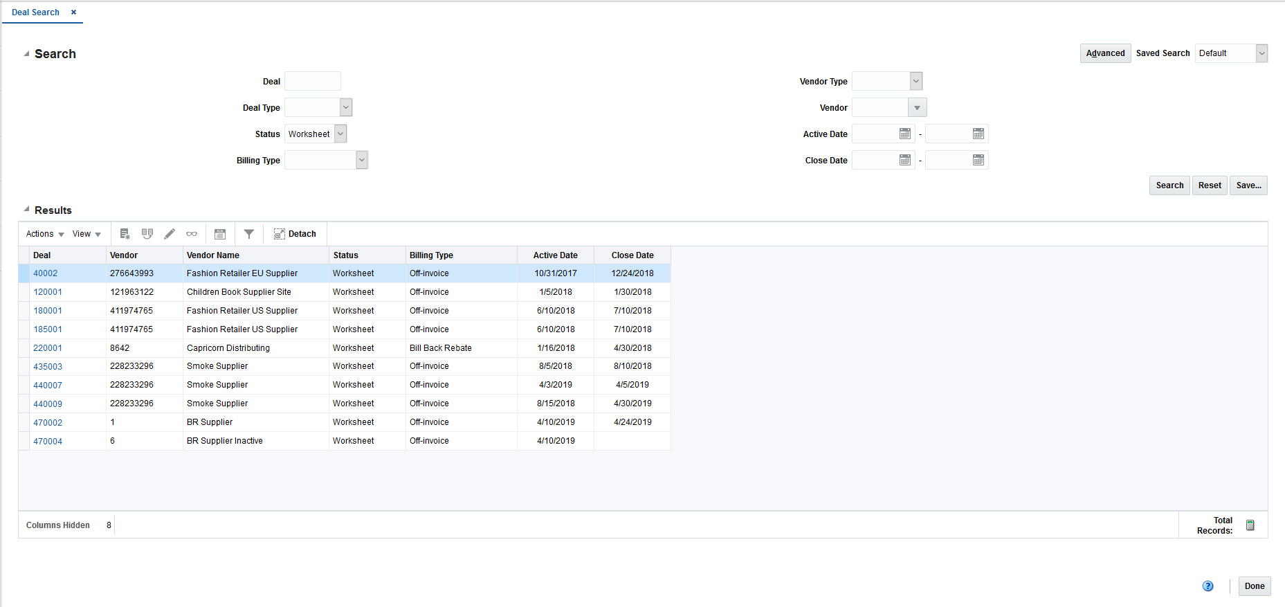

Search Screens
You can search for a particular entity by entering or selecting criteria using the search screens. Searches can be done using basic criteria, or can be done in advanced mode, which allows additional criteria to be added, as well as the use of operators (e.g. greater than, less than) in searches. Searches are generally accessed for most entities under the "Manage" actions in the task list.
Search Using Basic Criteria
The default view when you open a search page will be for a basic search. The criteria available will differ slightly depending on the entity you are searching in.
Enter or select one or all of the following basic search criteria.
Figure 2-12 Search Section in Basic Search Mode
Click Search. The entities that match the search criteria are displayed in the Results section.
Figure 2-13 Search Results

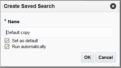

If there is no saved search selected in the dropdown, Reset clears the Search section, or resets to a saved search, if applicable.

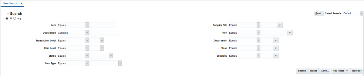

Search Using Advanced Criteria
The Advanced Search feature allows you to add new criteria that are not part of basic search, define operators to use in the search, or add multiples of a specific criterion. For example, if searching for an item, using advanced criteria allows you to search on items that are in worksheet or submitted status, by adding the status criterion a second time in the search. Perform the following procedure to define a search using the advanced search criteria:
From a Basic Search page, click the Advanced button in the upper right corner of the screen. This will change the label on the button to Basic, which will allow you to revert back to Basic mode, if needed.
From the Advanced Search page, you can define the variables around how each search is performed.
Figure 2-14 Advanced Search Page
The All or Any radio buttons allow you to define what items are returned in the search. Select All to return only those results that meet all the search criteria. Select Any to return those results that meet any of the search criteria.
The search field operators allow you to define how each field searches for results.
The options available for the operators will differ based on the type of attribute and in some cases may not be available.

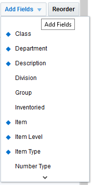

Many of the Advanced Search pages allow you to add additional fields from which to search. This is also the method by which a second instance of a particular criterion can be added. Alternately, some search pages will automatically display all additional criteria that can be used in advanced search.
From the Advanced Search page, click the Add Fields button.
Figure 2-15 Add Fields List
From the Add Fields list, click the field that you want to include.
Repeat these steps for each additional field you want to add. Only one additional field can be added at a time.

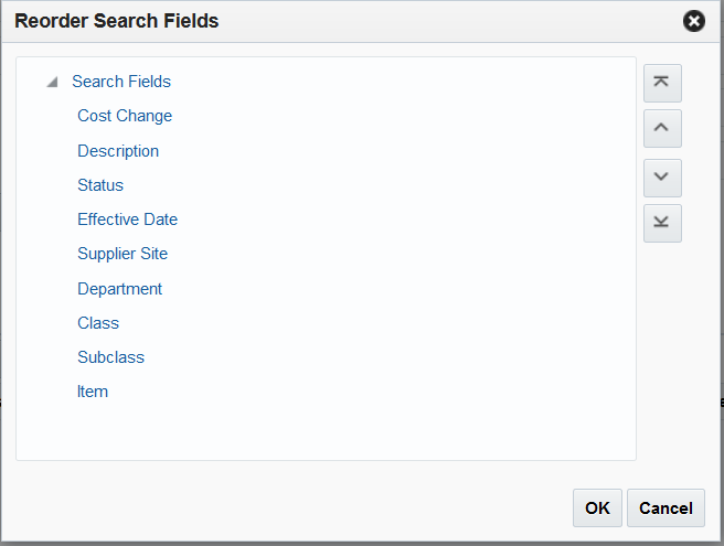

Use the Reorder button to customize the order in which the search criteria appear.
From the Advanced Search page, click the Reorder button. The Reorder Search Fields pop-up appears.
Figure 2-16 Reorder Search Fields Pop-up
Select the search criteria you want to reorder and use the arrow buttons to move the field up or down the list.
Click OK to save your changes and return to the Advanced Search page.
Figure 2-17 Search Results
From the Search Results, you can manipulate the data using the selections from the Actions menu or selecting one of the table level buttons.
Click Done to close the page.
Create a Saved Search
You can create a Saved Search by selecting the Save button in the Search Criteria panel after you have entered the criteria for your search. The Save button will call up the Create Saved Search pop-up where the search is given a name and the user determines whether it should be the default search, which indicates it should be the one displayed when the page is initially opened, as well as whether it should be run automatically.
To view the created saved search, first enter your desired criteria in either basic or advanced mode. Then, follow these steps:
Click the Save... button. The Create Saved Search pop-up appears.
Figure 2-18 Create Saved Search
Enter the name of the search.
You can also choose to save the combination of the search criteria by selecting the following check boxes:
Set as default
Run automatically
Click OK to save your search. Click Cancel to close the pop-up without saving.
