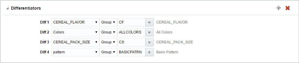

Diffs
A differentiator (diff) is a characteristic that can be used to make items distinct from one another. You can add levels to an item group if you identify a set of diffs or diff groups. Each unique diff or combination of diffs creates a new level in the item group. If you choose not to use diffs, you can manually create item levels.
Once you have selected the diffs, you can create all of the items for that item level, through Merchandising.

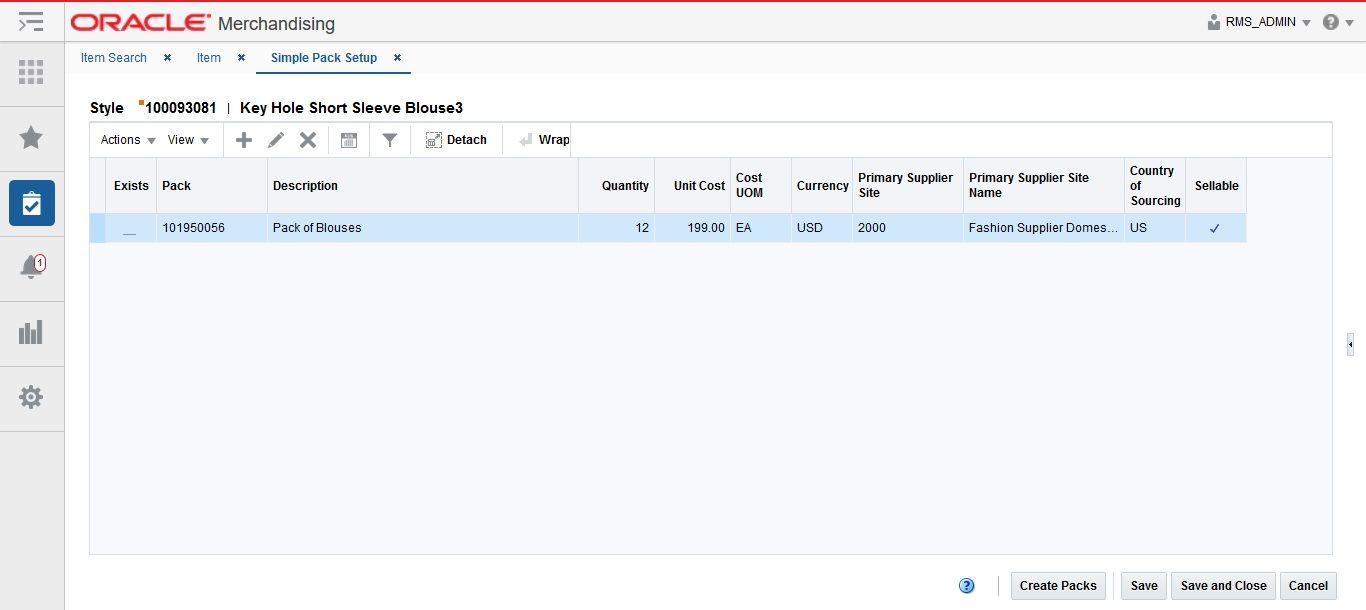

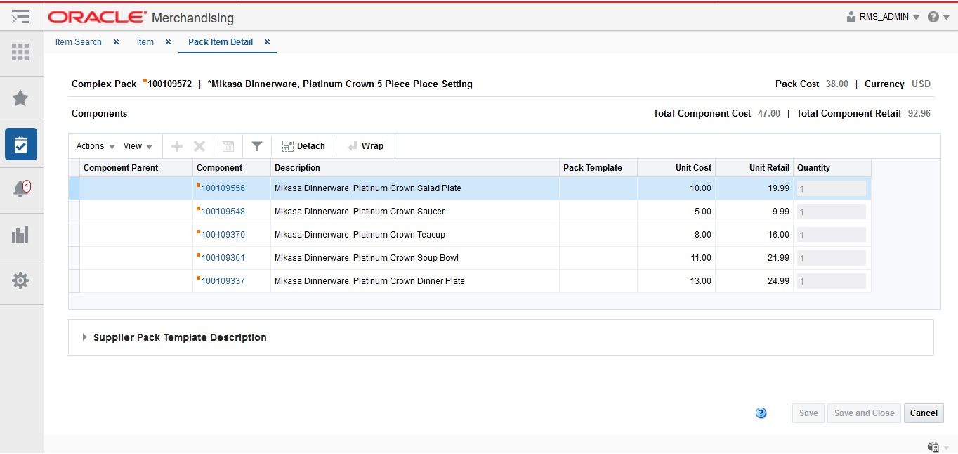

Packs
A pack is a way of tracking multiple items under one item number. The Pack Item Overview contains additional information on simple and complex packs.

Deposit items can be maintained as a complex pack or a single item. Maintaining the deposit items as a complex pack ensures the appropriate components are grouped together and facilitates ordering. If you maintain the deposit items individually, you must associate the item with the appropriate container item.

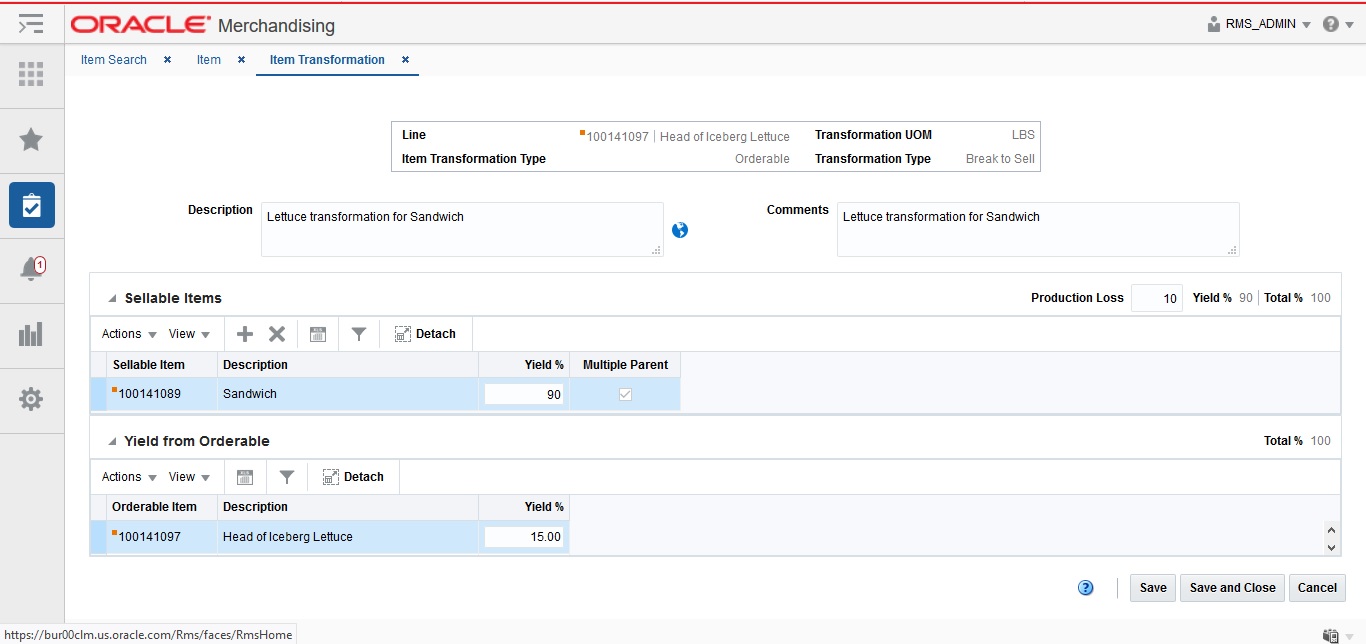

Transformable Items
A transformable item is an item that can be ordered as one item and broken into smaller items. The smaller items can then be resold in the store. There are two types of transformable items:
Transformed Orderable: The item is ordered from the supplier in one form, but changed by the retailer and sold to the customer in a different form.
Transformed Sellable: The item that is sold to the customer. A transformed sellable item is different from the item ordered from the supplier, it is then broken or modified before selling.

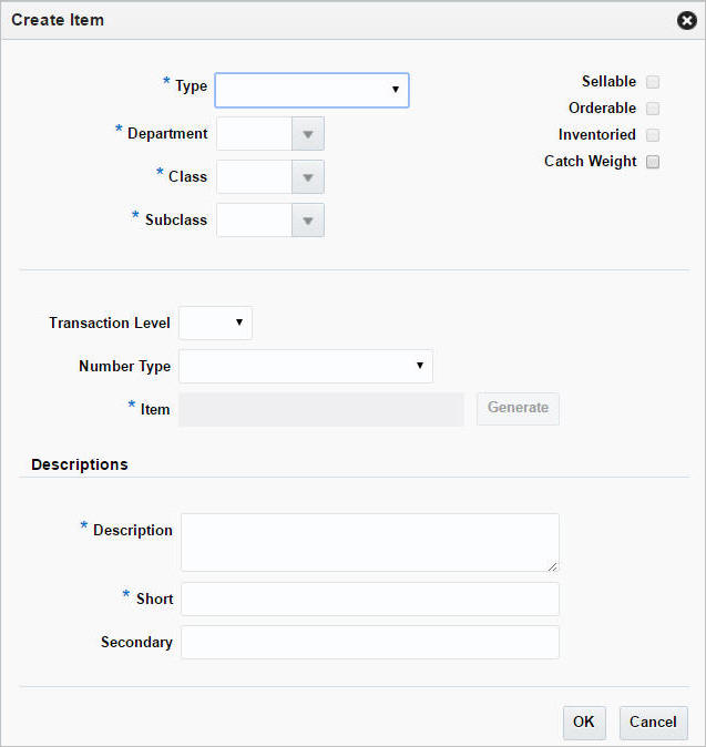

Create an Item
To create an item:
From the Tasks menu, select Items > Create Item. The Create Item page appears.
Figure 1-1 Create Item Page
In the Type field, select the following type of items you can create:
Regular Item
Simple Pack
Complex Pack
Deposit Contents
Deposit Container
Deposit Crate
Deposit Returned Item
In the Department field, enter the ID of the department for the new item, select the department, or search and select the department.
In the Class field, enter the ID of the class for the new item, select the class, or search and select the class. You must select a department before you can select a class.
In the Subclass field, enter the ID of the subclass for the new item, select the subclass, or search and select the subclass. You must select a department and class before you can select a subclass.
Select the item type indicators:
Sellable: Select this check box to indicate the item is sellable and will be sent to the selling systems (e.g. POS, OMS).
Orderable: Select this check box to indicate the item can be ordered, set up, set up on replenishment, and to set up HTS and expenses.
Inventoried: Select this check box to track inventory and to have stock on hold in Merchandising.
Catch Weight: The Catch Weight functionality allows items that may be purchased and sold in varying weights to be better managed within Merchandising. The Catch Weight items are weighed at the receiving location.
The indicators that you select for the Level 1 item will be applied to all items in the item group and cannot be changed.
In the Transactional Level field, select the transaction level for the item.
In the Item Number Type field, select the type of item number that you want to associate with the item.
The Item field is the unique number used to identify the product.

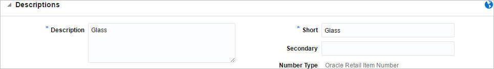

In the Descriptions area:
In the Description field, enter the description of the item.
In the Short field, populates with the item description.
In the Secondary field, enter alternate description of an item. This field can be used to enter the item description used by the supplier.
Then choose one of the following options.
Click OK. The Item page appears.
For more information about this page, see the Item Page section.
Click Cancel to reject all entries close the page.

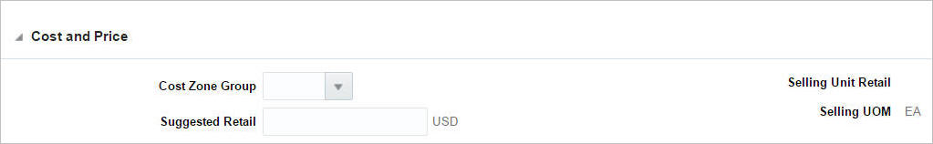

Add the cost zone group.
Go to the Cost and Price section. In the Cost Zone Group field, enter, select or search for the cost zone group.

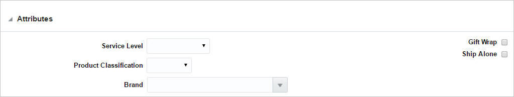

Add the attributes for the item.
In the Attributes section, enter, select or search for the attributes as necessary. For more information about attributes, see the Attributes section.

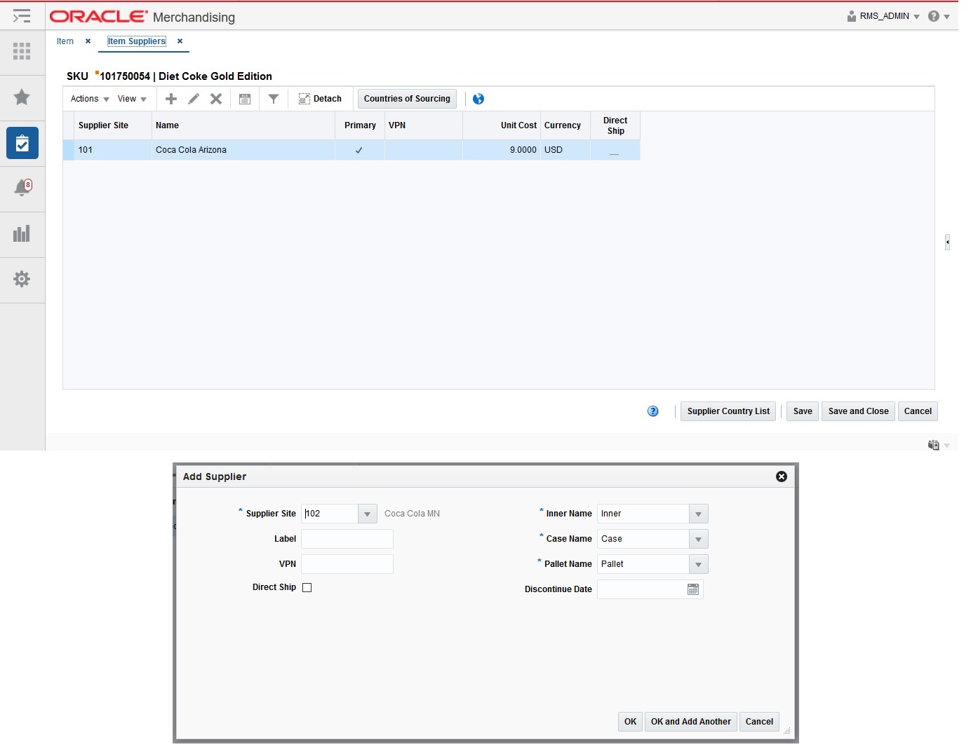

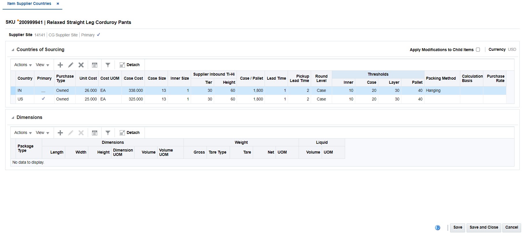

Add a supplier and a sourcing country for the item.
Select More Actions > Suppliers. The Item Supplier page appears. For more information about this page, see the Add Suppliers section.
Add a supplier by selecting Actions > Add, or using the Add icon

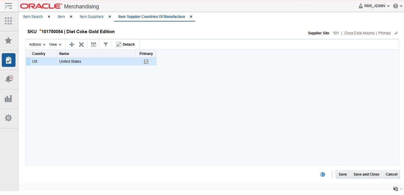

Add a sourcing country for the supplier of the item by select Actions > Countries of Souring, or by clicking the Country of Sourcing button.

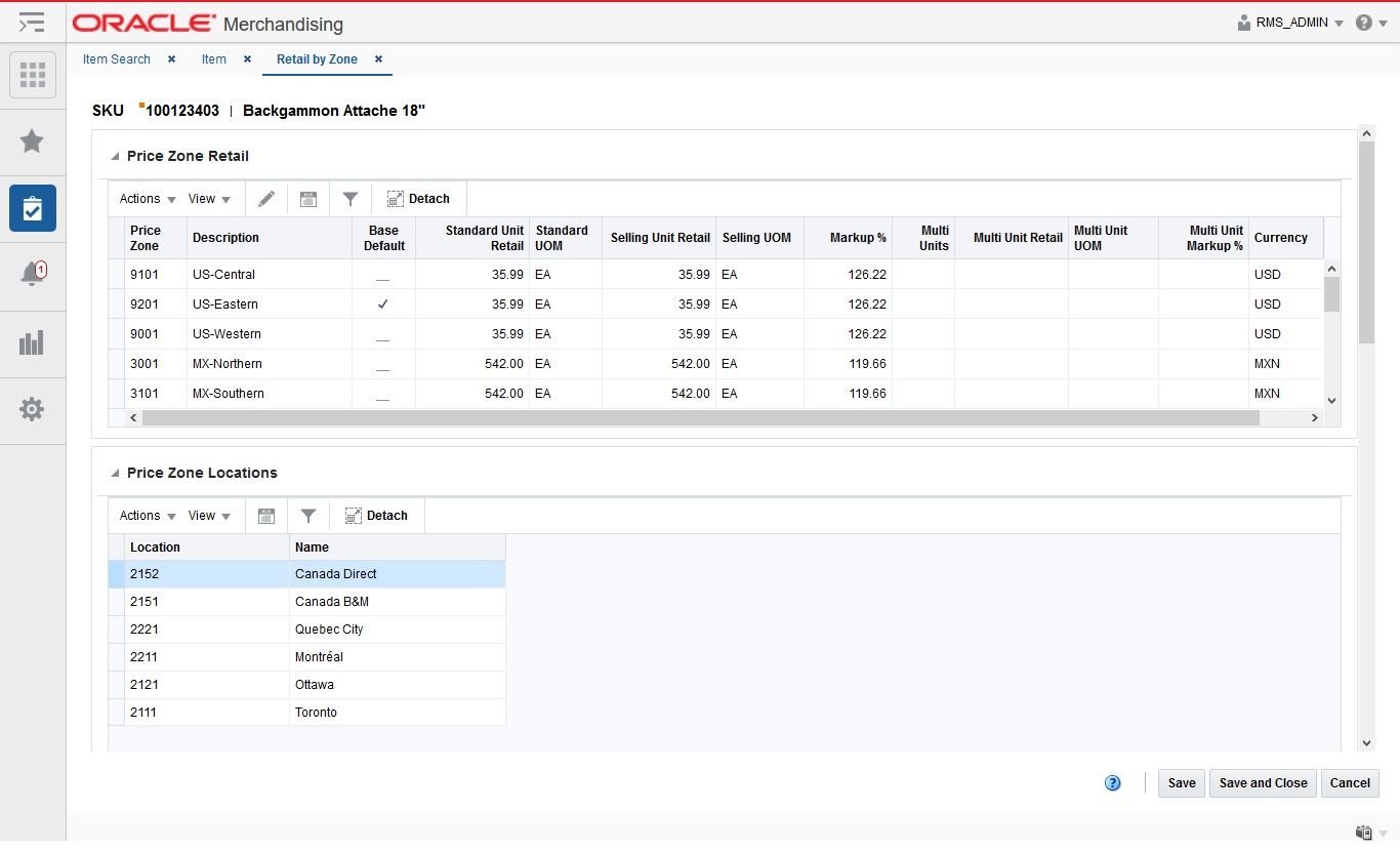

Edit the retail price of the item.
Select More Actions > Retail by Zone. The Retail by Zone page appears. For more information about this page, see the Define Initial Prices section.

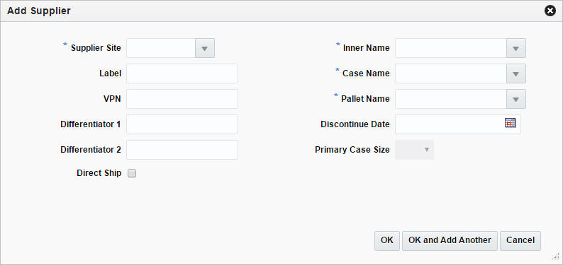

In the Item page, select More Actions > Suppliers. The Item Supplier page appears. For more information about this page, see the Add Suppliers section
In the Item page, select More Actions > Retail by Zone. The Retail by Zone page appears. For more information about this page, see the Define Initial Prices section.

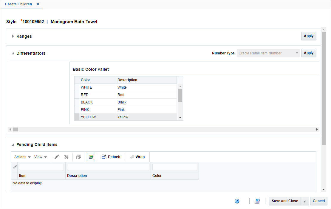

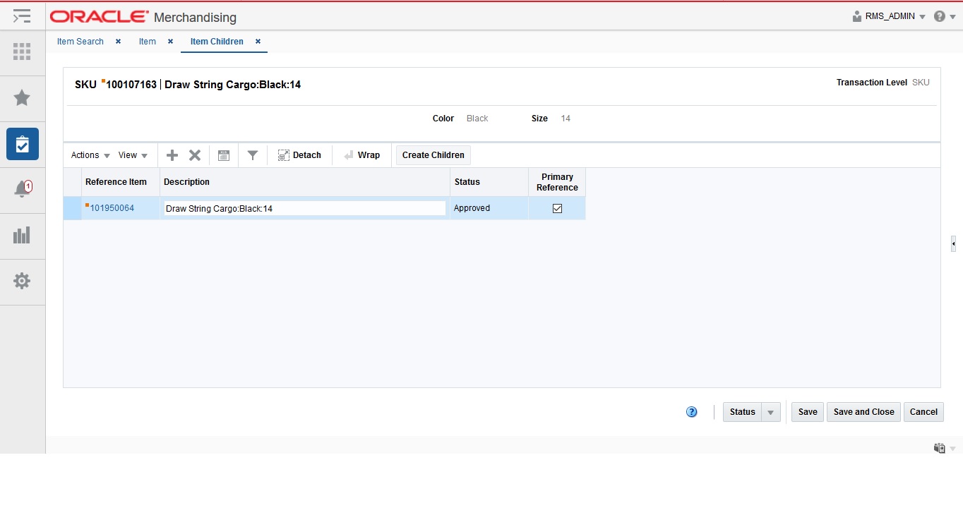

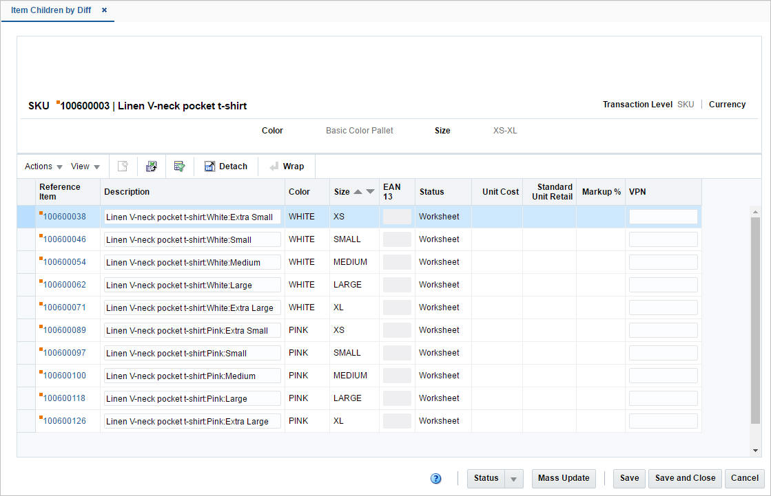

Add child items to the item.
In the Item page, click Create Children. The Item Children page appears. For more information about this option, see the Item Children section.
Save you entries.
Add the differentiators for the item.
In the Differentiators section, add the diffs for the item. For more information about this section, see the Differentiators section.
In the Item page, click Create Children. The Create Children page appears. For more information about this option, see the Create Children Page section.
Save you entries.

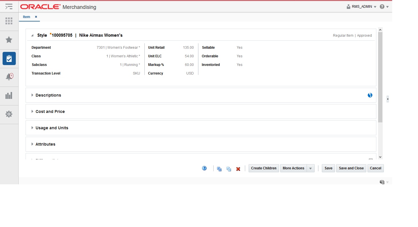

Item Page
Once you fill in all the details in the Create Item page and click OK, the Item page appears.
The Item page includes the following sections:
Figure 1-2 Item Page
Item Header
The Item Header includes the following fields:
Table 1-1 Item Header - Fields and Description
Fields | Description |
Title |
The title displays the Item level (SKU/Style/Reference Item), Item ID, and Item Description with a separator between them to the extreme left of the Item page. The type of item and item status is displayed with a separator between them to the extreme right of the Item page. The item number is populated by default. |
Item Status |
The description of the item status is displayed as text. When you create an item, the status is Worksheet. |
The following fields are populated by default: Style, SKU, Department, Class, Subclass, Transaction Level, Unit Retail, Unit ELC, Markup %, Currency, Sellable, Orderable, Inventoried.
Descriptions
Figure 1-3 Descriptions
This section contains a Translate icon in the top right corner. You can create a translation by using the Translate icon .
The Descriptions section includes the following fields:
Table 1-2 Descriptions - Fields and Description
Description |
Enter the description of the item. This field is a required field. |
Short |
Enter the short description of the item. This field is a required field. |
Secondary |
Enter the alternate description of an item. This field can be used to enter the item description used by the supplier. |
Number Type |
This field is displayed by default. |

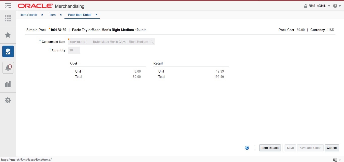

Pack
Figure 1-4 Pack
The label of the Pack section varies, depending on whether you create a Simple Pack or a Complex Pack.
The top right corner of the section contains the Pack Details icon. If you click the icon, the Pack Item Details page appears. For more information about this page, see the Pack Item Detail section.
The pack section includes the following fields:
Table 1-3 Pack - Fields and Description
Type |
For complex packs, select the pack type from the list. Possible types are Buyer Pack or Vendor Pack. For simple pack the field defaults to Vendor Pack. |
Order As Type |
Only enabled if you select Buyer Pack as Pack Type. Select pack or eaches to indicate how the item should be ordered. |
Contains Inner |
The Contains Inner checkbox indicates if the pack contains inner containers. |
Store Pack Inventory |
The Store Pack Inventory checkbox indicates whether inventory is tracked at the pack level in SIM for stores. |
SOH Inquiry at Pack Level |
The SOH Inquiry at Pack Level is used by SIM to determine how to reflect SOH for pack items in the store. |
Cost and Price
Figure 1-5 Cost and Price
The Cost and Price section includes the following fields:
Table 1-4 Cost and Price - Fields and Description
Cost Zone Groups |
Enter the cost zone group ID, or search for and select the cost zone group. |
Suggested Retail |
Enter the suggested retail price. |
Selling Unit Retail |
Enter the new retail price. |
Selling UOM |
Enter the Selling UOM as necessary. |

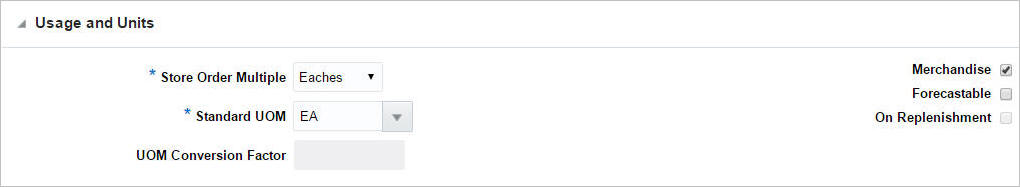

Usage and Units
Figure 1-6 Usage and Units
The Usage and Units section includes the following fields:
Table 1-5 Usage and Units - Fields and Description
Store Order Multiple |
The unit of measure by which items are shipped to stores. The store order multiple may be each, inner, or case. The default store order multiple is set up at the item level. Store order multiples for specific locations are set up at the item/location level. Select the Store Order Multiple from the list. This field is a required field. |
Standard UOM |
Enter the standard UOM, or search for and select the standard UOM. |
UOM Conversion Factor |
This factor will be used to convert sales and stock data when an item is retailed in eaches and does not have eaches as its standard unit of measure. |
Merchandise |
If the item is merchandised, select the Merchandise check box. |
Forecastable |
If the item is forecasted, select the Forecastable check box. |
On Replenishment |
This indicates if the item is put on replenishment. |
Attributes
Figure 1-7 Attributes
The Attributes section includes the following fields:
Table 1-6 Attributes - Fields and Description
Service Level |
Select the service level from the list. |
Product Classification |
Select the Product Classification from the list. |
Brand |
Enter the Brand or select from the list. |
Gift Wrap |
Select Gift Wrap, if this item is available with gift wrap. |
Ship Alone |
Select Ship Alone if this item is shipped alone and not grouped for shipment. |

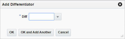

Differentiators
A differentiator (diff) is a characteristic that can be used to make items distinct from one another. You can add levels to an item group if you identify a set of diffs or diff groups. Each unique diff or unique combination of diffs creates a new level in the item group. If you choose not to use diffs, you can manually create item levels.
Once you have selected the diffs, you can create all of the items for that item level through Merchandising.
Figure 1-8 Differentiators
The Differentiators section includes the following fields.
Table 1-7 Differentiators - Fields and Description
Diff 1-4 |
Select the Diff 1 from the list. You can select up to four diffs by clicking the Add icon |
Group/ID |
Select the group or ID from the list. |
Diff Value |
Select the diff value, or enter, search and select. |
Item Aggregate checkbox |
This checkbox is only enabled for diff groups.

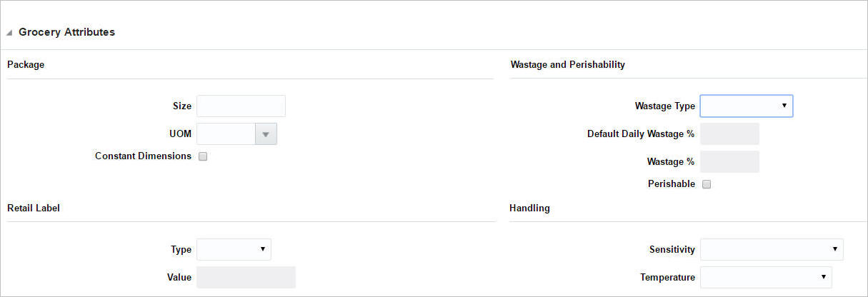

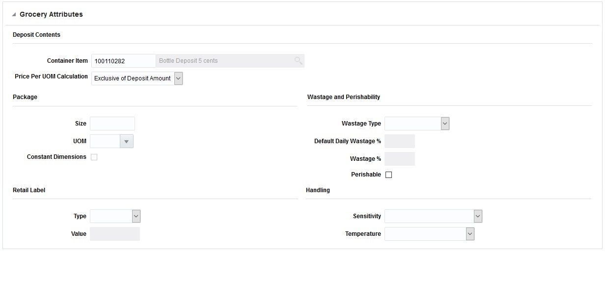

Grocery Attributes
Figure 1-9 Grocery Attributes
This section is only displayed, if you have the required privilege. The Grocery Attributes section includes the following fields:
Table 1-8 Grocery Attributes - Sections and Description
Sections | Description |
Deposit Contents area |
Only available, if you create a deposit content item. You have to associate a container item to the deposit content item, in this area.
Package area |
Wastage and Perishability area |
Retail Label area |
Handling area |
Deposit Container area |
Only available, if you create a deposit container item. The table lists the content items associated to the deposit container item. |

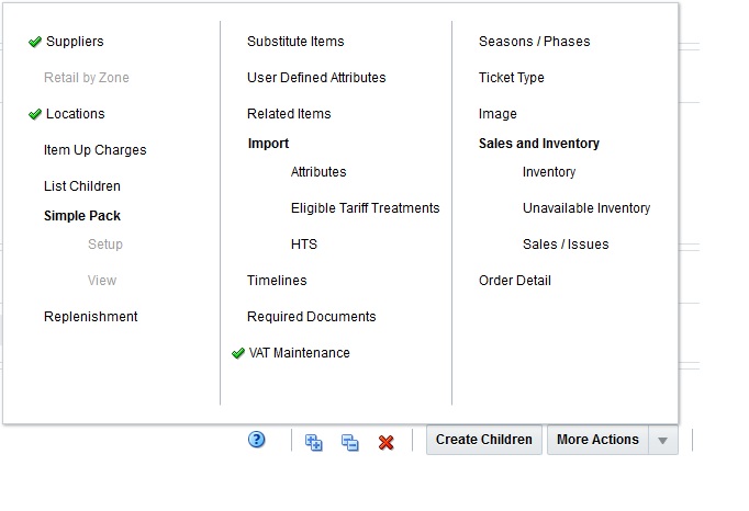

Item - More Actions Menu
The More Actions menu contains the options listed in the table below.
Figure 1-10 More Actions Menu of Item Page
Table 1-9 More Actions Menu - Buttons and Description
Action Buttons | Description |
Checkmark icon |
The checkmark icon indicates that data has already been entered for this option. |
Required icon |
This icon indicates that data is required, but has not been entered. |
Suppliers |
Opens the Item Supplier page. For more information about this page, see the Add Suppliers section. |
Retails by Zone |
Opens the Retail by Zones page. For more information about this page, see the Define Initial Prices section. |

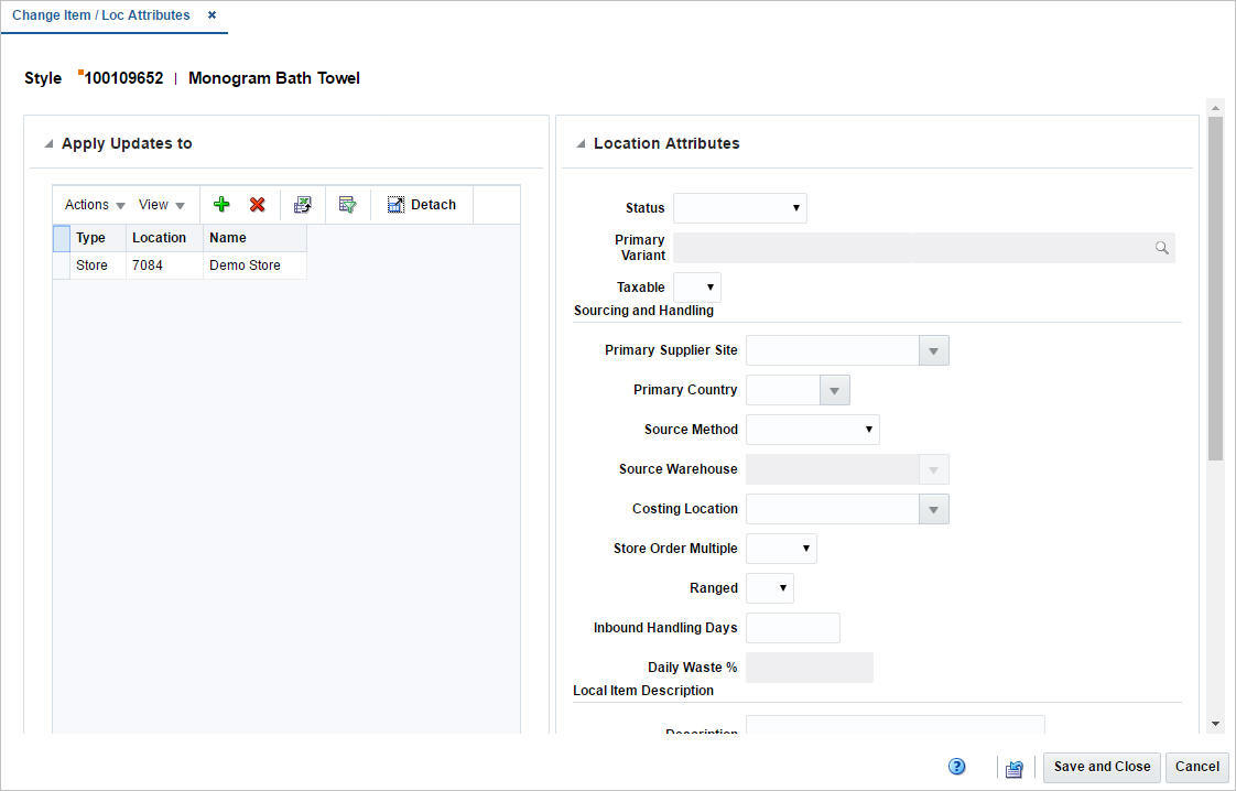

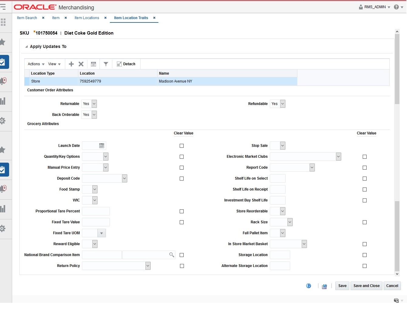

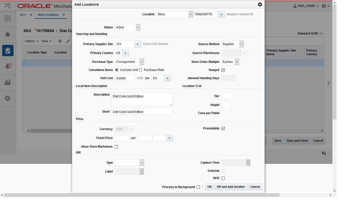

Locations |
Opens the Item Locations page. For more information about this page, see the Item Locations section. |

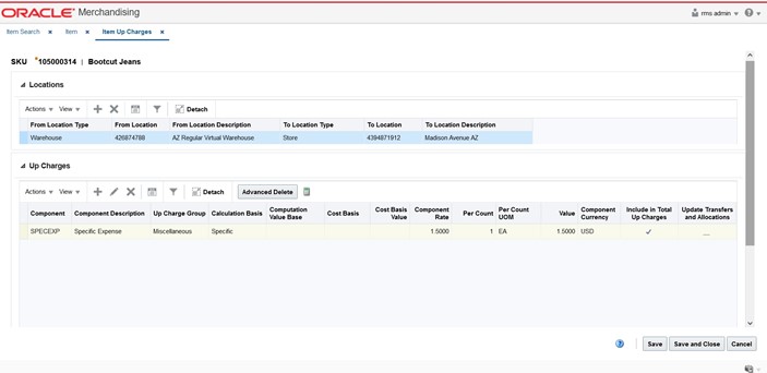

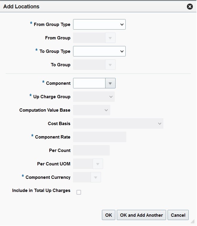

Item Up Charges |
Opens the Item Up Charges page. For more information about this page, see the Add Up Charges section. |
List Children |
Opens the Item Children/Item Children by Diff page. For more information about this page, see the Item Children and With Diffs sections. |
Simple Pack |
Select one of the following options from the Simple Pack submenu:
Transformation |
Opens the Item Transformation page. For more information about this page, see the Item Transformation section. |
Replenishment |
Opens the Manage Replenishment Attributes page. For more information about this page, see Managing Attributes at the Item Level in the Oracle® Retail Merchandising Replenishment User Guide. |
Substitute Items |
Opens the Substitute Items page. For more information about this page, see the Define Substitute Items section. |
User Defined Attributes |
Opens the Item UDAs page. For more information about this page, see the Manage Item Lists chapter, section "Update User Defined Attributes". |

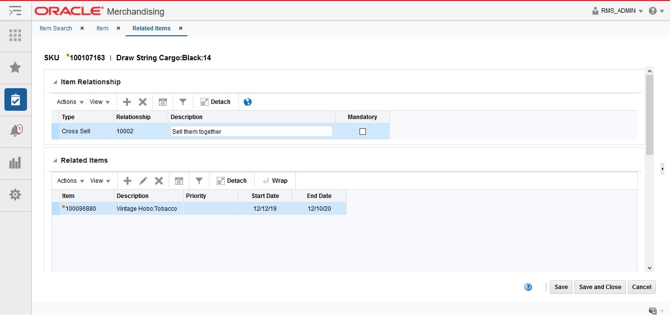

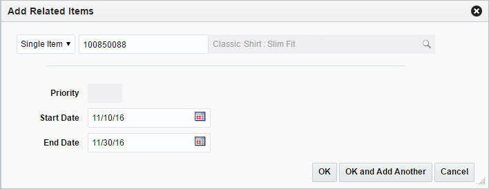

Related Items |
Opens the Related Items page. For more information about this page, see the Add Related Selling Items section. |

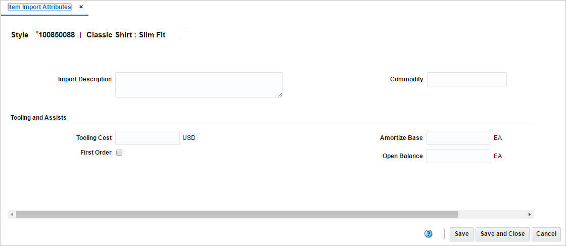

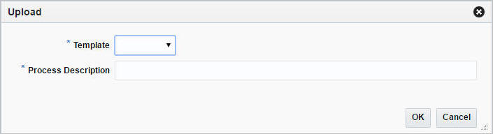

Import |
Select one of the following options from the Import submenu:
Timelines |
Opens the Timelines page. |
Required Documents |
Opens the Required Documents page. For more information about this page, see the Required Documents section in the Oracle® Retail Merchandising Purchase Orders and Contracts User Guide. |
VAT Maintenance |
Opens the Item VAT page. For more information about this page, see the Define VAT Rates section. |
Season/Phases |
Opens the Item Seasons page. For more information about this page, see the Add Seasons and Phases section. |

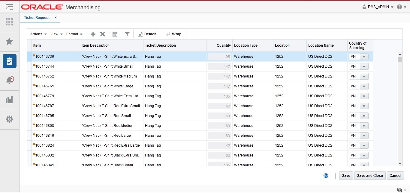

Ticket Type |
Opens the Item Tickets page. For more information about this page, see the Add Tickets section. |

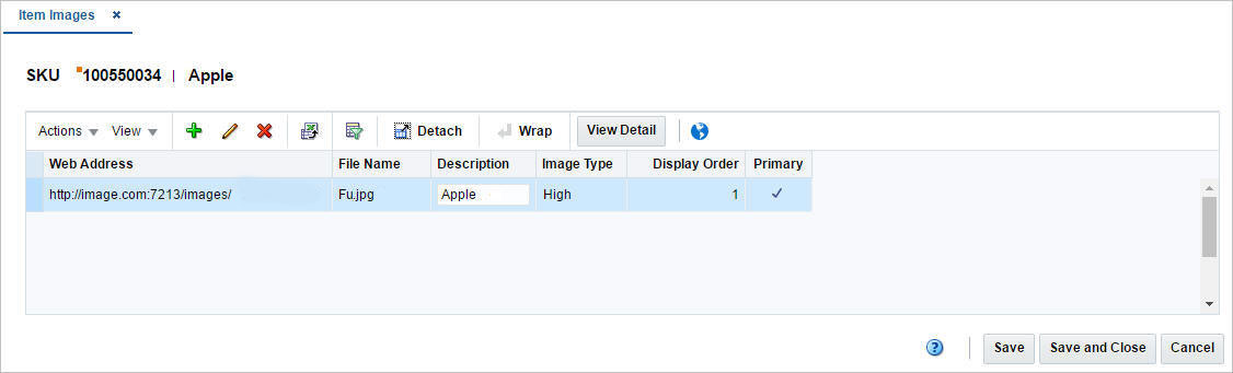

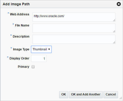

Image |
Opens the Item Images page. For more information about this page, see the Add Images section. |

To create a deposit item, follow the steps below.
In the Type field, select the deposit item you want to create from the list. Possible options are:
Deposit Container: The item for which the deposit is taken. The deposit container item holds the deposit contents item.
Deposit Contents: The item that is sold to the customer.
Deposit Crate: The item which holds the container and contents items.
Deposit Returned Item: The item that is returned to the retailer by the customer and for which the deposit is returned to the customer.
The necessary item type indicators for the selected deposit item are selected by default.
Sellable: When selected, indicates that the item is sold and is sent to the POS.
Orderable: When selected, the item can be ordered, set up on replenishment, and can have HTS and expenses set up.
Inventoried: When selected, indicates that the inventory is tracked and held in Merchandising.
In the Department, Class, and Subclass fields, enter, select or search for the IDs of the merchandise hierarchy.
In the Transaction Level field, select transaction level 1, 2 or 3.
In the Number Type field, select the type of item number that you want to associate with the item.
If you select Oracle Retail Item Number or UPC-A in the Type field, the item number is automatically added. If you select EAN/UCC-13, you can automatically generate the EAN number by clicking Generate. If you select Manual, the description field accepts alphabetic text and does not validate digit, length, or characters. It is a 12-digit number starting with 3 that includes check digit validation.
In the Description and Short field, enter a description for the item.
For more information about the Item page, see the Item Page section.

In the Grocery Attributes section add the attributes as necessary.
Figure 1-11 Grocery Attributes
If you create a deposit content item, you have to associate a deposit container item to the deposit content item.
Once associated, the deposit container item lists all associated deposit content items in the Deposit Container table.
For more information about this section, see the Grocery Attributes section.

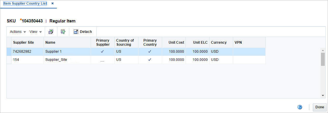

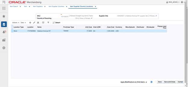

In the Type field, select the type of the transformable item you are creating from the list.
Transformed Orderable: The item is ordered from the supplier in one form, but is changed by the retailer and sold to the customer in a different form.
Transformed Sellable: The item that is sold to the customer. A transformed sellable item is ordered from the supplier in a different form that it is sold.
The necessary item type indicators for the selected transformable items are selected by default. If necessary, select the Catch Weight checkbox.

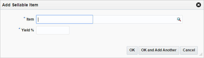

Then add sellable items by selecting Actions > Add, or by using the Add icon
in the Sellable Items section.
If the Multiple Parent checkbox in the Sellable Items section is selected, the The Yield from Orderable section is displayed. Define the yield details for any sellable items that are associated with multiple orderable items.
For more detailed information about how to transform an item, see the Item Transformation section.

Item Transformation
The Item Transformation page is only available for items with the item type Transformable Orderable.
The Item Transformation page contains the following sections.
Header
The header contains transformable orderable item, unit of measure information, the item transformation type as well as the transformation type.
In addition the section contains a Description field, for the description for the transformation template and Comments field. You can create a translation for the transformation template by using the Translate icon
Figure 1-12 Item Transformation Page
Sellable Items
In the Sellable Items section you can map transformation sellable item(s) to a transformation orderable item and define the percentage of each sellable item that results from the transformation.
The Production Loss Yield % and the Total Yield % are displayed in right corner of the section. The Production Loss Yield % and the Total Yield % values must add up to 100%.
The table displays the sellable item, the item description, the yield % for each item as well as Multiple Parent checkbox.
The Multiple Parent checkbox indicates whether or not the sellable item is derived from multiple orderable items. If the checkbox is selected the Yield from Orderable section enables and is populated.
The Yield From Orderable section is used to distribute yield percentages between multiple transformation orderable items for any transformable sellable items derived from multiple orderable items.
This section is available only for items that have the Multiple Parent checkbox selected, meaning the sellable item is derived from multiple orderable items and therefore the distribution yield percentages must be defined.

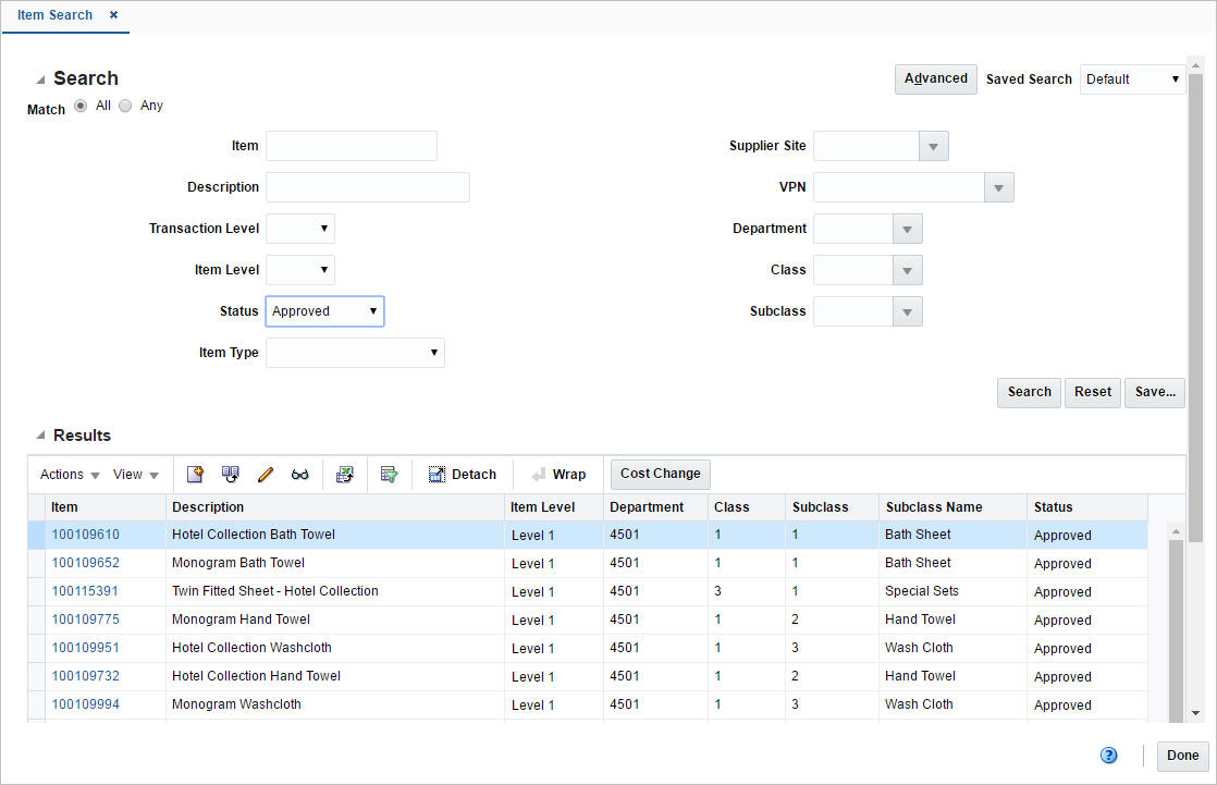

From the Tasks menu, select Items > Manage Items. The Item Search page appears.
Restrict your search to the item type Transformed Orderable.
For more information about how to create a transformable item, see the Transformable Items section.
Click Search. The items that match the search criteria are displayed in the Results section.
In the item column, click the item link, or mark a record and select Actions > Edit, or use the Edit icon

Select More Actions > Transformation. The Item Transformation page appears.
In the Description field, enter the description of the item transformation.
In the Production Loss field, enter the percentage of the orderable item which is wasted in producing the sellable items. Then add the sellable items.
Then add the sellable items. For more information about how to add sellable items, see the Adding Sellable Items section.
To add sellable items, follow the steps listed below.
In the Sellable Items section, select Actions > Add, or use the Add icon
. The Add Sellable Item page appears.
Figure 1-13 Add Sellable Item Page
In the Item field, enter or search for the sellable item that is created from the orderable item.
In the Yield % field, enter percentage of the orderable item used to create the sellable item.
The Total Yield % field must equal 100% for the orderable item. The Total Yield % field is calculated by adding the Yield % and the Production Loss % field.
Click OK to add the current sellable item to the table.
Click OK and Add Another to add additional sellable items.
Click Cancel to reject all entries and close the page.
In the Type field, select simple pack from the list.
The necessary item type indicators Orderable and Inventorable are selected by default. If necessary, select the Sellable and/or the Catch Weight checkbox.
The Transaction Level field, defaults to level 1.

Simple Pack Set Up
In the Simple Pack Set Up page you can create and view simple packs that contain the selected component item. A simple pack is a sellable and/or orderable vendor pack with multiples of only one item number as the component item.
When creating a simple pack for a component item, the following information needs to be provided:
Type of number, pack number, and pack description
Number of units of the component item that make up the pack
Primary supplier and country of sourcing for the pack
Unit cost of the pack
Number of packs in a case, cases on a tier, and tiers on a pallet
Base retail price of the pack if it is sellable as a pack
In addition you can define the dimensions, weights, and volumes of cases and pallets. After defining the attributes of the pack, you can choose to copy other details from the component item. The details may include suppliers, stores, warehouses, seasons, user defined attributes, ticketing, required documents, sales taxes, HTS numbers, and expenses.
Figure 1-14 Simple Pack Setup Page

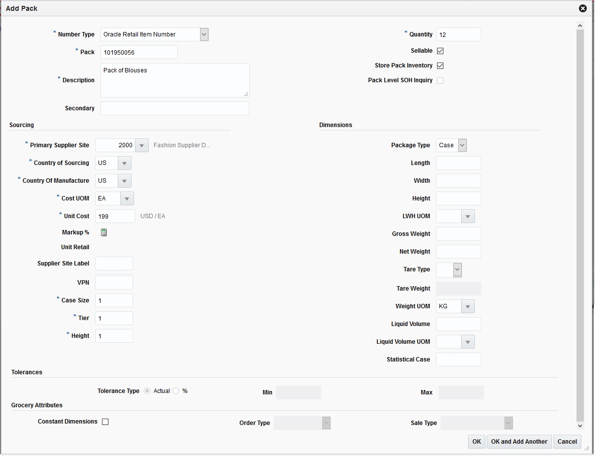

Adding Pack Information
To add pack information for the selected item, follow the steps below.
In the table, select Actions > Add, or use the Add icon. The Add Pack page appears.
Figure 1-15 Add Pack Page
In the Number Type field, select the type of item number that you want to associate with the pack item. This field is a required field.
In the Pack field, enter the pack number of the pack item. This field is a required field.
If you select Oracle Retail Item Number or UPC-A in the Item Type field, the item number is automatically added. It is a 12-digit number starting with 3 that includes check digit validation.
In the Description field, enter a description for the pack item. This field is a required field.
In the Secondary field, specify the alternate name of the item.
In the Quantity field, specify the number of component items of the pack. This field is a required field.
If you select the Sellable checkbox, the item can be sold and sent to the POS.
The Store Pack Inventory checkbox indicates whether inventory will be tracked at the pack level in SIM for stores.
The Pack Level SOH Inquiry is used by SIM to determine how to reflect SOH for pack items in the store.
The NIC is static checkbox indicates if the Negotiated Item Cost (NIC) is static or not.
In the Sourcing section enter the following information:
In the Primary Supplier Site field, enter, select or search for the primary supplier site. This field is a required field.
In the Country of Sourcing field, enter, select or search for the code for the country. This field is a required field.
In the Country of Manufacture field, enter, select or search for the country. this field is a required field.
In the Cost UOM field, enter, select or search for the unit of measure. This field is a required field.
In the Unit Cost field, enter the cost of the item in the indicated currency. This field is a required field.
The Markup % field displays the percentage the price marked up, based on the supplier's cost.
The Unit Retail field is displayed by default.
The Supplier Site Label field is defined to describe the label or brand for the item supplied by the supplier.
In the VPN field, specify the vendor product number.
In the Case Size field, enter the case size. This field is a required field.
In the Tier field, enter the tier. This field is a required field.
In the Height field, enter the height. This field is a required field.
In the Dimensions section, enter the necessary information about the simple pack.
In the Tolerance section, the following fields are available.
Tolerance Type: This is the unit of the tolerances for catch weight simple packs. The valid values are A (actual) and % (percentage).
Min: This is the minimum tolerance value for the Catch Weight simple pack.
Max: This is the maximum tolerance value for the Catch Weight simple pack.
In the Grocery Attributes section, the following fields are available.
The Catch Weight and Tolerance areas are enabled only if you select Catch Weight in the Attributes area of the Item page.
Select the Constant Dimensions checkbox, if the pack dimensions are fixed.
The Order Type field gets enabled only for Catch Weight pack.
The Sale Type field gets enabled only for Catch Weight pack.
Click OK to add the current pack to the table
Click OK and Add Another to add additional packs.

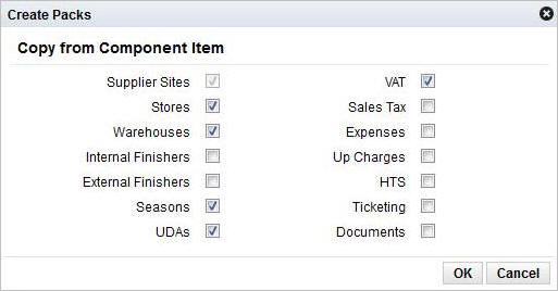

Creating Packs
To create packs follow, follow the steps listed below.
In the toolbar, select Create Packs. The Create Packs page appears.
Figure 1-16 Create Packs Page
Select which details you want to copy from the component item to the simple pack.
Click OK to add the simple pack to the table. The Exists checkbox is automatically selected and the selected component details are copied to the simple pack.
When you click Create Packs, component details are copied to the new simple packs. If simple packs already exist, their details are not updated.

Pack Item Detail
In the Pack Item Detail page you can add, edit, delete and view the component items of a pack item. A complex pack may be composed of multiple units of multiple items. A simple pack may be composed of multiple units of one item.
There are some restrictions depending on the how you define the purpose of the pack:
Orderable pack: You cannot add, delete, or edit the component items if the pack is already on order or stocked at any location.
Sellable pack: You cannot add, delete, or edit the component items after the pack item is priced.
The Pack Item Details page varies depending whether you maintain a complex or simple pack.
Simple Pack:
Header
The header displays the label Simple Pack, the pack number and description. The right hand side displays the Pack Cost and Currency.
Component

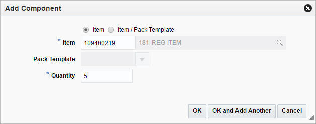

In this section you can search for a component item. You can add only component item in case of simple packs.
In the Component Item field, enter, select or search for the component item.
In the Quantity field, enter the quantity for the component item.
The Cost and Retail section displays the Unit and Total fields. These fields are populated when you enter the item.
Complex Pack:
Header
The header displays the label Complex Pack, the pack number and description. The right hand side displays the Pack Cost and the Currency.
Figure 1-18 Pack Item Detail - Complex Pack
Components
The Components section displays a table which contains all the component items that are part of the complex pack. The title displays the Total Component Cost and Total Component Retail in the in right hand corner.
You can edit the Quantity column of the component item directly in the table.

Maintaining Pack Item Details
To maintain pack item details, follow the steps below.
Enter or select search criteria as desired to make the search more restrictive.
Restrict your search to the item type Simple Pack or Complex Pack in Worksheet status.
In the Simple/Complex Pack section, select the Pack Item Details icon
. The Pack Item Details page appears.
Simple Packs
For simple packs, enter the following details.
Save your changes.
Complex Packs
For complex packs, add component items and supplier pack templates.
Adding Components for Complex Packs
To add components for complex packs, follow the steps below.
In the Components section, select Actions > Add, or use the Add icon
. The Add Component page appears.
Figure 1-19 Add Component Page
Select if you want to add an item or an item/pack template.
In the Item field, enter or search for an item. This field is a required field.
In the Pack Template field, enter, select or search for the template. Only enabled if you select item/pack template.
Click OK to add the component to the table.
Click OK and Add Another to add additional components.
Save your entries.

Add Suppliers
In the Item Supplier page you can add, edit, delete and view the suppliers for an item. By default, the first supplier is marked as the primary supplier for the item. After additional suppliers are added, the primary supplier can be redefined.
The Item Supplier page contains the following sections.
Header
The header displays the Item Level (SKU/Style/ Reference Item), the item number and item description.
Figure 1-20 Item Suppliers Page
The table header contains the item number and item description. The table displays the supplier site, the supplier site name, the vendor product number (VPN), the unit cost as well as the currency. Additionally the table displays whether or not a direct shipment from the supplier to the customer is eligible.
Maintaining Item Suppliers
To maintain item suppliers, follow the steps below.
Restrict the search to items in Worksheet status.
In the Item column, click the item link, or mark a record and select Actions > Edit, or use the Edit icon
Select More Actions > Suppliers. The Item Suppliers page appears.
Adding Item Suppliers
To add item suppliers, follow the steps below.
In the Item Suppliers page, select Actions > Add, or use the Add icon
. The Add Supplier page appears.
Figure 1-21 Add Supplier Page
In the Supplier Site field, enter, select or search for the supplier site. This field is a required field.
In the Label field, enter the supplier label for the item.
In the VPN field, enter the vendor product number.
In the Differentiator fields, enter the diff values, if applicable.
Select the Direct Ship checkbox, if direct shipments from the supplier to the customer are permitted.
The Inner Name, Case Name and Pallet Name fields, are defaulted to the name used by the supplier to refer to the inner, the case and the pallet. These fields are required fields.
In the Discontinue Date field, enter the date at which the supplier discontinues the item or use the Calendar icon to select the discontinue date.
In the Primary Case Size field, select the primary case size from the list.
This field is only enabled, if the Advanced Inventory Planning application is used.
Select the Apply Modifications to Child Items checkbox, to update the child items.
The first supplier added to the item, is marked as the primary supplier by default. You can change the primary supplier for the item, after you have added additional suppliers.
For more information about how to change the primary supplier for an item, see the Editing Item Suppliers section.
Click OK to save the supplier for the item and close the page.
Click OK and Add Another to add additional suppliers for the item.

Item Supplier Countries
The Item Supplier Countries page allows you to add, edit, and view the sourcing countries that are associated with an item supplier combination. You can define a Purchase type that captures the Ownership model agreed upon with the supplier for the specific Item-sourcing country combination. Three types of Ownership models are supported namely Owned Merchandise, Consignment and Concession. Consignment and Concession ownership models can be selectively enabled through system option configuration Based on the ownership model you can enter the costs or costing method negotiated with the supplier. Additionally you can maintain location defaults, ordering, case, and packaging information
You can view all countries associated to the item in the table of the Country of Sourcing section. For each country up to four dimension records can be created.
The Item Supplier Countries page contains the following sections.
Header
Depending on the item you have selected, the label of the header varies. The label displays Item Level (SKU/Style/ Reference Item), the item number and item description. Additionally, the header contains the supplier site number and name and indicates whether or not the selected supplier is the primary supplier for the item.
Figure 1-23 Item Supplier Countries Page
Figure 1-24 Item Supplier - Add Country
Country of Sourcing
The Country of Sourcing section displays the following columns by default.
Country
Primary
Purchase Type
Unit Cost
Cost UOM (Unit of Measure)
Case Cost
Case Size
Supplier Inbound Tier - Height
Case/Pallet
Lead Time
Pickup Lead Time
Round Level
Thresholds
Packing Method
If the selected item is a parent item, the Apply Modifications to Child Item checkbox is displayed in the right hand corner of this section. Select to checkbox to indicate that the changes are also applied for the child items.
Maintaining Countries of Sourcing for a Supplier
To maintain countries of sourcing for a supplier, follow the steps below.
The item should be in Worksheet, Submitted, or Approved Status.
In the Item Suppliers page, select Actions > Countries of Sourcing, or use the Countries of Sourcing button. The Item Supplier Countries page appears.
Adding a Country of Sourcing for a Supplier of an Item
To add a new country of sourcing for an supplier of an item, follow the steps below.
In the Countries of Sourcing section select Actions > Add, or use the Add icon
. The Add Country page appears.
In the Country of Sourcing field, enter, select or search for the country.
If you want to define the current supplier as the primary supplier for the item, select the Primary option.
Select the Purchase Type to be associated with the item supplier country combination.
Valid values of Purchase type are Owned, Consignment and Concession. Consignment and Concession purchase types will be available for selection only if the functionality is selected in system options.
Several fields in the Packaging, Sourcing, Rounding and Tolerances sections default to the suppliers default information. Edit the information as necessary.
Enter the Unit Cost and Case Cost of the Item.
If the Purchase type is Consignment or Concession item costing can be entered based on either Cost per Unit or Purchase Rate %.
If the selected item is a parent item, the Apply Modifications to Child Item checkbox is displayed. Select to checkbox to indicate that the changes are also applied for the child items.
Click OK to add the country of sourcing for the supplier and close the page.
Click OK and Add Another to add additional countries of sourcing for suppliers.
The Purchase Type and Costing details captured on an Item Supplier Country record will be used as a default unless location specific exceptions are defined in Item Supplier Country Location.
Editing Countries of Sourcing for a Supplier of an Item
To edit a country of sourcing for a supplier of an item, follow the steps below.
In the Countries of Sourcing section, select a record in the table.
Then select Actions > Edit, or use the Edit icon
. The Edit Supplier page appears.
Edit the fields, as necessary.
Click OK to save your changes and close the page.
Dimensions
The Dimensions section displays the package type, as well as dimension, weight, and liquid information.
Adding Dimensions for a Country of Sourcing
To add dimensions for a country of sourcing, follow the steps below.
In the Countries of Sourcing section, select a country for which you want to add dimensions.
In the Dimensions section, select Actions > Add, or use the Add icon
. The Add Dimensions page appears.
In the Package Type field, select a package type from the list.
The Dimensions, Weight and Liquid sections default to the suppliers default information. Edit the information as necessary.
Click OK to add the dimensions for the country of sourcing and close the page.
Click OK and Add Another to add additional dimensions for the country of sourcing.
You can add up to four dimensions for one country.
Editing Dimensions for a Country of Sourcing
To edit dimensions for a country of sourcing, follow the steps below.
In the Countries of Sourcing section, select a country for which you want to edit the dimension information.
In the Dimensions section, select a record in the table.
. The Edit Dimensions page appears.

In the toolbar, click Supplier Country List. The Item Supplier Country List page appears.
The Item Supplier Country List page contains the following sections.
Header
The header of the page displays Item Level (SKU/Style/ Reference Item), the item number and item description.
Figure 1-25 Item Supplier Country List
Table
The table displays supplier site and country of sourcing information.
Item Supplier Country Locations
The Item Supplier Country Locations page allows you to create and maintain Location specific exceptions to the values defined on Item Supplier Country. These could be exceptions based on Purchase Type, Costing, dimensions, packing information etc .You can view all location specific exceptions to an item supplier country record in the table on the Item Supplier Country Locations page.
The Item Supplier Country Locations page contains the following sections.
Header
Depending on the item you have selected, the label of the header varies. The label displays Item Level (SKU/Style/ Reference Item), the item number and item description. The header also contains the supplier site number and name and indicates whether or not the selected supplier is the primary supplier for the item. Additionally the header also includes the country of sourcing and whether it is primary or not.
Table
Figure 1-26 Item Supplier Country Locations Page
The Locations displays the following columns by default.
Location type
Location
Name
Purchase type
Unit Cost
Case Cost
Currency
Manufacturer
Distributor
Wholesaler
Pickup Lead Time

Adding an Item Supplier Country Location Record
To add a new Item supplier Country location exception, follow the steps below.

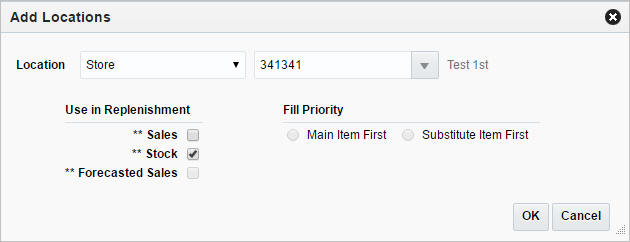

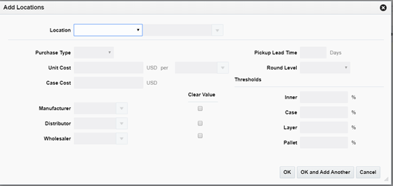

In the Locations section select Actions > Add, or use the Add icon
. The Add Locations page appears.
Figure 1-27 Add Location Pop-up
In the Location field, select the Location Type and select or enter the location.
The Purchase Type is defaulted from the Supplier Country of sourcing. Edit this information as necessary
The Cost defaults from the Supplier Country of sourcing. Edit this information as necessary.
If the Purchase Type is consignment /concession, then the Calculation basis and the cost or Purchase Rate needs to be specified
The Rounding Thresholds and Lead times default to the values from the Supplier Country of Sourcing. Edit the information as necessary.
Editing an Item Supplier Country Location Record
To edit an item supplier country location record, follow the steps below.
In the Locations section, select a record in the table.
. The Edit Item Supplier Country Location page appears.
Deleting an Item Supplier Country Location Record
To delete an item supplier country location record, follow the steps below.
Then select Actions > Delete, or use the Delete icon
. The record is deleted from the table
Item Bracket Costing
The Item Bracket Costing page allows you to view the brackets for the item/supplier/country/location combination and edit unit and case bracket costs for items in worksheet status. Brackets are used by the suppliers to provide different costs based on the quantity ordered.
When a country-level bracket is modified, costs default down to all location brackets. When items above the transaction level are modified, costs are default down to children for all brackets. If a default bracket cost is changed, the cost is modified at the item-supplier-country-location level.
The Item Bracket Costing page contains the following sections.
Header
The header of the page displays the Item Level (SKU/Style/ Reference Item) and the item number. Additionally the header displays the supplier site and name, the country as well as the location and location name.
Select the Primary checkbox for the supplier site, country and/or location to indicate if they are the primary supplier site, country or location.
Detail
The table displays the brackets for the item-supplier-country-location combination. You can edit the Unit Cost and Case Cost columns directly in the table.
Restrict your search to items with the status Worksheet.

Add Countries of Manufacture
In the Item Supplier Countries of Manufacture page you can manage manufacturing countries for item suppliers. One of the countries can be indicated as primary.
The Item Supplier Countries of Manufacture page contains the following sections.
Header
Figure 1-28 Item Supplier Countries of Manufacture
Detail
Depending on the selected item the label of the header either displays the item description, or indicates if the selected item is a pack or reference item.
On the right hand side the supplier site information is displayed. Additionally Primary checkbox shows if the current supplier is the primary supplier for the item.
The table displays the following columns by default.
Country
Country Name
Primary
Maintaining Manufacturing Countries for a Supplier
To maintain countries of manufacture for a supplier, follow the steps below.
In the Item Suppliers page, select Actions > Countries of Manufacture. The Item Supplier Countries of Manufacture page appears.
Adding a Country of Manufacture for a Supplier of an Item
To add a new manufacturing country for an supplier, follow the steps below.
In table, select Actions > Add, or use the Add icon
. The Add Country of Manufacture page appears.
In the Country field, enter, select or search for the country.
If you want to define the current country as the primary manufacturing country for the supplier, select the Primary option.
Click OK to add the country of manufacture for the supplier and close the page.
Click OK and Add Another to add additional countries of manufacture for suppliers.

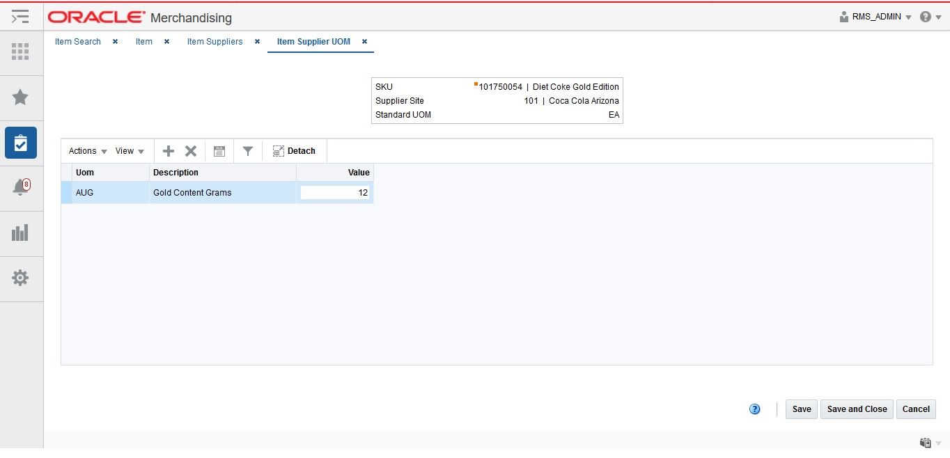

Add Supplier Units of Measure
In the Item Supplier UOM page you can add, delete, and view miscellaneous units of measure (UOM) for an item/supplier combination. You must enter a factor that can be used to convert the unit of measure to the standard unit of measure. In this page you can overwrite the unit of measure for all subordinate level items that are supplied by the supplier of the selected item.
The Item Supplier UOM page contains the following sections.
Header
The header displays the item, the supplier site as well as the standard unit of measure.
Figure 1-29 Item Supplier UOM
Detail
Unit of measure (UOM)
Description
Value
You can enter the value of the unit of measure directly in the table.
Maintaining Units of Measure for a Supplier
To maintain units of measure for a supplier, follow the steps below.
In the Item Suppliers page, select Actions > UOM. The Item Supplier UOM page appears.
Adding a Unit of Measure for a Supplier of an Item
To add a new unit of measure for an supplier, follow the steps below.
. The Add UOM appears.
In the UOM field, enter, select or search for the unit of measure.
In the Value field, enter a value of the UOM.
Click OK to add the unit of measure and close the page.
Click OK and Add Another to add additional UOMs for the supplier.

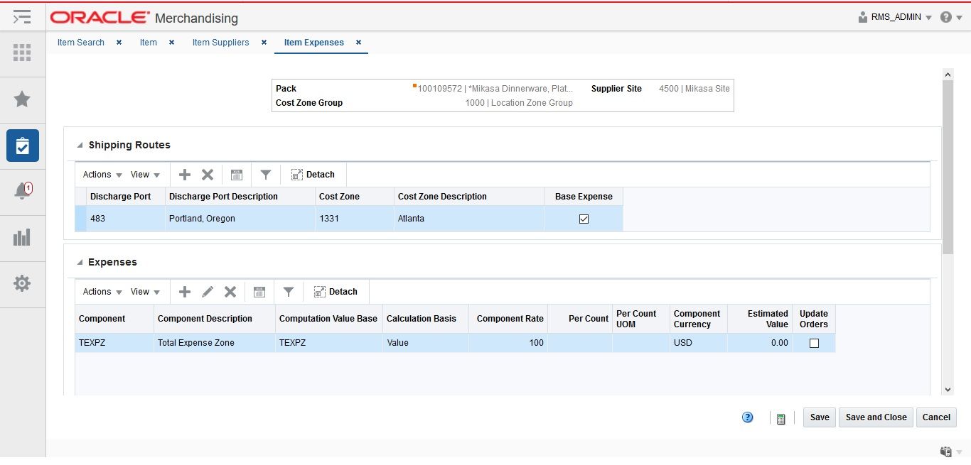

The Item Expense page allows you to view and maintain shipping routes and importing and exporting expenses associated with an item and shipping route. Expenses are tracked at the following two levels:
Country:
Country-level expenses track the costs of importing merchandise from the country of sourcing, through the lading port, to the discharge port.
Zone:
Zone-level expenses track the costs of sending merchandise from the discharge port to the final destination. This screen can be accessed from Item Suppliers and Item Supplier Country screen.
The Item Expenses page contains the following sections.
Header
When you access the Item Expenses page from Item Supplier page, the header displays the item, supplier site and cost zone group.
When you access the Item Expense page from Item Supplier Country page, the header displays the item, the supplier site and the country of sourcing.
Figure 1-30 Item Expenses Page
Shipping Routes
When you access the Item Expenses page from Item Supplier page, the Shipping ping Rout table displays the following columns by default: Discharge Port, Discharge Port Description, Cost Zone, Cost Zone Description and Base Expense.
Whereas when access the Item Expenses page from Item Supplier Country page, the Shipping Route table displays the following columns by default: Lading Port, Lading Port Description, Discharge Port, Discharge Port Description and Base Expense.
Base Expense:
The Base Expense option indicates whether or not this set of expenses is also the base set of expenses. You can select the Base Expense option directly in the table.
Expenses
The Expenses section displays the following columns by default:
Component
Component Description
Computation Value Base
Calculation Basis
Component Rate
Per Count
Per Count Unit of Measure
Component Currency
Estimated Value
Update Orders
Maintaining Item Expenses
To maintain item expenses, follow the steps below.
Access from the Item Supplier page.
In the Item Suppliers page, select Actions > Expenses. The Item Expenses page appears.
Access from the Item Supplier Countries page:
In the Countries of Sourcing section, select Actions > Expenses. The Item Expenses page appears.
Adding a Shipping Route
To add a new shipping route for an item, follow the steps below.
In the Shipping Route section select Actions > Add, or use the Add icon
. The Add Shipping Route page appears.
When accessed from the Item Supplier page:
In the Discharge Port field, enter, select or search for the discharge port.
In the Cost Zone field, enter, select or search for the cost zone.
The Base Expense option indicates whether or not this set of expenses is also the base set of expenses. Select the Base Expense option, if necessary.
When accessed from the Item Supplier Countries page.
In the Lading Port field, enter, select or search for the lading port.
Click OK to add the shipping route for the item and close the page.
Click OK and Add Another to add additional shipping routes for item.

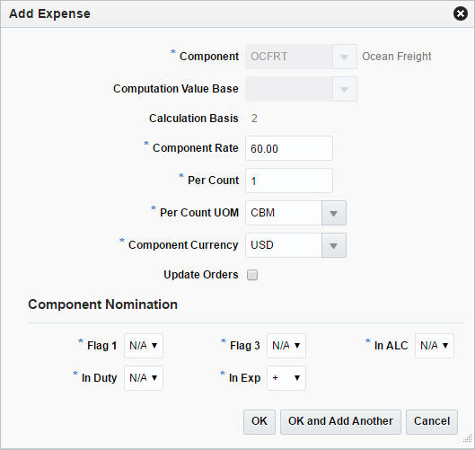

Adding Expenses
To associated expenses with an item and shipping route, follow the steps below.
In the Expenses section, select Actions > Add, or use the Add icon
. The Add Expense page appears.
Figure 1-31 Add Expense Page
In the Component field, enter, select or search for the expense component.
The following fields default to the expense defaults. Edit the information as necessary.
Calculation Basis
Component Rate
Per Count
Component Currency
Update Orders
Required fields are marked with an asterisk.
In the Component Nomination section, edit the fields, if necessary.
Click OK to add the expense for the item/shipping route and close the page.
Click OK and Add Another to add additional expenses for the item/ shipping route.
Editing Expenses
To edit expenses for an item/shipping route, follow the steps below.
In the Expenses section, select a record in the table.
. The Edit Expense page appears.

In the Retail by Zone page you can view and/or edit the initial retail price that is calculated by zone during the creation of a new item(s). The price zone retail is calculated based on the markup percent defined for the departments primary zone group. Retail values are calculated and displayed for all zones within a departments primary zone group. Locations tied to a zone are displayed in the Price Zone Locations section. You can edit the retail value as necessary prior to submitting or approving the item. Once an item is approved this screen is disabled, future retail price changes are done via the RPM system.
The Retail by Cost Zone page contains the following sections.
Header
Figure 1-32 Retail by Zone Page
Price Zone Retail
The Price Zone Retail section displays all zones tied to the primary zone group designated for the merchandise hierarchy of the created item(s).
The, Price Zone Locations displays all of the locations tied to a zone that is highlighted in the Price Zone Retail section.
Editing a Retail Price of an Item by Zones
To edit a retail price of an item by zone(s), follow the steps below.
Restrict your search to items in Worksheet status.
In the Price Zone Retail section, select one or more records in the table.
. The Edit Zone Retail page appears.
The price zone information of the selected record is displayed. Edit the fields, as necessary.
If you have selected more than one price zone. The Price Zone field shows Multiple. Update the Markup % and the multi-units fields as necessary.
In the Selling Unit Retail field, enter the new retail price. Then select the selling unit of measure.
In the Markup % field, enter the percentage the price is marked up, based on the supplier's cost.
Update the appropriate multi-units field as necessary.
Click OK and Edit Another to edit additional price zones.

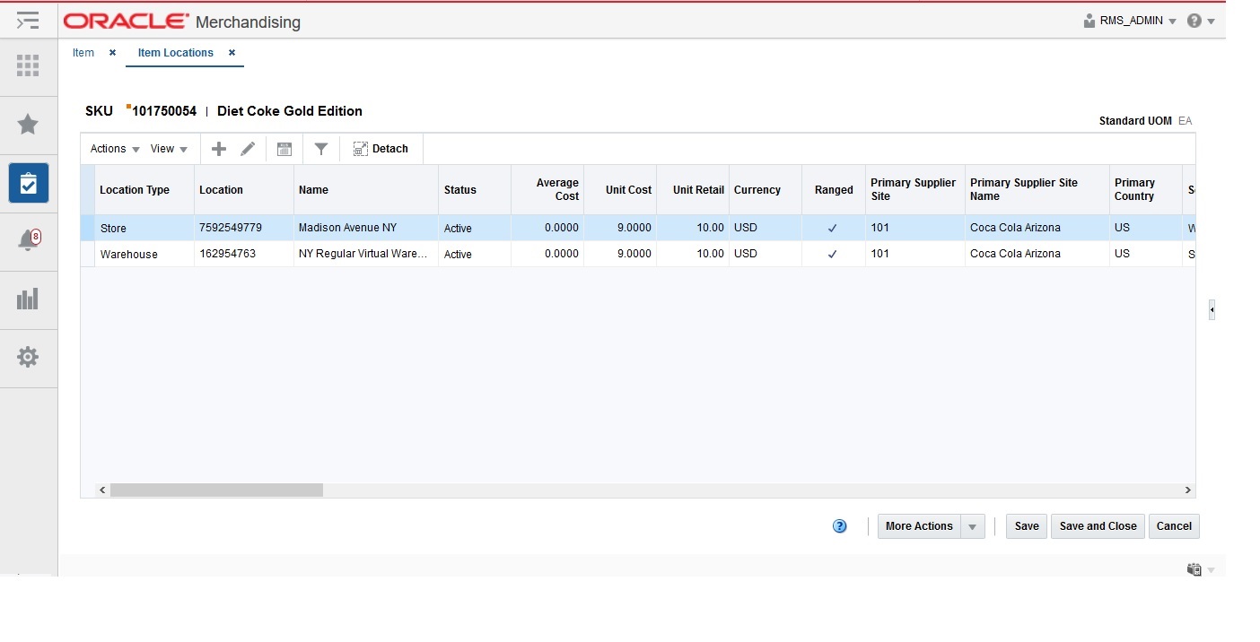

Item Locations
In the Item Locations page you can view and maintain the locations at which an item is stocked. Locations for items at or above the transaction level can be maintained. If the item is above the transaction level, an option to automatically apply changes to child items down to the transaction level can be selected.
Additional information can be added at the item location level that is different at the location than it is for the item.
You can add the following additional information:
Item's active status
Costing information, for the pack and the unit
Tier - Height information

The Item Locations page contains the following sections.
Header
Figure 1-33 Item Locations Page
Table
The table label displays the item number and either the item description or indicates whether the selected item is a pack or reference item. Additionally the standard unit of measure is displayed in the top right corner. The table displays the locations information for the selected item.
Maintaining Item Locations
To maintain item locations, follow the steps below.
Access from the Item page:
Select More Actions > Locations. The Item Locations page appears.
Adding Locations
To add a new location for an item, follow the steps below.
In the Item Locations page, select Actions > Add, or use the Add icon
Figure 1-34 Add Locations Page
In the Location field, select the location type from the list. Then choose the location.
The system displays the information of the selected location.
Add the information at the item location level that is different at the location than at the item level.
Edit the displayed information in the following sections:
Status of the Item
Sourcing and Handling information
Primary Supplier Site – Enter or select a primary supplier site for the location if it's different from the one specified at the item level.
Primary Country – Enter or select a primary country for the location if it's different from the one specified at the item level.
Purchase Type – This field is available only when consignment/concession functionality is used in the system. Select a value to specify ownership type of item if it's different from what's defined at the item supplier country level.
Calculation Basis – Only available when purchase type is consignment or concession. Specifies if the costing of the item will be based on per unit cost or a purchase rate.
Specify unit cost or purchase rate depending on the calculation basis specified.
Source Method – Select if the default source method for the location will be supplier or warehouse.
Source Warehouse – Default source warehouse for the location.
Store Order Multiples – Specify the multiple in which item needs to be shipped from a warehouse to the location.
The Ranged checkbox determines if the location is ranged intentionally for replenishment/selling or incidentally ranged by the Merchandising transaction when the item is not ranged to a specific location on the transaction.
Inbound Handling Days – Specify inbound handling days for warehouses.
Location Item Description
Costing information
Edit the information for the pack and the unit.
Type of the Unique Identification Number Type (UIN)
In the Type field, select the UIN type from the list. This number is used to identify the instance of the item at the location.
In the Label field, select the UIN label from the list. This number will be displayed in SIM.
If the selected item is a parent item, the Apply Modifications to Child Items checkbox is displayed. The checkbox indicates whether or not the updates are also applied to the child item. The checkbox is selected by default.
The Process In Background checkbox determines if the ranging of items to the selected locations happens immediately or the ranging is submitted in the background.
This checkbox must be checked if the list of locations ranged is big, so that you do not have to wait for the ranging to complete. Submitting the ranging to background disables this page and the Item page goes into View mode.
You can check Asynchronous Job Log for status of the ranging happening in background.
Click OK to add the location for the item and close the page.
Click OK and Add Another to add additional locations for item.

Item Location Traits
The Item Location Traits page is used to define and maintain item attributes at a single location or at multiple locations. Some of these attributes are downloaded at the Point of Service (POS) or a ticketing system, while others are entered for information only and drive no processing.
The Item Location Traits page contains the following sections.
Header
The header contains the item number and description.
Apply Updates To
This section contains the following subsections:
Only available if you selected the Mass Change > Locations Traits option in the Item Locations page.
Customer Order Attributes
Grocery Attributes
Figure 1-35 Item Location Traits Page
Table
In this table you can add and delete locations for the item attributes.
Maintaining Item Location Traits
To define and maintain item location traits, follow the steps listed below.
Updating Multiple Locations
To updating multiple locations, by using the Mass Change option, follow the steps below.
In the Item Locations page select Mass Change > Location Traits. The Item Location Traits is displayed.
In the table of the Apply Updates To section, you can add one or more locations for which location traits may be updated.
Select Actions > Add, or use the Add icon
In the Location field, select a location type from the list. Then select the location.
Click OK to add the current location to the table and close the page.
Click OK and Add Another to add additional locations.
Click Cancel to reject your entries and close the page.
Enter, select or search the new values for the desired traits.
Choose a saving option.
Updating a Single Location
To update a single location, follow the steps listed below.
In the Item Locations page, select a location in the table.
Then select Actions > Location Traits. The Location Traits page appears with the highlighted location populated in the header of the Item Location Traits page.
Viewing Item Location Traits
To view item location traits, follow the steps listed below.
In the Results section, mark a record and select Actions > View, or use the View icon
Then select Actions > Location Traits. The Location Traits page appears. View the item location traits.
Click Done to close the page.

With Diffs
In the Item Children by Diff page you can edit child items created with differentiators, generate EAN13s or create grand children.
You can perform the following actions in this page.
Edit the description and other details of level 2 or level 3 items that were created with differentiators.
Generate EAN13s.
Create children of level 2 transaction level items.
The Item Children by Diff page contains the following sections.
Header
The header displays the Item Level (SKU/Style/ Reference Item), the item number and the item description. Additionally the transaction level and the currency are displayed in the right hand corner. The differentiator groups/values associated with the parent item are displayed.
Figure 1-36 Item Children by Diff Page
Table
The table lists the child items. The item level description, description, EAN 13, status, unit cost, standard unit retail, markup % andVPN are displayed by default.
You can edit the Description, the EAN 13 and the VPN (Vendor Product Number) column directly in the table.
Maintain Item Children by Diff
To maintain item children, follow the steps listed below.
Click More Actions > List Children. The Item Children by Diff page appears.

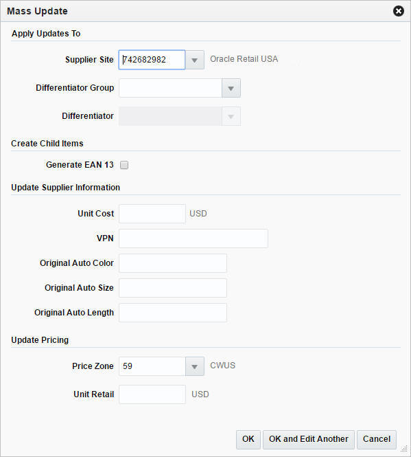

Mass Update
To perform a mass update, follow the steps below.
Click Mass Update. The Mass Update page appears.
Figure 1-37 Mass Update Page
The Supplier Site field is populated with the parent item's primary supplier and the Price Zone field is populated with the price zone group's base zone.
In the Differentiator Group field, enter, select or search for a diff group.
If a diff group is selected. The Differentiator field enables, enter, select or search for the appropriate diff.
Select the Generate EAN 13 checkbox, to generate EAN 13 for the child items.
In the Update Supplier Information section, enter the values as necessary.
In the Unit Cost field, enter the unit cost, if necessary.
In the VPN field, enter the vendor product number, if necessary.
In the Supplier Diff fields, enter the diffs. All available diffs are displayed.
In the Update Pricing section, enter the values as necessary.
In the Price Zone field, edit the price zone, if necessary.
In the Unit Retail field, enter the unit retail price.
When the items are approved, the Update Pricing section is not available. You cannot update the price zone and the unit retail price.
Click OK to add the item to the table and close the page.
Click OK and Add Another to add additional items.
Item Children
The Item Children page is used to create a subset of items from an item that is already entered into Merchandising. In this screen, you can perform the following actions:
Edit level 2 or level 3 items that were created without differentiators.
Edit the description of items at level 2 or level 3 of an item group.
Use the Actions menu to edit details for the selected level 2 or level 3 item.
The Item Children page contains the following sections.
Header
The header displays the Item Level (SKU/Style/ Reference Item),, item number and the item description. Additionally the transaction level is displayed in the right hand corner. If the parent item has differentiators associated, all differentiators are displayed.
Figure 1-38 Item Children Page
Table
The table lists the child items. The columns Reference Item, Description, Status and Primary Reference Item are displayed.
You can edit the Description column directly in the table.
Click More Actions > List Children. The Item Children page appears.

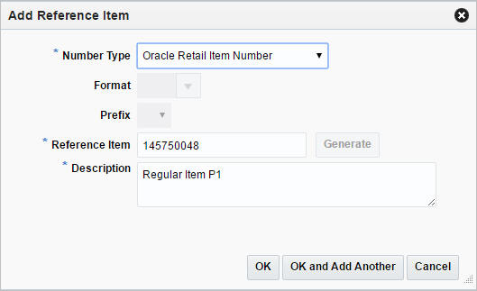

Adding Items
To add items, follow the steps below.
Select Action > Add, or use the Add icon
. The Add Item page appears.
Figure 1-39 Add Item Page
In the Number Type field, select a number type you want to add from the list. This field is a required field.
If you select Oracle Retail Item Number or UPC-A, the item number is automatically added.
If you select EAN/UCC-13, you can automatically generate the EAN number by clicking the Generate.
If you select Manual, the Description field accepts alphabetic text and does not validate digit, length, or characters. It is a 12-digit number starting with 3 that includes check digit validation.
If you select Variable Weight PLU, the fields Format and Prefix enable.
In the Reference Item field, enter the item. This field is a required field.
In the Description field, enter the description of the item. This field is a required field.
In the Create Children page you can select differentiators while creating child items for items with differentiators. Differentiators can be applied individually, by differentiator range, or by differentiator group. When two types of diff values are combined, a level 2 or level 3 item is created for each possible combination of the two types. The new child items appear in the Pending Child Items section.
The Create Children page contains the following sections.
Header
Figure 1-40 Create Children Page
Ranges
This section is only available, if there are applicable differentiator ranges. Irrespective of the number of the possible ranges that can be applied, only one differentiator range is displayed by default.
Differentiators
The Differentiator section can contain up to four possible differentiator tables, listing all the differentiators for each differentiator group or ID. Only differentiator tables containing values are displayed, therefore the number of visible tables equals to the number of diff group/value of the item.
For group type diffs, the table header contains the diff group description. For value type diffs, the table header contains the diff type description. The tables display the columns diff type description and description.
Pending Child Items
The Pending Child Items table only lists new unique child items for further operations.
Create Child Items for Items with Diffs
To create children for Items with diffs, follow the steps listed below.
Click Create Children. The Create Children page appears.
Applying a Diff Range
To apply a diff range, follow the steps below.

Adding Components
To add more components to a location, follow the steps listed below.
In the Locations section, select a location in the table.
In the Up Charges section select Actions > Add, or use the Add icon
Figure 1-43 Add Component Page
In the Maintenance Type field, select a type from the list.
The Maintenance Type field is only displayed for item lists. If you select Add and the up charge already exists, the details of the existing up charge will be overridden.
In the Component field, enter, select or search for the component. This field is a required field. On selecting a component, the remainder of the fields below are defaulted from the component definition. These fields can be updated if required.
In the Up Charge Group field, select the group from the list.
In the Computation Value basis field select the basis required. Either this field or the Cost basis are required for components that have a Calculation basis set to Value in the component definition.
In the Cost basis field, select the basis from one of Weighted Average Cost/Acquisition cost, Supplier Cost and Off Invoice Net Cost.
In the Component Rate field, enter the rate.
In the Per Count field, enter the number of counts.
In the Per Count Unit of Measure, enter, select or search for the UOM.
In the Component Currency field, enter, select or search for the currency.
Select the Update Transfers and Allocations checkbox to indicate that the transfers and allocations should be updated.
Select the value of the Include in Total Up charge Indicator.
Click OK to add the component for the selected location and close the page.
Click OK and Add Another to add additional components for the location.

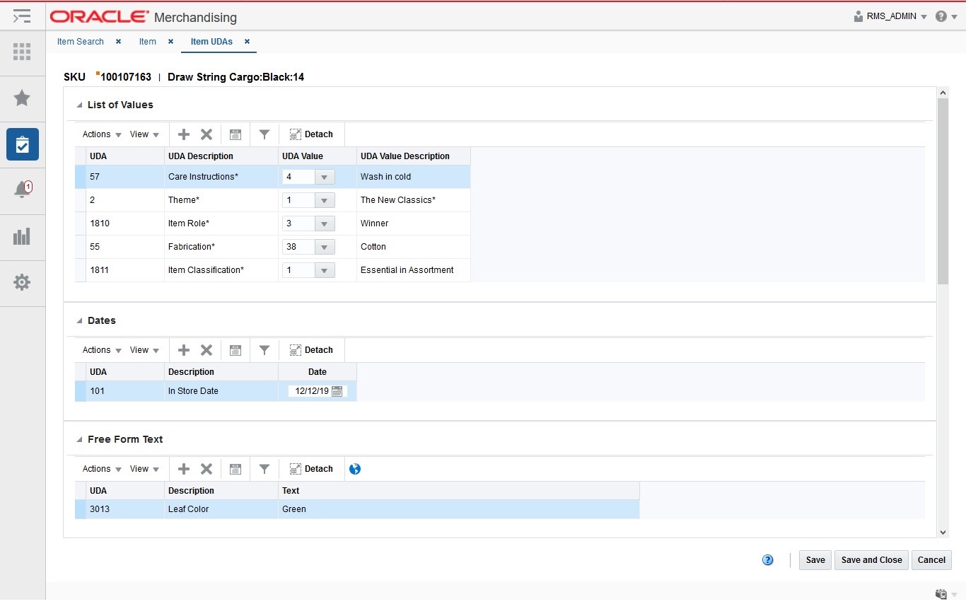

Add User Defined Attributes
The Item UDA List page allows you to maintain and view the user defined attributes (UDA) that are associated with an item.
The Item UDAs page contains the following sections.
Header
Figure 1-48 Item UDAs Page
User Defined Attribute Defaults
When you create a new item and enter the Item UDAs page, the system verifies if any defaults are defined for the hierarchy in which the item is created. If defaults are defined, the UDA Defaults page appears.
The page displays the following defaults:
List of Values
Dates
Free Form Text
You can enter UDA values, dates or texts for each required UDA as well as for each non-required UDA directly in the corresponding table.
You can also delete the non-required UDAs by selecting Actions > Delete, or using the Delete icon .
To close the page choose one of the following options.
Click OK to add the UDA defaults to the corresponding tables in the Item UDAs page and exit the page.
Click Cancel to exit the UDA Defaults as well as the Item UDAs page.
List of Values
This section displays the user defined values for the selected item. You can edit the UDA Value field directly in the table.
Dates
This section contains the user defined dates for the item. You can edit the Date field, directly in the table.
