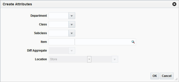

To create replenishment attributes follow the steps listed below.
From the Tasks menu, select Replenishment > Create Attributes. The Create Attributes window appears.
Figure 2-1 Create Attributes Window
In the Department field, enter, select or search for the desired department.
In the Class field, enter, select or search for the desired class.
In the Subclass field, enter, select or search for the desired subclass.
In the Item field, enter, select or search for the item to be replenished.
In the Diff Aggregate field, enter, select or search for the differentiator associated with the selected item.
This field is only enabled, if the Diff Aggregate Indicator is selected for the item chosen for replenishment.
In the Location field, select the location type from the list. Then enter, select or search for the location ID.
Check the Rebuild Location List checkbox, if you wish to rebuild the location list.
This field is only enabled, if you have selected location list as location type.
Then choose one of the following options.
Click OK to create the attribute. The Replenishment Attributes window appears in a new tab.
For more information about the Replenishment Attributes window, see the Replenishment Attributes Window section.
Also the location list will be rebuilt, if you have selected the Rebuild Location List checkbox.
Click Cancel to reject all entries and close the window.

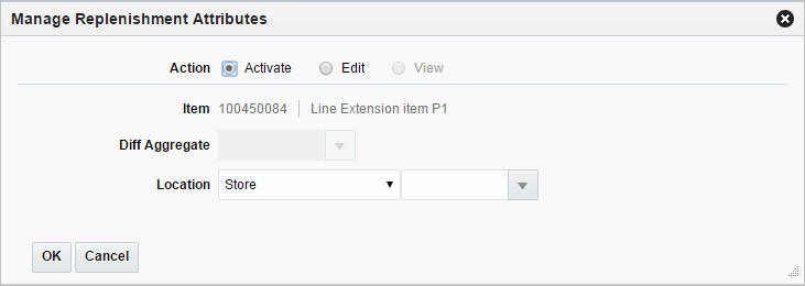

Managing Attributes at the Item Level
To manage attributes at the item level, item child level or item child by diff level, follow the steps below.
From the Tasks menu, select Items > Manage Items. The Item Search window appears.
Enter or select search criteria as desired to make the search more restrictive.
Click Search. The items that match the search criteria are displayed in the Results section.
In the Item column, click the item link, or mark a record and select Actions > Edit, or use the Edit icon
. The Item window appears.
For Items:
Select More Actions > Replenishment. The Manage Replenishment Attributes window appears.
For Item Children:
Select More Actions > List Children. The Item Children or Item Children by Diff window appears.
Then select Actions > Replenishment. The Manage Replenishment Attributes window appears.
Figure 2-2 Manage Replenishment Attributes
Select if you want to activate, edit or view the replenishment attributes for the item.
The Item field displays the item number and description of the selected item.
This field is enabled only if the Diff Aggregate Indicator is selected for the item chosen for replenishment.
In the Location field, select the location type from the list. Then enter, select or search for the location.
This field is only enabled, if you have selected Location List as location type.
Select the Update from Master checkbox, to update the item/location from the existing master replenishment attributes, if available.
The checkbox is only available if you have selected Edit as action.

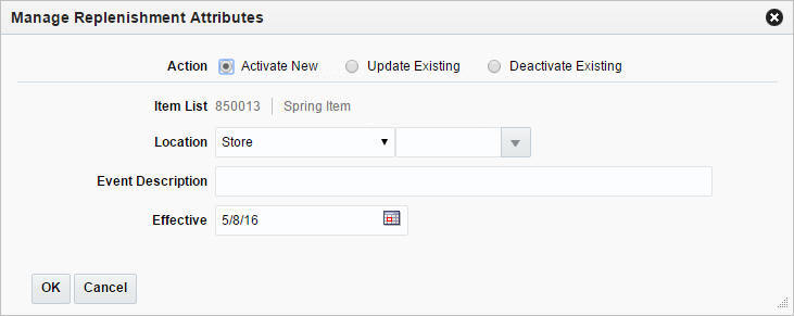

Managing Attributes at the Item List Level
To manage attributes at the item list level, follow the steps below.
From the Tasks menu, select Foundation Data > Items > Manage Item Lists. The Item List Search window appears.
Click Search. The item lists that match the search criteria are displayed in the Results section.
Select a record in the Results section.
Then select Actions > Mass Change > Replenishment. The Manage Replenishment Attributes window appears.
Figure 2-3 Manage Replenishment Attributes
Select if you want to activate new, update existing or deactivate replenishment attributes for the item list.
The Item List field displays the selected item list number and description.
In the Event Description field, enter the event description.
In the Effective field, enter an effective date for the replenishment attribute or use the Calendar icon to select an effective date.
The checkbox is only available if you have selected Update Existing as action.

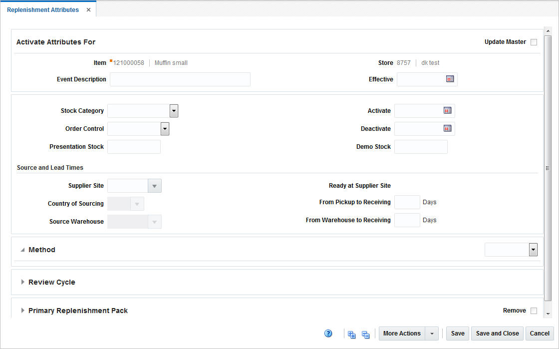

The Replenishment Attributes window allows you to add, edit, and view various replenishment parameters for the defined merchandise hierarchy and location hierarchy level.
In order to set up the replenishment parameters, you need to carry out the following functions in this window:
Select the stock category and type of order control
Specify effective dates
Define source and lead time days
Specify replenishment method and parameters
Determine the replenishment review cycle.
When you update the replenishment attributes for an item, you can choose to update the Master Replenishment Attributes at the same time.
The Replenishment Attributes window consists of the following sections:
Figure 2-4 Replenishment Attributes Window
Header
The title of this section indicates the mode, in which you enter the window, for example, possible headers are Activate Attributes For, Deactivate Attributes For or View Attributes For.
The Header section contains the Update Master checkbox and the values you entered in the Create Attributes window in addition to other fields.
For more information about how to create attributes, see the Creating Attributes section.
Table 2-1 Attributes For - Fields and Description
Fields | Description |
Update Master checkbox |
Check the Update Master checkbox to indicate that you want to update the master replenishment attributes with the replenishment attributes you are adding or updating. |
Department |
Only enabled for department, department/class, or department/class/subclass level maintenance. View only field. You cannot edit this field. Displays the value entered in the Create Attributes window. |
Class |
Only enabled for department/class or department/class/subclass level maintenance. View only field. You cannot edit this field. Displays the value entered in the Create Attributes window. |
Subclass |
Only enabled for department/class/subclass level maintenance. View only field. You cannot edit this field. Displays the value entered in the Create Attributes window. |
Item |
Only enabled for item or item/diff aggregate level maintenance. View only field. You cannot edit this field. Displays the value entered in the Create Attributes window. |
Diff Aggregate |
Only enabled for item/diff aggregate level maintenance. View only field. You cannot edit this field. Displays the value entered in the Create Attributes window. |
Item List |
Only enabled for item list level maintenance. View only field. You cannot edit this field. Displays the value entered in the Create Attributes window. |
Event Description |
This field contains the scheduled replenishment event description, entered in the Create Scheduled Update or Manage Replenishment Attributes window. Edit the event description, if necessary. |
Location |
Displays the location type and location ID. When the location type is All Stores or All Warehouses, the location ID field is disabled. View only field. You cannot edit this field. Displays the value entered in the Create Attributes window |
Created |
Displays the created date and created by values. View only field. You cannot edit this field. |
Effective |
Displays the effective date for when the scheduled event will take place. Enter the effective date or use the Calendar icon to select a date. |
Stock Category |
The Stock Category refers to the method in which merchandise is sourced and delivered to a location on replenishment. Valid values are Direct to Store, Cross-Docked, Warehouse Stocked, and WH/Cross Link. For example, select Cross-Docked. Select the stock category from the list. |
Order Control |
The Order Control parameter determines whether or not purchase orders and transfers should be created during the replenishment process, and if so, in what status they should be created. Valid values are Manual, Buyer Worksheet, Semi Automatic and Automatic. Select the order control method from the list. |
Presentation Stock |
Presentation Stock is the minimum amount of stock required to fill a facing in the store. Merchandising uses the presentation stock as a component in the determination of net inventory and order quantity calculations, as at a minimum replenishment tries to ensure shelves are full. Enter the quantity of the presentation stock for the item. Replenishment algorithm uses the presentation stock quantity in calculating ROQ. |
Activate Date |
The Activate Date is the date on which an item/location becomes active for replenishment. Enter an activate date or use the Calendar icon to select a date. |
Deactivate Date |
The Deactivate Date is the date on which an item/location becomes inactive for replenishment. Enter a deactivate date or use the Calendar icon to select a date. |
Demo Stock |
Demo Stock is the quantity of an item at a location considered not available for sale. Commonly, this is used for a particular product that is made available to customers to demo in the store, but could be used for other purposes as well. Enter the quantity of the demonstration stock for the item. The replenishment algorithm uses the demo stock quantity in calculating ROQ. This field is not required when you are adding replenishment attributes for an item at a warehouse. |
Source and Lead Times
Below the stock information the source and lead times information is displayed. The following fields are shown.
Table 2-2 Source and Lead Times - Fields and Description
Supplier Site |
Enter, select or search for the supplier site, which will be the source for this replenishment. |
Country of Sourcing |
Enter, select or search for the country of sourcing. |
Source Warehouse |
This attribute must be defined for stores, if the selected stock category is Cross-Docked, Warehouse Sourced, or WH/Cross Link. The attribute is not used for warehouse replenishment. This attribute designates the warehouse that will be used as either the source or the interim destination for the inventory on its way to the store. Only stockholding warehouses associated with the item can be designated as the source warehouse. Enter, select or search for the warehouse. |
Ready at Supplier Site |
The supplier site lead time is defaulted from the item supplier country lead time. |
From Pickup to Receiving |
The pickup to receiving lead time is the amount of time needed to ship the merchandise from the supplier to the initial receiving location, which can either be a store or a warehouse. Enter the number of days it takes for the item to reach the store or warehouse. This field is required for direct to store and cross-docked items. |
From Warehouse to Receiving |
The warehouse to receiving lead time is the amount of time needed to ship the merchandise from the warehouse to the store. Enter the number of days it takes for the item to reach the store. This field is required for cross-docked, warehouse cross-link and warehouse stocked items. |
Method
The Method section contains information on the replenishment method. The replenishment method allows you to automate the ordering process for items by constantly monitoring inventory conditions, and creating orders to fulfill consumer demand according to predefined replenishment parameters. Merchandising supports a total of ten replenishment methods.
The upper right hand corner of this section displays the Method field, select a method from the list for the section to expand.
